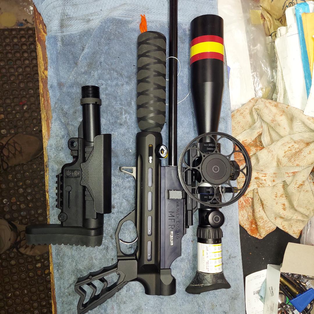

These FT pistols are very low rate and initially can be setup with a few different options like .177, .20 cal, 12fpe or 20fpe, aluminum or carbon fiber tank. They are not offered on the AirForce website yet, so just email ([email protected]) or call them (1.877.247.4867) and tell them what you want. They will get back with a quote. They have parts on the shelf to build your FT pistol.
Where did you buy this rifle? From Air Force or Airguns USA? Is this a custom build because it's not shown anywhere in their catalogs.

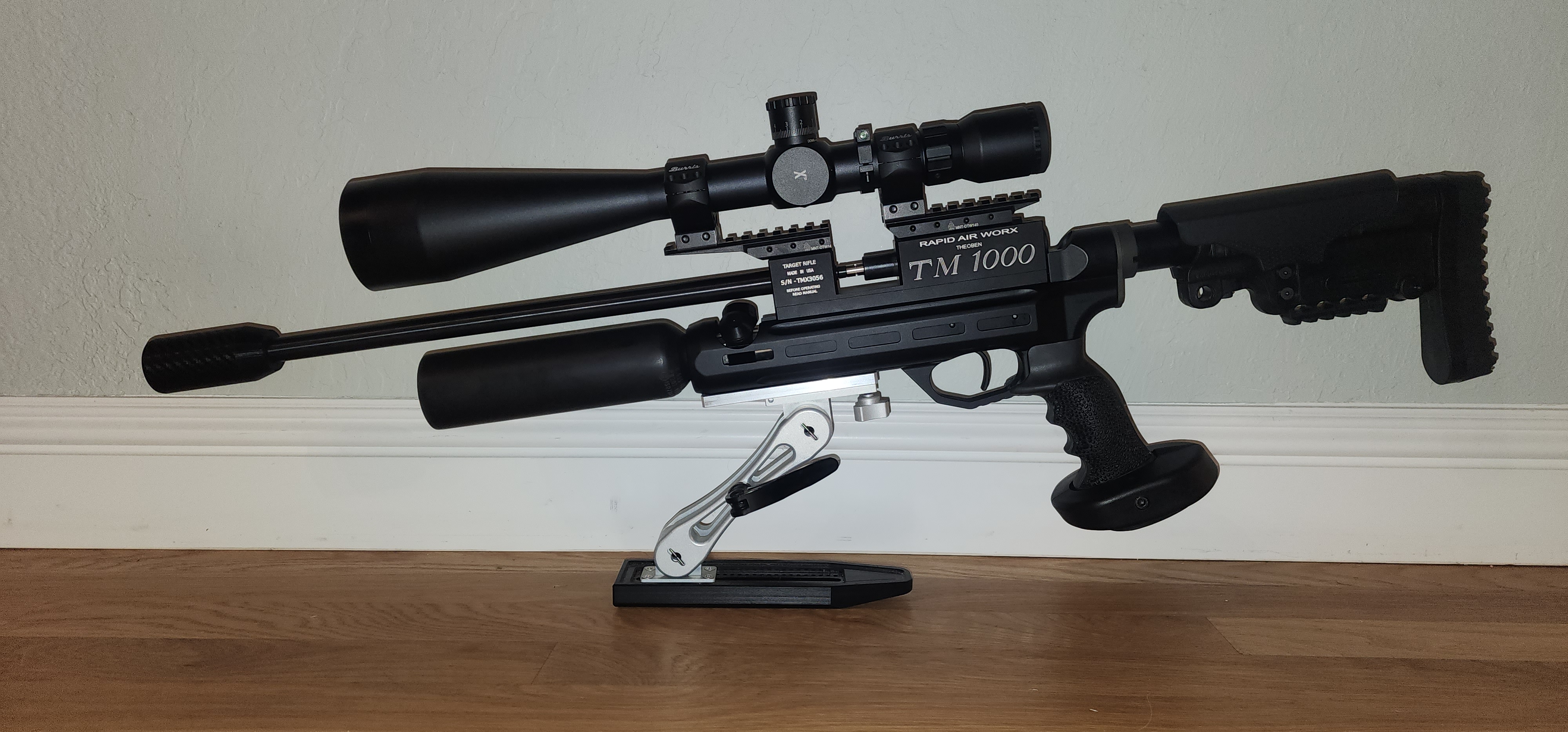

Is that an aluminum air tank on that rifle? A CF bottle would shave off 10 oz.
The difference is roughly 6 oz between the 220cc carbon fiber bottles and this aluminum one.
Not a big enough difference for me to worry about it. And with my tuning ability I'm able to get a ton of shots per fill with this small aluminum bottle.
I would say at 12fpe a user gets lots of shots as it comes from the factory too.

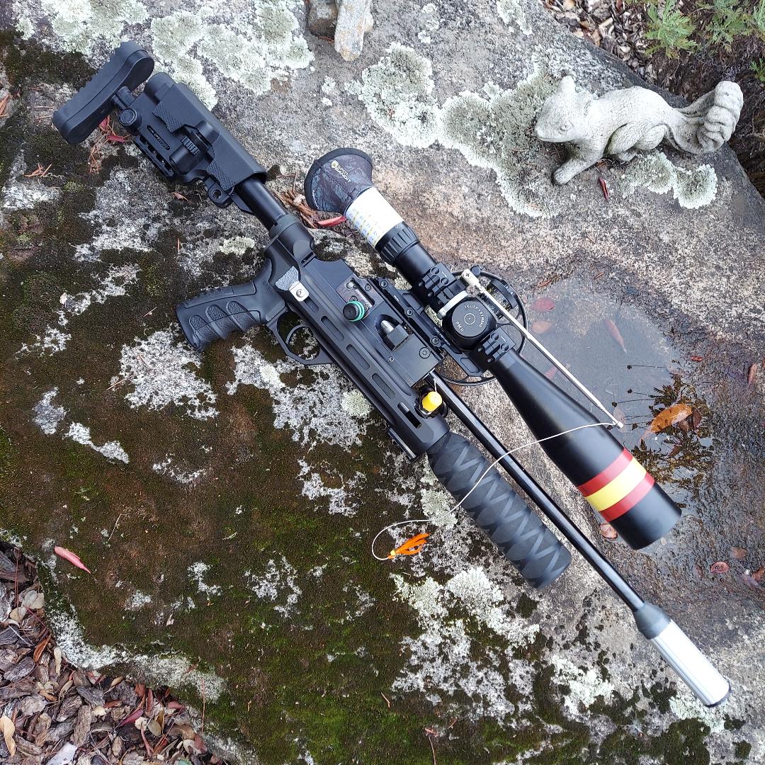

I just received my new tm1000 from Rapid air worx.
When I received the gun it was set up for 12.1 FPE all I had to do was back off the hammer spring a half a turn to bring it where I needed it. I filled it to 200 bar and shot 36 shots over the chronograph, looking at the pressure gauge I only dropped 25 bar. It appears this gun will get roughly a hundred shots or just under per fill.
It's is a real sweet setup. Just got a scope mounted last night, I made a uit rail for the m lock system, installed some modified dovetail to picatinny adapters and this is almost exactly how I'll be shooting it in competition.
I will be installing a proper butt plate, a kneecup style hamster shelf and one of my magnetic detachable side Wheels on the scope. The scope is the brand new falcon X 505 ft which I will be testing to see if it is something I want to use this season.

I requested this gun to come to me set for 12fpe. It technically can shoot every class, but this setup is particularly for WFTF Rifle and Pistol FT.
The gun will come in a higher powered configuration as well. Plans are, I'll have dual spring cartridges that allow for both 12fpe and 20fpe. Which would allow you to shoot open class and hunter class power levels.

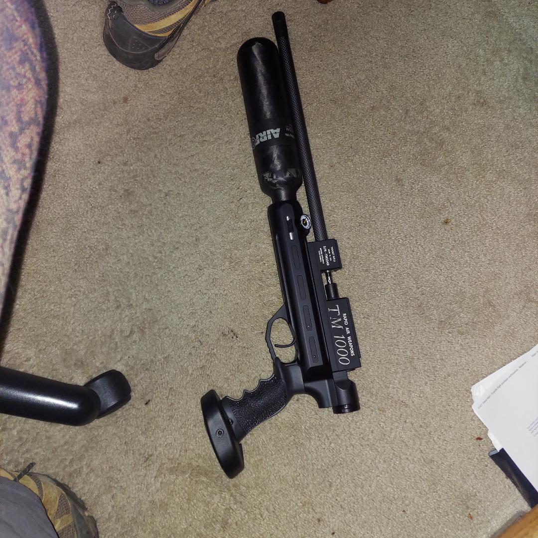

Just received this ... TM-1000 FT Pistol.
It is for a customer who wants all the RAW / THEOBEN tuning tricks applied.
This should be interesting & productive ;)
Factory has opted for the barrel to be a total of <15" including an LDC threaded adapter.
Full length Carbon Sleeve. Customer requested full size 480 cc bottle = LOT of shots :love:
TM receivers must be in low supply as it is marked Weapons and not Werks ( RAW )
All the internals are current Airforce/ RAW specification.
Was this a pistol that you added a stock too or did you get it as a rifle?
