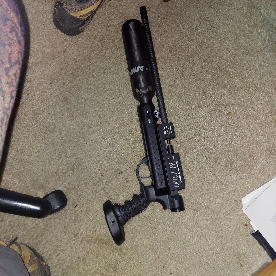

I just received my new tm1000 from Rapid air worx.
When I received the gun it was set up for 12.1 FPE all I had to do was back off the hammer spring a half a turn to bring it where I needed it. I filled it to 200 bar and shot 36 shots over the chronograph, looking at the pressure gauge I only dropped 25 bar. It appears this gun will get roughly a hundred shots or just under per fill.
It's is a real sweet setup. Just got a scope mounted last night, I made a uit rail for the m lock system, installed some modified dovetail to picatinny adapters and this is almost exactly how I'll be shooting it in competition.
I will be installing a proper butt plate, a kneecup style hamster shelf and one of my magnetic detachable side Wheels on the scope. The scope is the brand new falcon X 505 ft which I will be testing to see if it is something I want to use this season.
