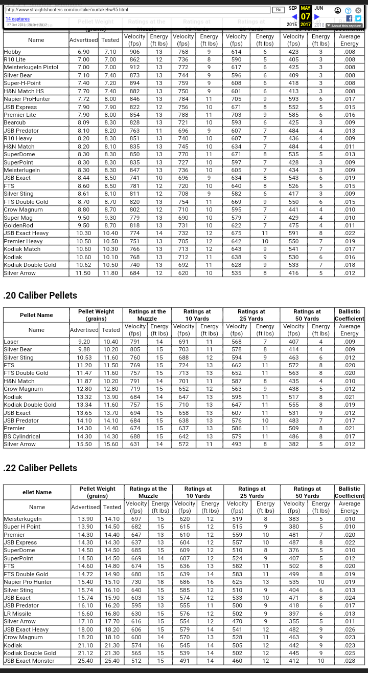

Hello all. Getting some conflicting information. Brand new Weihrauch HW98 .177 arrived from AoA. Test sheet shows 5 shot avg. @ 11.7 fpe(JSB 8.44 @792fps). I was expecting a bit more pep from a full power export. AoA assured me this was correct, and a non FAC rifle would be 8.5-9fpe. Anyone have chrony numbers/info to share on a stock 95/98 .177 rifles? Thought I had a pretty good grasp on the powerplant. Maybe the piston seal needs shot in? Thanks for any information.
Then here the 8.84 is testing at 741 ( muzzle) hw95
