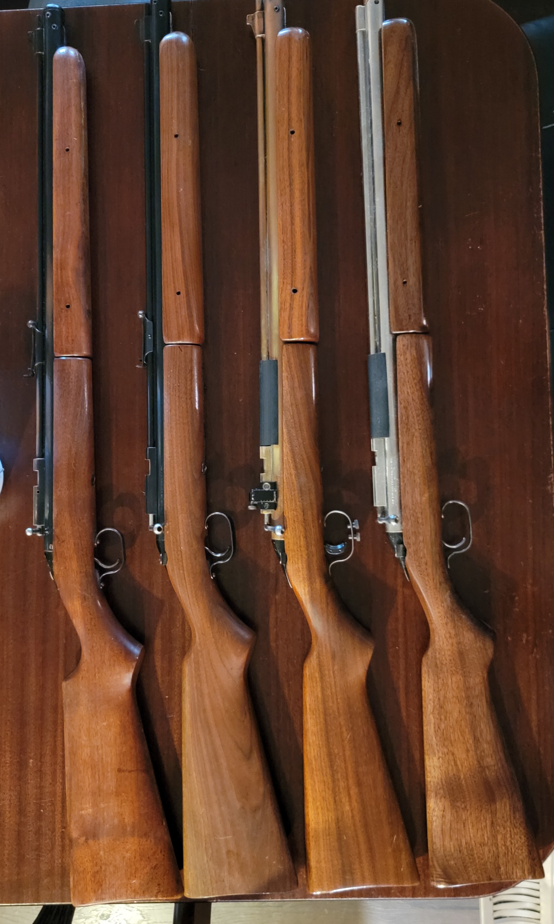

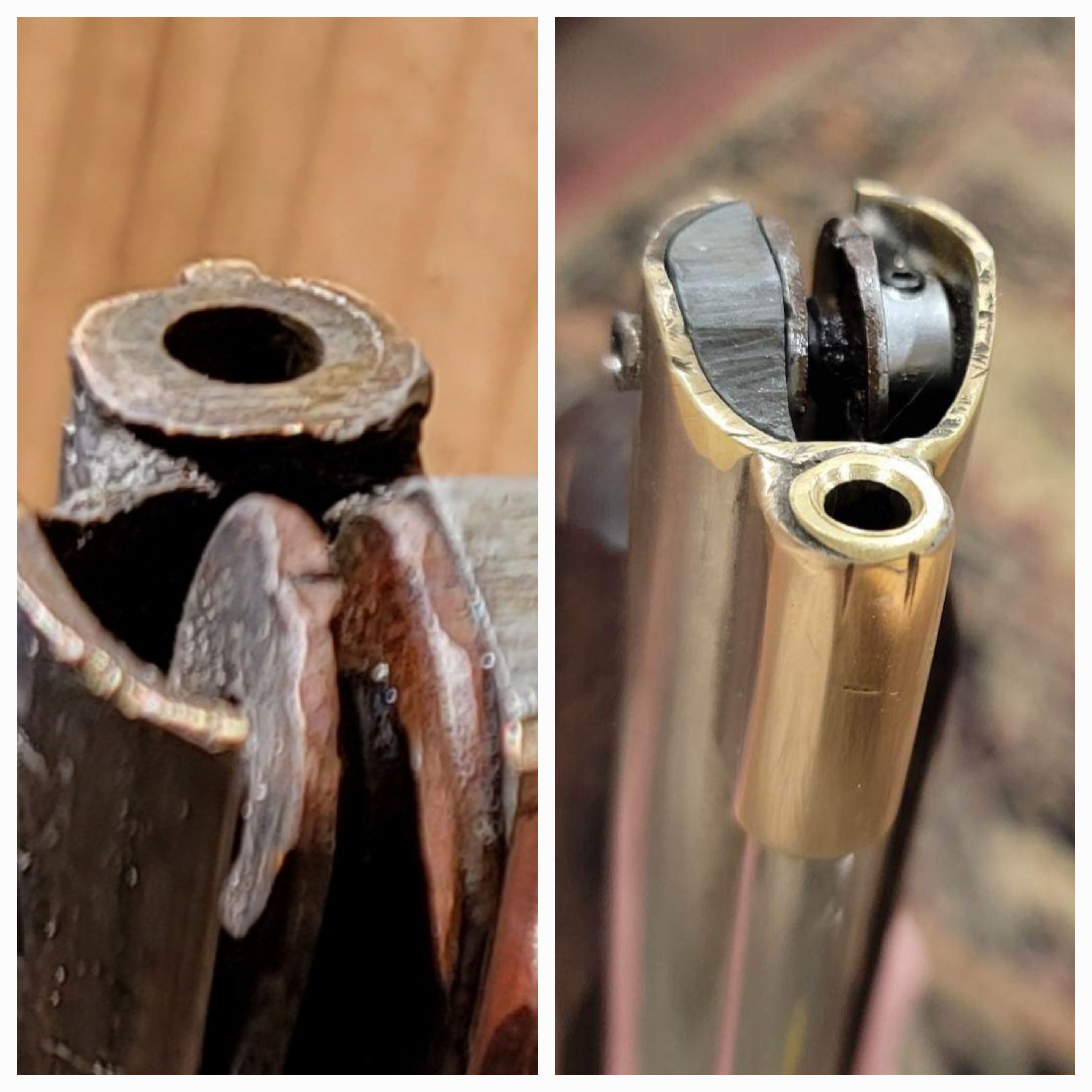

I have four Sheridan's, from 1955 to 1971, and ony one was abused. It's barrel was cut off by a cave man. At least it looked like cave man tools were used.
After a re-square, and re-crown, it shoots as good as any..
I can't say that their barrels are capable of precision accuracy, because of the lack of precision in the MPP platform, but they are amazingly accurate plinkers with oper sights.
