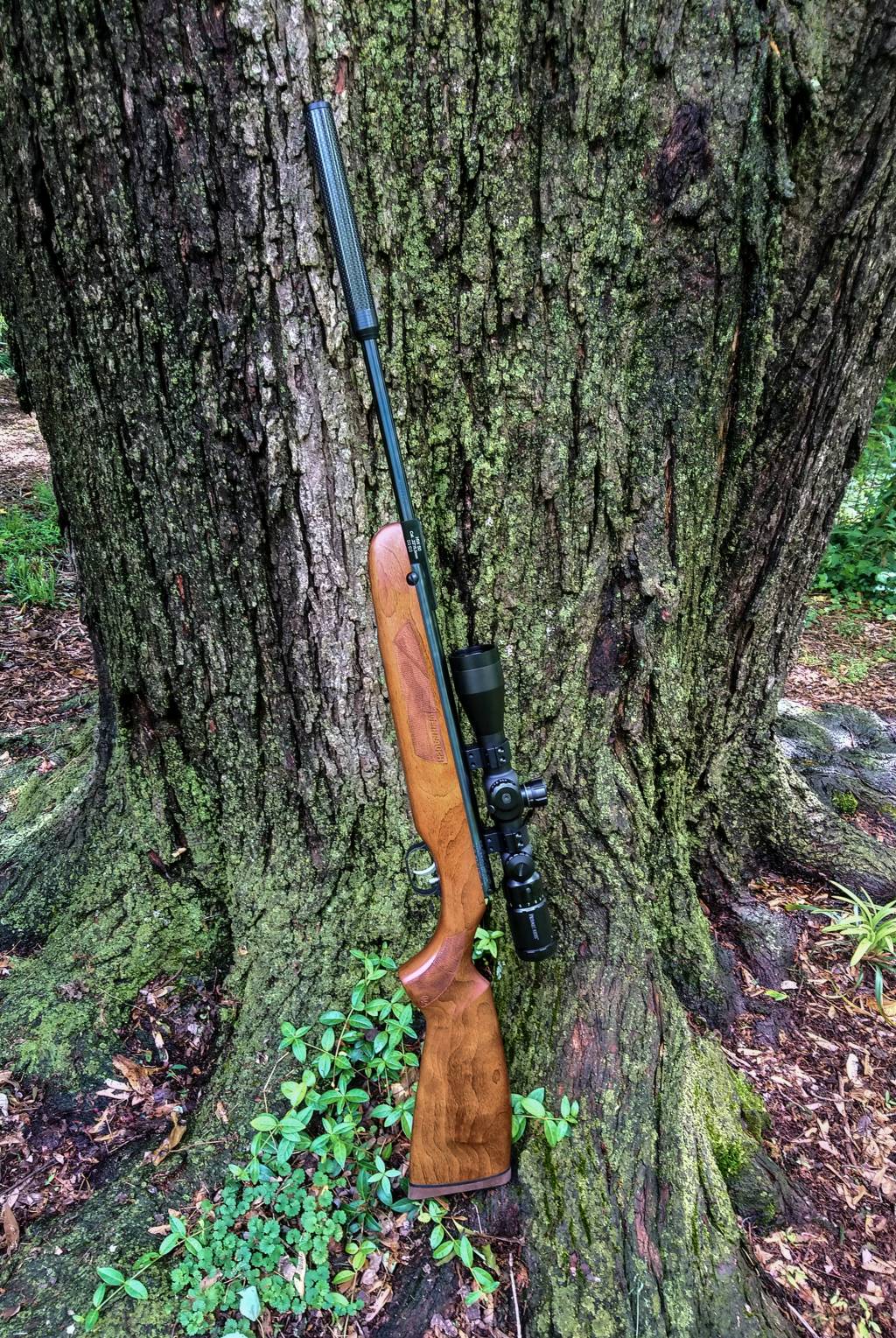

Also agree with Odoyle that an HW30 is a great choice. I have 2 (both .177), one is an AoA Urban Pro with moderator the other open sights and plain stock. Both are quiet enough for the backyard. A quiet backstop/pellet trap might be a bigger issue than the report of an HW30. I also shoot a moderated HW50s in .22. It is bit louder but not much than an HW30.
