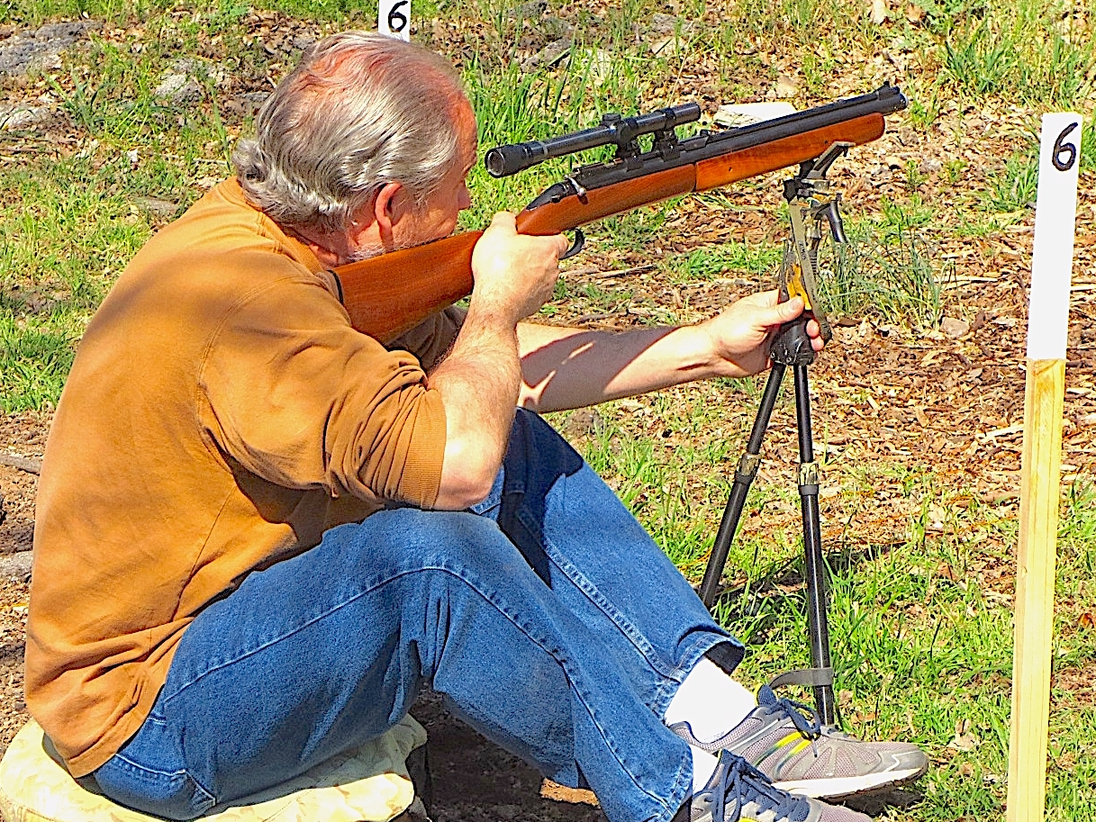

I don't want to discourage you but unfortunately, we rarely see Crosman type pumpers, single stroke pneumatics and/or CO2 used in FT for air rifle. Mainly because all three would be competing in the PCP class for rifle.
After re-reading the pistol rules again, I think in pistol FT there are only two classes: hunter and unlimited ...someone correct me if I'm wrong. (It's not divided into PCP and Piston like air rifle)
Air Rifle
For air rifles, main reasons most don't shoot pumpers or CO2 are that PCP are so consistent and accurate. Plus right now some PCP are just so darn "inexpensive" when you compare group size/dollar spent.
However, I have heard of some skilled gun smiths/ shooters who were successful with pumpers. Usually their rifles have highly modified pump valves, modified pump assist linkages for easier pumping (like the dragonfly), switching the barrel out to a competition barrel etc.
CO2 unfortunately are temperature sensitive platforms. Since we shoot mainly outdoors, CO2 is not ideal for Field Target. Some have attempted to overcome this by modifying their rifle to shoot HPA. Depending on your skill level as a gun smith, that might be the way to go.
I had my phase for 3-4 years when I tried to modify a Benjamin Sheridan to shoot FT. Then the FX independence came out in 2016? (since discontinued). I finally decided it was just cheaper and easier to buy and shoot an Air Arms 410.
If you have your heart set on pumpers...I think the Seneca Aspen and the Dragon Fly are two possible options. I have a feeling both may need to be (highly?) modified to shoot FT. Because FT demands a high level of precision and consistency. Your high wear components need to be modified because minimally, you are pumping 3 pumps/shot. In a regular 60 shot match that's 180 pumps not counting sight-in and practice at home. Three pumps/shot was arrived at during my Benjamin Sheridan phase (the goal was 11-12 FPE/shot). Their dump valve design may not be the most efficient or reflective of current valve design. With an onboard storage tank and a regulator, you might be able to reduce #pump/shot. If you dig thru the airgun pumper history, hopefully you can find some of the work attempted. Try the old Yellow forum...there was a guy name Scott in Washington state doing a ton of mod for pumpers.
For my Tx200 springer, practicing at home, I'm going thru 1 tin of (500 pellets) every 2 to 2.5 weeks. That's 1,500 cycles for a pumper in 2.5 weeks, most unmodified Crosman pumpers would be lucky to survive that kind of abuse after 1 year.
But that's just me shooting springers...I need to practice my hold and trigger control...you shooting pumpers, maybe not so much shooting/practice (plus I sux shooting springers).
I think I should stop here... I know it can be done. Maybe those with experience can chime in and provide a ray of hope (I don't remember or know of anyone using a single stroke pneumatic to shoot FT...I'm sorry if I hindered you by providing my personal doom and gloom analysis...)

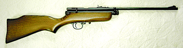

I have shot a 1377 in pistol class field target. It is more work than necessary. I have seen a few multi pump benjamins, but those shooters never return. They would be in hunter pcp class, since no recoil. As long as your gun meets power limits, they will put you in a class. Very few piston class shooters anymore, you may be in a class by yourself.

I've shot a Sheridan multi-pump rifle In Hunter class, taking all but the most difficult shots offhand. It was fun, but I finished in the middle of the field.
And I converted a 1960s vintage Crosman (187) co2 rifle that originally sold for $21.95 into an HPA pistol for Hunter Pistol Class field target. That pistol (conversion) has three State and three National Champion titles to its credit so far; not only a good example of airgunsmithing possibilities, but the depths of depravity of one answering to such aliases as The Manic Compressive, Og, and That Damned Neanderthal!.
The Crosman 187 field target "pistol" before conversion (aka- $21.95 Crosman 187)-

Which begs the question, at what point does 'lively imagination' wander into 'he ain't zactly right' territory? Hard to say...
But we certainly have a few examples now!
