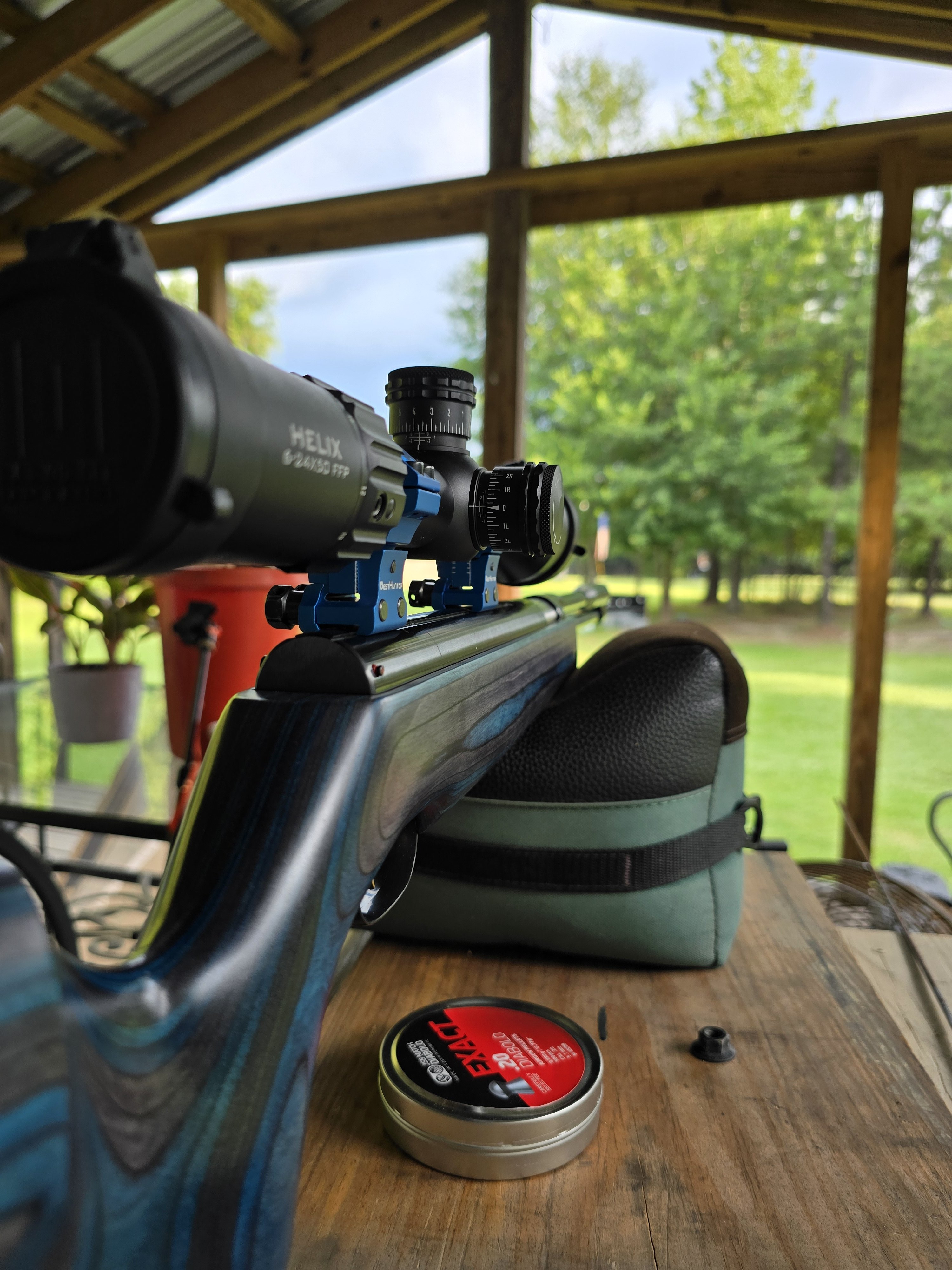

Picked up a blemished HW97K from Pyramid Air just over a month ago, stock had one small mark underneath and that was it, it looked brand new. I mounted a Hawke scope with 2pc Sportmatch mounts and sighted in at 35 yards. Tried several different pellets, one day gun would like JSB's and then the H&N FTT ammo then Crosman Premier 7.9's.
Was kind of all over the place first 500 rounds but still decent accuracy as gun was breaking in I got the occasional dieseling. Stock screws kept coming loose and were loose when I received gun from PA, the pin that holds the cocking lever latch in place kept backing out, and a little green lock tight took care of that.
I ended up removing stock and hardening wood around stock screws with some thin Mercury Adhesives CA and this solved the loose screw issue.
After about 1000 rounds I made a slight adjustment to trigger and it's right at a crisp one pound. I ran over chronograph and gun really settled in nicely and to my surprise likes Crosman Premier 7.9 gr the best, velocity is very consistant hovering right around 900 FPS, I also noticed long range accuracy at 75 yards is outstanding with the Premiers, these little pellets shoot a full mil dot flatter at this distance compared to the same weight JSB and the heavier H&N's. In past years the first thing I would do is tune any springer I purchased with a kit but the more I shoot this gun the smoother it gets with less and less spring twang. I really see no need to take this springer apart, just needed a few tins of ammo shot through it to break in. Just curious what gun will be like with say 5K rounds through it. I have several springers and quality PCP's but am really enjoying the 97 right now.

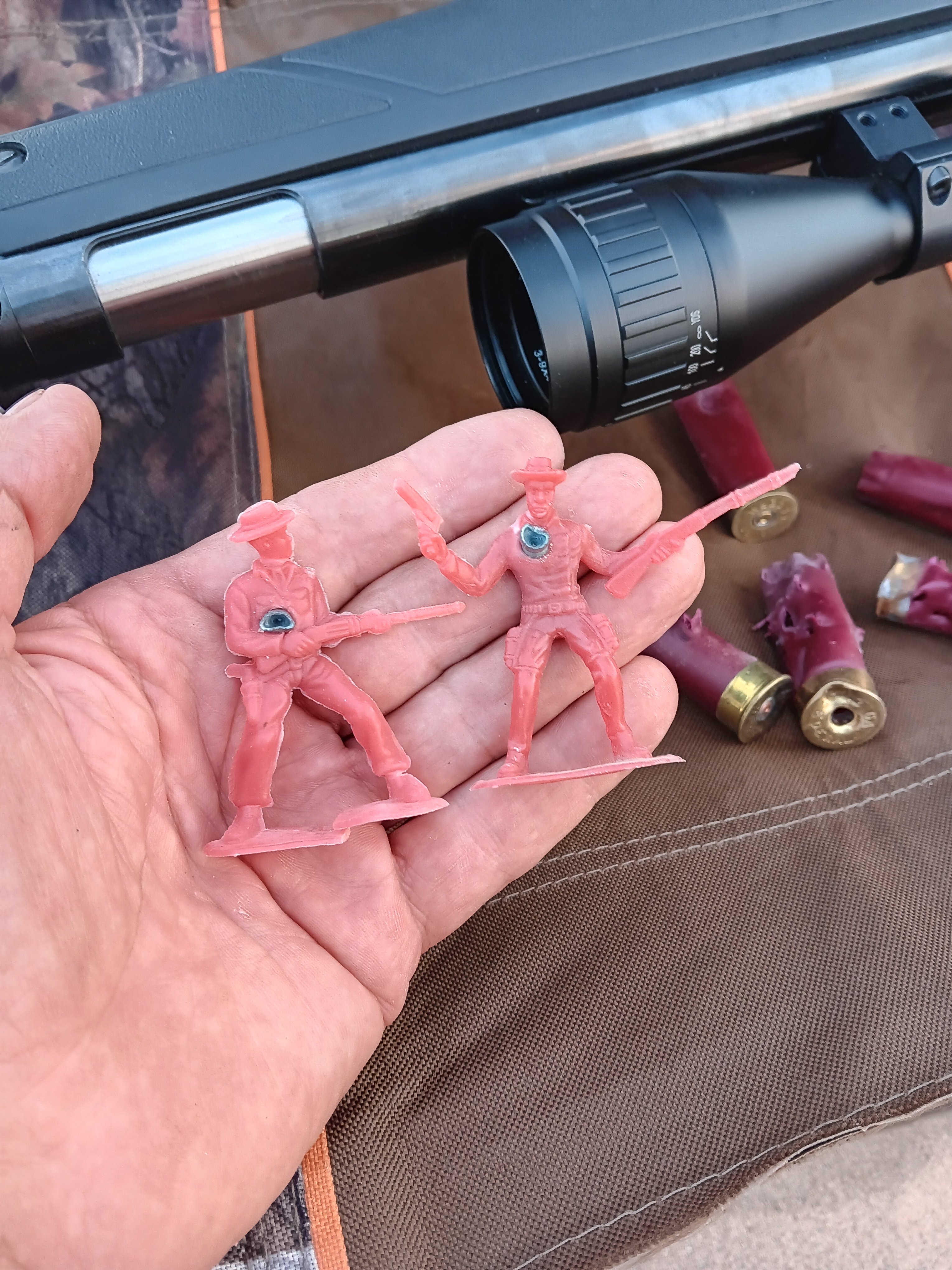

The rifle is a freaking hammer. I love it. Shotgun shells at 80 and little plastic outlaws at 50. Just one right after the other.

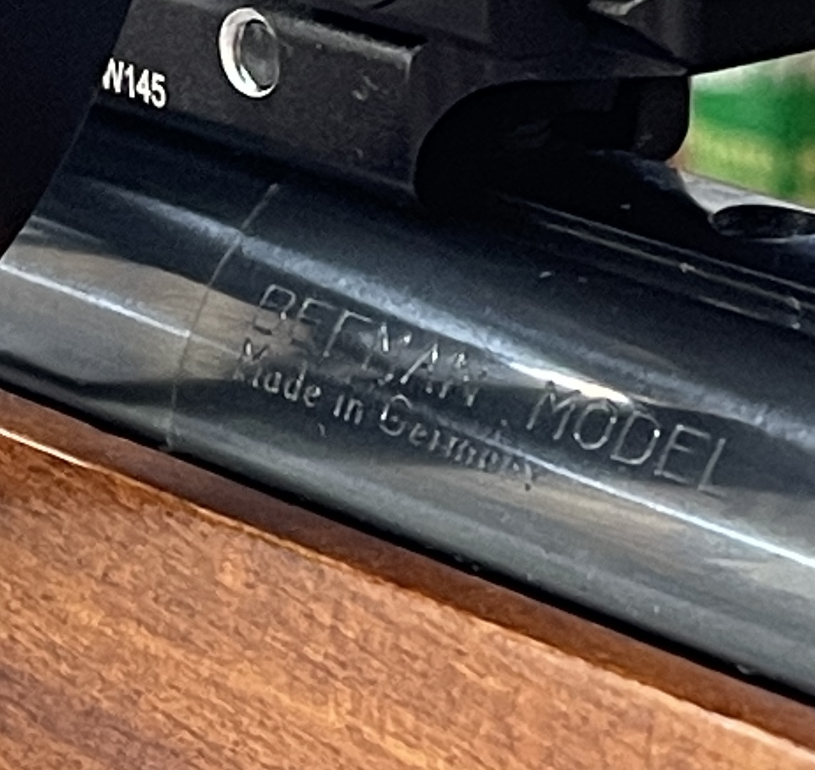

The 97K is a hard to beat spring piston rifle. I bought mine 2007 for $499 at Straight Shooters.
It's a Beeman model with Huntington Beach CA on the right side.

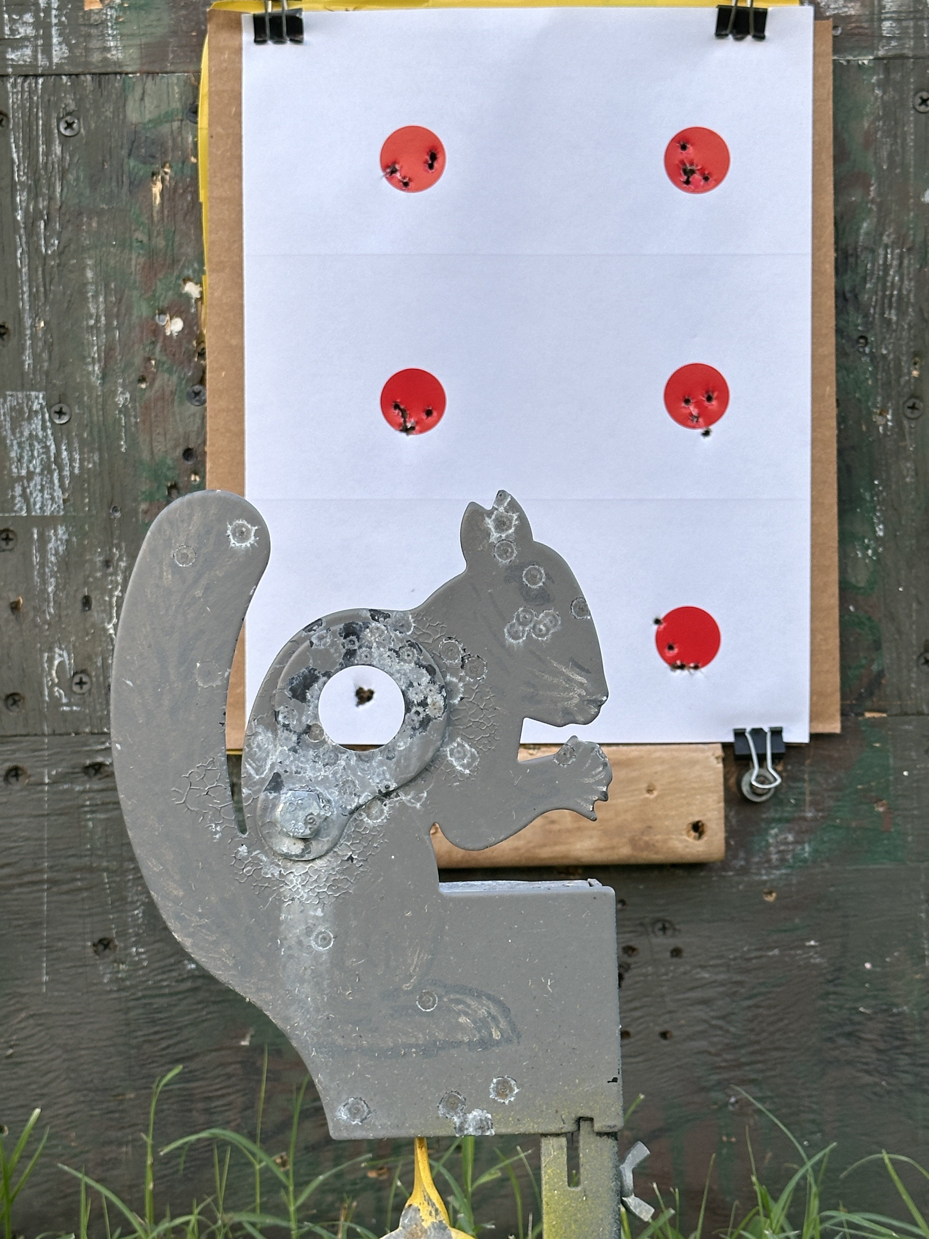

Here a target shot the other day at 40 yards rested on bags with QYS 8.48's and using a $125 Hawke 2-7X32 at 7power. The red dots are 1.0" diameter.
5-shot groups. The one shot thru the squirrel KZ is 4 shots, at about a 1/4 diam.

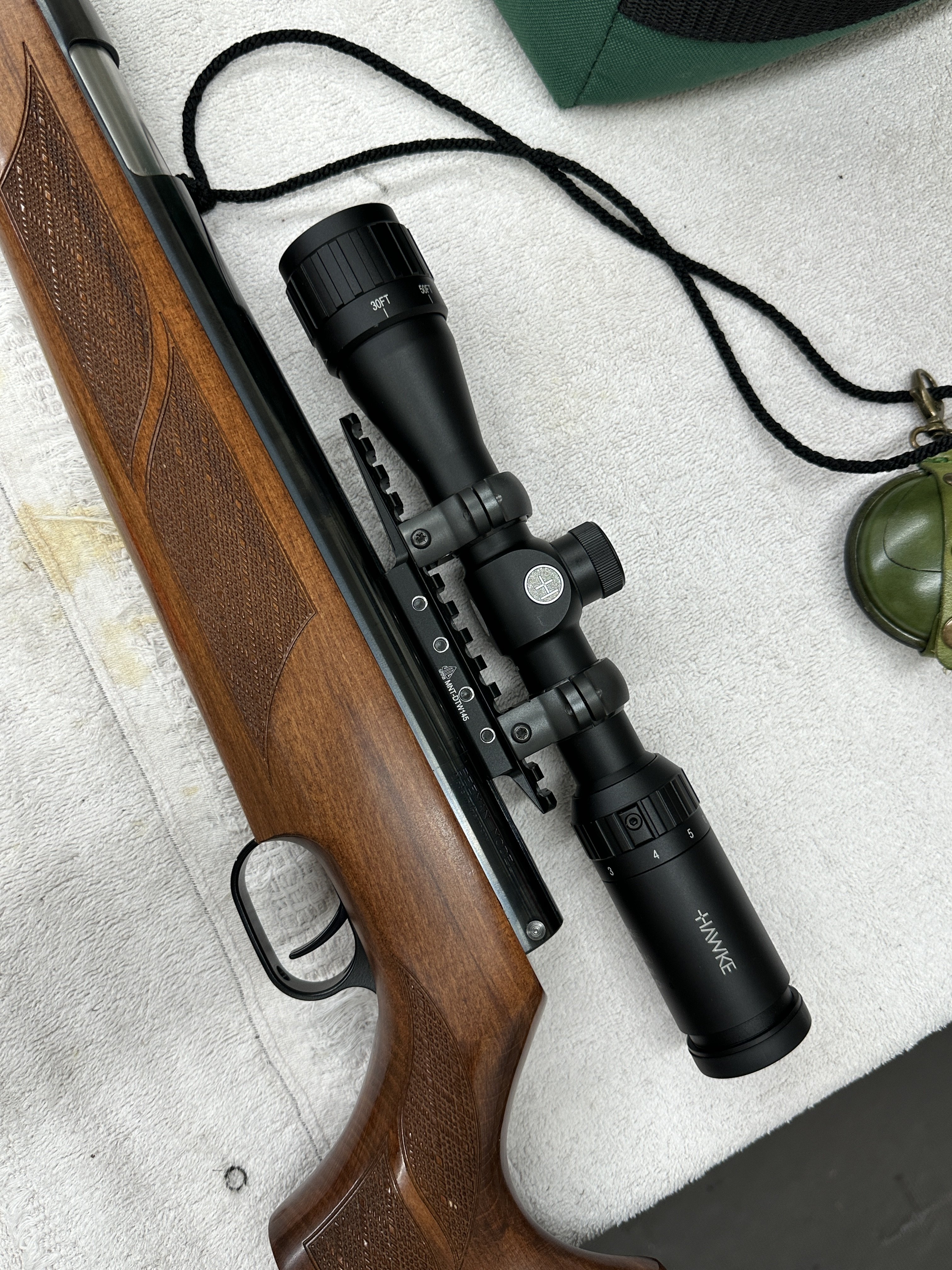

I've had my 97K set up with about 8 different scopes over the years, from "high dollar" scopes to the one I have now only $125, and they all worked great. I'm kinda digging this little light weight Hawke at less than a pound right now.

I shoot the same rail with the same rings and the same scope on my Hatsan rifles (I'm assuming those are Burris steel z rings. If not they are just like them).
That's a rock solid setup.

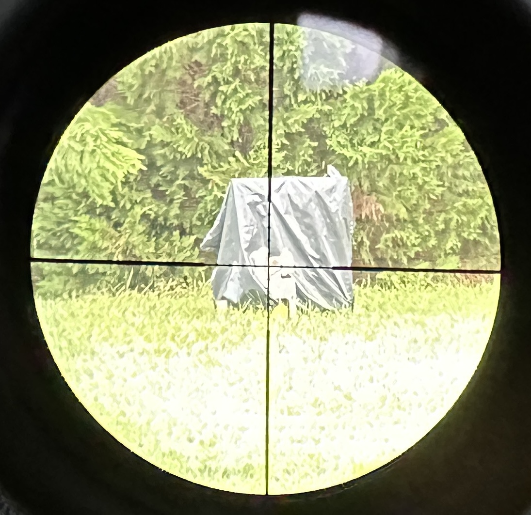

This one would be good for hunting or desert scrub brush I suppose, a little thick for fine target work, but it makes it more challenging.
Not the best picture, it's a mill dot, and not bad.

Reloaded a much better picture of the reticle in the upper post, ⬆️ you can see the small mill dots on this one.
