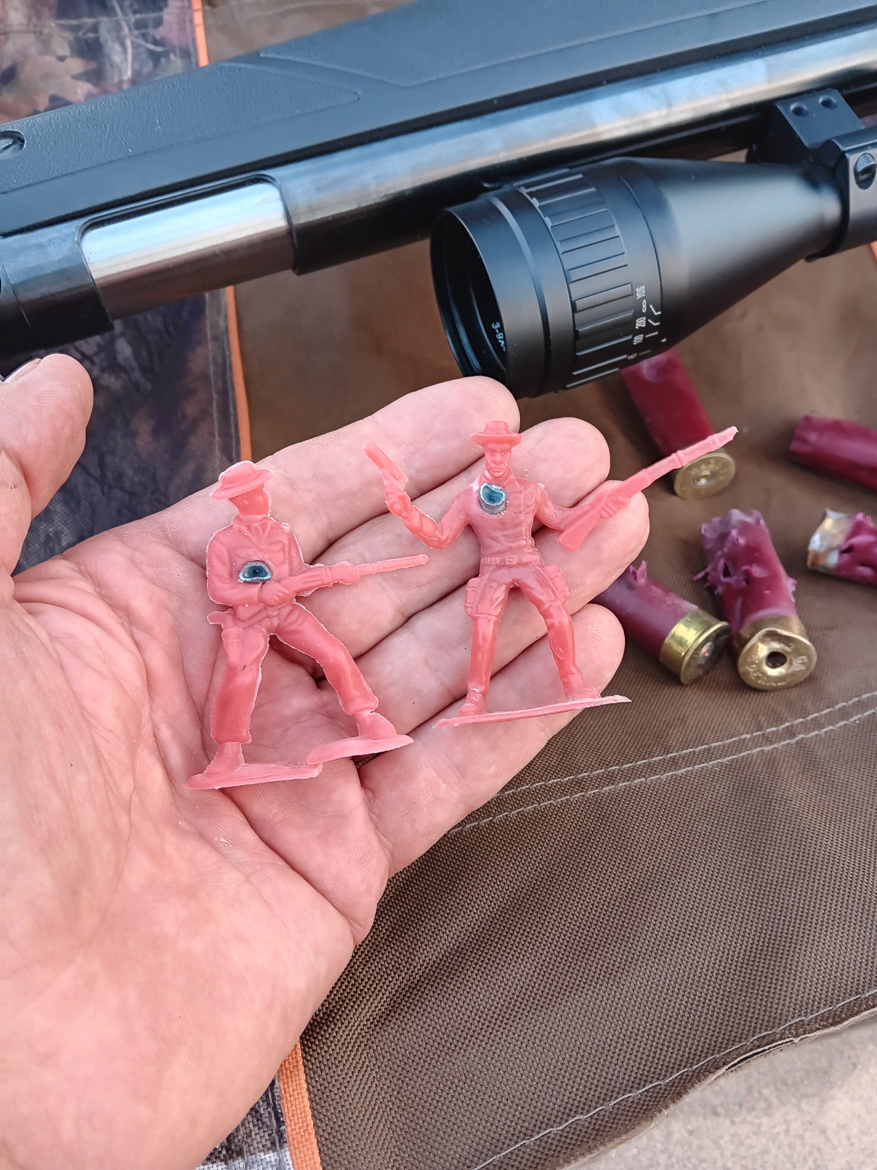

The rifle is a freaking hammer. I love it. Shotgun shells at 80 and little plastic outlaws at 50. Just one right after the other.

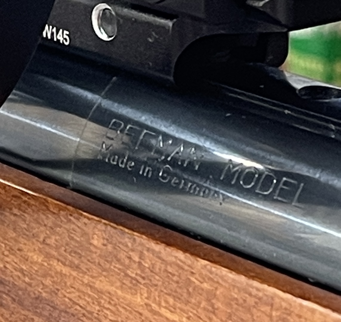

It's a Beeman model with Huntington Beach CA on the right side.

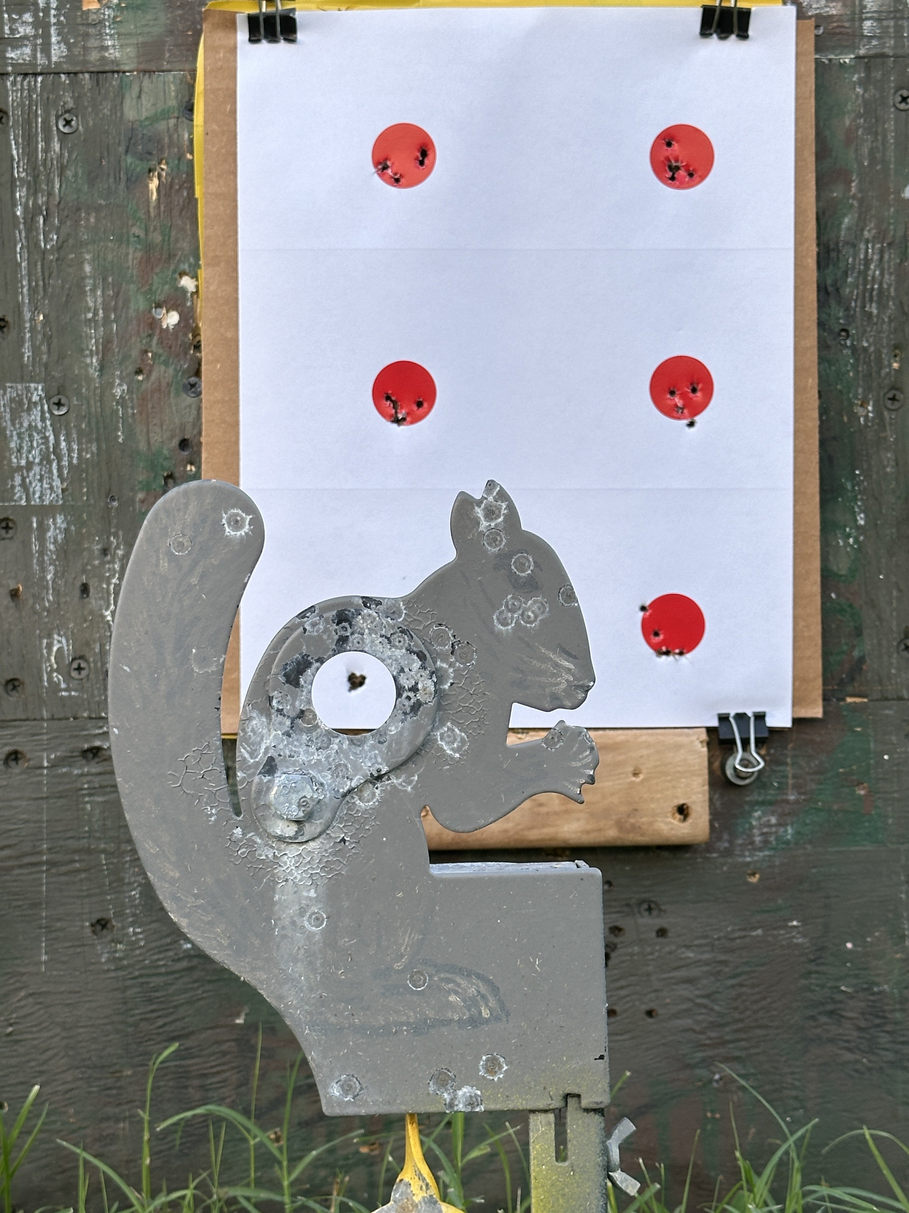

Here a target shot the other day at 40 yards rested on bags with QYS 8.48's and using a $125 Hawke 2-7X32 at 7power. The red dots are 1.0" diameter.
5-shot groups. The one shot thru the squirrel KZ is 4 shots, at about a 1/4 diam.

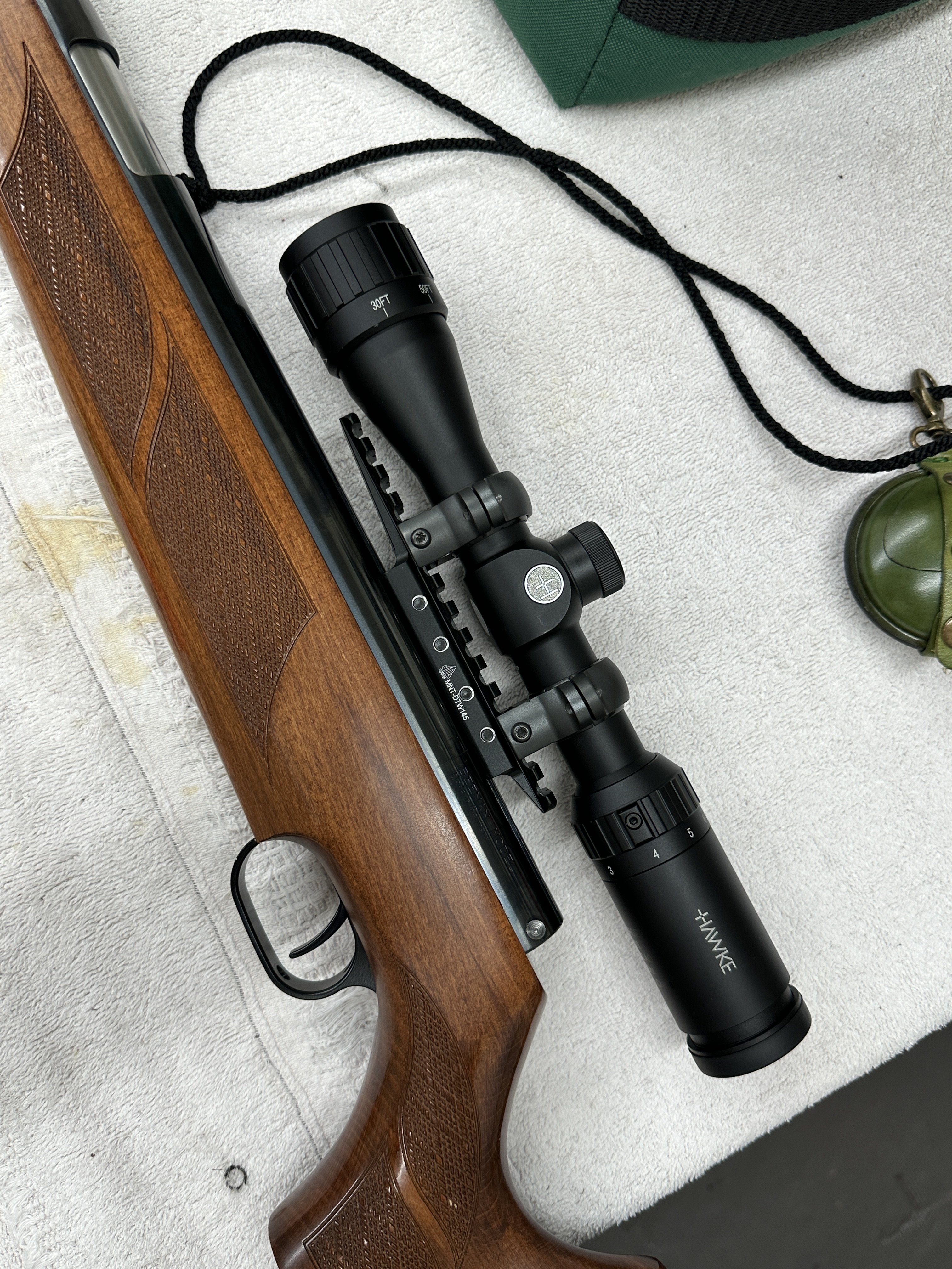

I've had my 97K set up with about 8 different scopes over the years, from "high dollar" scopes to the one I have now only $125, and they all worked great. I'm kinda digging this little light weight Hawke at less than a pound right now.

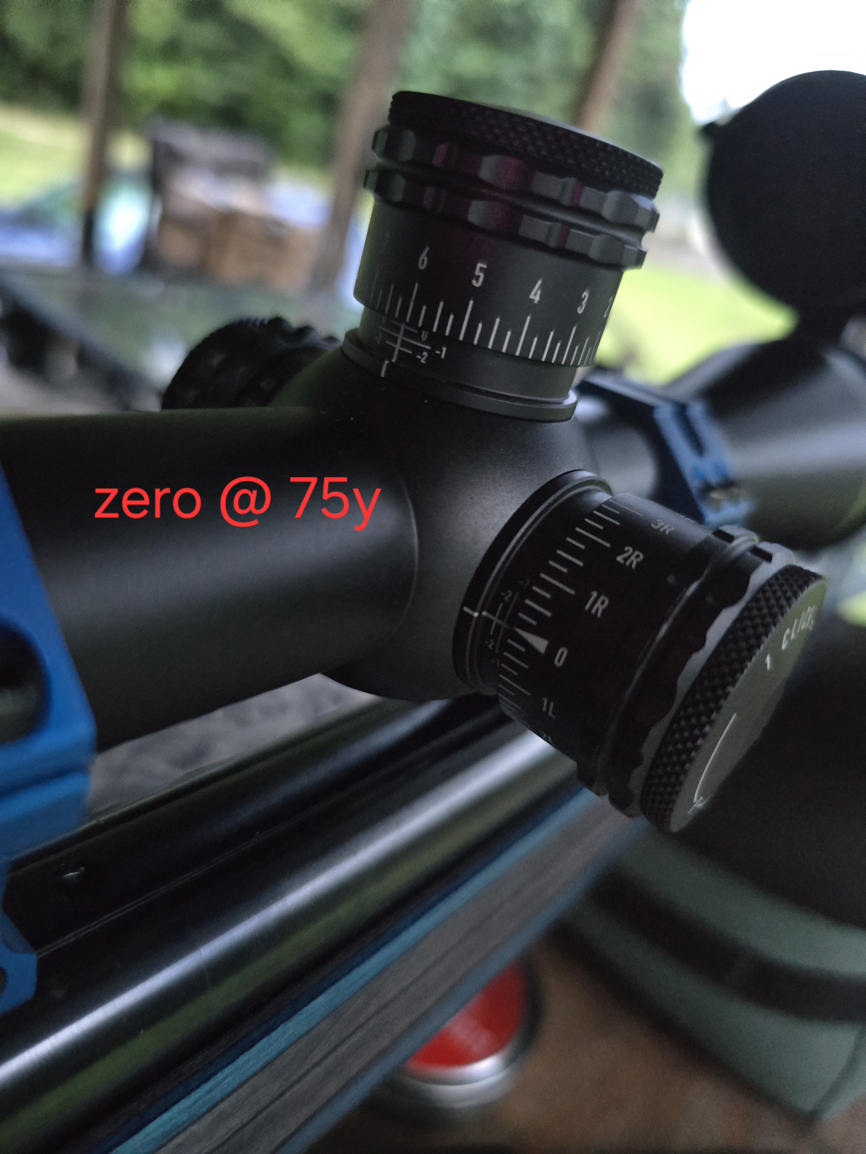

You're right about centering. Here's a pic of my turrets zeroed for 75y. The arrow on the windage turret is the scopes optical center. It went right back to center after the warranty work, and having the scope zeroed on a different gun.

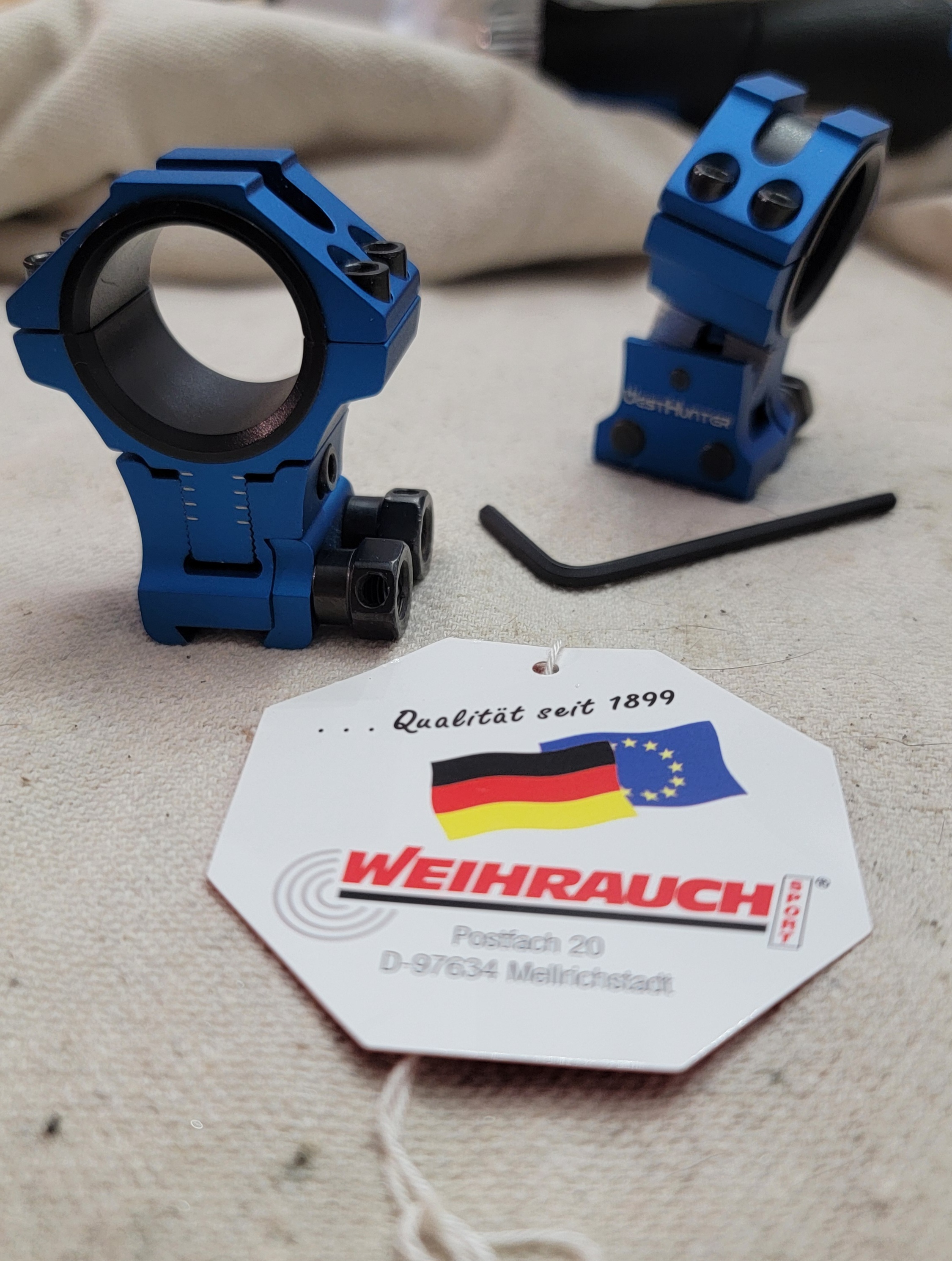

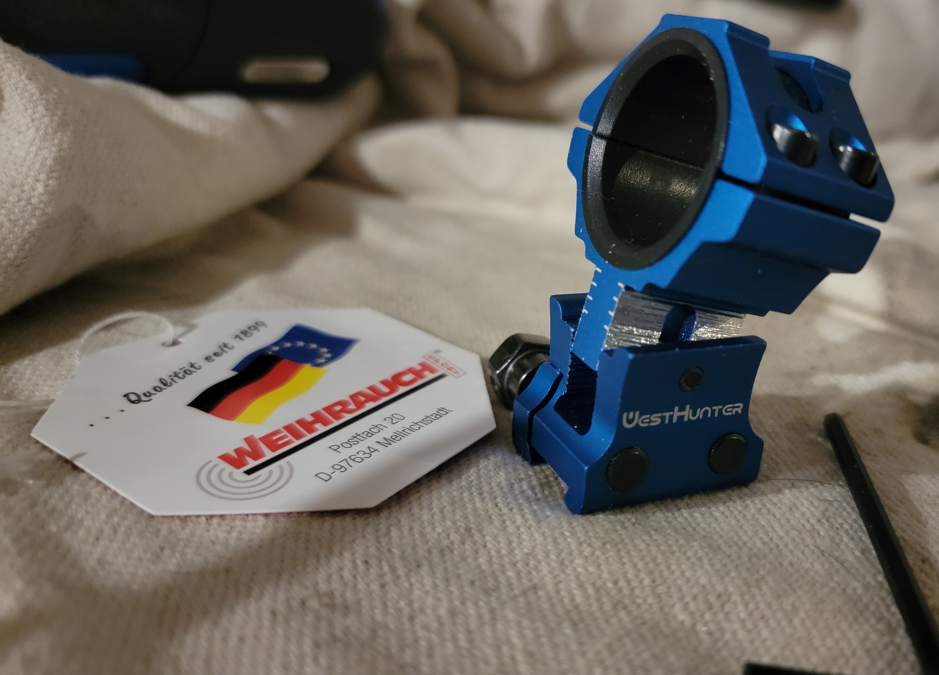

I modified my rings to allow moa adjustment.
Then I set the scopes optical center between my to backstops 30y and 75y. So now it takes an equal amount of up past center at 75y, as it does down past center for 30y. This is my effort to stay away from the internal scope stops, especially on a springer.

That's a great job on those rings! I've never seen anything like that.
I did a set of cheap rings with resin as an experiment. I bedded a scope at an angle. It worked great. Held tight. Kinda the same idea as yours but uglier and not nearly as professional.

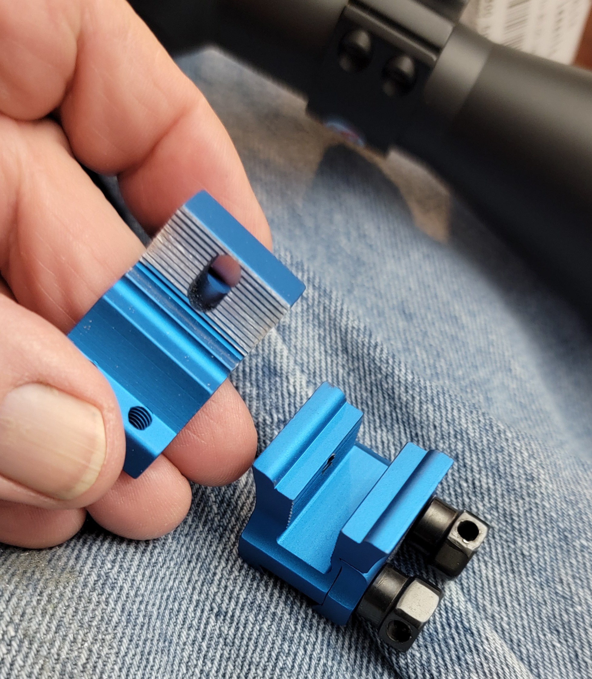

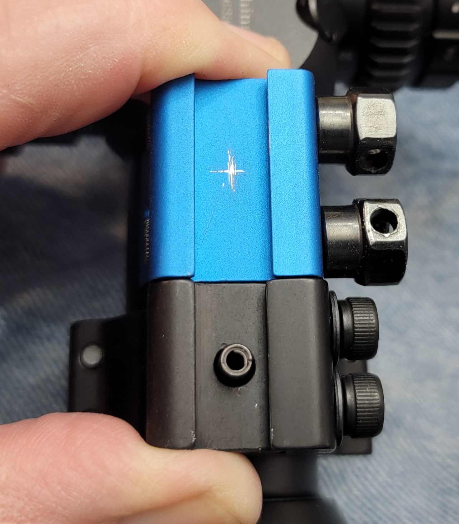

I thought that those rings would work like that when I bought them, but ithey turned out to only be adjustable scope height rings. I cut the grooves down with wet paper to convert them.
It's pretty easy to add a pin if you like, but they don't really need it.
I had posted an article here called, Modifying West Hunter Rings, at the time.
