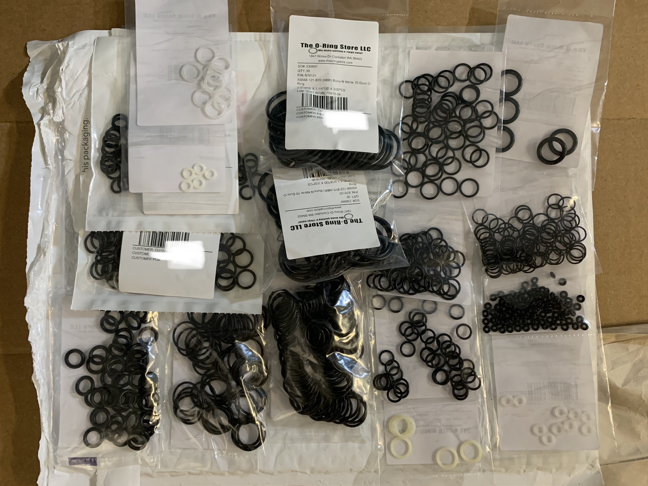

@RatAssassin $10 for two o-rings is ridiculous and Crosman is out of line for that. The O-Ring Store came recommended by several AGN members. This bundle cost me about $85 shipped. This is probably around 1000 o-rings.
Cool. Could you perhaps share a part number or how you ordered from this company?
I need the orings for
.22 and .177
It sounds like they are all the same size if I am not mistaken.

@RatAssassin I don’t have the guns that you have. I did a lot of looking at exploded diagrams, parts lists for different guns, and reaching out to other members with questions about numbers that I didn’t understand or was too frustrated to understand. After about three days I compiled a list of what I needed and a lot of what I was looking for. You’ve received some solid advice in this thread.
I suggest that you do a little more leg work. Maybe start by measuring o-rings that you can hold in your hand and record their size(s). For the others consider reading the exploded diagrams and parts lists that manufacturers publish online and in their instruction manuals.
To order from The Oring Store go to their website and search for the o-ring durometer (hardness), material (generally Buna nitrile), and the size needed (this should be on a parts list or exploded diagram). It helps to know if you’ll be ordering metric sizes or standard sizes. A lot of airgun o-rings I’ve encountered or read on lists are Buna 70 (nitrile). Some have a minimum order quantity that need to be purchased (for example you may have to order a minimum of 10 of one size and 50 for another instead of the one or two that you may need immediately). Then the checkout process is pretty much like most other online vendors. Be mindful if something is not in stock, it may hold up the shipping of your order.
Here’s a link to their website https://www.theoringstore.com/store/
