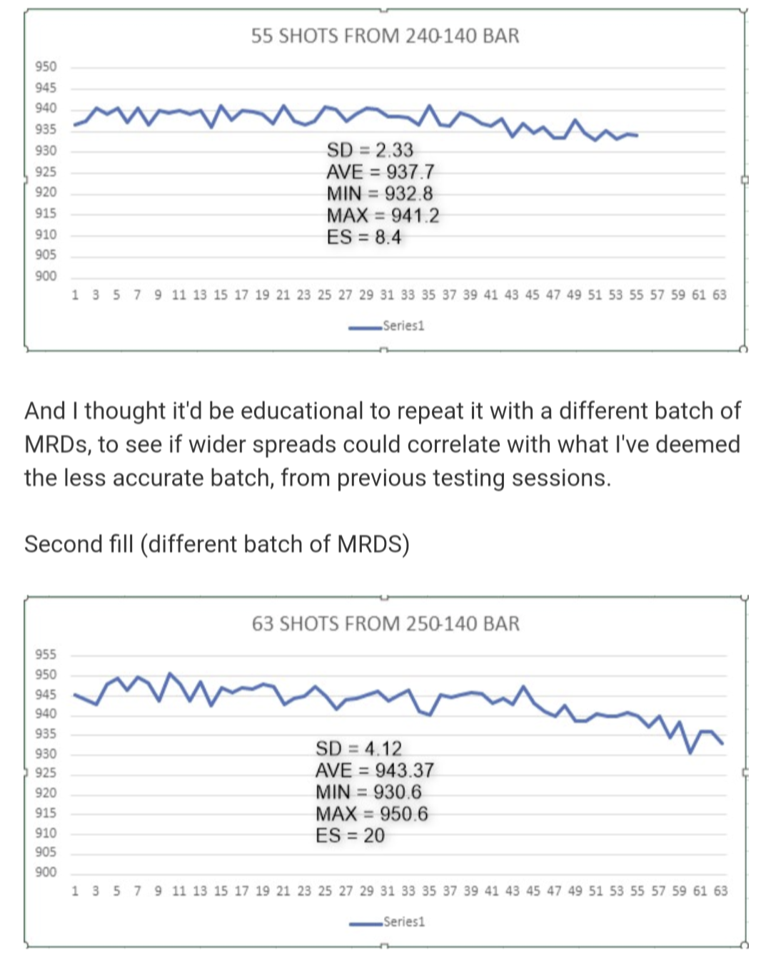

This is right @ 50fpe (25.4 @ 940fps)
480cc bottle
