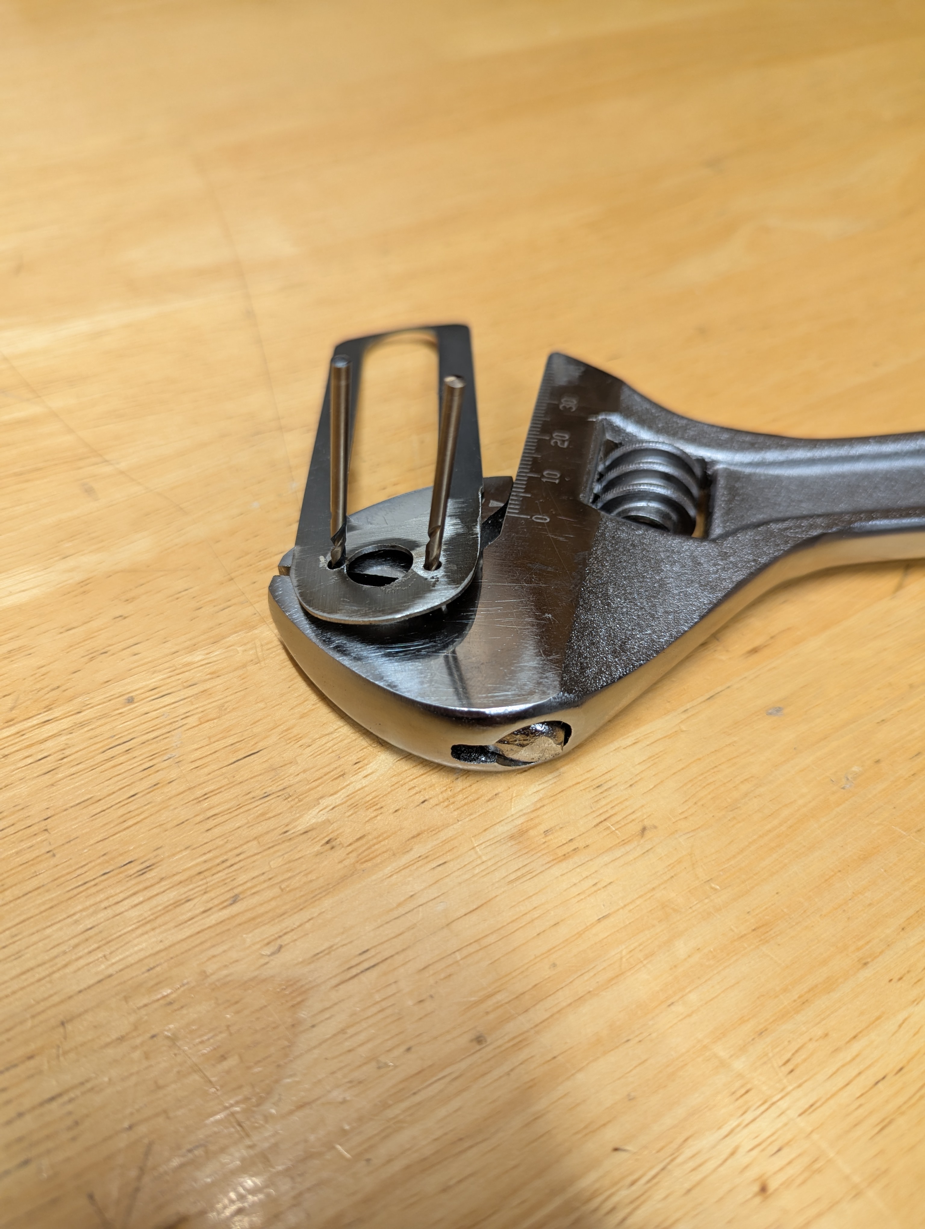

With no air in the gun, the valve stem should be pretty easy to depress. Here's a short little clip of what that looks like with a valve out of the gun...
Easily depressed with thumb alone. If it's taking more than that, you got a problem....and that problem could be that the gun actually still has air in it (gauge isn't reading correctly) or that your valve stem is in a bind somehow (bent?).
I've personally avoided the degas by firing method for awhile now....every leaky valve I've had happened shortly after a tuning session where I needed to drop the reg and emptied the gun of air by firing a bunch of times. Coincidence? Possibly. But because of that I've been degassing by cracking the manometer slightly. And trying not to need to degas very often.
As for removal of the valve....here's my homemade little tool. It works fine. I've been told that it's possible with just the drill bits (or ideally correct diameter pins) and the crescent wrench. But I prefer using my little scrap of flat metal with holes to kinda secure the pins. The first time you loosen that valve retaining disc will be the hardest. Dunno why but it's over tightened from the factory.
Finally, the leaky valves I've had didn't have any visible defects on the valve stem. One of them I was able to spin the valve stem with a hand drill against the face of the valve where it seats and then got it holding air again. The other required a new valve. Each time I tried to just get a valve stem replacement but AOA replaced the entire valve assembly. And it being like a faucet/shower cartridge, it's just a pull the old one out and pop the new one in situation.
It's interesting that yourz isn't leaking, but seems to maybe have the valve stem (partially?) bound up. I'm not sure the valve is the problem, but we seem to have ruled out the other most obvious culprits.

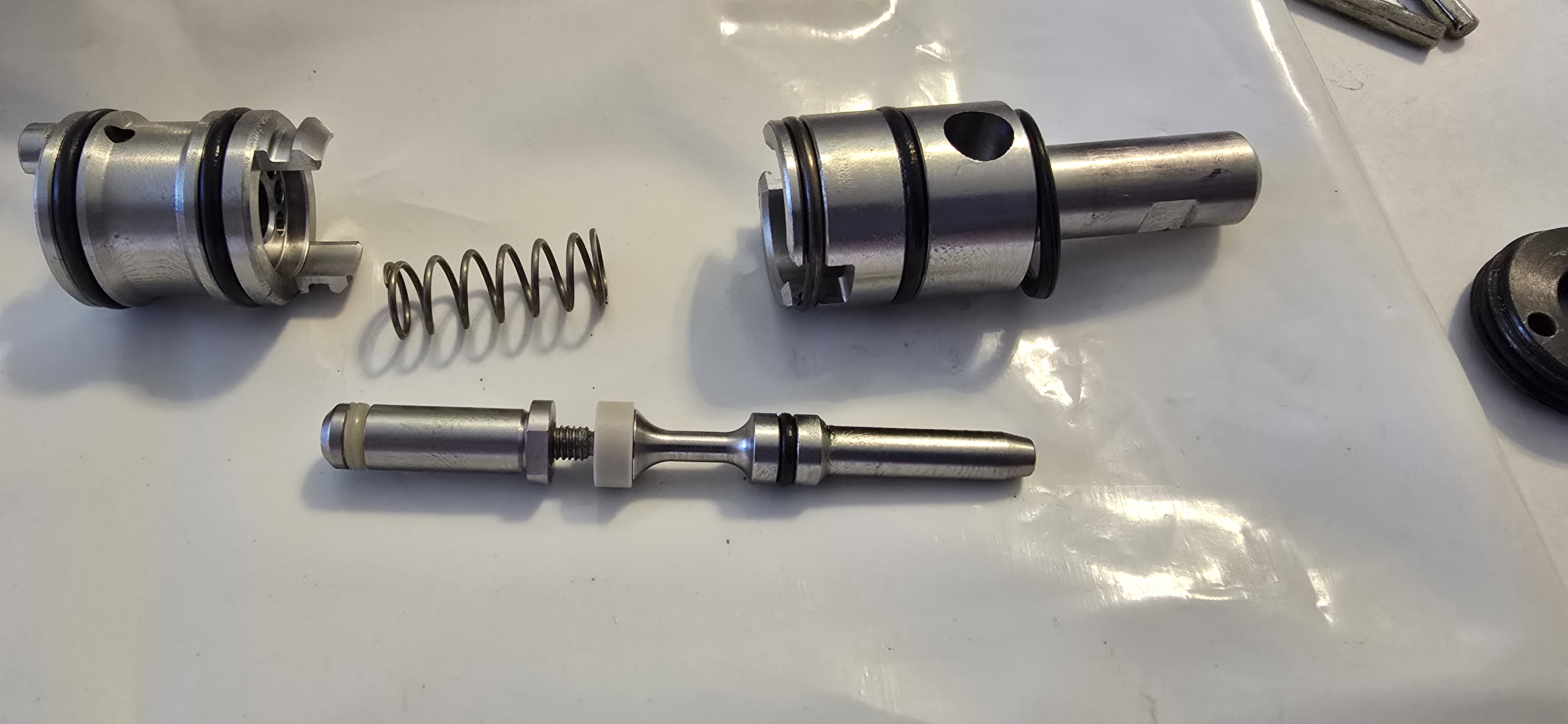

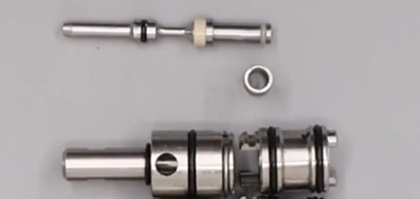

I was able to get the valve out and it definitely looks different than what is in the BRK strip down video. (I know there have been some changes)
From the video:
Pulled from my gun:
The internal end of the Valve Pin appears to have backed out with only a few threads holding it. Also by hand, I cannot get it to tighten down any further than where it is in the picture.
I put the valve back together and it will now depress slightly, but it does not appear to move to the extent that is shown in the video that was linked above.
Any thoughts?

Your "valve pin" (valve stem) will need to be tightened so that the head is supported by the flared piece with the white oring. If it won't screw together, take it apart and clean it well and make sure none of the threads are damaged or cross threaded. You'll need to to Loktite it on final assembly. I don't think Red Loktite would hurt... you'll not want it to come apart, maybe ever...
