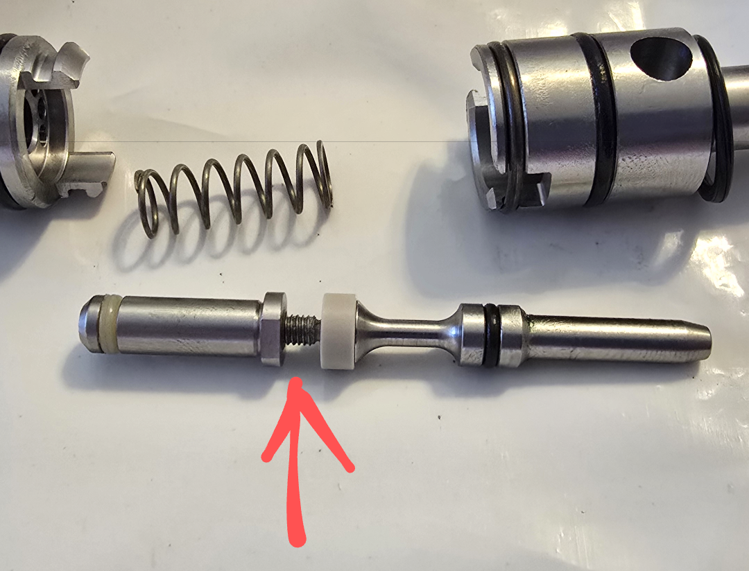

Your "valve pin" (valve stem) will need to be tightened so that the head is supported by the flared piece with the white oring. If it won't screw together, take it apart and clean it well and make sure none of the threads are damaged or cross threaded. You'll need to to Loktite it on final assembly. I don't think Red Loktite would hurt... you'll not want it to come apart, maybe ever...
Bob
I agree. I've not seen the valve stem unthreaded in any of the 4-5 valves that I've been inside....
You found your problem. This made the valve/pin too long, can’t open fully. Screw it in (put vibra tite on it if you have it (I wouldn’t use locktite) and out it back in, you should be fine! Weird how that happened though…
Yeah, I cleaning the male threads with a brass wire brush, but it isn't wanting to thread in any further. It acts like the threads are galled. So I am going through my tap/die set to see if I have anything that matches the threads in hopes of cleaning them up (gently) by hand.
I would expect this to be a warranty coverage item.
If not, I've seen Ghost valve stems for something like $20 from one of the UK parts suppliers. Of course tack on some shipping. If you don't have warranty, a stand-alone valve stem would be much cheaper than an entire valve.

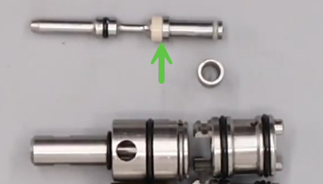

I found that the internal tip of the valve stem (end opposite of the poppet) had come unscrewed and was restricting the travel of the valve stem.
It should look like this:

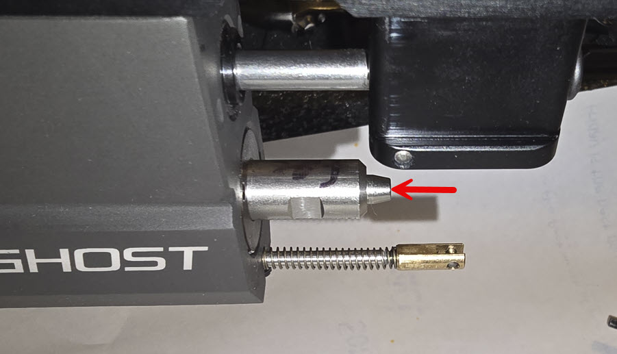

The shortcut to identifying this was:
1. Degassing the gun (I would avoid dry firing as I believe that is what caused this issue)
2. Removing the rear of the gun to expose the valve poppet
3. With the gun fully degassed (Reg gauge reading 0) see if the poppet moves when you press on it (it should move freely like in the video).

As I was pulling the valve out of the gun I noticed that there was almost no flex in the valve assembly unlike what we see HERE and it took quite a bit of effort to get the two halves of the valve body to separate.
When attempting to tighten the two halves of the valve pin it acted like the threads were galled and would not tighten, I was able to unthread the two halves of the valve stem and then cleaned up the threads as much as possible with a brass wire brush. Then I worked at threading them together working them back and forth/back and forth until I was able to get them almost tight (maybe a 1/16" gap) at which point I wrapped the poppet end of the stem in a towel and "clamped" it with a vice grip which allowed me to use a crescent wrench to finish tightening up the halves.
In the end I took it back apart, cleaned the threads and applied some Loctite to ensure that this will not happen again. After reassembling the rifle I tested it with the following configuration and results.
