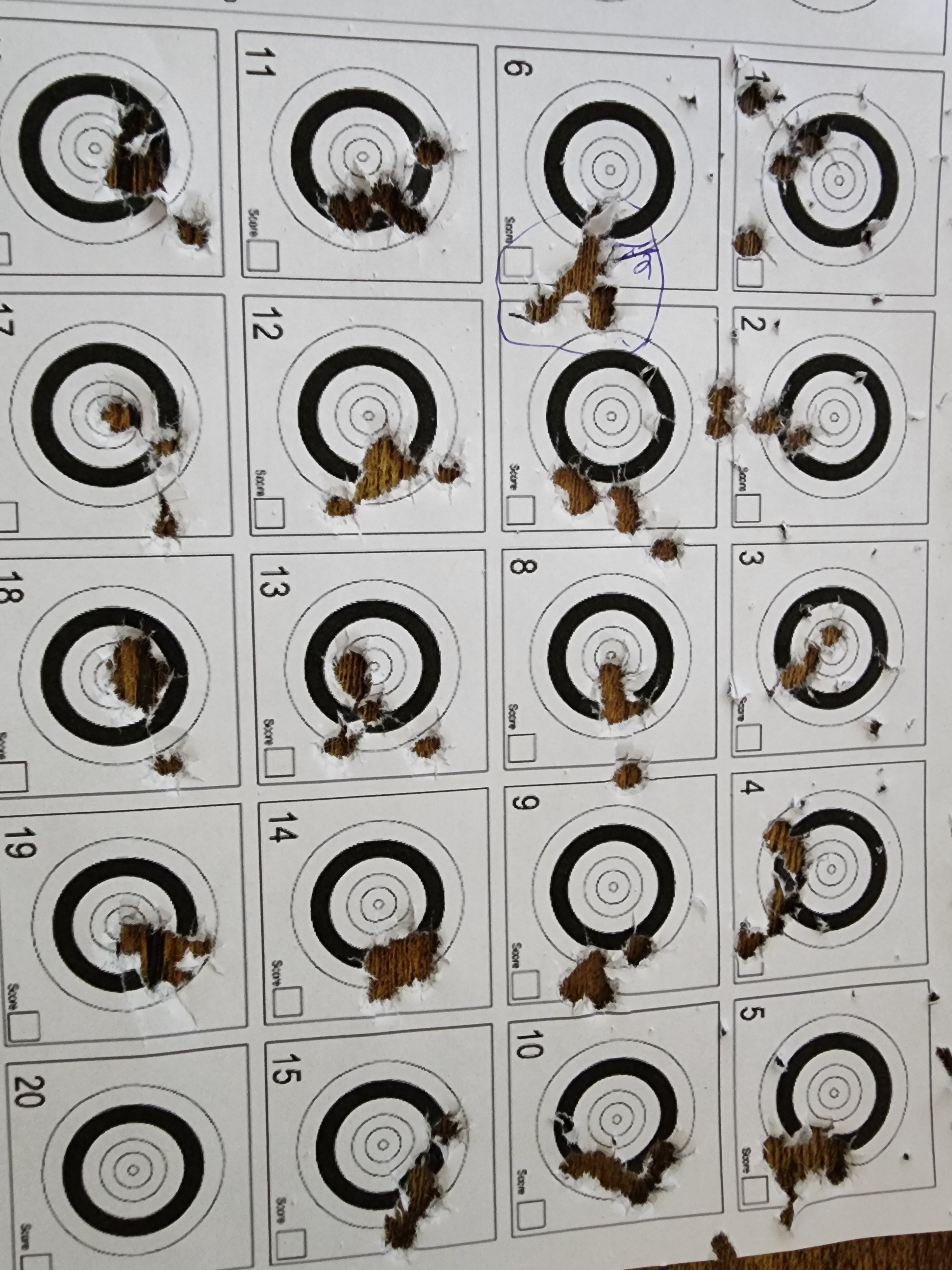

Started with 3,500 PSI in the tank, Regulator is factory set at 140, Dialed the Power Wheel down to 1 (Didn't notice the "min") shot 5 shots at each target from the mag. Refilled after every 5 shots to make sure I was staying above Reg Pressure.
Below is a picture of the 5 shot groups at 25 yards (26 if you want to exact Laser Range Finder).
So looking at the groups below a couple seem to stand out as better than the others. Groups 3, 5, 8, 12, 14, and 18 Seem to be the best to me. If the LabRadar didn't flake on me I would have been able to tell you the Average Speed per Setting at each of the settings. Area 1 = 832-875 Area 2 = 889-903 So out of the 100 shots I took (20 areas @ 5 shots each) I have 36 tracks from the LabRadar.

Have a ghost 25. Started with reg a 125 got 50 shots @ 905 turned reg up to 135 still about 50 (its close) 935 avg both power wheel on 18. Am sticking with the 935 for the 33.9 as i shot a 216 and 217 @ 100 and had a better score yet on the run today but made a blunder and skipped 2 targets and didn’t notice till I got home. Love my 2 ghosts!!👻👻

I’ve probably put 1000 pellets down the pipe. I pushed a pellet thru right after i got it and cleaned the barrel which i would suggest. I’ve read quite a few saying it was pretty dirty new though mine didn’t seem too bad. Mine has a pretty tight choke so I’ve hit the choke area twice with polish. Don’t know how much it has changed but it shot the test target well that was at 50 i think and it seems to shoot well at various speeds. Id give it a go with the reg at 135 with the 33.9 jsb and play with the wheel a bit first should give good shot count and accuracy. Something i forgot to mention is i have a 580 cc bottle on mine. Good luck and let us know how you make out!
