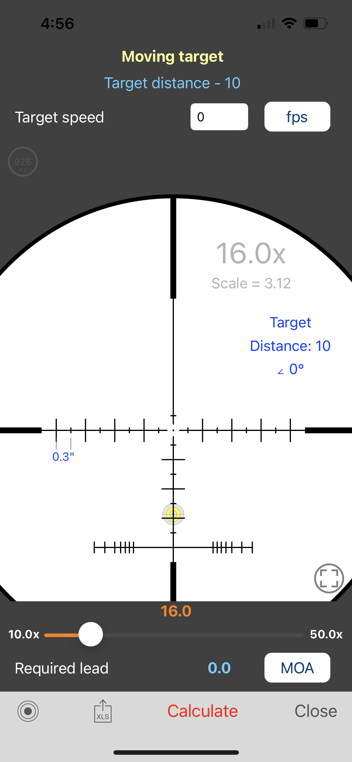

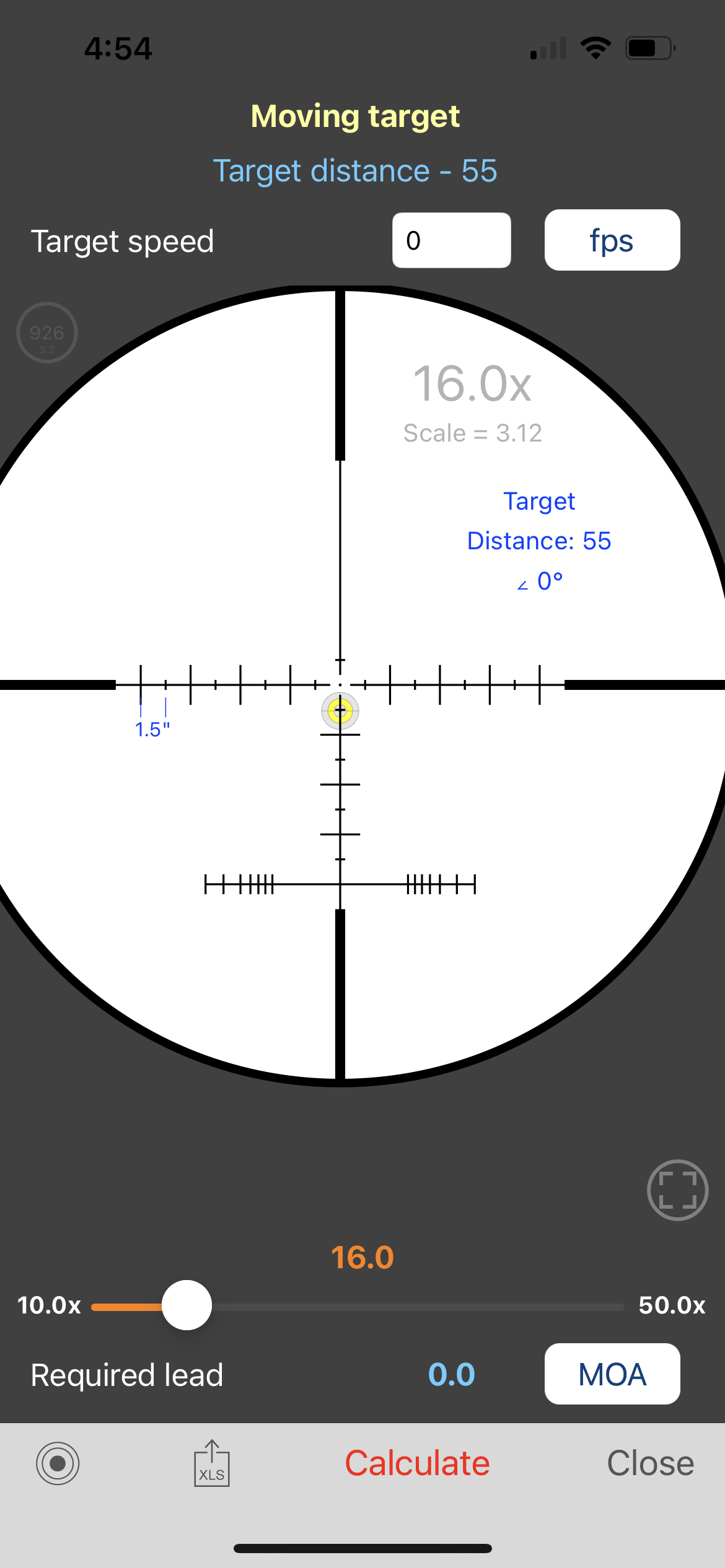

It’s pricey but they retain their value really well should I decide to sell. Presently I’m mucho happy with it. I’m not sure why scope manufacturers are afraid of using more reference points/markings on their reticles? Many times your eyeballs are guessing if you’ve got the holdover point correct. Pic of 10 yard holdover point. Pic of 55 yards holdover point.

I had a good bit of wind yesterday and was still knocking them over at 55 yards just using StrelokPro data.
Once I have a still day I will verify each and every shot from a bench - yard by yard from 10 to 25 yards and then again from 40-55 yards and adjust my dope.
