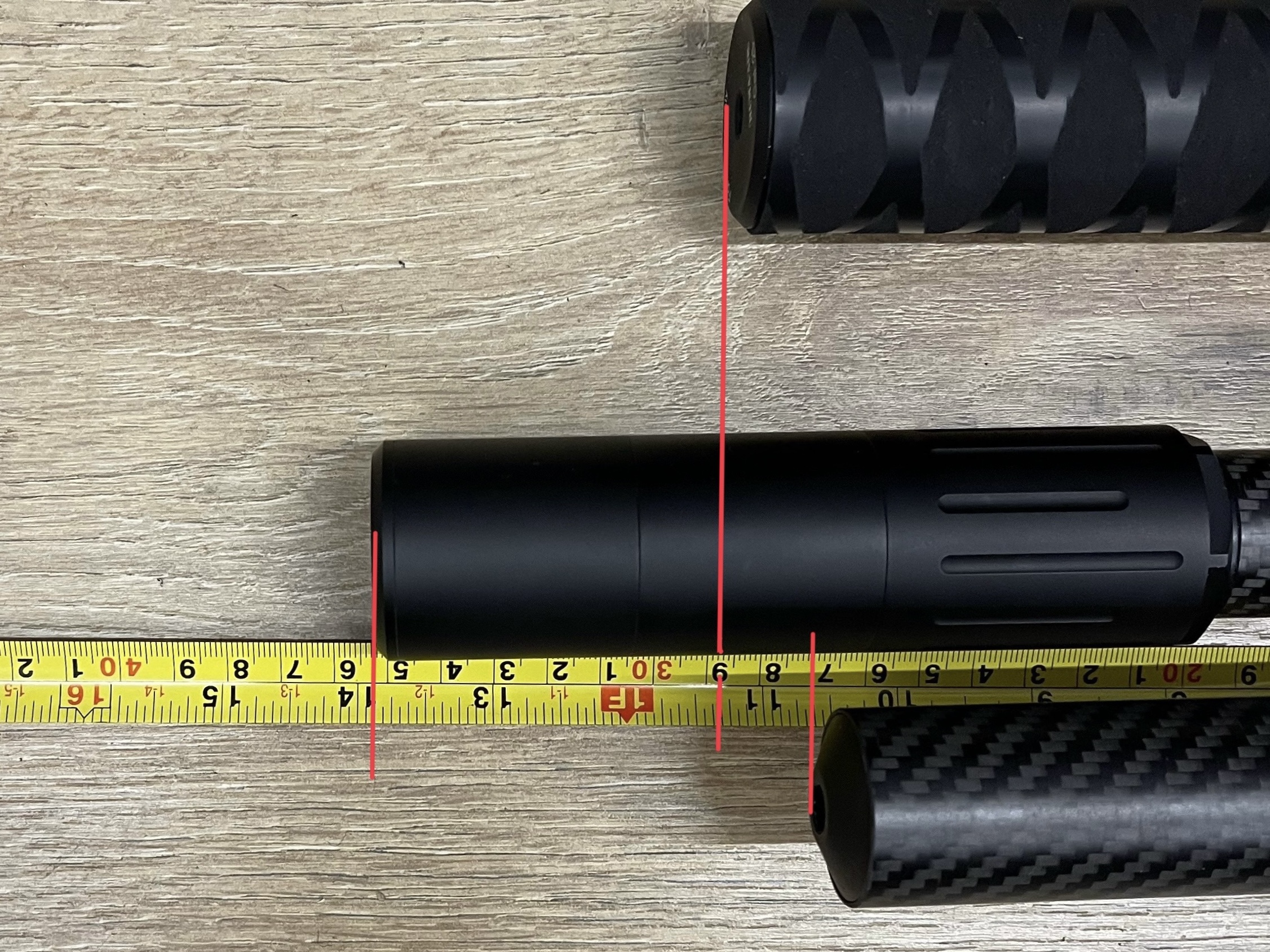

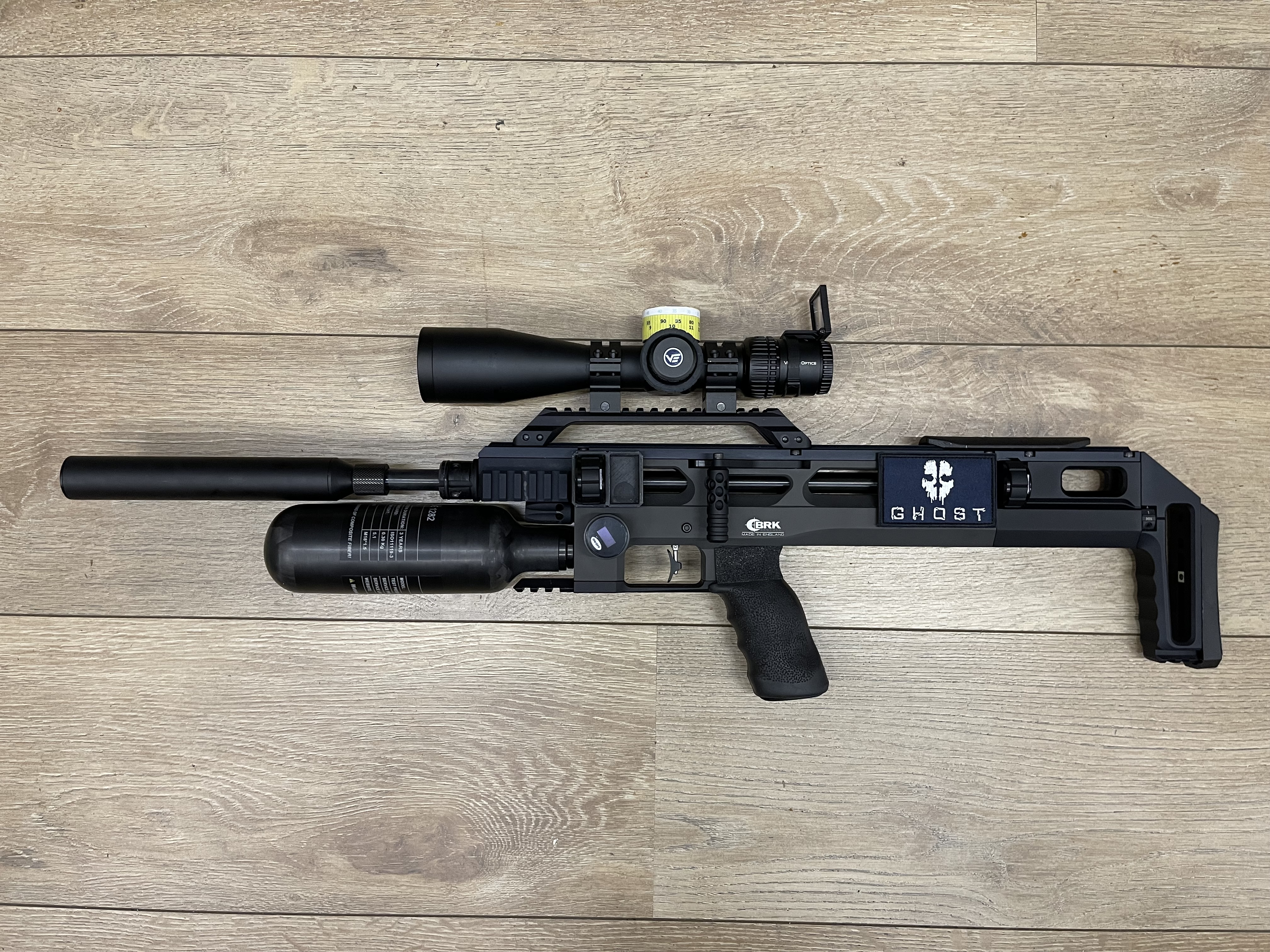

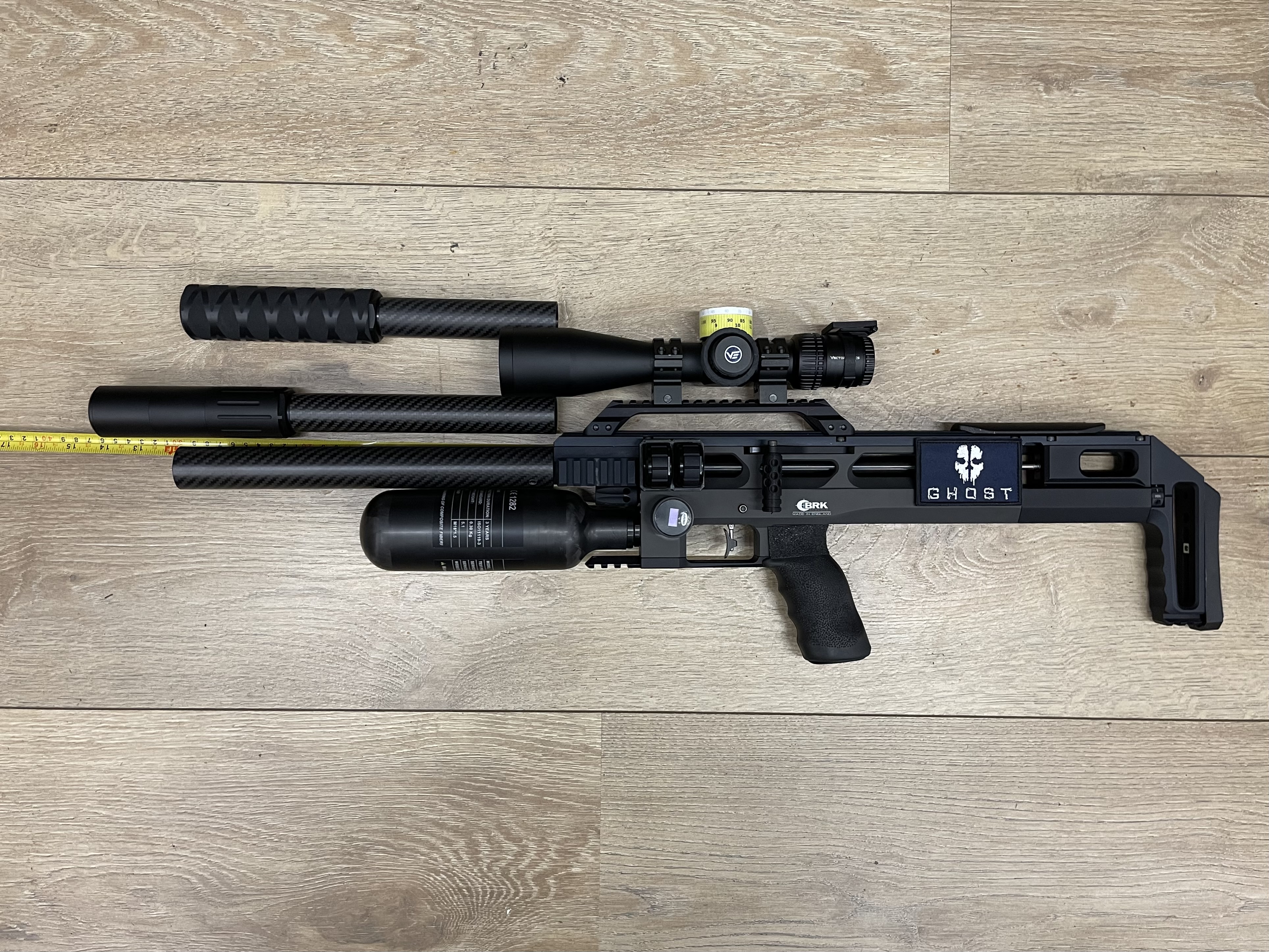

I did. Well, sort of. I experimented a lot with various setups (as can be seen in the pics), on top a (home made) carbine shroud, in the middle the OEM Plus shroud, and bottom a (homemade) HW (Weihrauch) setup. The most silent of the three turned out to be the one with a Weihrauch silencer (the others being Huma’s). The added benefits were that it was the shortest one of the pack (37cm, or 10 and some fractals in inches) and the cleanest in terms of looks. I used a steel M14x1.25 to 1/2UNF adapter, and made the carbon shroud myself, so not sure if it is the size of an HP shroud, as it is trimmed to the length of the silencer.
The airstripper is not used in this setup, so no air venting into the shroud as opposed to the other 2, (which do use the standard airstripper) but is still the quietest of the 3.
