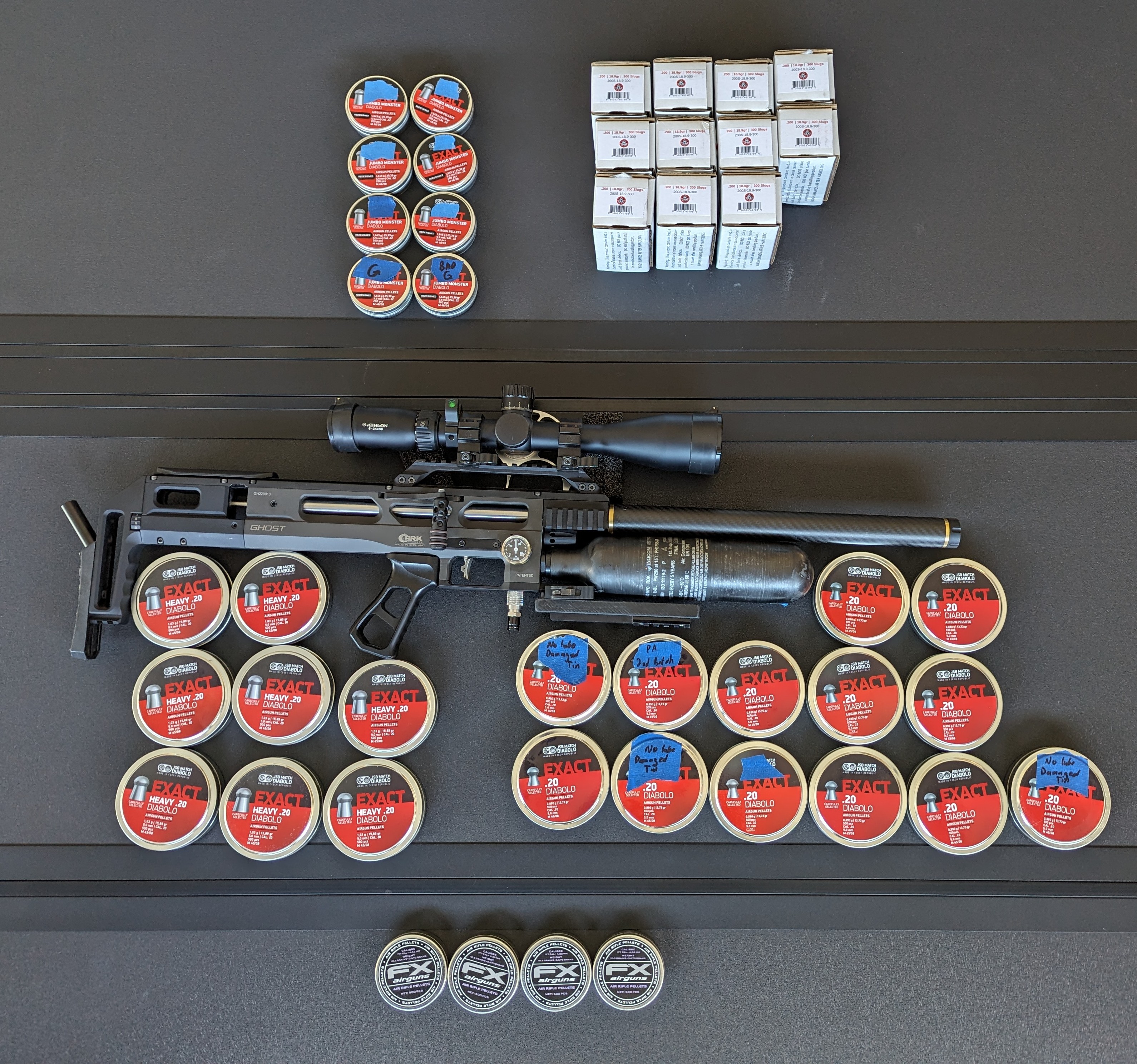

Added another box of slugs to the empty pile this morning and decided to lay these out for a photo.
This is since Sept of 2022. It represents entire tins or boxes shot solely by the Ghost. Shots taken when experimenting with other possible pellets are not here.
There are...
4x500 of the FX .177/10.34
8x200 of the JSB .22/25.4 Monster RD
11x300 of the NSA .20/18.9 slugs
8x500 of the JSB .20/15.89
13x500 of the JSB .20/13.73
I'm totaling that out to 17,400. I'd guess that the testing of various other pellets and slugs would get it closer to 18,000.
I've enjoyed every shot.
That’s the right way to get the lead out!
