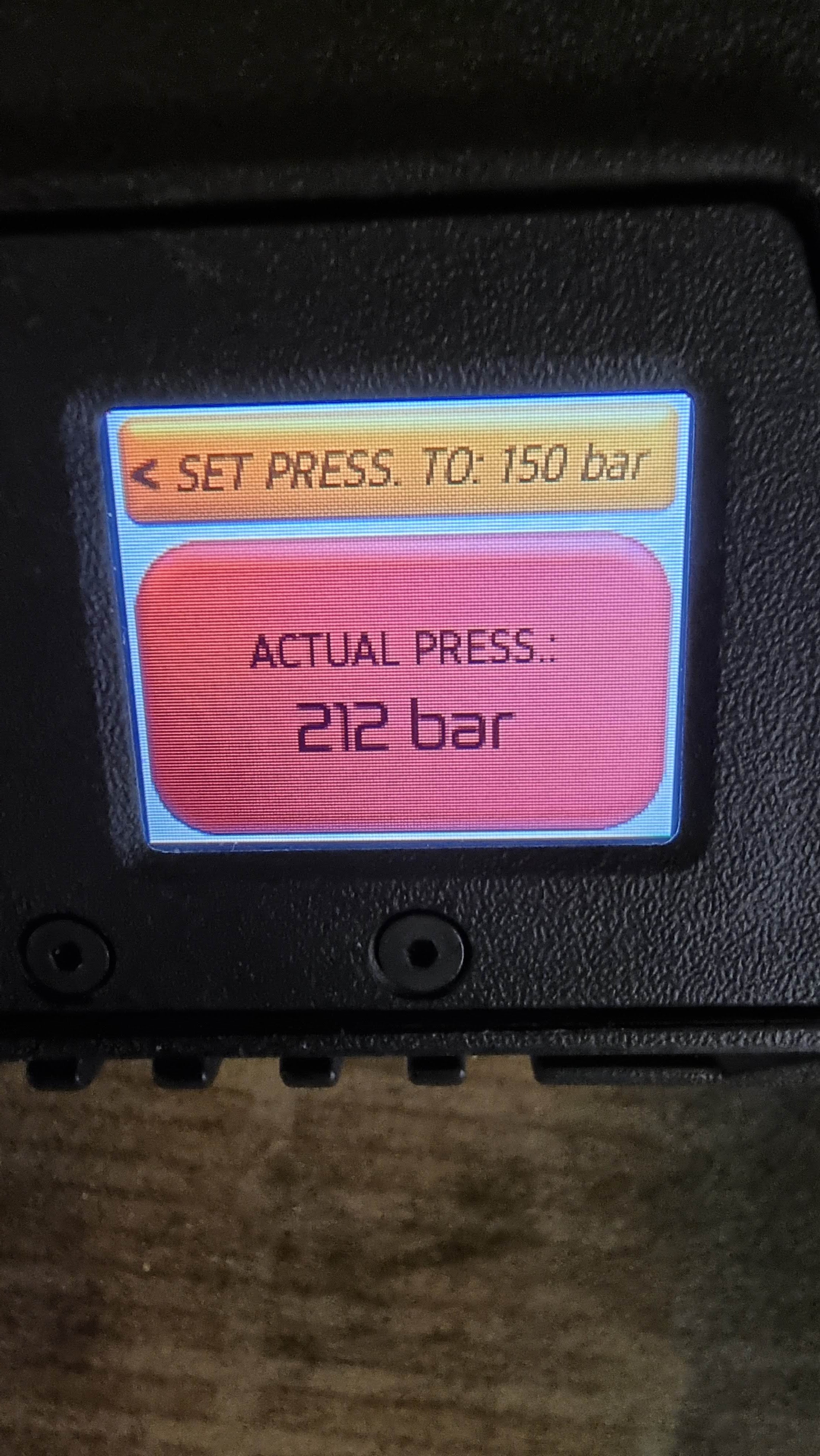

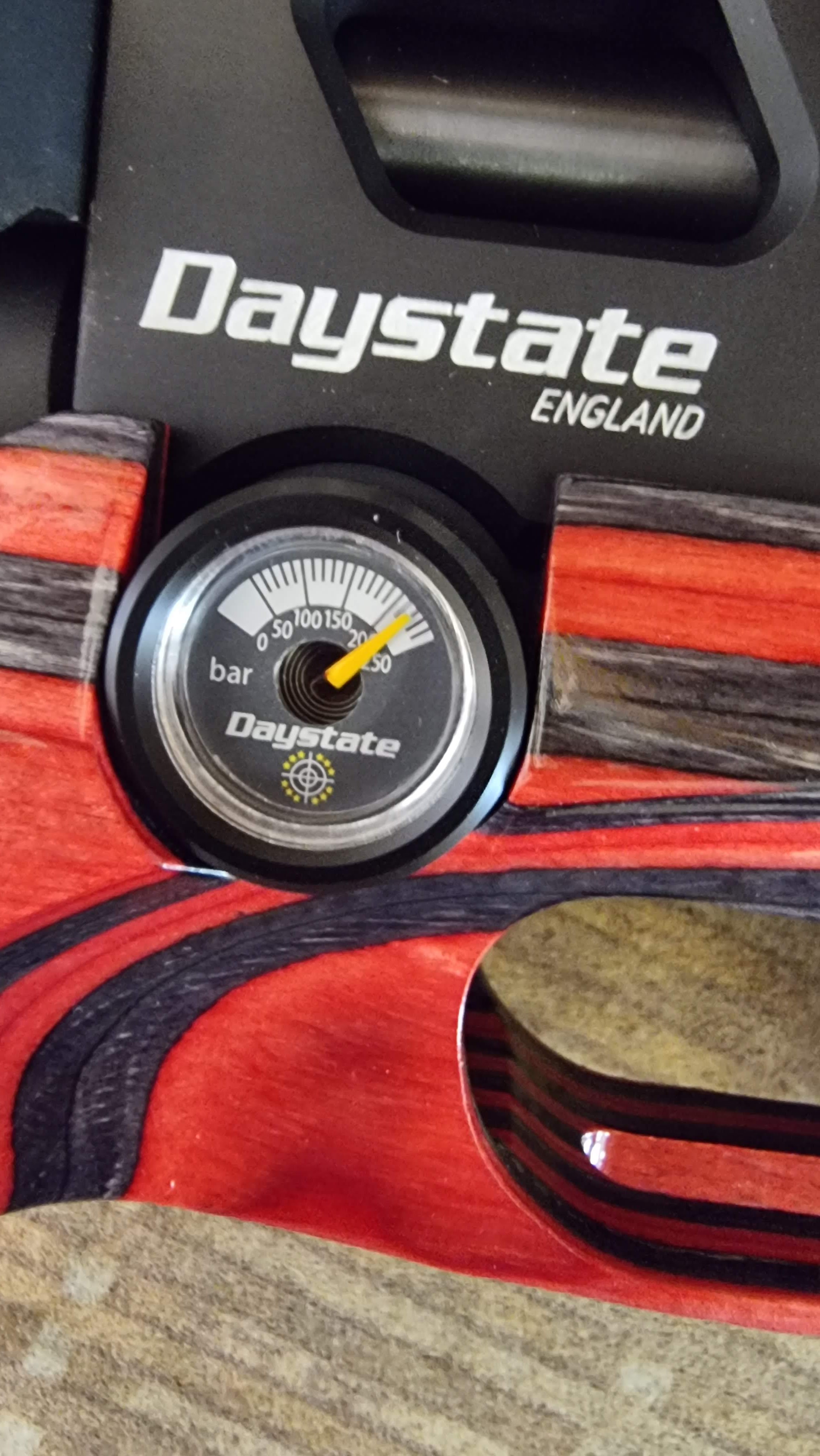

Mine, out of the box, showed a reg pressure of 212 bar. See screenshots.
The regulator adjuster was found to be fully wound counter clockwise and reg pressure was showing the same as the bottle pressure.
So how come the reg pressure exceeds Huma medium reg pressure stated maximum of 175 bar ?
If it was actually fully clockwise and 212 bar, it's likely that it's adjusted beyond the working range and no longer regulating.
Thanks for that. Hopefully with no long term damage. It seems to be working OK-ish. Reg spread of 10 bar between bottle full and refill pressure. Just about acceptable.
Edit: counter clockwise for max reg pressure. My error.

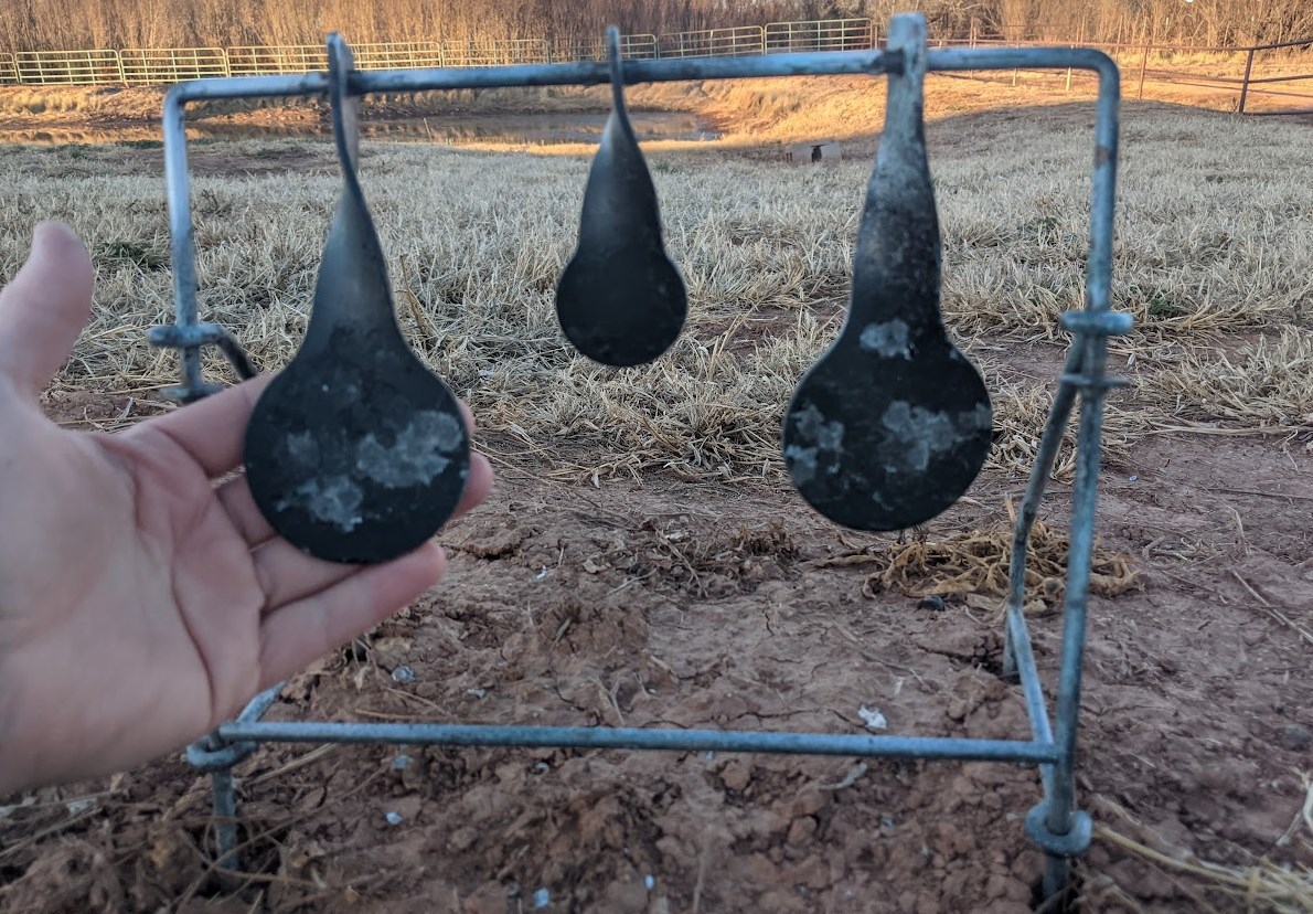

Shot this a couple nights ago with the Ghost in HP config. Didn't walk out to get a photo until today when I walked back there to check on a pest bird I sniped off the fence. No formal testing, just enjoying the gun. .22/25.4gr MRDs at the same 925-930fps that I shot the Xtreme FT match with around 10 days ago.
95 yards, wanted to shoot 2, 10 shot groups on each of the larger paddles but will admit that it took 23 shots to get a 10 shot group on each. 1 miss on the left paddle, so 10/11 showing. And 2 misses on the right paddle, so 10/12 showing on that one. Wind was stiff, as it has been for a few weeks here. To give an idea of the winds I've been dealing with, I just checked the weather forecast and they're predicting gusts up to 25mph tomorrow, 33mph on thurs, 40mph on fri, 41mph on sat, and so on. Good to practice in, but not great for accuracy assessments or sharing of data for those interested in seeing examples of what the Ghost can do.

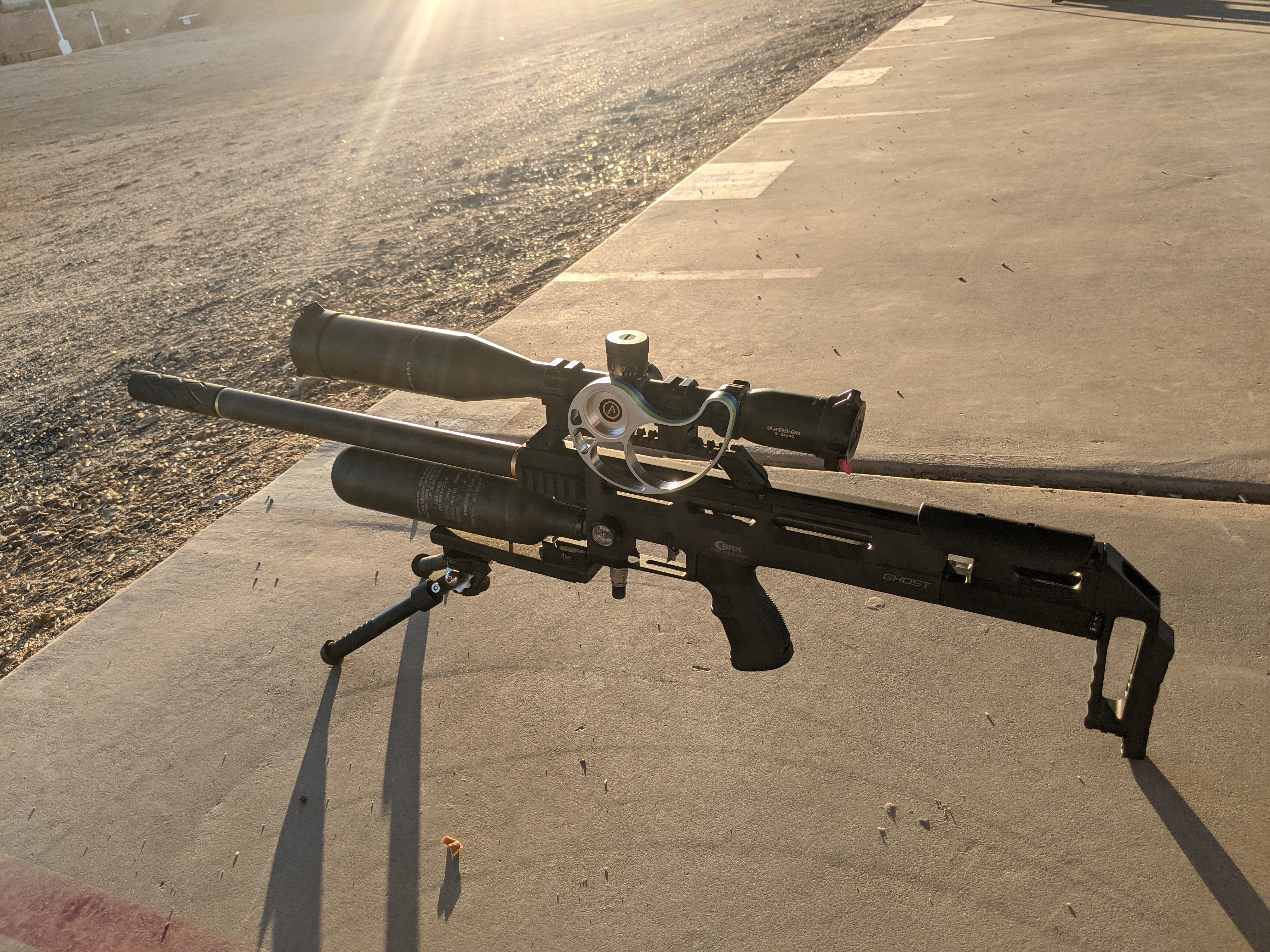

For the high power match we got to PRGC about an hr before dark. I swapped over to the 24 inch .22 barrel and made the other necessary adjustments. Took all of five minutes. I was ecstatic to then shoot at the paper on the sight-in range and have MOST of my dope data line up. Everything was spot-on up to and including 50 yards, but my dope data/trajectory past that wasn’t what I had gathered at home. In retrospect I realized that my trajectory gathering session at home was done with a pretty stiff quartering in head-wind that had effected my far impact points rather seriously. I adjusted for it and was able to shoot 10 shots into what looked to be around 1.5 inches at the 100 yard paper, but the damage was done mentally as I didn’t trust the dope on the far ones after that. Couldn’t decide if I should trust the home dope or the dope right there that evening right before the match. We ultimately had 3 rimfire shooters and 10 pellet shooters at the high power/long range night match. I shot a 40/48 which was a tie for the second highest score of all 13 shooters. Tie was broken by longest string and so it went to Mike, making my 40/48 officially 3rd place. Wes (1st place) was the Extreme Field Target champ at EBR in .22 class in Oct. And Mike (2nd place) currently holds the record for best knockdown percentage at an XFT match @ PRGC.

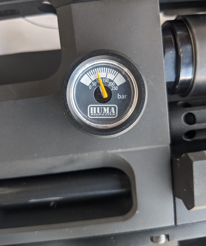

So, last week on a day off I did a bit of experimentation.....
Regulator pressure just a smidge under 100 bar, maybe 98 or so. 100 bar would be about 1450psi, which is really quite low. I thought that'd be a good starting reg pressure for the 28-32ish fpe using 15.89, and maybe 18.13grain pellets.
(Still has the .22 barrel on it.)
Keep in mind that the HP model comes with a 592grain hammer and maybe even the heavier 0.051" wire hammer spring. The review gun in my possession is still using that 455grain skeletonized hammer that it came with as a .177 Carbine, and in this case the 38grain hammer weight I made, So that puts the hammer weight at 493grains, nearly 100 grains lighter than the standard hammer for the HP model. AND I'm using the lighter 0.047" wire hammer spring that also came in the .177 Carbine.

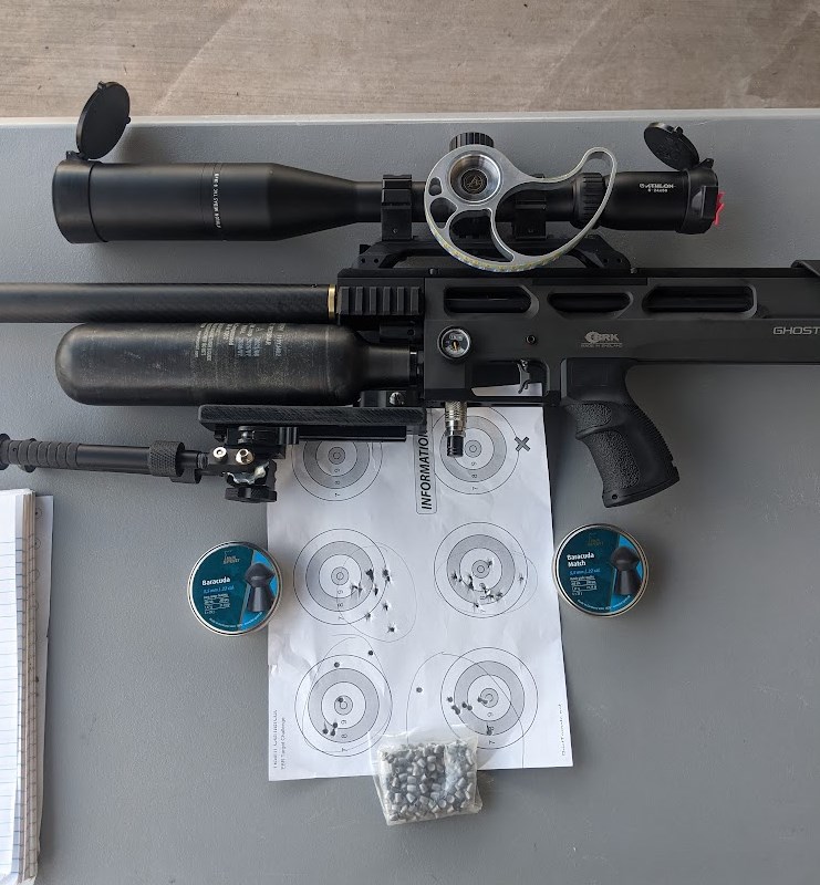

These looked like much more reasonable speeds for their respective projectile so headed outside for some shooting. Yeah, winds were only gusting to 25mph that day. Not the kind of testing conditions where definitive data is going to be collected, but it was my day off and I was excited about getting nearly 40fpe from a reg pressure of 1450psi so I wanted to at least do a bit of prelim group shooting.

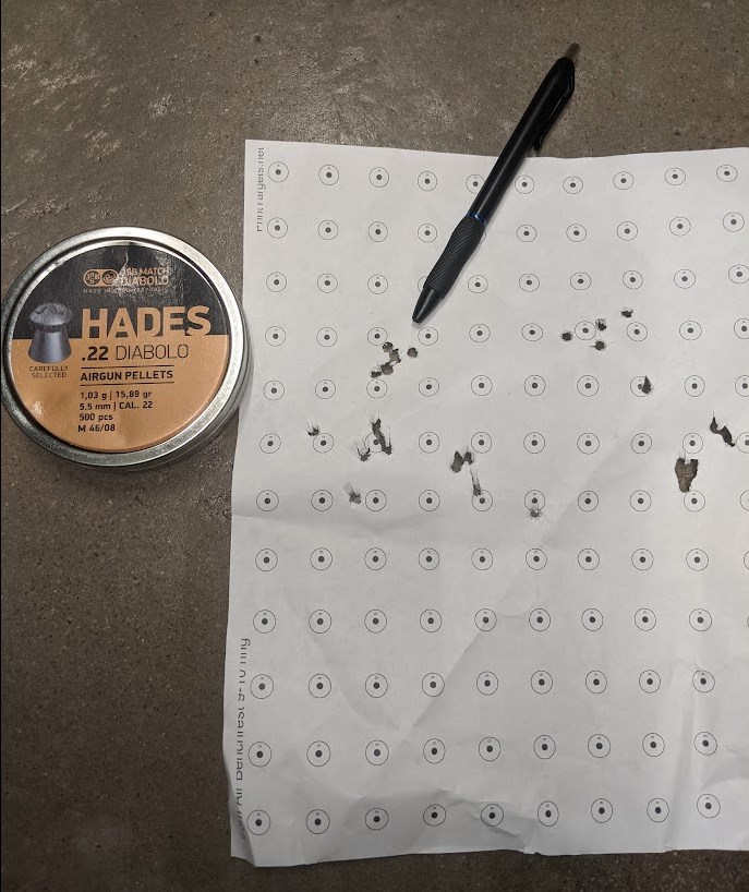

Thought I had the pellet trap at 55 yards but lasered it out to 58 yards.
Started with the 18.13s and overall got pretty poor results from them, next thought to myself, "Why not, lets try some of the Hades at 1012fps!"
The pen is pointing at the 5 shot group from the Hades, everything else on this page is the 18.13....
I would have never guessed the Hades would have grouped like that at over 1000fps in 25mph winds. This is all I shot with them but need to revisit on a less windy day and see if that was a fluke or standard sized groups.
Went on to the two flavors of Baracuda and the 17.5grain NSAs next. 10 shots with each of the Baracudas and then the bottom groups are from the 17.5grain slugs. The bottom left was zeroing for the slugs, the bottom right was a 10 shot group with the slugs.
Piqued my interest enough that I'll be revisiting all of this at a future date (with less wind and warmer temps). There's some potential in the above. It also suggested that a reg pressure down around 80bar might even be plenty for a tune in .22 at around 26-30fpe. Being able to shoot from 250 down to 80 bar would be LOTS and LOTs and LOTS of shots per fill, and quiet, and safe, and high volume shooting for cheap.....it got me excited.
