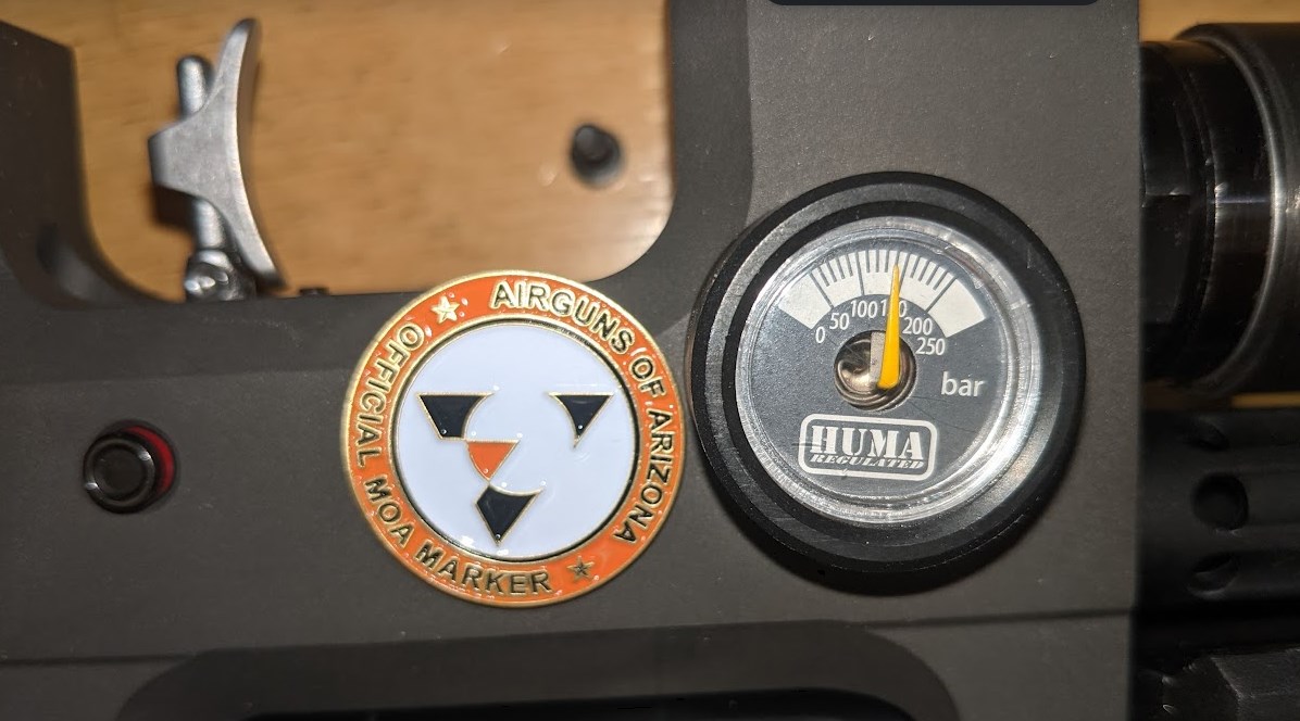

Please share once they've arrived and you get em installed.The gauges are still in my basket at Huma.

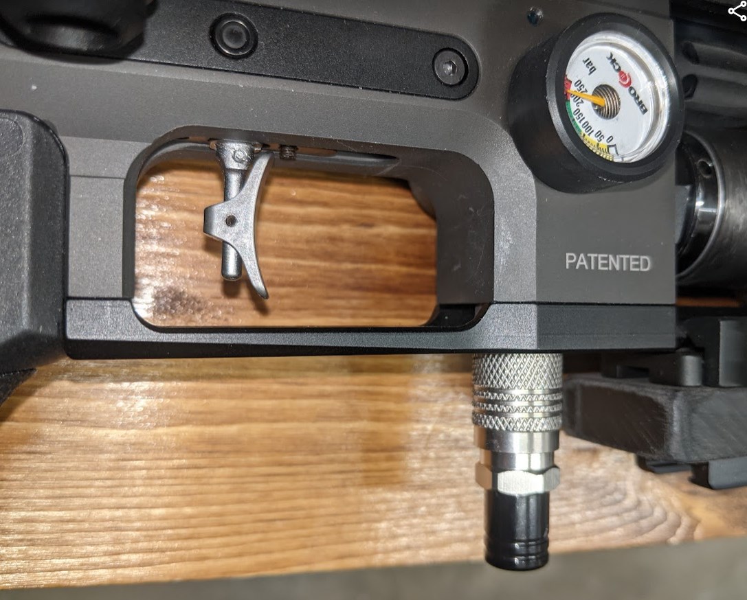

VERY nice Derrick! Had to swap out that trigger rod return spring to get the pull weight that low right? Are those fps results with the 34gr .25s? Or slugs? In addition to the projectile info, please keep us updated with results, your impressions, and generally anything you learn about the Ghost that you are willing to share. Yours being a .25, you'll have data for that caliber that I simply won't be able to provide to interested parties (myself being one of those interested parties, as I continue to consider making the switch to .25/34gr for my long range uses).Black Max is here ~ .25 Ghost HP. Trigger job done yielding a 4.5 ounce break and I did a bit of port/polish work in the barrel’s transfer port and probe.
At 150 bar reg setting, I’m getting 955 fps on max (19). Dial down to 14 for 940 fps. Down to 8 and I have 920 fps. Just got it scoped and will be testing as time permits. Love the feel, adjustability and power! Added a grip and moderator.
Looking good... Thats good power with the 34 grain King Heavy at 150 bar. Knowing you it won't be long before we see what 170 and/or 180 bar can do.Black Max is here ~ .25 Ghost HP. Trigger job done yielding a 4.5 ounce break and I did a bit of port/polish work in the barrel’s transfer port and probe.
Yes, this is with JSB 33.95gr pellets. I’ll get some meaningful testing done Friday at 100 yards.VERY nice Derrick! Had to swap out that trigger rod return spring to get the pull weight that low right? Are those fps results with the 34gr .25s? Or slugs? In addition to the projectile info, please keep us updated with results, your impressions, and generally anything you learn about the Ghost that you are willing to share. Yours being a .25, you'll have data for that caliber that I simply won't be able to provide to interested parties (myself being one of those interested parties, as I continue to consider making the switch to .25/34gr for my long range uses).
