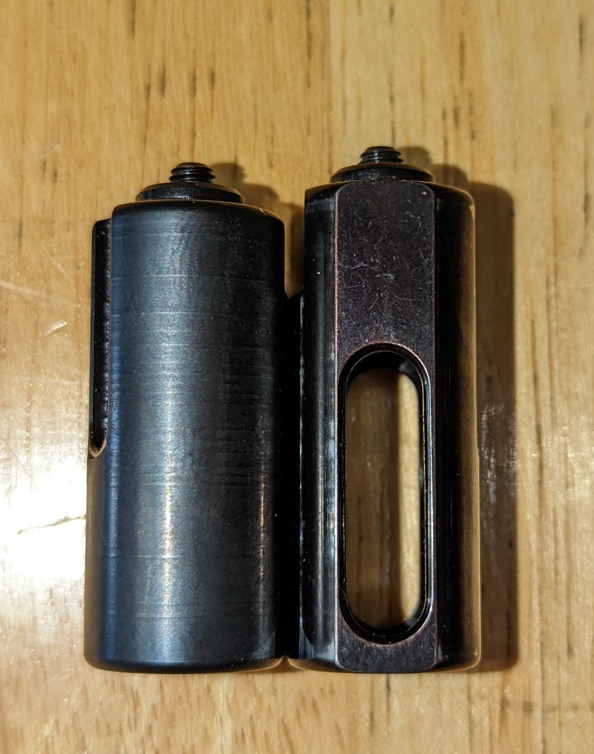

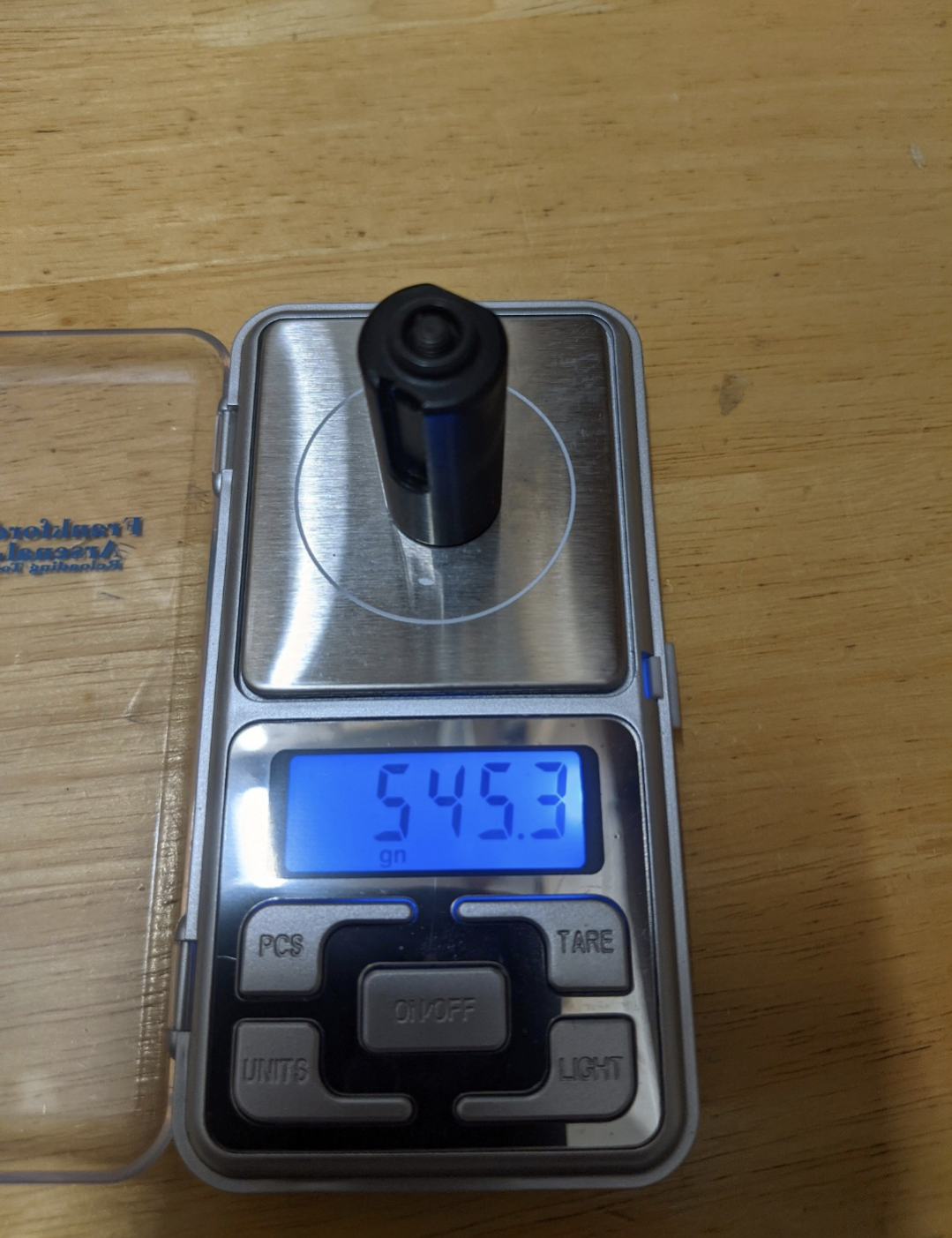

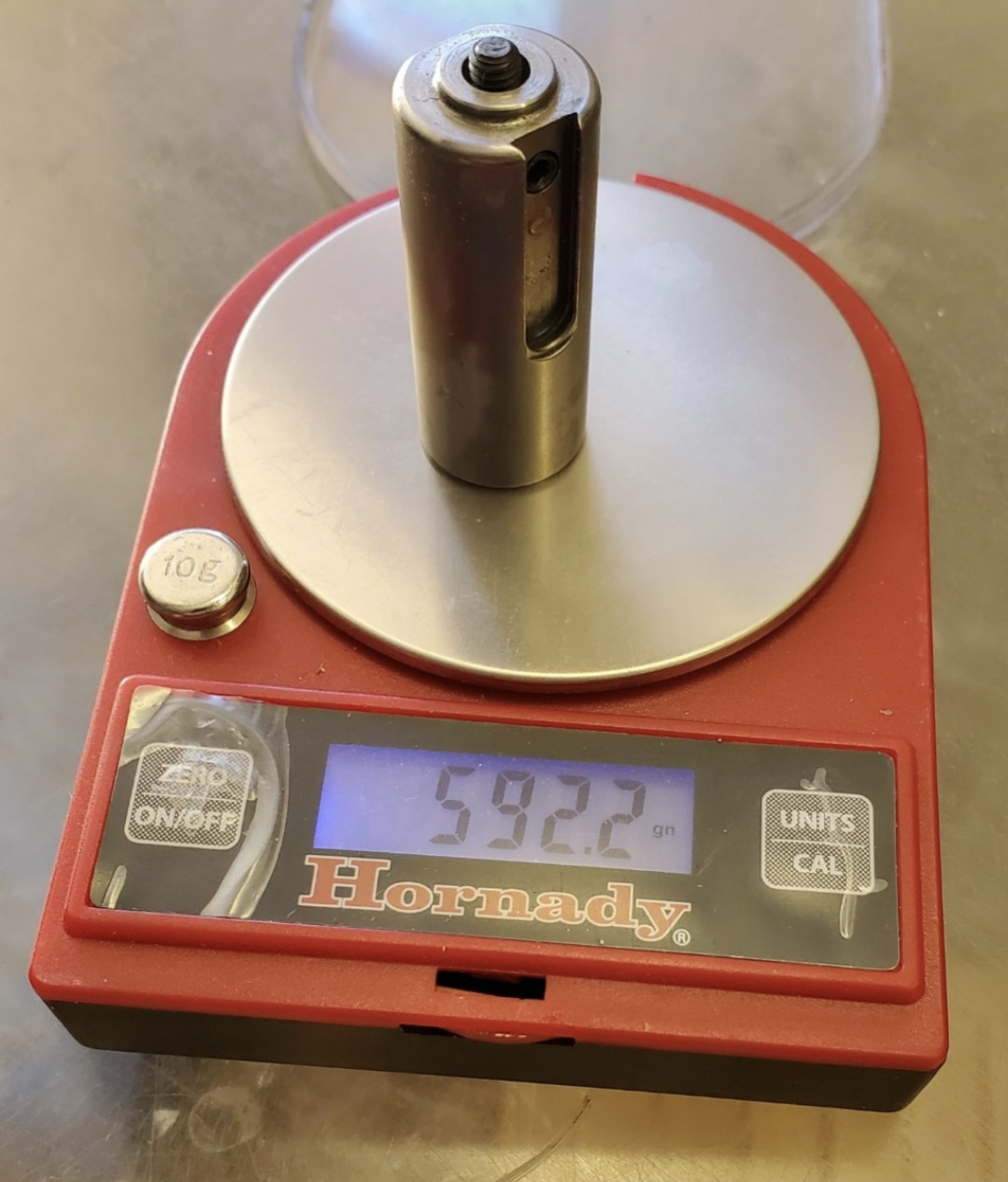

- "Heavy hammer" = 545.3grain hammer that comes in GHOST HP.
- "Heavy hammer spring" = 0.052 wire hammer spring

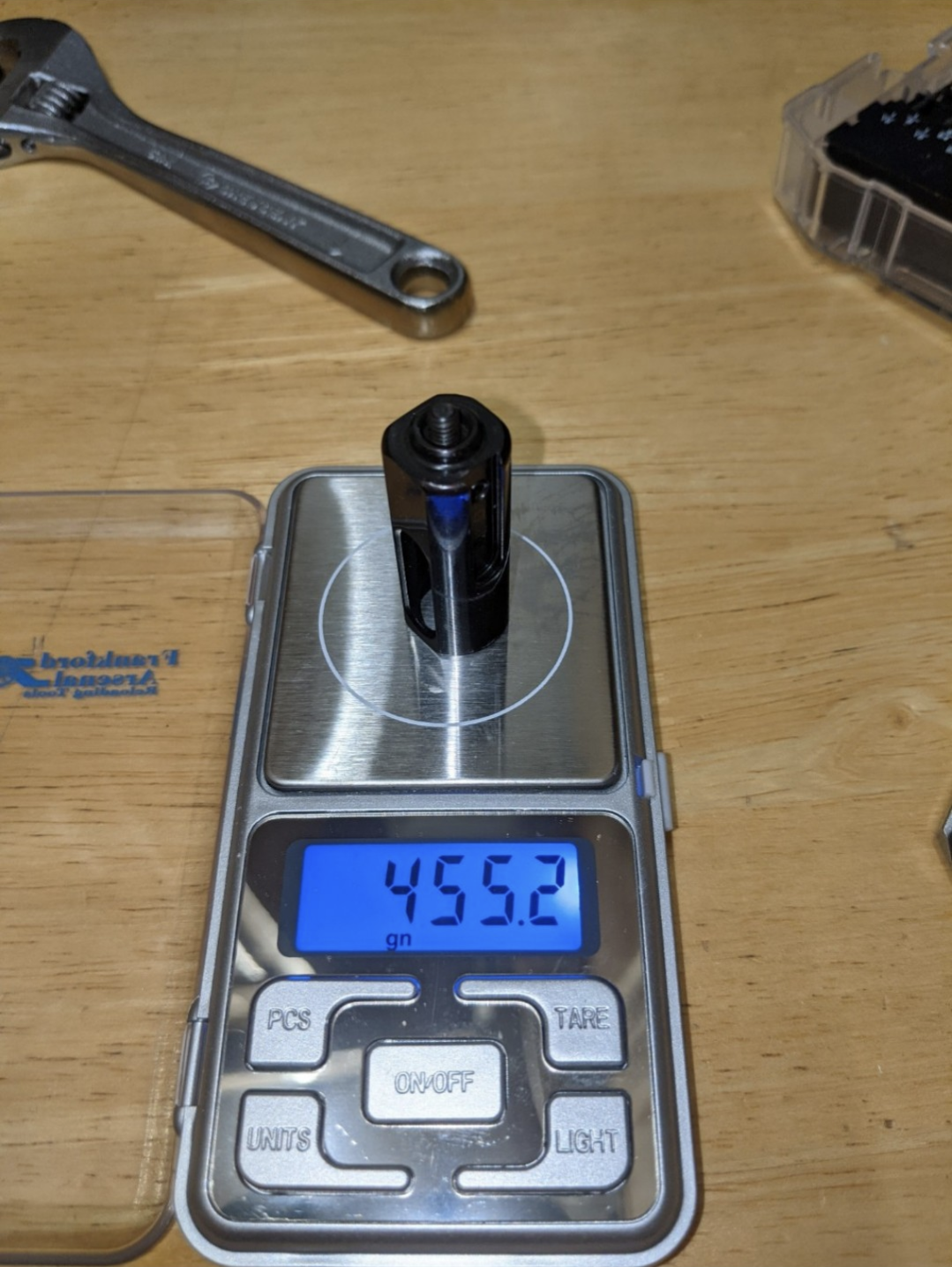

- "light hammer" = 493.2grain (455.2grain hammer that is probably a sub 12 fpe UK hammer + my home brew 38 grain hammer weight)
- "light hammer spring" = 0.047 wire hammer spring that came in the .177 Ghost Carbine

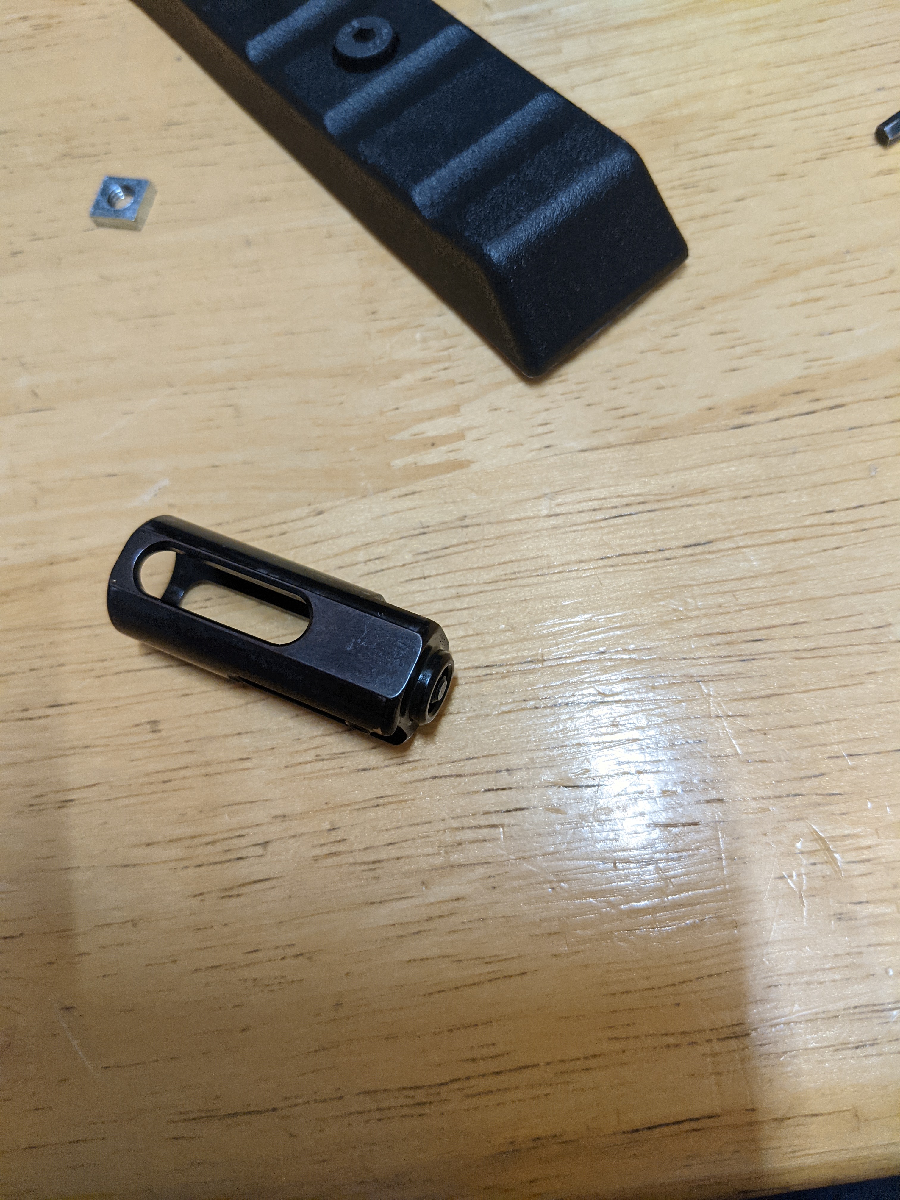

The swap over was pretty uneventful. Simple enough to take out the lighter hammer and lighter hammer spring, and put in the heavier ones. Reg pressure still at about 140 bar. Hammer spring tension wheel at "MAX" (original design). First shot over the chrono was 900fps with MRDs. Next couple were also right there around 900fps. This is LESS than I was getting with the lighter hammer and spring. Scratch my head for a minute.....Maybe needs more reg pressure since I'm theoretically smacking the valve harder so, increased the reg pressure.....to no avail. I got as high as 165-170bar and fps went DOWN to 885fps. More head scratching. Dropped the reg pressure down to 120 bar, fps of 860 with MRDs. Highest energy output was with a reg pressure of 135-140 bar.
At this point, I've got a heavier hammer, with a stiffer hammer spring, and a longer stroke. All three of which should equate to hitting the valve harder, therefore producing more energy. But it was producing LESS energy. Thought maybe too long of a stroke? So threaded out the nose of the hammer, fps went down about 25fps. Maybe too much hammer spring? So swapped back to the light hammer spring but kept the heavy hammer in the gun. FPS with MRDs went down to 770fps. What the @&%#@ he77?!?!?!
Assessed the smoothness of the hammer traveling in it's little home and compared the two, they're both smooth as silk, so no apparent friction or roughness issues there.
At this point, I'm wondering if I've got a failing valve or something horrible. So I go back to the configuration that I shot the XFT match with in December. Put the light hammer + my weight and the light hammer spring back in the gun, essentially replicating my settings from before this recent heavy hammer/heavy hammer spring adventure. First MRD over the chrono with my previous settings was 940, right where it should be (had reg at about 137 at the last match and fps was 920-930. New reg of 140 bar so expected fps to be up just a bit from that) . Shot ten over the chrono and they were something like 932-940fps. MAX on the hammer wheel will take them back up to 965, all of that is just like it did before with similar settings.

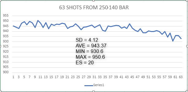

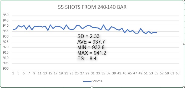

Too windy for true accuracy testing (been gusting up to 30mph these last two days at my place) but I realized I hadn't ever shot a full string over the chrono to see how consistency is. For sure didn't want to just do that into a trap in the garage so I set up so that I could do it outside. Also got the crazy idea to try to hold on the same impact point at 75 yards (lasered out to 76) for the entire shot string and see what the wind and pellet quality and shooting through a whole "fill" would do to impact points.
This is the first fill.

Couple conclusions from the above...
- The lowest shots from both strings were in the last couple shots. Which suggests that either the reg manometer is a few bar off, or more simply that the reg slightly misbehaves if shots are taken all the way down to set point. From now on will be stopping and refilling around 145 bar.
- Filling all the way to 250 bar, versus only 240, doesn't gain much in the way of shot count.
- The previously decided less accurate of the two batches DID produce a wider ES.
- One of the two batches actually shot slightly faster as well. No visually discernable difference in pellet shape, but perhaps an average head size difference from one batch to the other.
- I am well-pleased with the consistency.
- Will fill to 240 bar and shoot down to 142-145 bar from now on, planning on a solid 50 shots per fill at just the slightest smidge under 50 fpe each.
- That is from a 480 cc bottle. Do what most would and add a bigger bottle and of course shot count will increase. Personally, with lots of time with tube guns, I'm pretty dang happy with a 50/50 tune (50 shots of 50 fpe each, between needing to fill up the gun each time).
