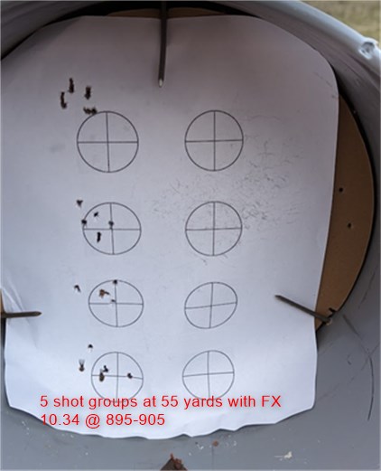

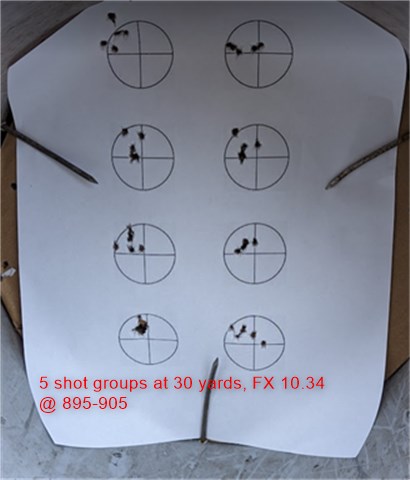

Shot some with the FX 10.34 first....
Keep in mine that the wind was gusting up to 16mph during this.
Circles measure 1 and 3/8inch.
The two above photos represent 60 shots (8groups x 5shots/group at 30 yards and 4 groups x5shots/group at 55 yards). Those 60 shots, each about 900 fps with the 10.34s, took the bottle pressure from 240 down to 170bar. The reg was around 110-112 here so there were many more shots available in this fill. While that's okay, it's not great. And that's b/c of the tiny transfer port on the .177 barrel. The reg has to be higher than should be necessary for 19fpe in .177 because the small transfer port is throttling power output down so much. There'll be more on that transfer port size @ 20fpe later.....
There's a couple good groups in there but it was mostly when the wind would calm down long enough for me to get 5 shots off. Overall I wasn't very impressed with how much the 10.34grain pellets were blowing in the wind.

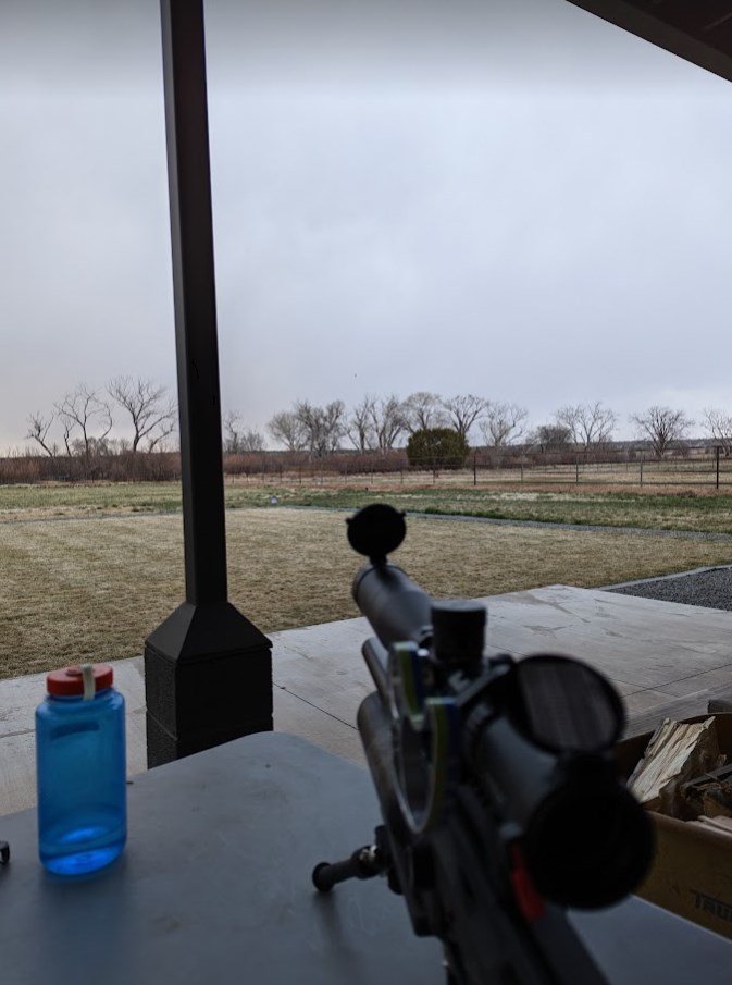

Shooting the Ghost right now and pulled my eye off the scope to grab a pellet and noticed something on my irrigation berm maybe 8-10 feet to the right. Panned over with the scope to get a closer look and.....a dove had landed while I was shooting.
Had to turn scope power down to 8 to get it and the pellet trap in the same frame...
He got a pass. Pretty sure it's a Mourning Dove and not a Euro. He wasn't too concerned about the sound of the Ghost or the pellets hitting that peach colored paper.

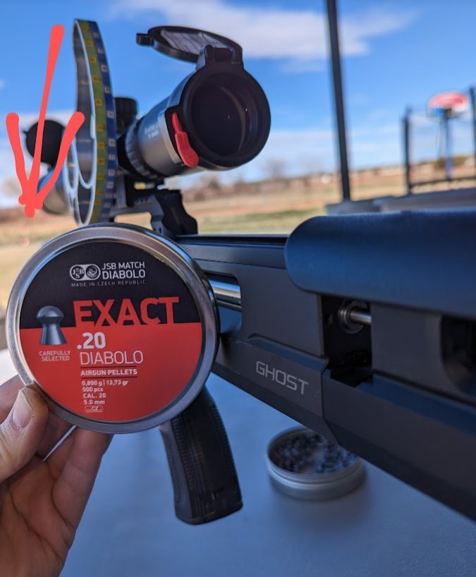

If you follow me on instagram (backyard_precision_airguns) you know that I spilled the beans about the new barrel/caliber earlier today. Otherwise, here it is.
Yes it's a .20. (That red arrow is pointing at the pellet trap @26 yards where the fly lost a wing and maybe a little portion of abdomen earlier today).
And it's not just any .20, but a very special old stock barrel that a dear friend supplied and machined to fit the Ghost. It's a kinda long story.....

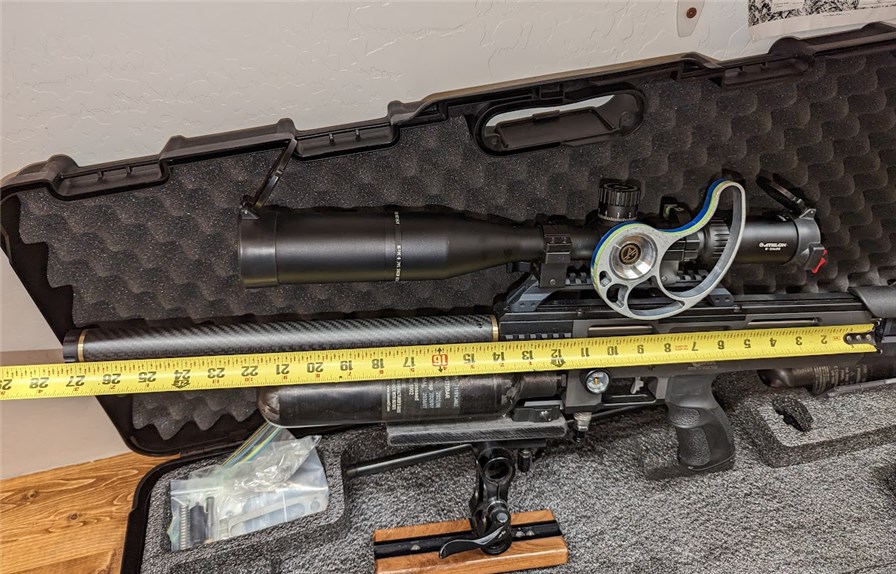

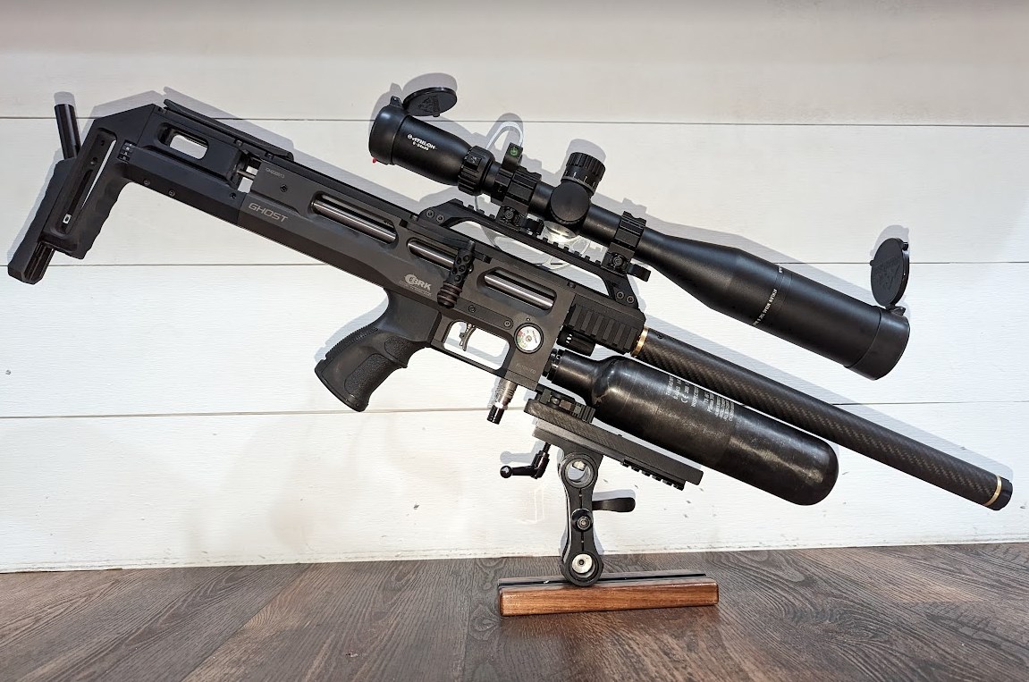

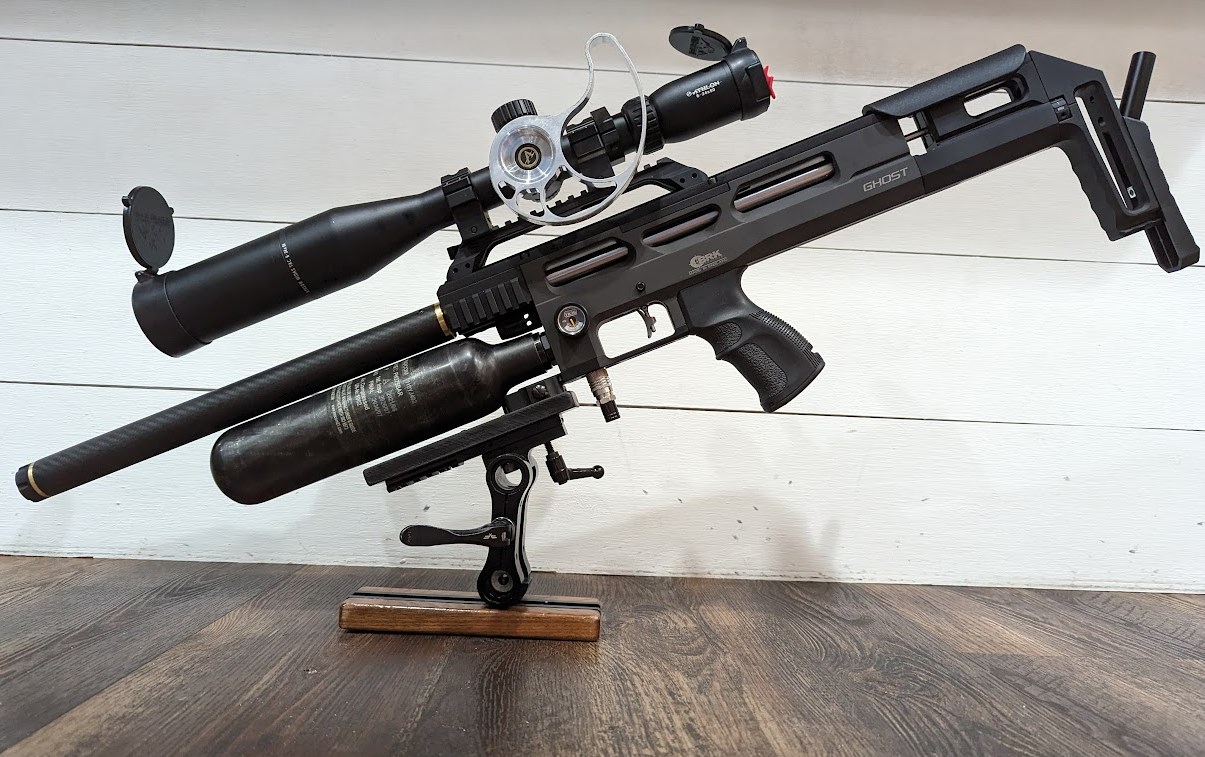

Here's the gun, with the .20 Sterling and in field target configuration. It'll be set up like this until winter.
33.75inches overall length.
I'm not needing any additional moderation, even with the Heavies around 30fpe. And most of that is because there's so much shroud in front of the barrel. The .20 barrel is 18.75 inches long so there's about 9.5 inches of shroud in front of the end of the barrel (barrel ends at 18.75 inches on the ruler in this photo). There's the option of pulling the shroud and putting the 110 0DB straight on the barrel to make it an overall length of about 27.75 inches. But since I like the looks of the shroud and I'm happy with the hushing I'm getting from it, I'll likely leave it just like it is.

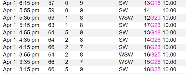

Wind wasn't the best for accuracy assessment but I still had fun. This covers the time-frame I was shooting.
The purple are the gusts, the black right in front of it the sustained wind speeds. So call it an average of 15mph sustained and 26mph gusts. Lol, yeah, it was windy for 20fpe.

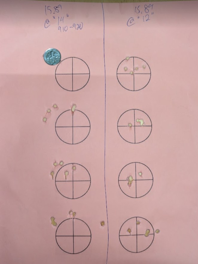

Decided to move over to the 15.89s after that, only shot them on paper at 55 yards. Same scope zero but had to take 7 clicks off for vertical to be correct so looks like a 30 yard zero for the 20fpe tune with the 13.73s and a 55 yard zero for the 29fpe tune with the 15.89s. Left column here was "14" on the hammer tension wheel which was 915fps average during the previous chrono session. Right column was with it on "12" on the wheel so probably 900-910fps. To me, seemed to do a bit better at the slightly slower speed. 3 of them are almost covered by dimes.

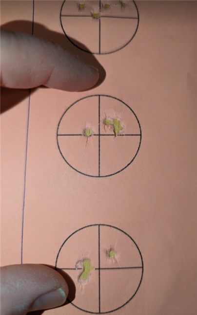

And the really cool thing is that two of the groups had 4 of the 5 shots in a hole about 2.5-3 pellet diameters wide. The next photo is zoomed in enough to see the lead smears of the 4 pellet strikes going into nearly the same hole...That's at 55 yards in 15-28mph winds with no hold off!!!
