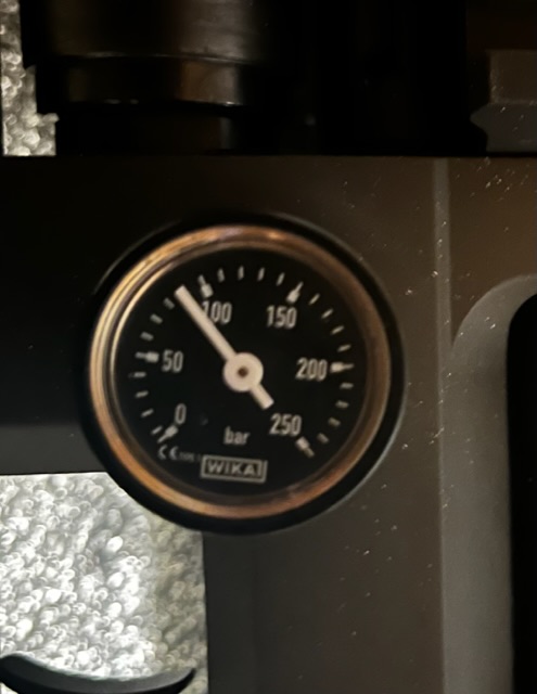

Just put 1 of the larger huma gauges on for the reg. It says 85 bar instead of almost 100 that the stock gauge read. I’ll be happy if it will shoot 13.4 rd’s at 815 consistently and 13 h&n and possibly 15 gr nsa to over 900 - 920. Thats enough power for what i want it gives me a nice .2 flatspot from 25-50 yds an still gives good trajectory at 100. Can’t wait to get out and see what it will do @50&100 cause inside it’s damn amazing!

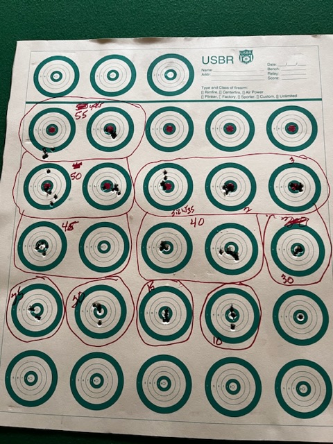

Well got out today as i have a match in 2 wks and it’s supposed to rain the next 2 wks! Now remember i got this gun 3:30 yesterday, went out to get my scope wheel marked in 5 yd increments and shot 5 shot groups at each yardage. Strelock seemed to be somewhere out in left field on this 1 as it was off near and far. Don’t know why just yet cause strelock matches the chair gun data? Anyway here’s a pic

Groupings look pretty dang good, especially for such prelim results. From the distances I presume this is in prep for a field target match? 13.4s @ the 815fps you mentioned yesterday?
Regardless, looking good!
I thought so too especially since i was doing it very quickly as it kept threatening to start raining! Id get a few drops for a min then a couple minutes later same thing. Im really hoping the lighter hammer spring gives me the adjustability to get up to around 920 from this 815 setting and for me this will be perfect! Oh and yes ft match in 2 wks

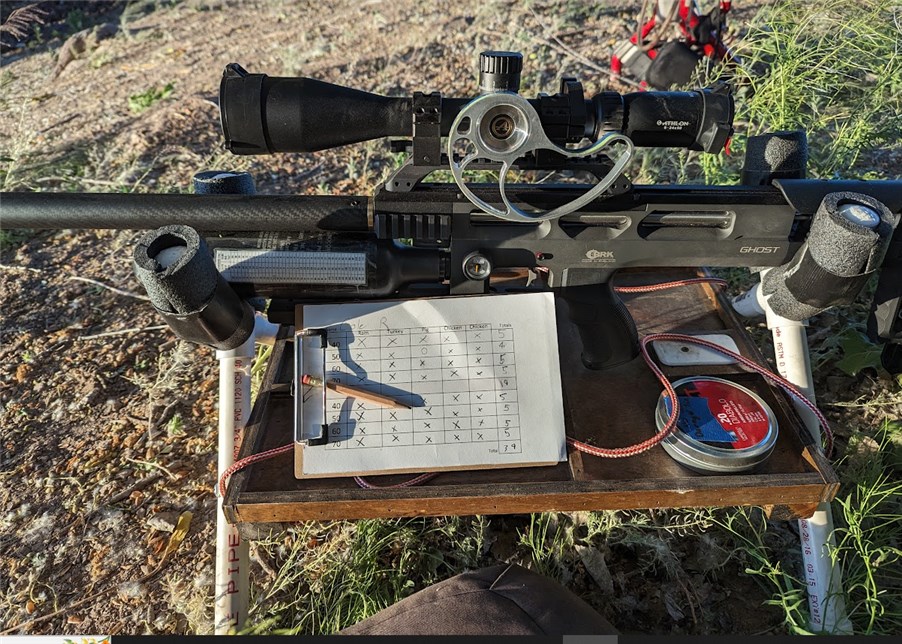

Had another competition experience with the Ghost this past weekend-sub 20fpe silhouettes and field target.
The long and not Ghost-specific version is here: https://www.airgunnation.com/thread...an-az-ft-and-silhouette-match-report.1289226/
The more Ghost-heavy version will be shared here.
This was the first competition with the .20 cal barrel, and it went well. The Ghost was the highest scoring gun in the silhouette match, achieving a 39/40 in gusts up to 25-mph and shooting tiny little chickens out to 70 yards, from a bumbag. (chickens are roughly the size of a 50 cent piece). The next highest score was a 35/40.
My silhouette miss was a pulled shot, notice it was on a larger animal on one of the closer distances. Perhaps I could see the larger .20 better than the .177 shooters and that played into the success of the Ghost .20 in silhouettes? but I saw that pellet arch right between the legs of the pig, perfectly coinciding with yanking the trigger, and therefore the gun, ever so slightly lower than intended.
The Ghost went on to shoot 49/52 in the field target course. Course Troyer was 32, so not incredibly difficult, but hard enough. That 32 is higher than many grand prix matches. I was the only shooter on a bumbag (Open class) but looking at the overall results, only one rig scored higher (a 50/52 in Hunter class).
