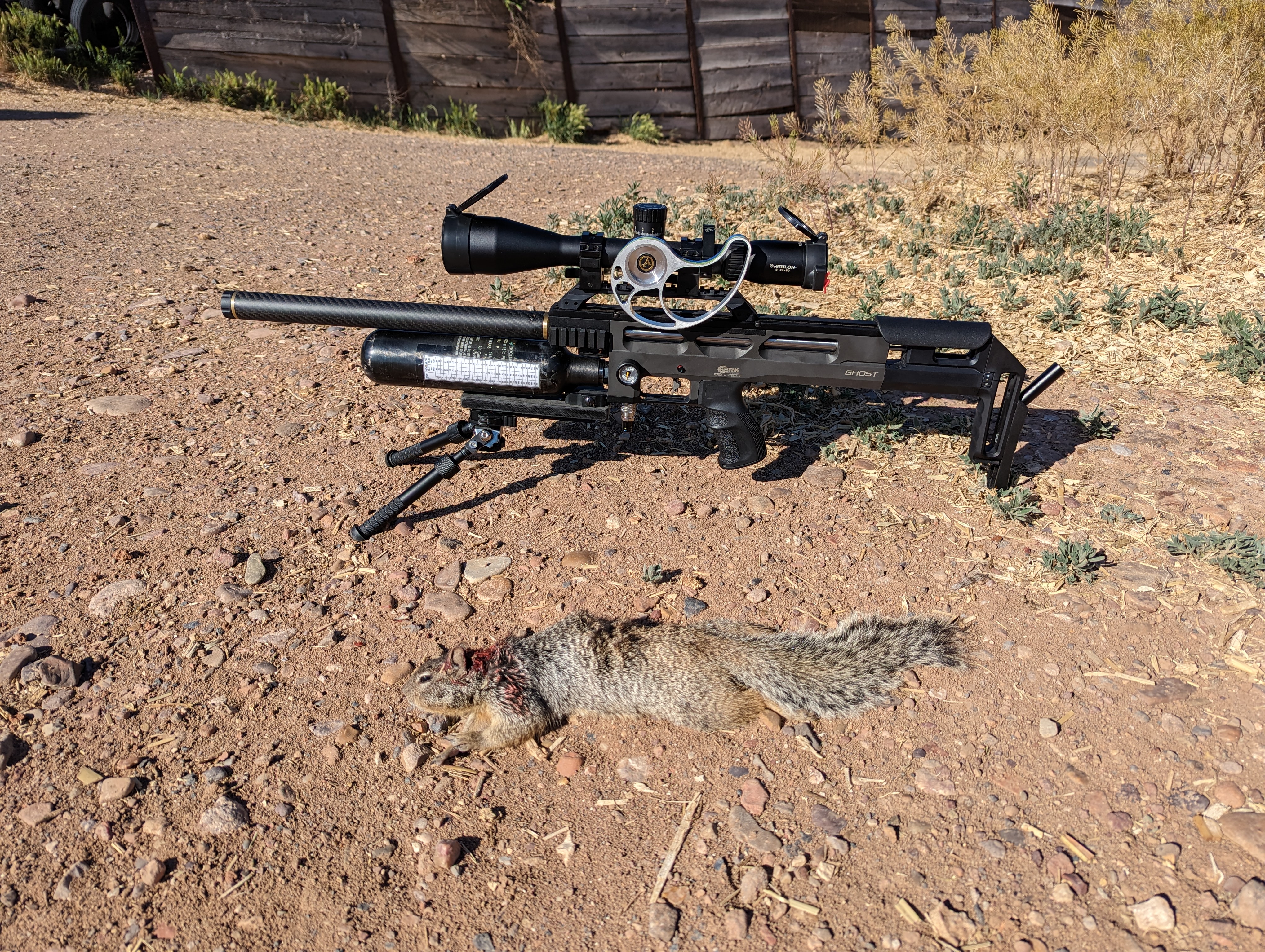

Ground squirrel, rock squirrel, dirt mover, etc. Whatever a person calls them, they are a CHALLENGE to get.
This one was dropped alongside a silage pit. My cousins and uncle take potshots at them in this location, using iron sighted .22 rimfires and cb shorts. They don't often connect, but they do condition the local population to be VERY wary.
The unfortunate victim was sunning himself at a lasered 46 yards. From an accuracy perspective, that's a gimme from the Ghost .20. One shot one kill, using the .20 Heavies at 915fps. Dead before he hit the ground.

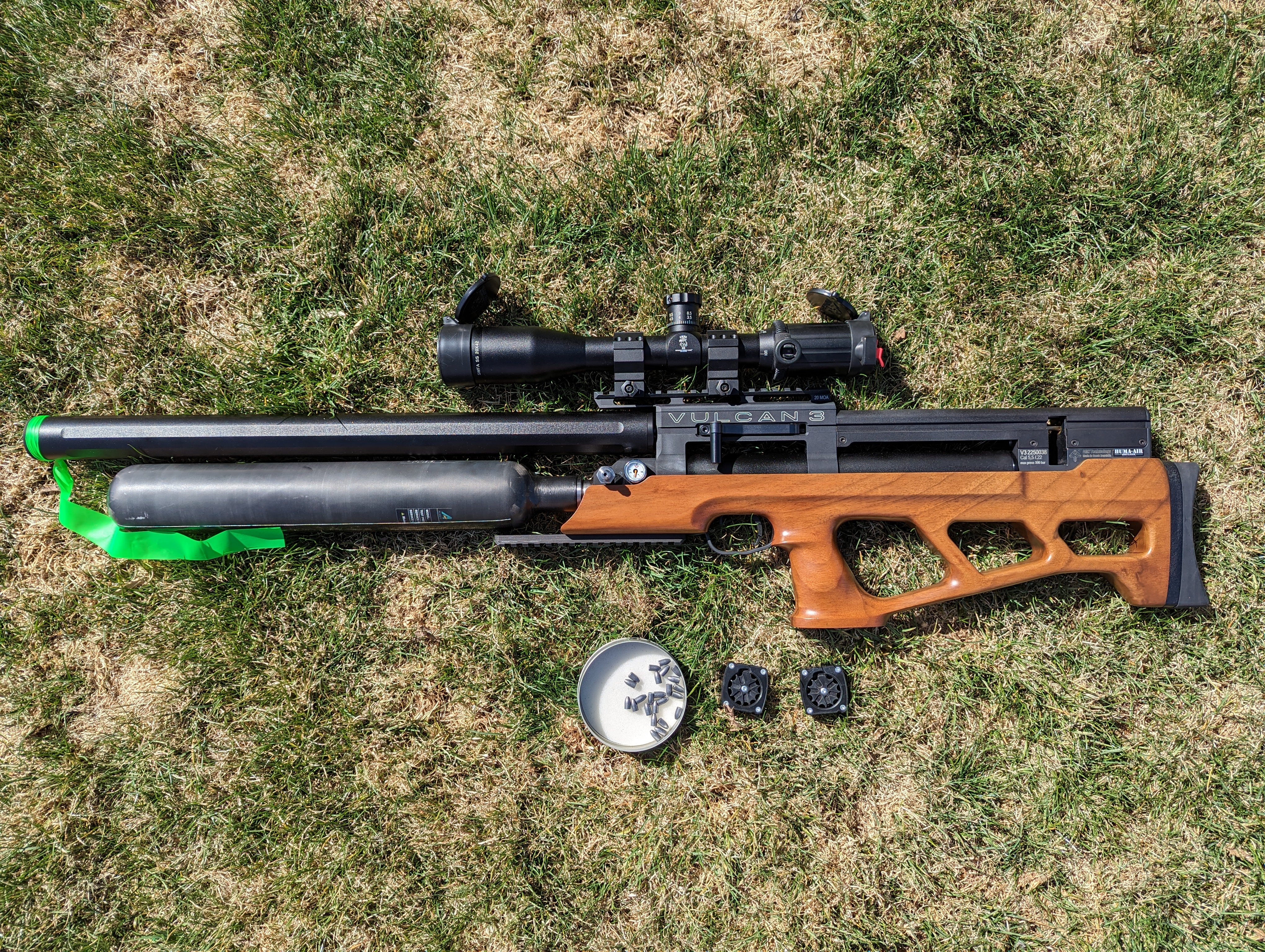

Here's a 700cc bottle on a Vulcan 3 that I borrowed from a friend for a couple weeks. Not a Ghost and wood stock but gives you an idea of a barrel-shrouded bullpup with a 700cc bottle...
Would it look hideous on a Ghost? I personally don't think so, especially if it gets more shots per fill. I'm always a fan of more shots per fill, and if your desire is throwing heavy stuff like the new .30 Zan, you're gonna need/want more shots/fill. You could always put a longer moderator on to balance out the "look." The only 0DB I have (and therefore the only one in any pics in this review) is the 110c, which is pretty short, as far as moderators go.
