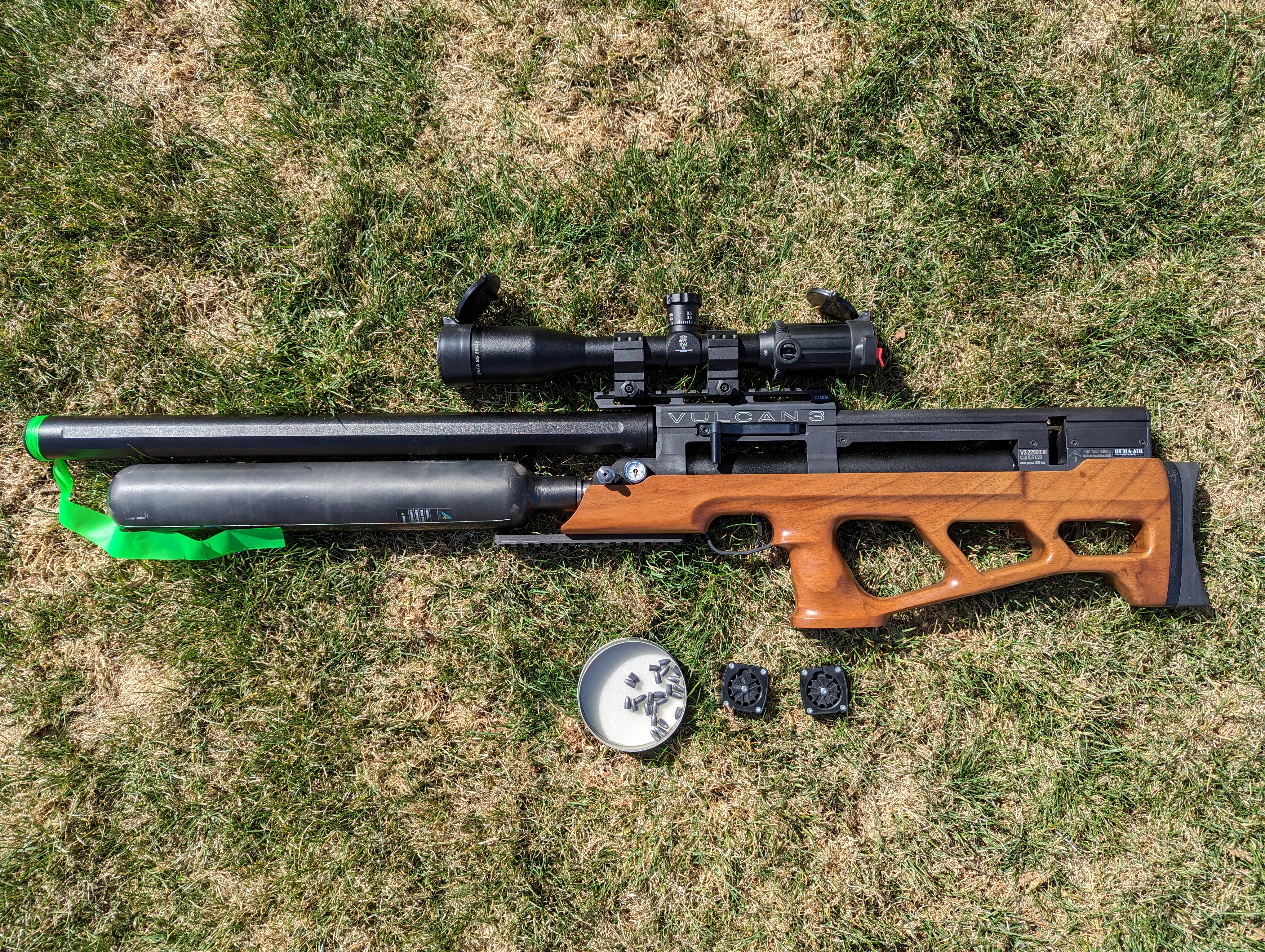

Here's a 700cc bottle on a Vulcan 3 that I borrowed from a friend for a couple weeks. Not a Ghost and wood stock but gives you an idea of a barrel-shrouded bullpup with a 700cc bottle...
Would it look hideous on a Ghost? I personally don't think so, especially if it gets more shots per fill. I'm always a fan of more shots per fill, and if your desire is throwing heavy stuff like the new .30 Zan, you're gonna need/want more shots/fill. You could always put a longer moderator on to balance out the "look." The only 0DB I have (and therefore the only one in any pics in this review) is the 110c, which is pretty short, as far as moderators go.

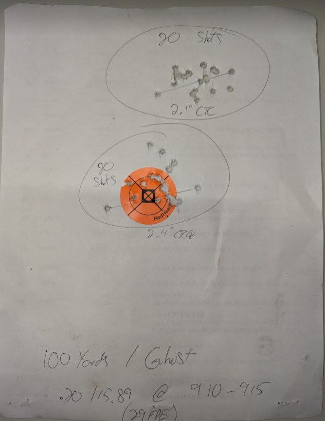

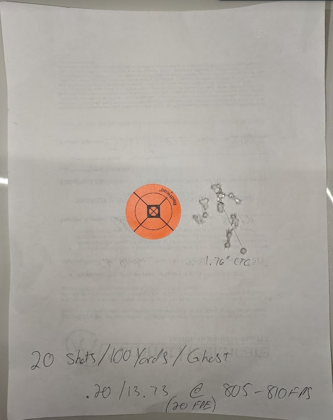

First, the 20fpe .20 (from the Ghost)
Next the 29fpe .20 also from the Ghost, just dialed the power wheel and swapped pellets. I dialed a couple clicks of elevation into the scope and repeated the 20 shots with a tighter hold to see what effect that would have on the groups. The orange-centered group is the loose hold, the group up above is the tight hold.

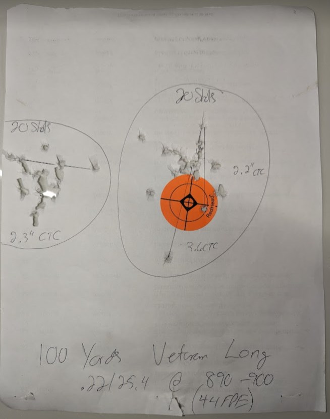

And finally, the "control," the .22 Veteran Long, shooting the .22/25.4grain Monster RDs. I think I've only shot one pellet from the gun in the last 4 or 5 months (that pellet absolutely destroyed an English Sparrow). Anyway, the first 20 shot group here is me being out of practice with the Vet Long, but it also contains at least one flyer, the curse of the .22 MRD, that low shot was the flyer than can nearly be counted on from the MRDs. After the first group I dialed in a couple clicks to the left and shot another 20 into the group on the left. No flyers from the second group (that means I can expect at least one flyer in the next 20 shots out of the Vet Long, lol dang MRDs).
Conclusions
  • I don't think I have any flyers from either .20 pellet, or at least not any horribly egregious ones.
    • (For extreme field target we're usually shooting at 3 inch kill zones at 100 yards, so happy to be able to put 20 shots into the same 2-2.5 inches that I wanted them to go. Furthermore, keeping that many consecutive shots under 2.5inches at 100 yards is plenty accurate for just about any pest species I'm going to be going after).
  • Ghost seems to shoot just a bit better with a tighter hold, and also made the group print a bit to the right when compared to the looser hold.
  • Can you believe that 20 shot 20 fpe group at 100 yards!?!?! I sure didn't expect the 20fpe to be the tightest group. Although that very gentle left to right definitely pushed it that direction a bit. Although, of these three setups, the .20/13.73 at 20fpe would be the third choice on a windy day.

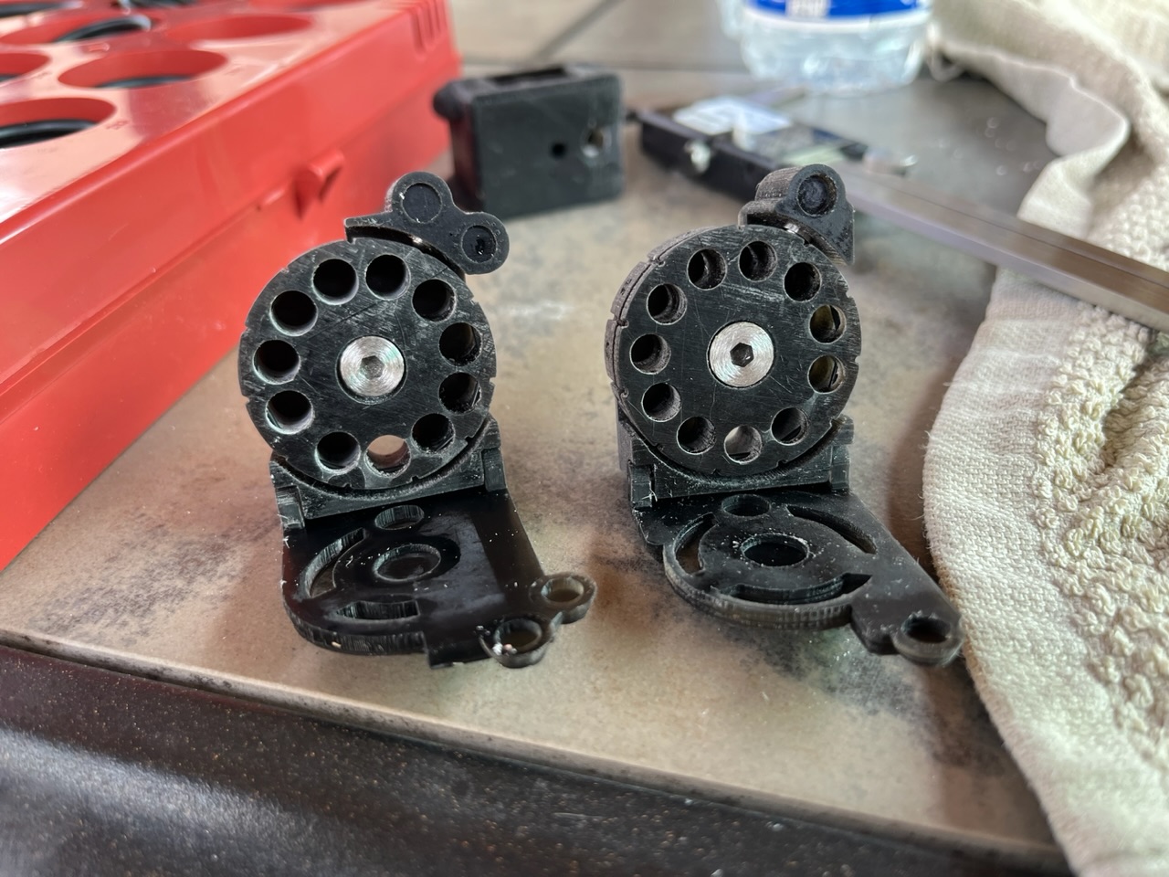

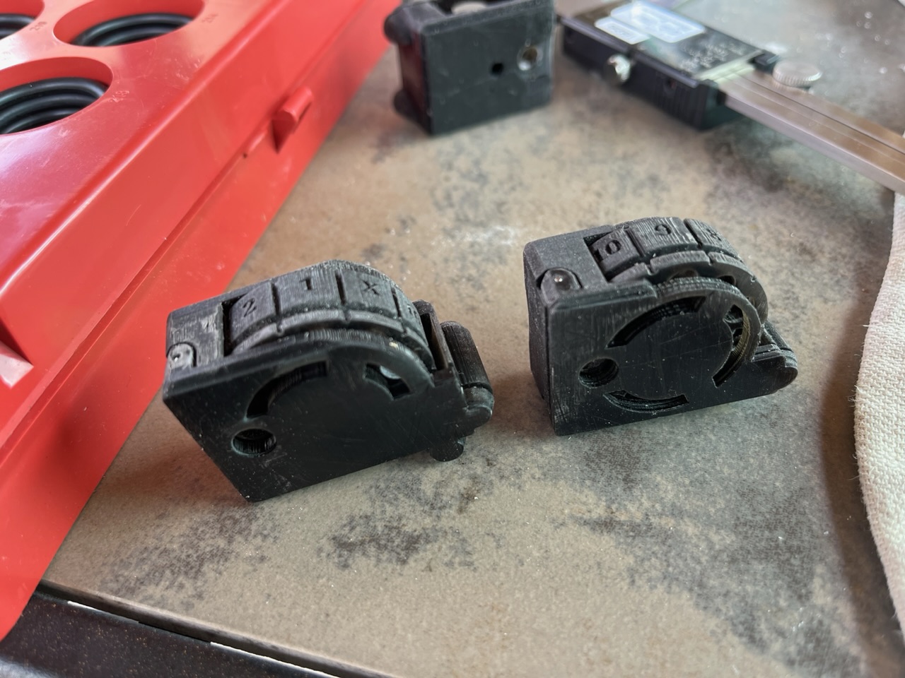

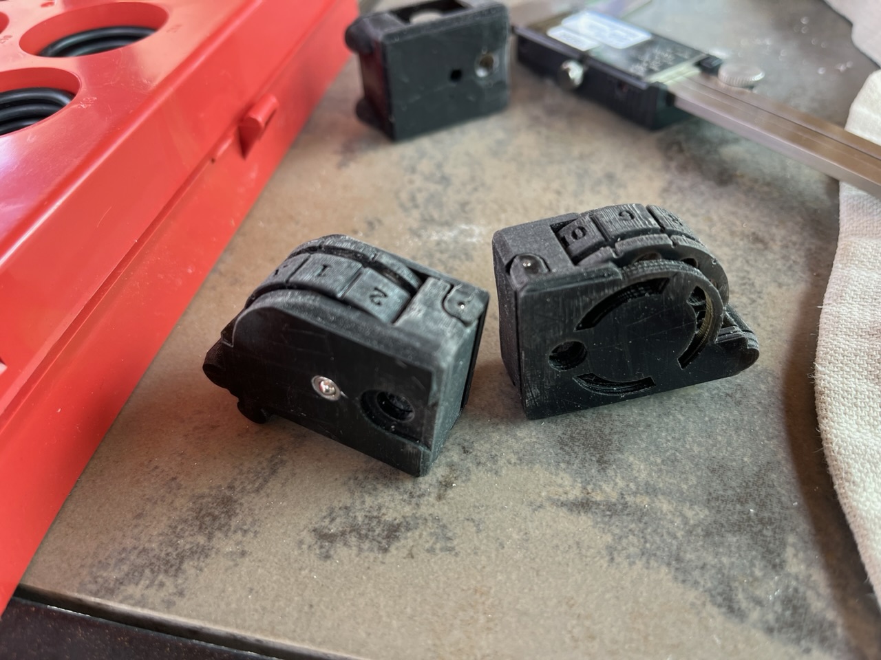

View attachment 361742View attachment 361743View attachment 361744
Franklink's rifle will need a 22 cal mag or loader. Since no 20 mag was available, I fitted the 20 barrel to use a 22 probe. This will not fit through a 20 magazine. The stock 22 magazine works ok as there is only 0.020" difference in the ammo but can be a little fiddly.

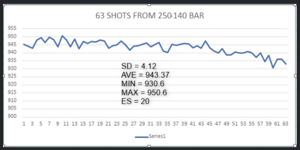

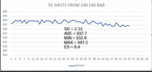

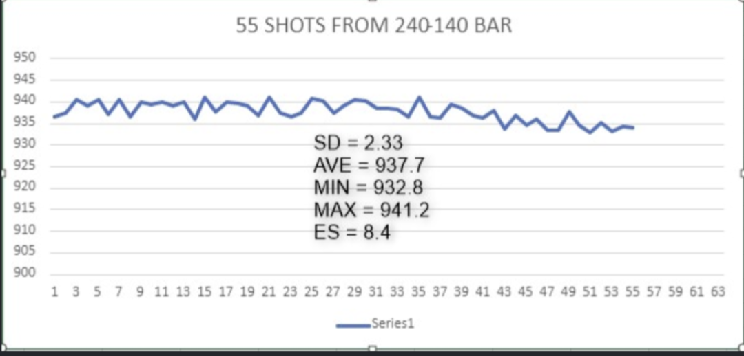

The most solid data I could find on shot counts was from the .22 HP configuration. This is from post #317.
With a strict inclusion criteria of single digit spread, it was good for 55 shots at just under 50fpe as a .22 (480cc bottle).
With less stringent ES requirements, good for about 65 shots at 50fpe, again, as a .22 with the 480cc bottle.
Other configuration's shots counts, from memory and rough estimates....
120-140 shots as a 19 fpe .177 (with 300cc bottle)
220+ shots as a 19.5 fpe .20 (with 480cc bottle)
This is of course specific to how I've configured those tunes. For example, with the 19.5fpe .20, I'm running a reg pressure of 140bar, for two reasons. The first is that it allows me to get 30fpe with the .20 Heavies by just spinning the hammer tension wheel. The second is that I like the crisper shot cycle (has a bit of blaaaaaaat feel with low reg pressure "tunes"). So, with a low reg pressure/19.5fpe tune in .20, shot count would likely be different than what I'm seeing.
