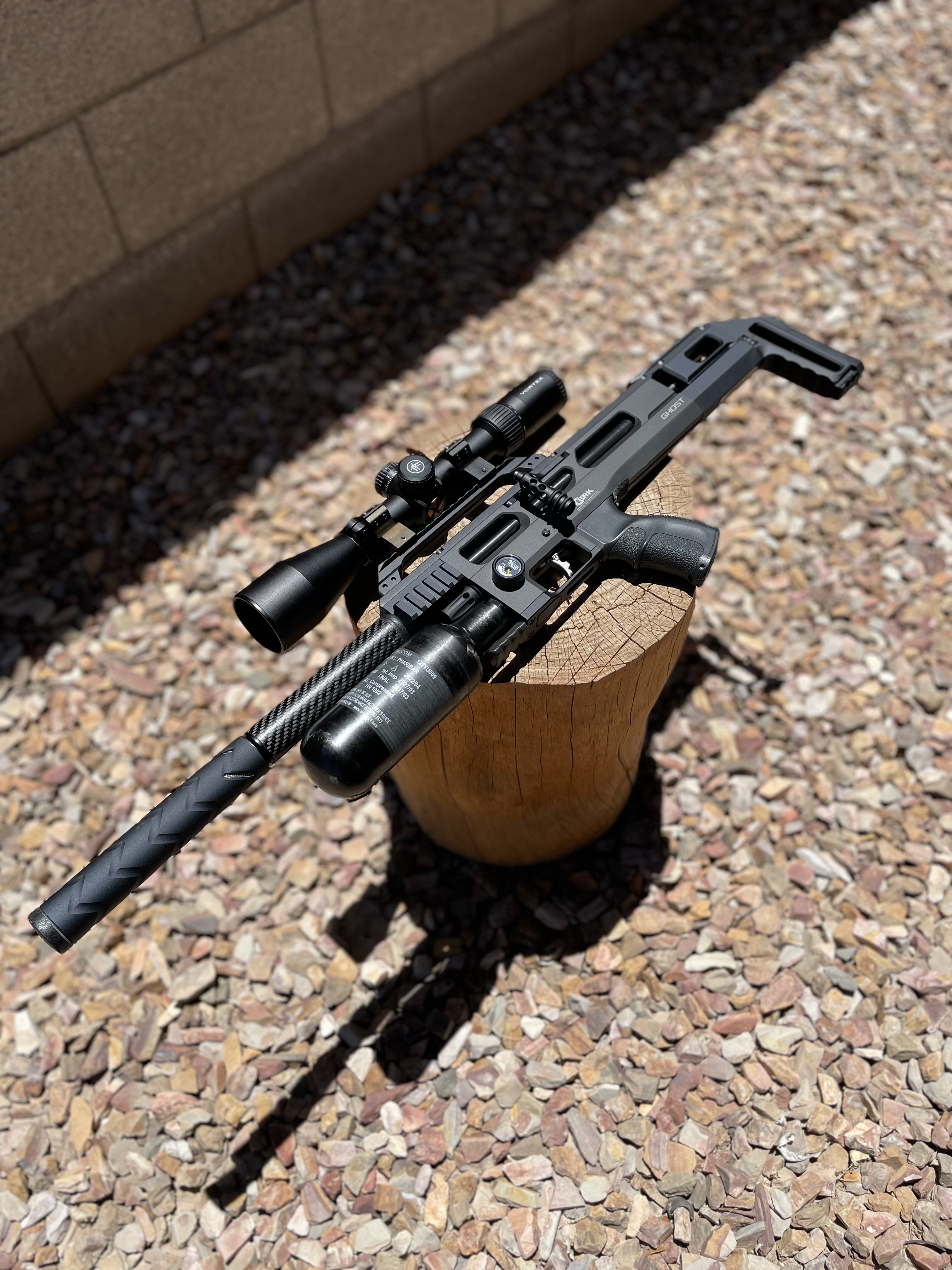

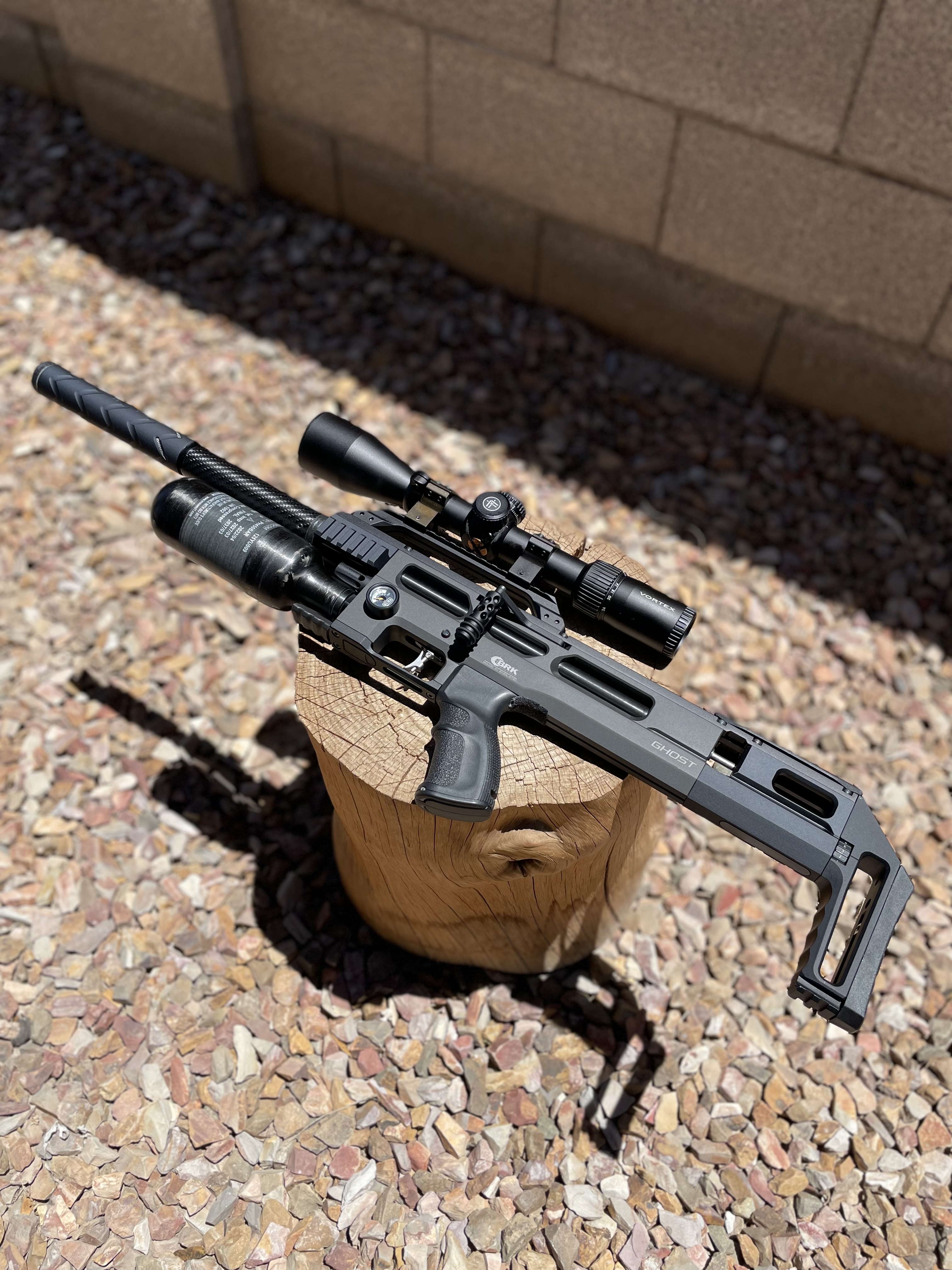

Fine looking guns.

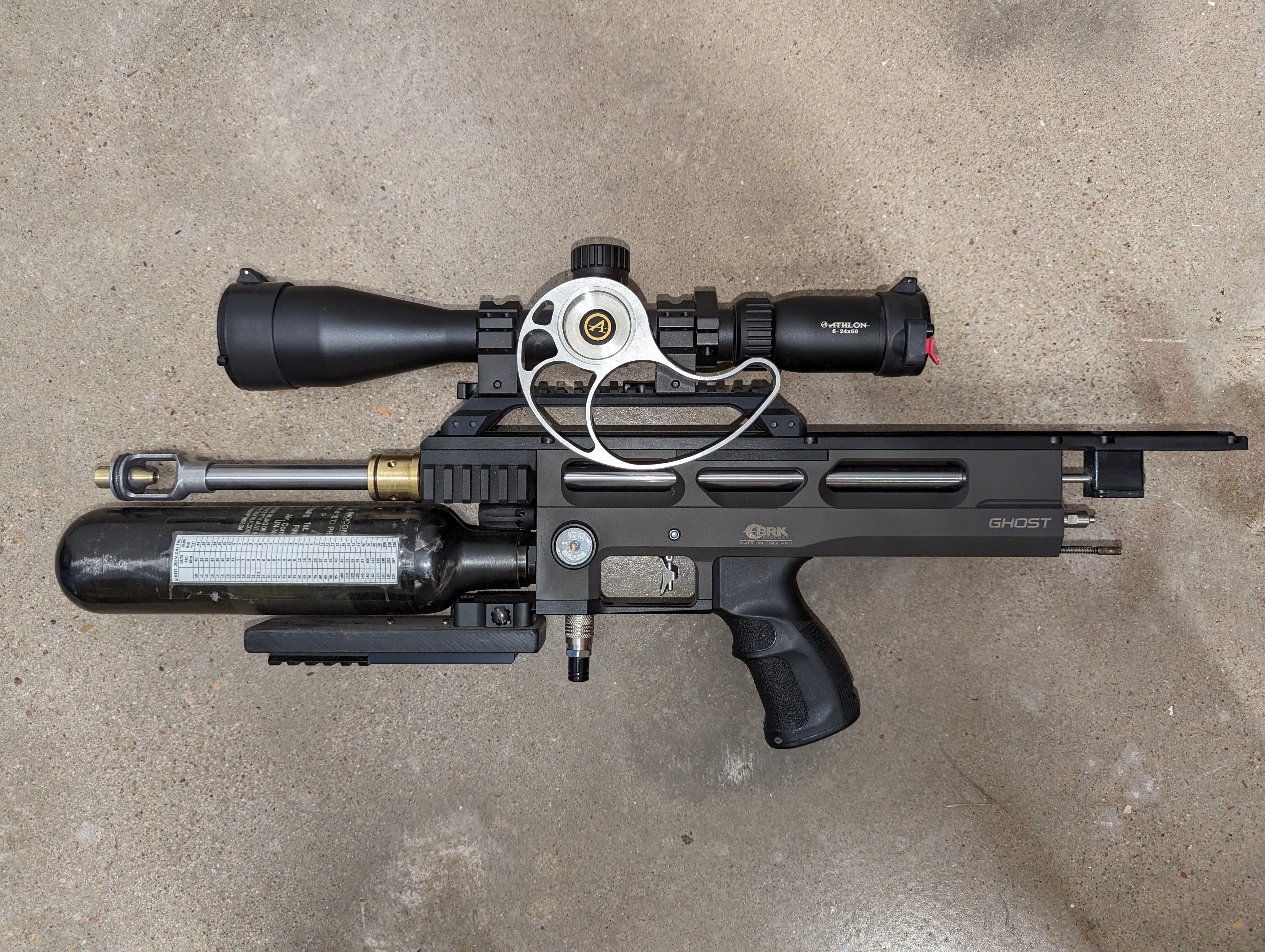

I couldn't help myself & ordered one of these up in .30. Just so many good groups being had at distance to not see what is up. I did a 580 bottle , Left hand cocking, small Odb mod..I'll use a saber rail extension, 20x sightron SIII,Althon low rings & see what she can do at 100. I'll try 44, 50.15 & ZAN56.

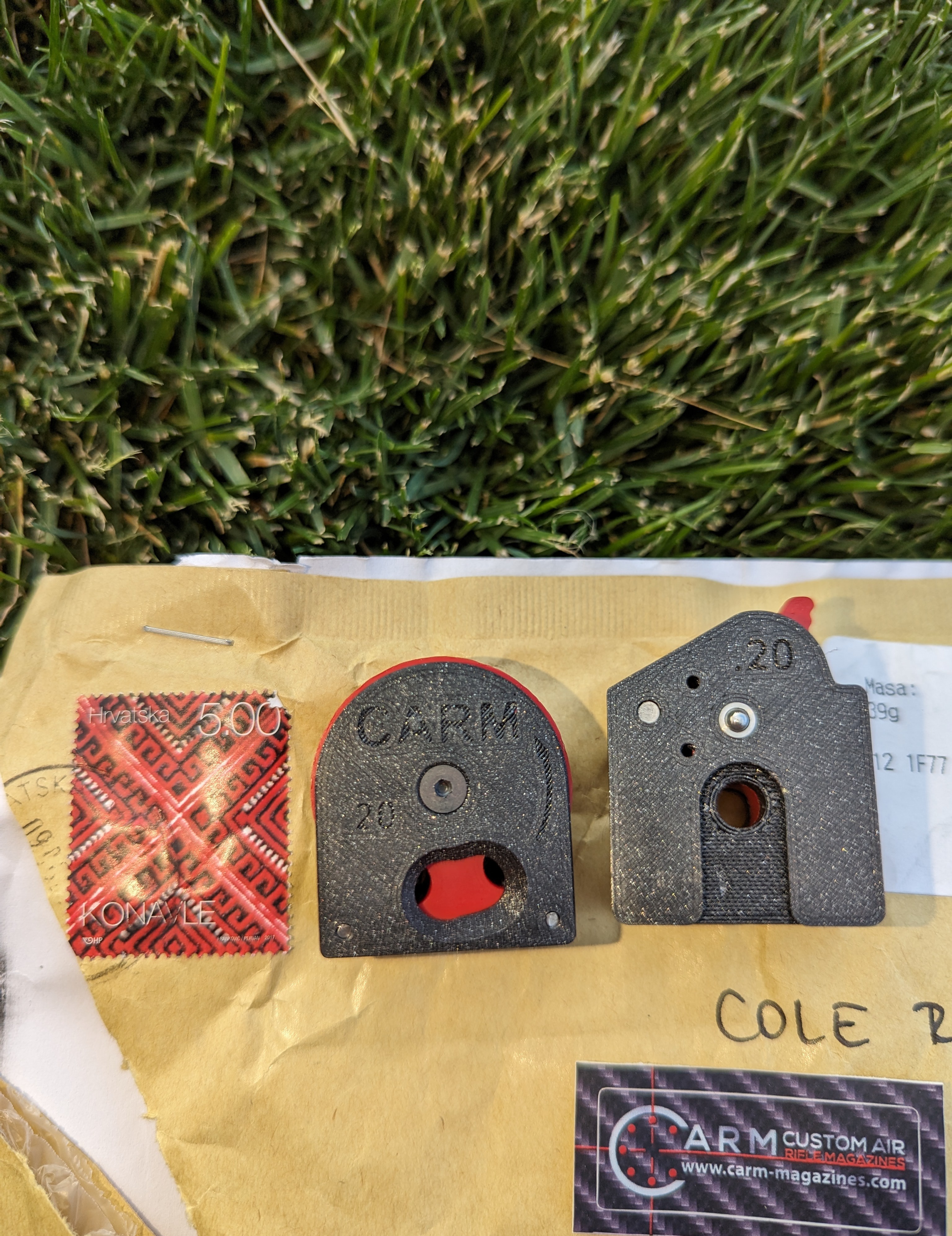

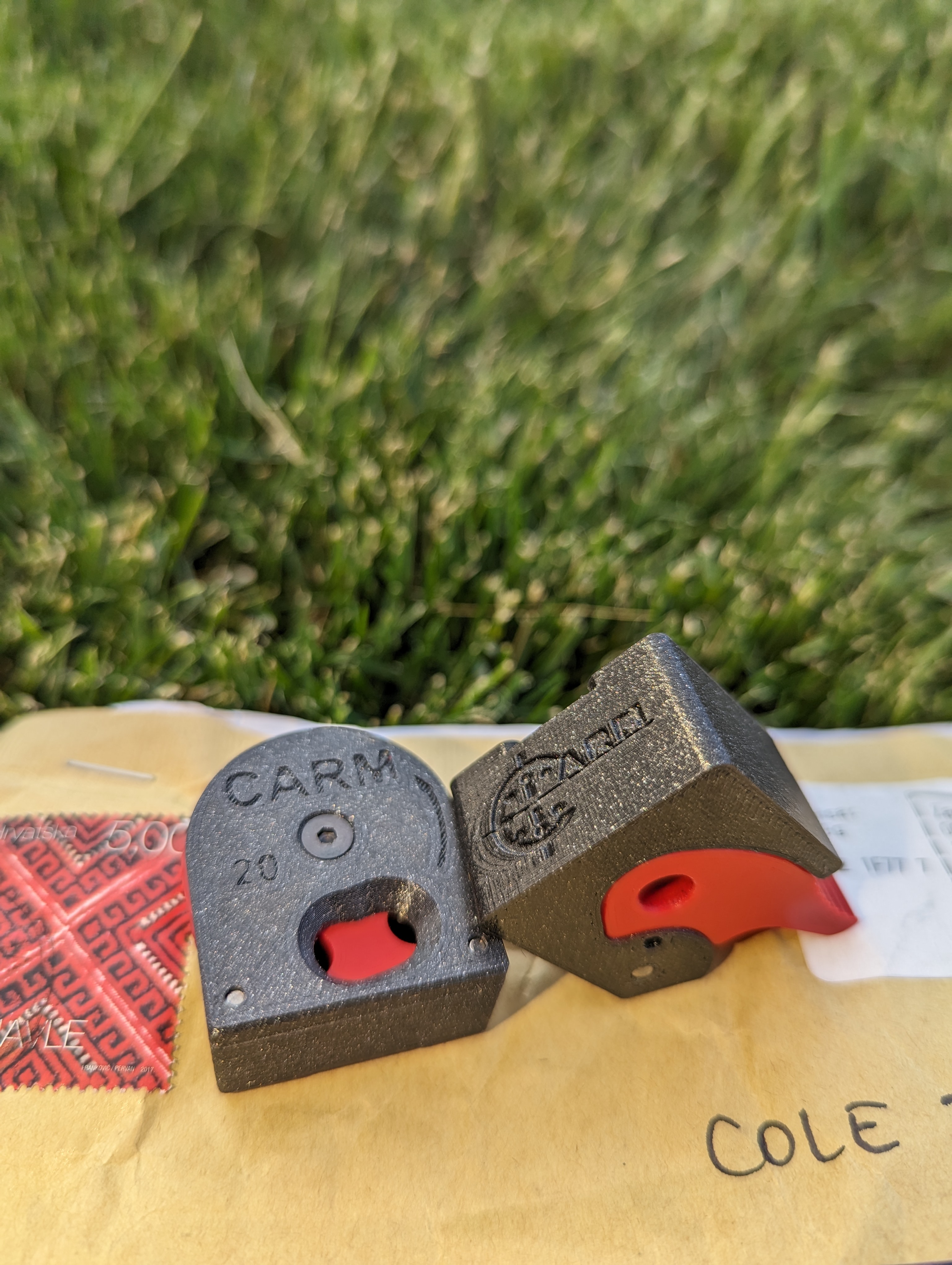

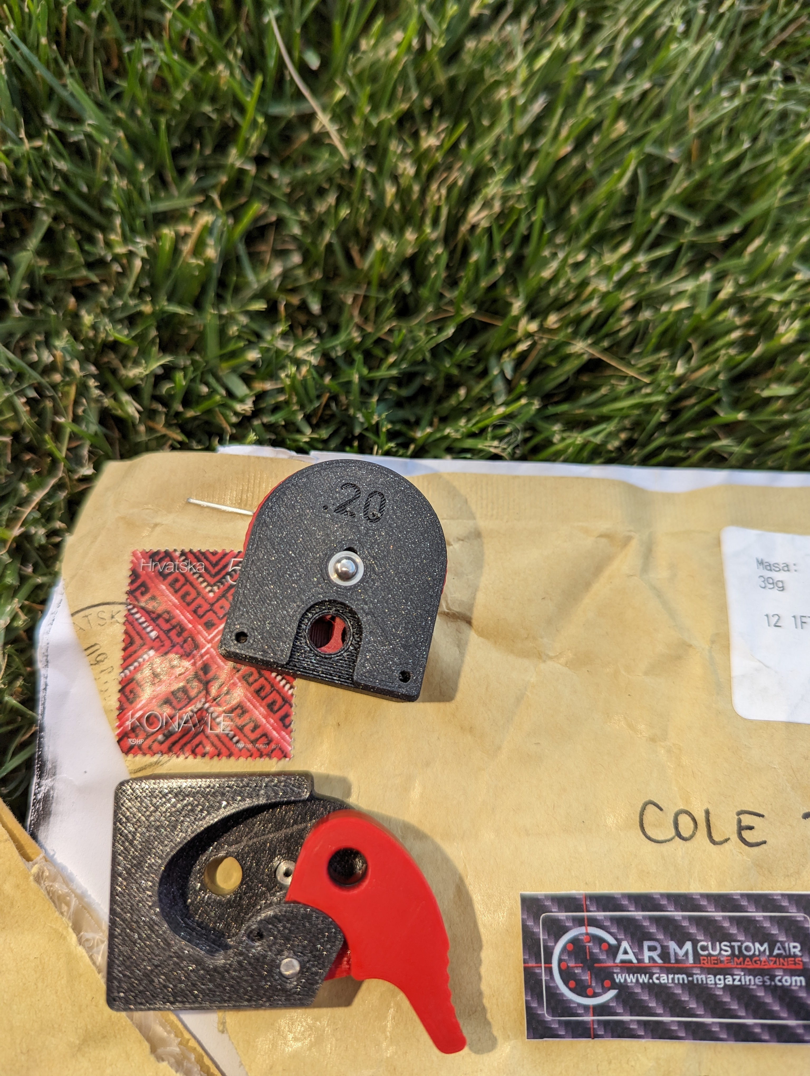

Darko sent me some cool stuff, received yesterday.
Tried em a bit last night in the fading light. Both function flawlessly, but I'm thinking I favor that flip open single shot loader over the magazine, just by preference.
Magazine has a nice stop after that last shot has been fired, bolt won't close again so you know you're on E. Pellets drop into each pellet well quite nicely.
Thank you Darko @ CARM magazines!

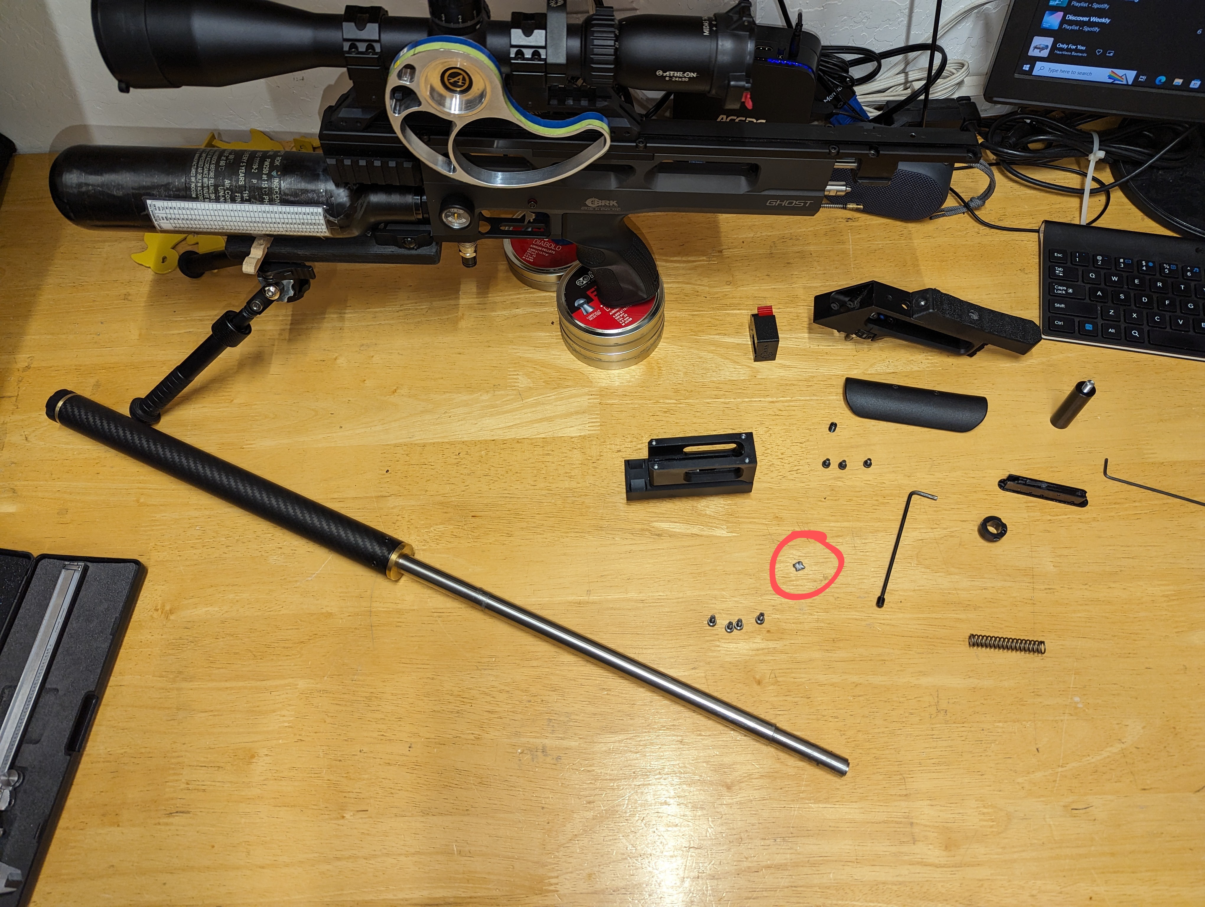

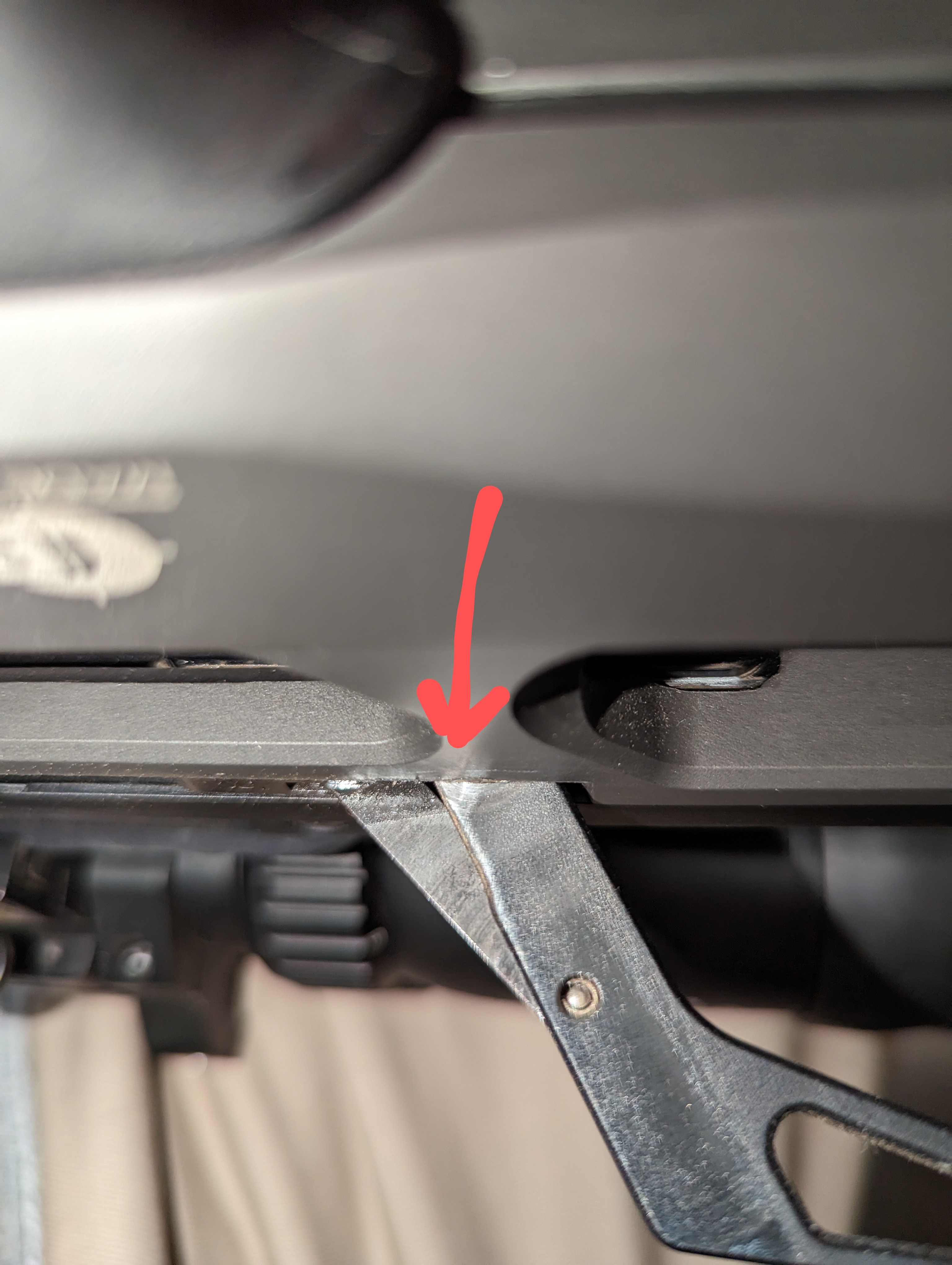

Well I dropped a pellet into the cocking block/hammer travel area last night. Slipped out of my fingertips just as I realized it didn't feel right. Of course, next shot the hammer didn't hit the valve stem so I knew a partial tear-down of rear end would be necessary.
And yep, smashed pellet /culprit circled in red here. I noticed clear tape across those open areas on Scotts Ghost at the Mormon Lake FT match about 10 days ago and he said he'd taped it off because the same had happened to him. It's obviously not a common problem, as I'm up around 8000 shots now and this is the first time, but it CAN happen while single-feeding and not paying attention.

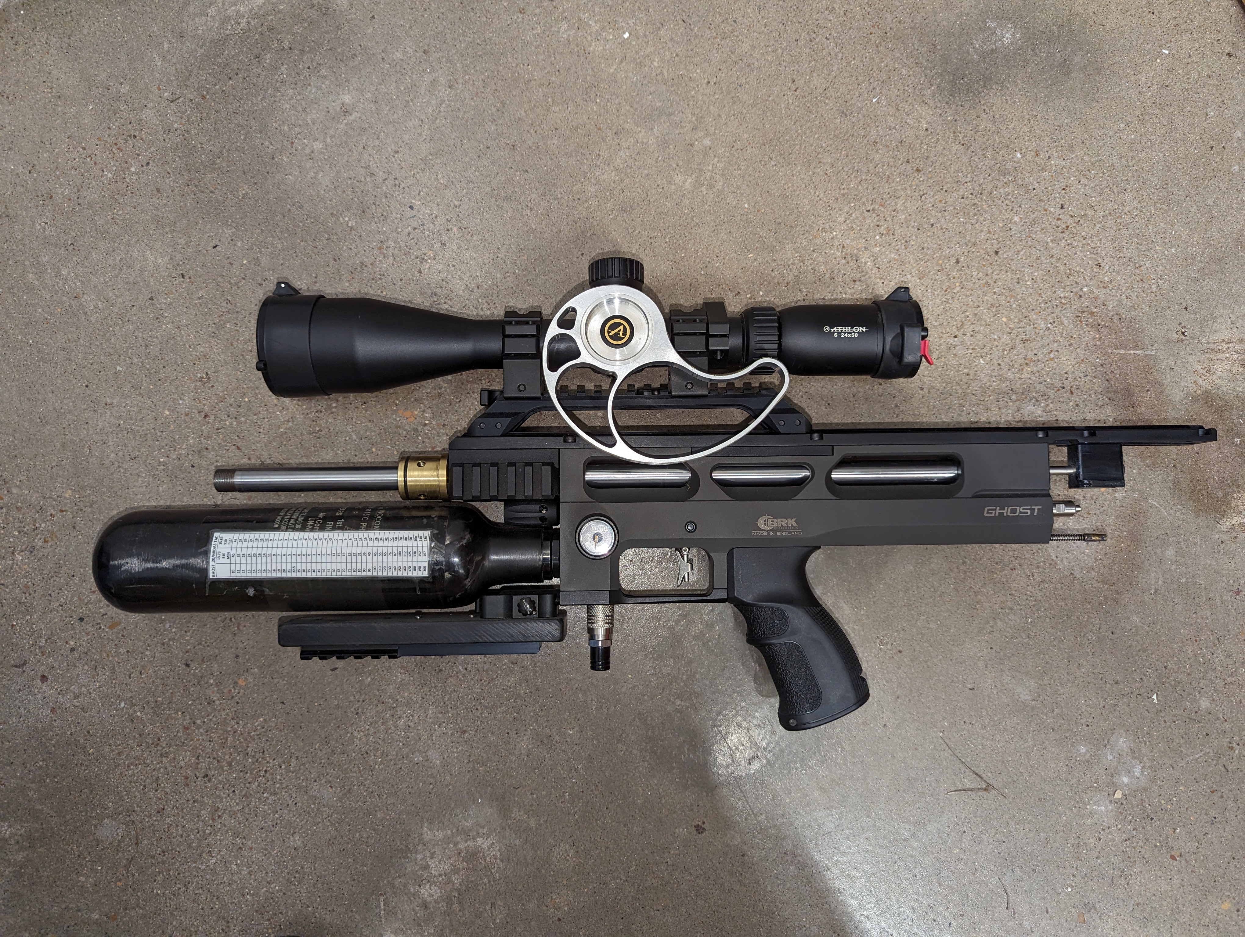

Decided now would be a good time for a deep clean on the .20 barrel. So shroud removal and some Gunzilla through the bore with a cleaning rod and patches.

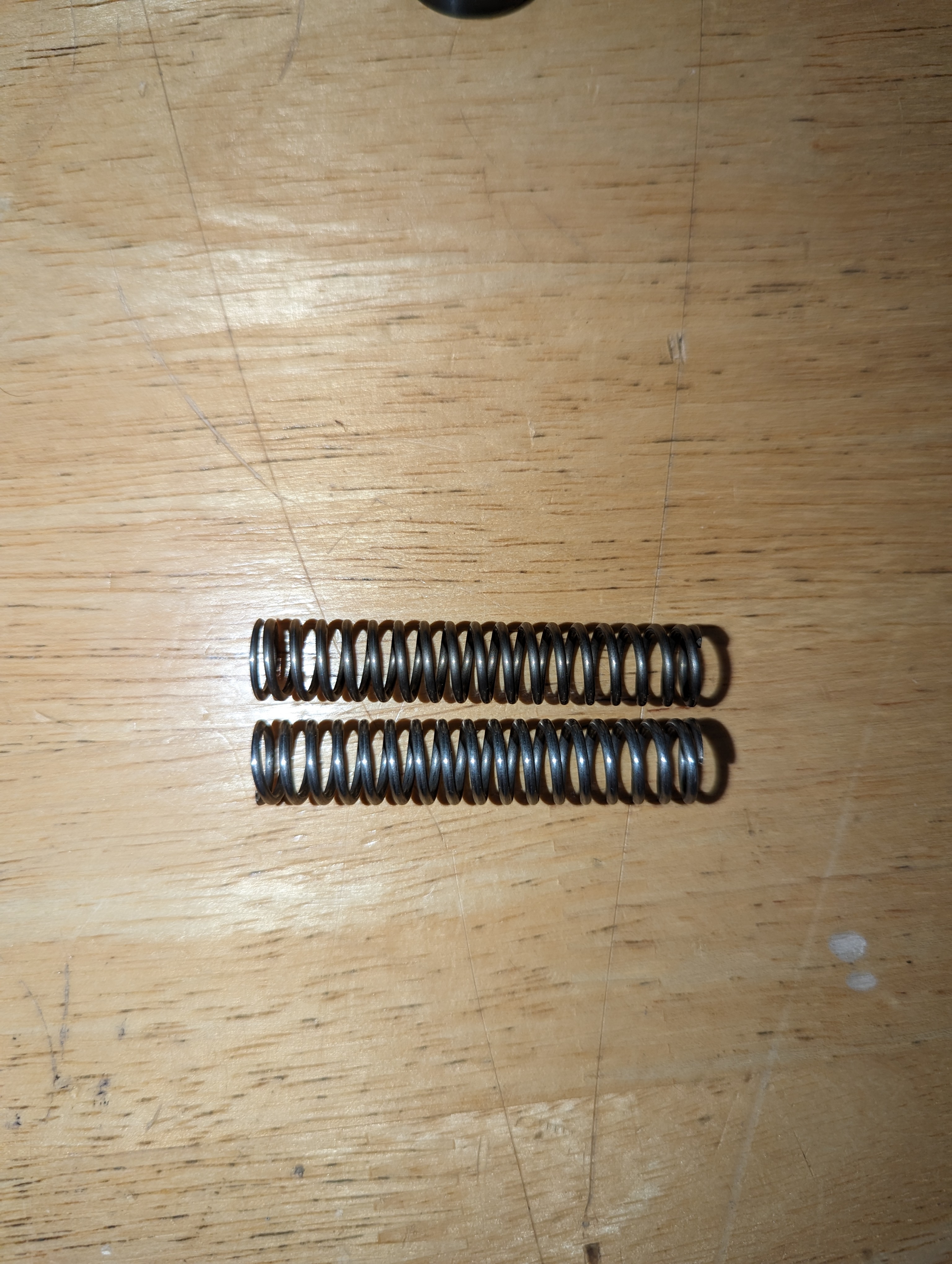

Also got interested in checking overall spring length as a proxy for "sag." This OEM 0.047" wire spring has been used for 99% of the shots taken from the gun. And it still measures 2 inches, just as it did when "new." Here it is next to the 0.052" wire OEM spring.
Also decided to look closely into the back of the hammer. @Arzrover told me a few months ago that his prototype Ghost has some sort of buffering device down in the recess of the hammer. Factory testing of a hammer debounce device perhaps? Anyway, this hammer does not have that. (I'm still using the lighter skelton hammer). For the tinkerers/curious types, there might be some gains on shot count or shot cycle by playing with orings of varying durometers down in the hammer, ala BStaley mod.
And finally, I'm happy to see the anodizing intact in the potentialwear areas of the gun. Mostly looking at: hammer raceway, triggers sears, and cocking block travel area. I'd hazard a guess that there aren't many Ghosts out there that have seen the shot count this one has, so it should be somewhat reassuring for owners (and BRK) to know that there's minimal wear on these areas of the gun at this point. On the topic of wear on anodizing, if I look really hard I CAN see some on the anodizing under the cocking lever. Here: (excuse the dust particles, this is a working gun)

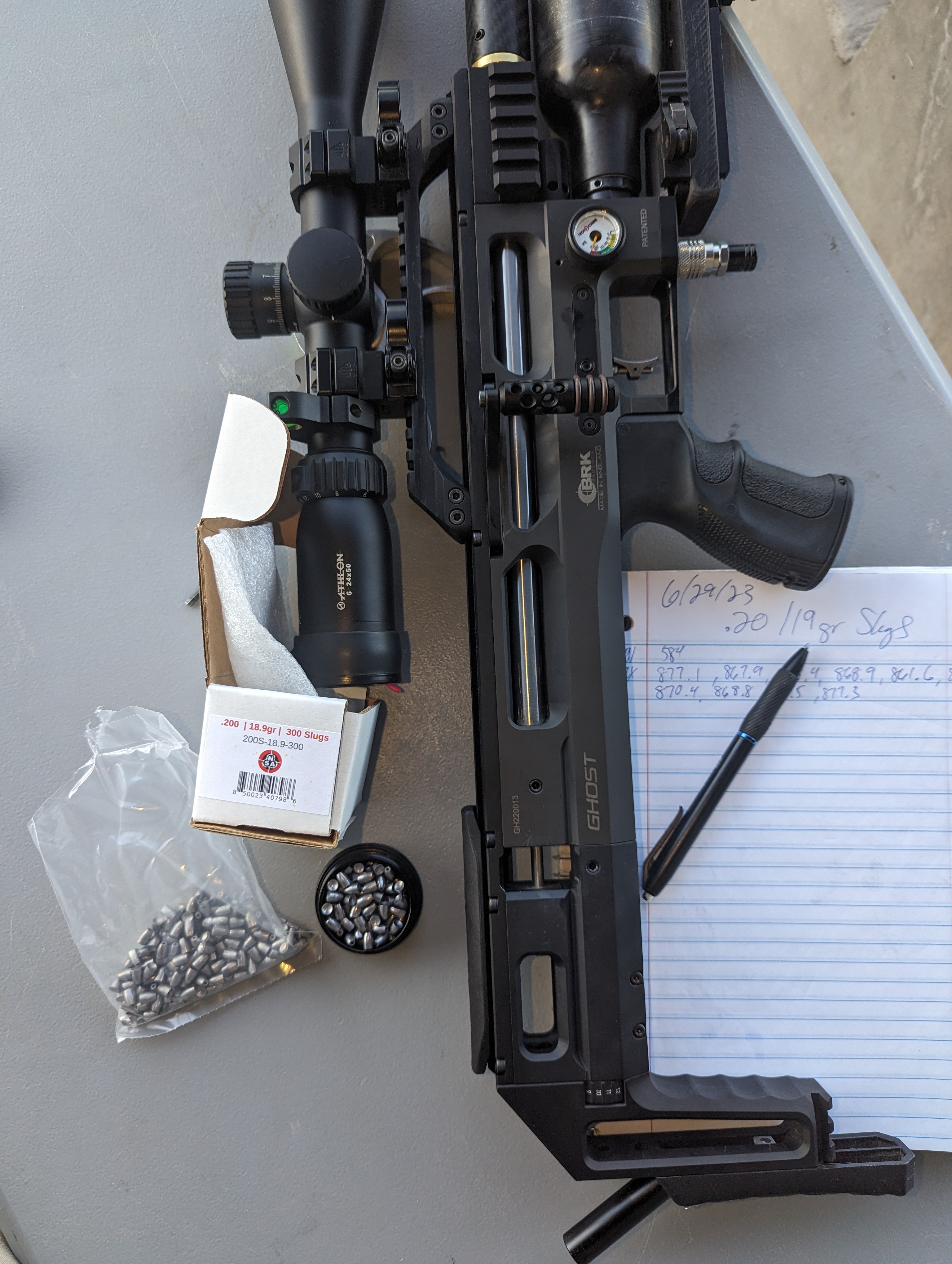

As an introduction to this little bit of slug testing from the Ghost, I want to state that I am not a big proponent of slugs. I've just had too many poor results from them to be very slug gung-ho. And that's from lots of quality barrels from lots of high-end airguns. The best barrel/slug/gun combination I've seen yet was the 34grain Varmint Knockers at 1000fps, from a Derrick Wall tuned Vulcan 3. And that was the best by a WIDE margin. I currently hold the slug record at a XFT @ PRGC match, and I used that V3 to do it. All the other slugs I've tested have been thoroughly unimpressive. A couple were "okay" but nothing to get very excited about. So, anytime I go into testing slugs from a new gun/barrel, I do so pretty skeptically.
I also want to state that I buy my own ammo.
With that out of the way...
A couple years ago there was talk here on the forum that NSA had sent out some prototype .20 slugs to @Motorhead for some beta testing. Having tooted the .20 horn for 5 or 6 years now, I was pretty excited about the prospect of some .20 slugs, but Scott reported that accuracy from those beta slugs was pretty ho-hum, and the idea seemed to die there. Fast forward a couple years and Nick announced that .20 slugs were now available for sale. From memory, this seems like it's just been a few months. With my glass-half empty feelings on slugs, I wasn't too crazy about buying some, instead hoping somebody else would do some testing on them. Well, I haven't seen many reports on how they do, so I ordered some earlier this week.
And last night I shot some, of those 18.9grain .20 NSA slugs, 116 to be exact. And I'm going to report on all 116 shots.
I did lube them up, pretty liberally, with Gunzilla. One of my gripes with slugs is how they're so bad about leading up barrels. The Gunzilla has seemed to help in both reducing the leading, as well as making it easier to clean once the inevitable required barrel scrub arrives.
As a recap, I'm using the lighter OEM hammer spring and the skeletonized lighter hammer that came in the Ghost when it shipped as a .177 Ghost Carbine. Reg pressure at 140 bar. This tune puts out the 13.73gr JSBs @ 805fps and at "11" on the wheel, shoots the 15.89grain JSBs at 910-915fps. The only adjustment I made for the .20 slug testing was the hammer tension wheel.
1st shot with the .20 slugs = 584 (wheel on "MIN")
Cranked the wheel to max and took ten more shots, again just over the chrono into pellet trap in the garage. Those ten had an average speed of 870.5fps, with a 15.7fps extreme spread. Decided at this point to shoot them on paper so moved it all outside. The rest of the 116 shots were all at at average speed of 870fps.
Set up paper at 31 yards and 53 yards. The circles I'm using as aim points are 1 and 3/8" across. No hold-offs for wind on any of the accuracy assessment shots. I guessed winds were around 10mph but nearest weather station recorded sustained winds at 13-17mph and gusts up to 28mph during the 600-700 pm shooting session. I don't think I had that much at my house, but definitely had some wind.
