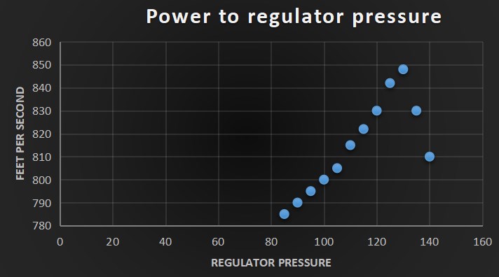

Yep. When choosing to run with a low reg pressure that low reg pressure becomes the power limiting factor. Ie, can hit the valve harder (by cranking up the hammer spring tension via the wheel) but not get any more power because you're limited by the lower reg pressure. But when choosing to use a higher reg pressure, you can tap the valve lighter to restrict power, or tap the valve harder to get more power (by adjusting the hammer tension) and there's enough high pressure air there for the harder valve tap to have an effect (an increase in speed). This effect is even more dramatic when using a light hammer spring.
I want to mention that another interesting phenomenon occurs when using a lighter hammer spring.......the power output to regulator pressure relationship peaks around 125-135 bar. Not sure I worded that well so I'll use an example of the .20/13.73. With a reg of 95-100 bar, I can get them to shoot at a very consistent 800fps. As I increase the regulator pressure though, the speed goes up too. So, somewhere around 105-110 bar I'm no longer field target legal (they're going about 820fps). As I increase the regulator, the speed keeps increasing, up to a max of about 850 @ around 125-130bar. And then the power/speed curve goes the other way as I continue to increase the reg pressure. At about 135bar reg pressure the speed is back down to 820-830fps and at 140 bar, I'm back down to ft legal at 805-810fps. And that entire example was with the hammer spring tension wheel on "MIN."
Let me jump on a computer and try to graph it so it'll make more sense....
(this is just from memory, I could go digging through my notes for exacts, but this is the gist of the scenario, learned through many hours of making adjustments and shooting over the chronograph).
I've previously mentioned that the gun seems more burpy at 800fps with a 95bar reg pressure and more crisp at 800fps with a 140 bar reg pressure.
The downside to using a higher reg pressure to restrict the power is that the first few cold shots will have a lower fps than all the rest. But it seems the gun has to sit for a couple hours without being shot before that becomes a problem. I've shot a couple field target courses now where I didn't take any reg resetting shots. And that's because after sight-in, the gun never sat unshot long enough for those low fps "cold" shots to be a problem.
Going deeper than that, adding in some hammer tension adjustments, or changing the rate of the poppet return spring in the valve (either by a different spring, cutting coils, or shimming it) are additional ways to make the Ghost do what you want.
And all of that is the beauty of the Ghost platform, its adjustability. My current configuration of high reg pressure/weak hammer spring/light hammer is allowing me a broad range of power outputs, for the trade off of low fps "cold" shots. I like the easy cocking (weak hammer spring) and I like the shorter/crisper shot cycle of the higher reg tune, and I like that it allows me to simply spin the wheel to get more power out of heavier projectiles.
Any idea why this is ? And is it a common anomaly ?
I think it's just the nature of regulated airguns. This is one of reasons you always hear people mention "tuning on the knee." Because they're trying to avoid low fps shots from a "cold" reg. (Cold has nothing to do with temp, but rather a regulator I'm a gun that hasn't been shot for awhile).
So yes, common situation when using a higher reg pressure than necessary for the power output desired.

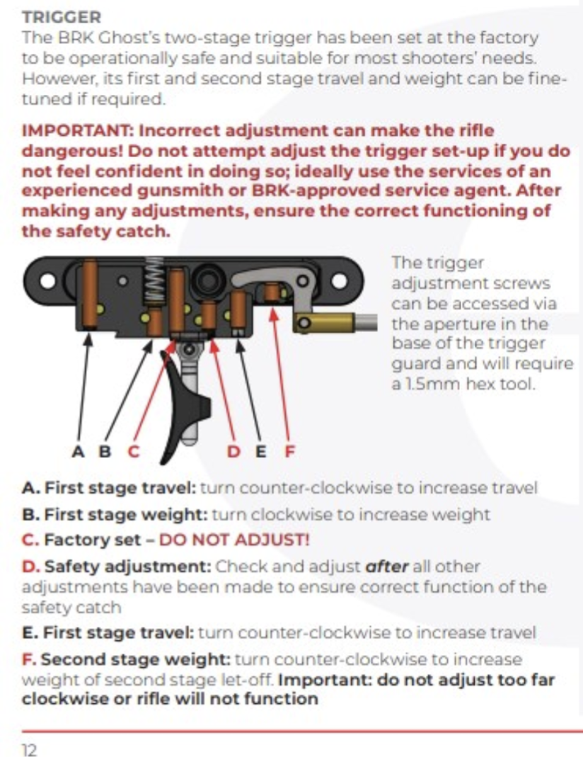

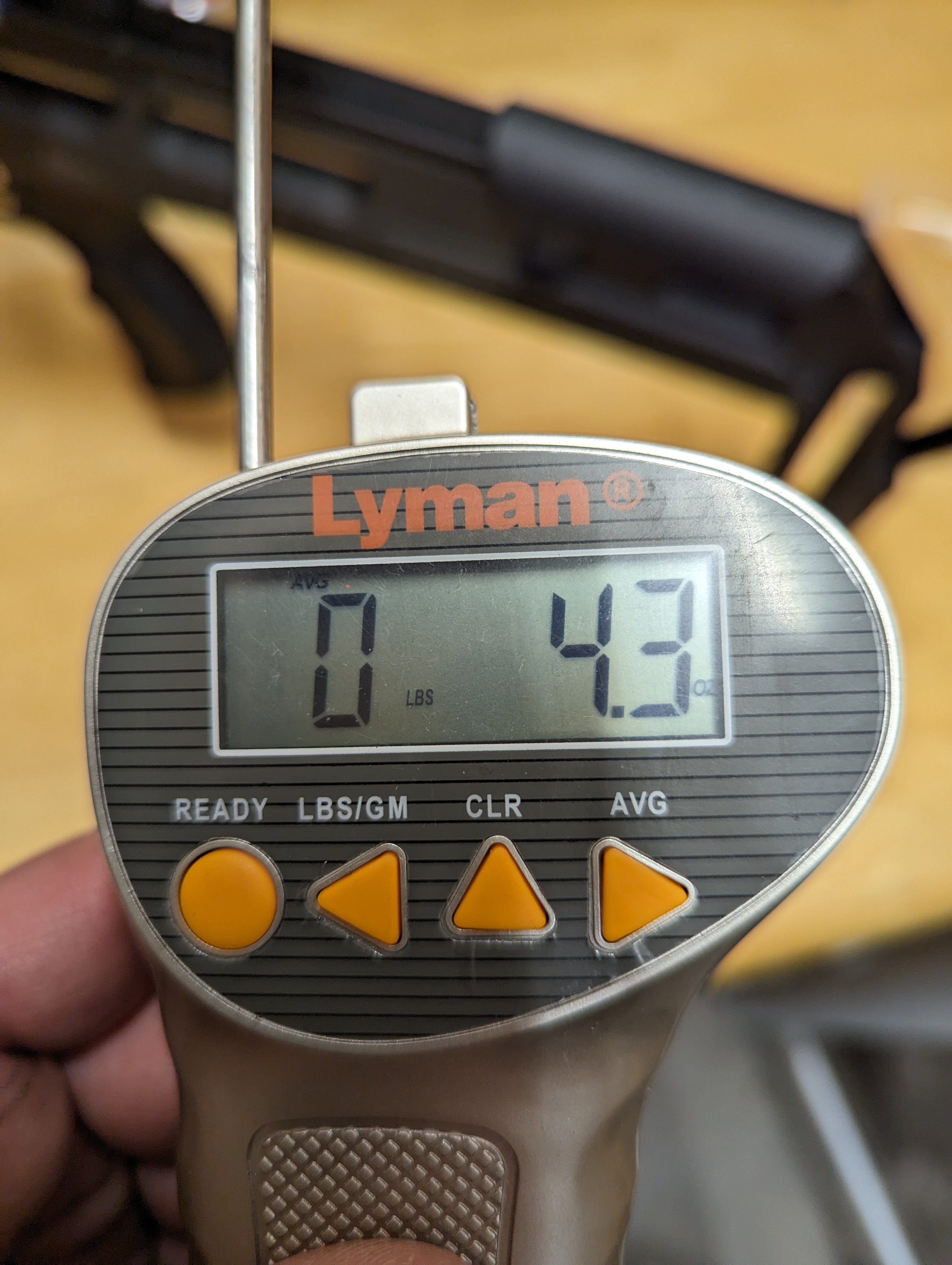

Posted this before but I just revisited it and dropped the trigger weight from 7-8oz to just a hair over 4 ounces.
Don't forget about screw F in this diagram.
Adjusted that F screw and got it down to this, 5shot average.
It helped eliminate some creepiness right before the break too. Now that it's gone, I'll have to get used to not using that creep to anticipate the break.
And the manuals warning is accurate, adjust it too much and gun won't cock.

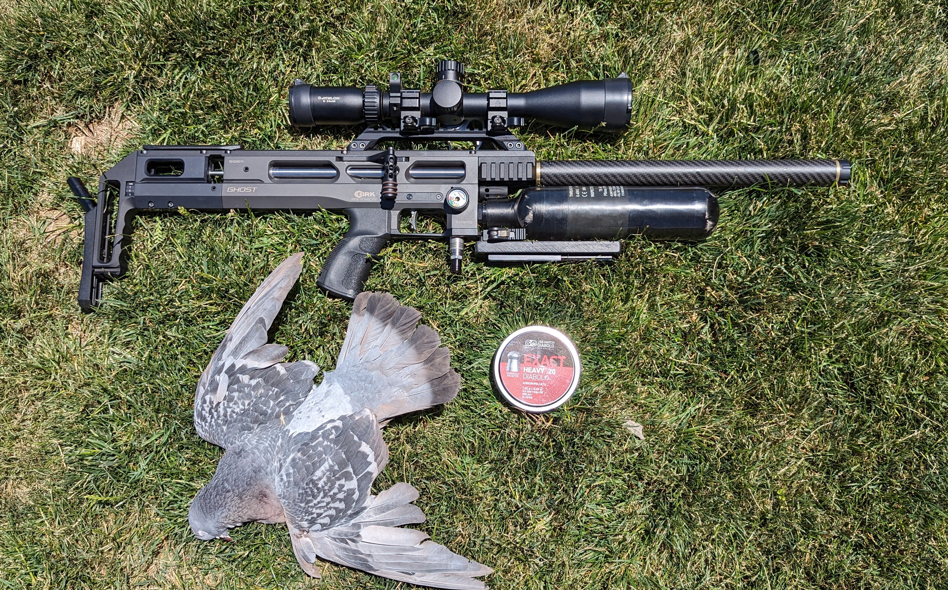

Really rare for a pigeon to test his luck in my back pasture ....BUT one landed about 30 minutes ago. A mad dash for the Ghost ensued, and the pigeon actually Sat there long enough for me to get the gun, slide open the gun turret window on the second floor, annnnnnddddd POP him!
I guessed his range @ 60 yards and just held dead-on, since that's the zero for the JSB .20/15.89 @ 915.
He was broadside, my least favorite way to shoot at a thick winged bird like a pigeon or Euro. And that's because it often results in a broken wing and a wounded bird when not using pretty big fpe. But I hoped I could slip the pellet in at the base of the neck, above the wing juncture. Took the shot and he dropped, dead as a doornail.
Upon retrieval I found the pellet hit about 1/2 to 3/4 inch lower than I wanted, and went straight through the thickest wing joint. It continued on through the upper breast, and there's blood on the far side as well, so it went clean through him, even though it hit that wing joint on entering. That slightly lower than intended impact point means he was probably more like 70 yards.
Ghost was ready to go, no sight-in necessary. Last time I shot it was Saturday. Just grabbed it, took the shot and dead pigeon. That's been the experience for the last ten months, completely reliable and always-retained scope zero.
Add a nice big pigeon to the Ghost .20s tally.

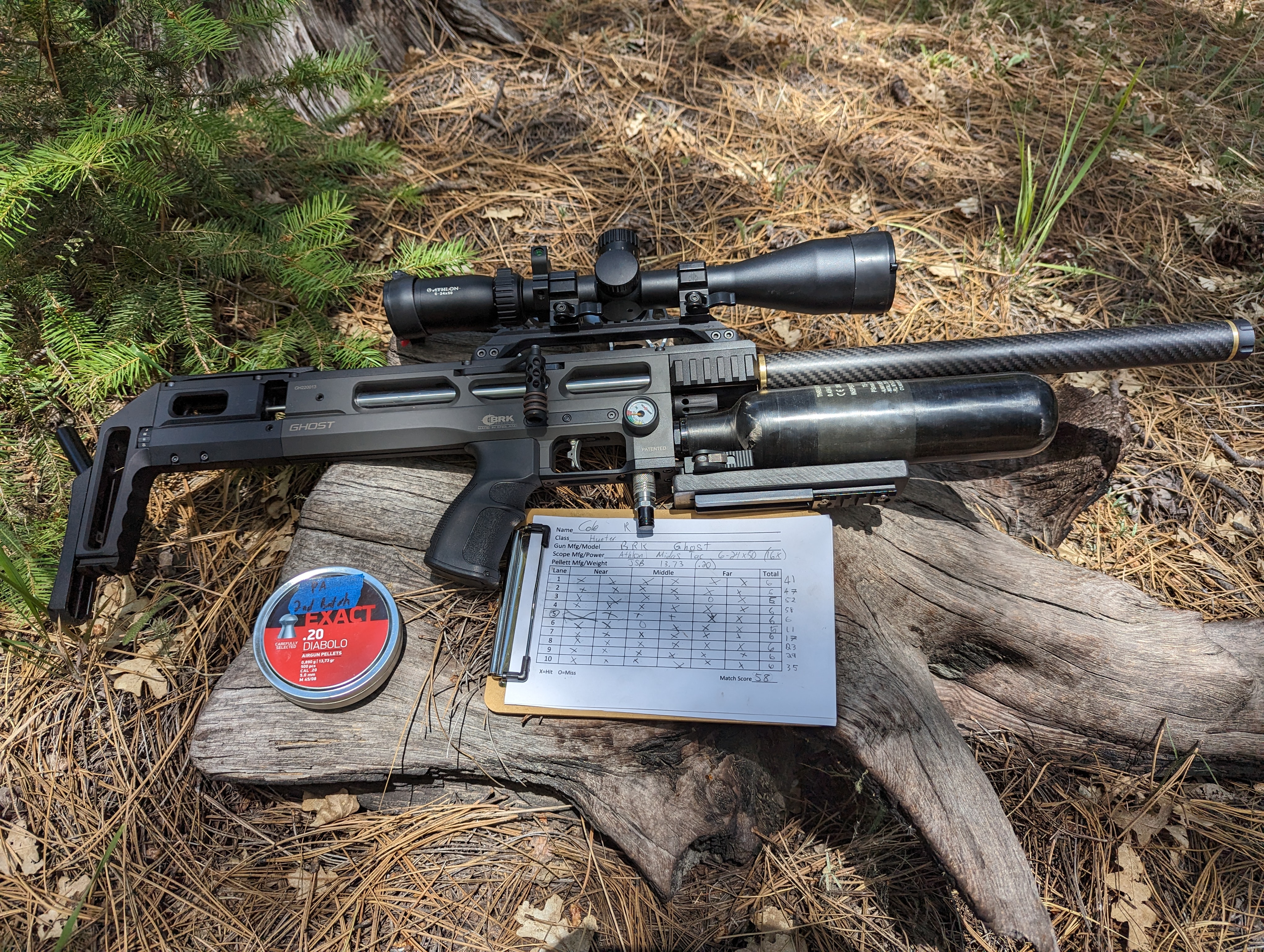

Ghost .20 served me well today. We had 17 shooters over at the Southwest Airgunners field target match in Western NM, and I believe 16 of us were shooting Hunter class. I tied for first with a 58. Match director chose to break the tie with shoot off, which consisted of 5 chickens @ 55 yards (1/5 scale silhouette) for each of us. 1 minute to knock em down, 1 shot per chicken. I hit my first four, missed the fifth, finished with about 20 seconds to spare. The other 58 score shooter missed his third and ran out of time for his fifth shot so the tie went to me. Very difficult course, 4 targets past 51 yards. 60 shot match and it's really hard not to make a mental mistake somewhere in that many shots. Ie, doing everything right 60 times in a row is VERY difficult. Really challenging, but really enjoyable day.
My two misses were a misranged shot where I initially ranged it at about 22-23 yards. Pellet strike at 6 o'clock on the rim of the kill zone. Reranged and realized it was more like 19 yards so got it on the second shot. The other miss was me holding for wind on a 54-55 yard shot, and pellet striking right at 3 o'clock where I was holding. Just held straight on for the second shot and the target fell. User error on both misses.
Ghost .20 is turning into a great field target gun!!!
