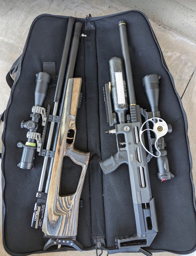

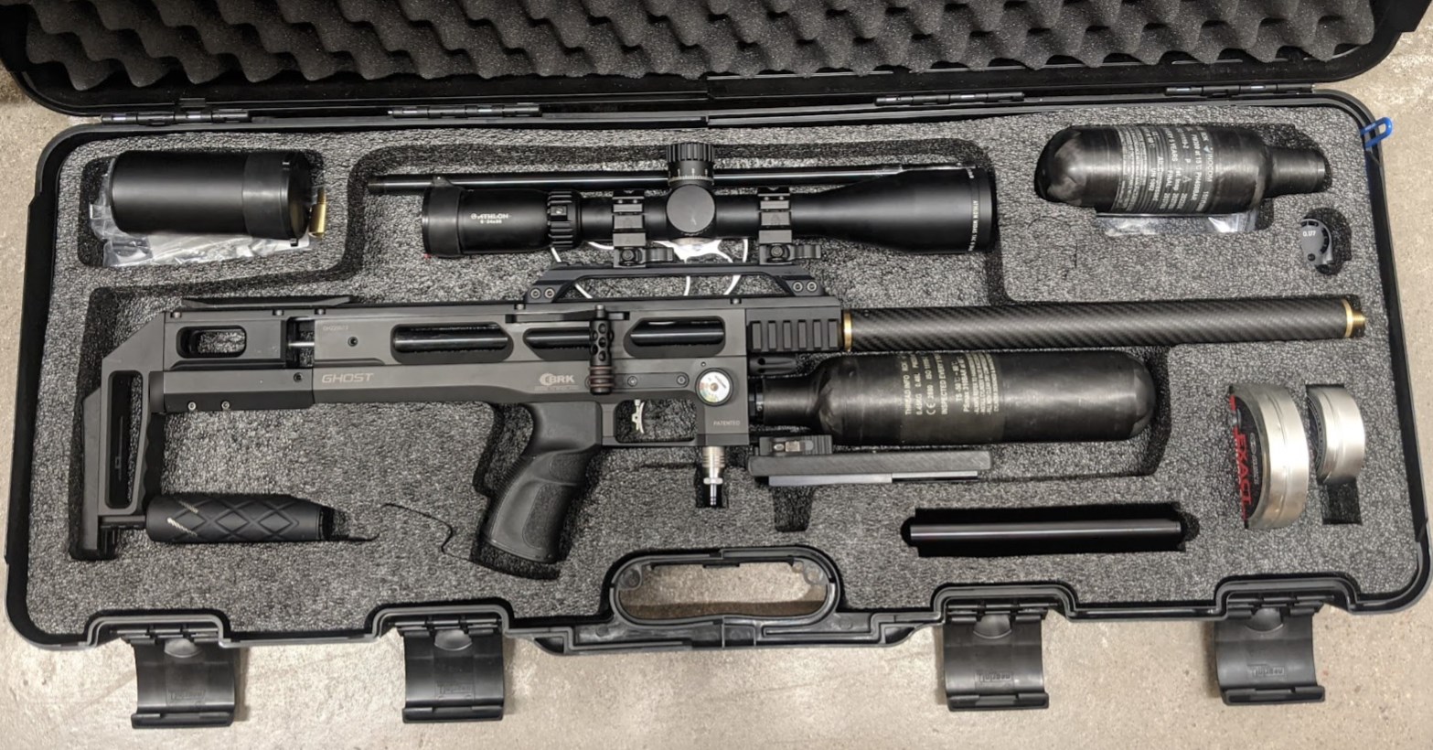

Minor modification of the case for dual set-up
Just a bit of an intro for the upcoming report on shooting in a low power and a high power field target match in the same day....
I made some modifications to the foam in the case to allow inclusion of everything necessary for both the sub20fpe .177 and the .22 high power configurations.
  • Main compartment of course has the rifle, but also is JUST long enough at the top to allowthe 17 inch .177 barrel to lay parallel with the scope.
I'm tickled to death with how everything fits in this case. Really neat to know that it's all there, no rummaging through cabinets and drawers in the gun room to try to find the various components for each configuration.

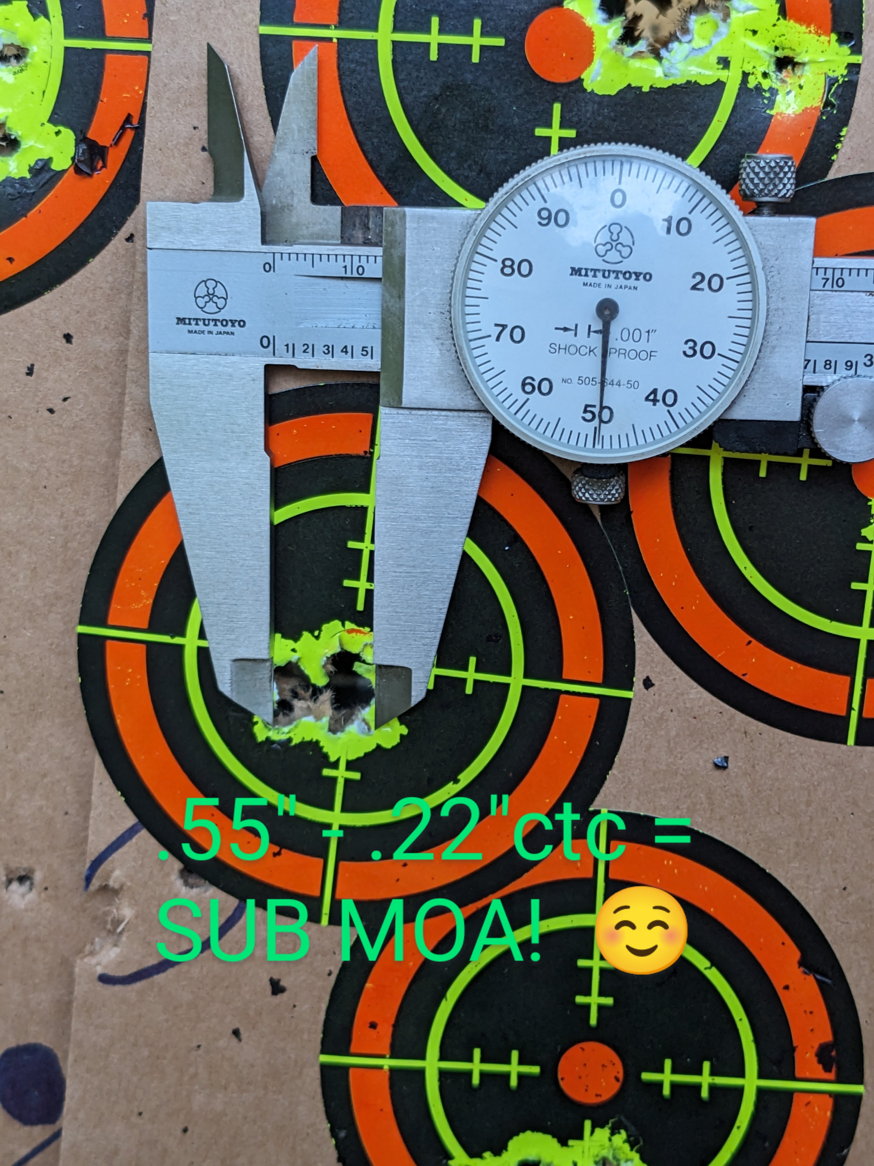

I spent maybe an hour or 2 this afternoon running JB's and Flitz through my Ghost HP .22 cal. I've only done this on two other rifles so far, one with noticeable improvement and the other a magnum springer that's simply no fun to shoot, so I've not gotten around to testing it yet. Let me say this, I sure hope those first 50 shots out of the Ghost's polished barrel are just the beginning. Prior to polishing the barrel I was sending 18.13gr JSBs downrange at a tad over 1000fps, not that was my wishes, but just where the speed landed after turning the reg down from the factory 150bar to @ 108bar, per my newly acquired digital gauge. A few things happened after the polishing that were unexpected. The velocity dropped @ 35fps. Hopefully not due to me knicking the pellet probe o-ring. I'll have to check that tomorrow. The POI also changed from a tad high and right, to low and left. I shot 3 mags like that before giving it a few clicks to the right and one up. What happened next was most unexpected but very much welcomed, SUB MOA with no fliers out of 50 pellets! Maybe I was just lucky, plucking those pellets straight from the tin without picking a bad one. Further testing will be coming.
50 yards, 10 rounds of 18.13gr JSBs flying an AVG of 964fps.
@IRBent, that's a pretty dang good 50 yard, 10 shot group!!! Congrats.
That's also a lot faster than you probably need to be shooting those 18.1s. Funny thing happens with pellets....they strip their speed so fast that whether you shoot them @ a muzzle velocity of 964 or 890-900, they're going the same speed by the time they get very far. I didn't run #s just now but prob around 60-80 yards they're going the same speed, no matter how fast they started. So pushing them that fast doesn't gain you much, as the low BC makes them bleed off speed so fast..... Basically, slow em down to 890-900 and you should still have the same 50 yard accuracy, but with a quieter gun that gets more shots per fill and is more docile on the shot cycle.
As for the barrel polishing, I saw the same thing with the .177 barrel the review Ghost came with. Markedly improved accuracy after some JB bore paste. And while I didn't personally polish the .22 and .20 barrel that have spent time in the review Ghost, I know that Bobby did.
My opinion, added to what you and Tony experienced, is that there ARE accuracy gains to be had via polishing the bore.

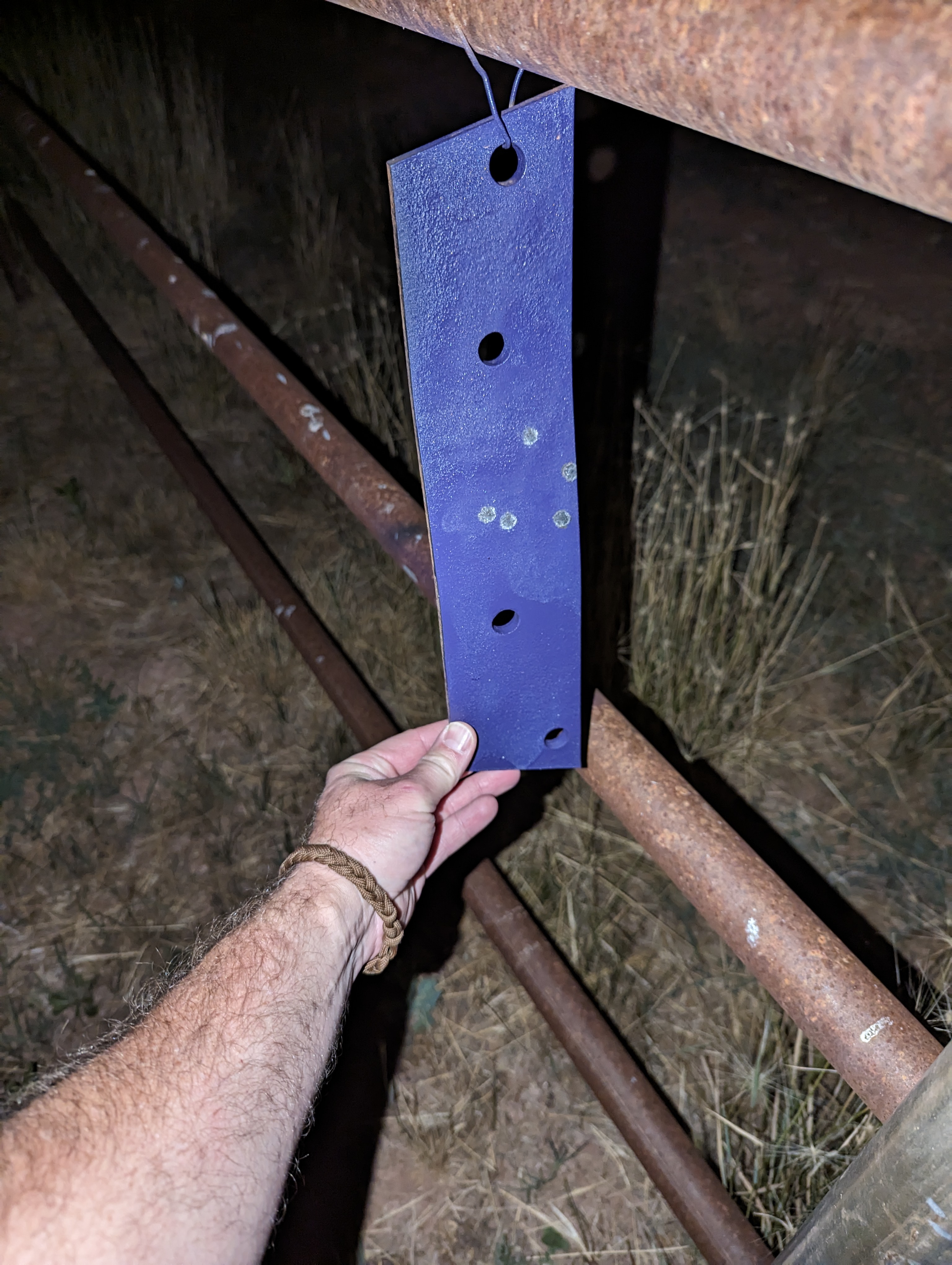

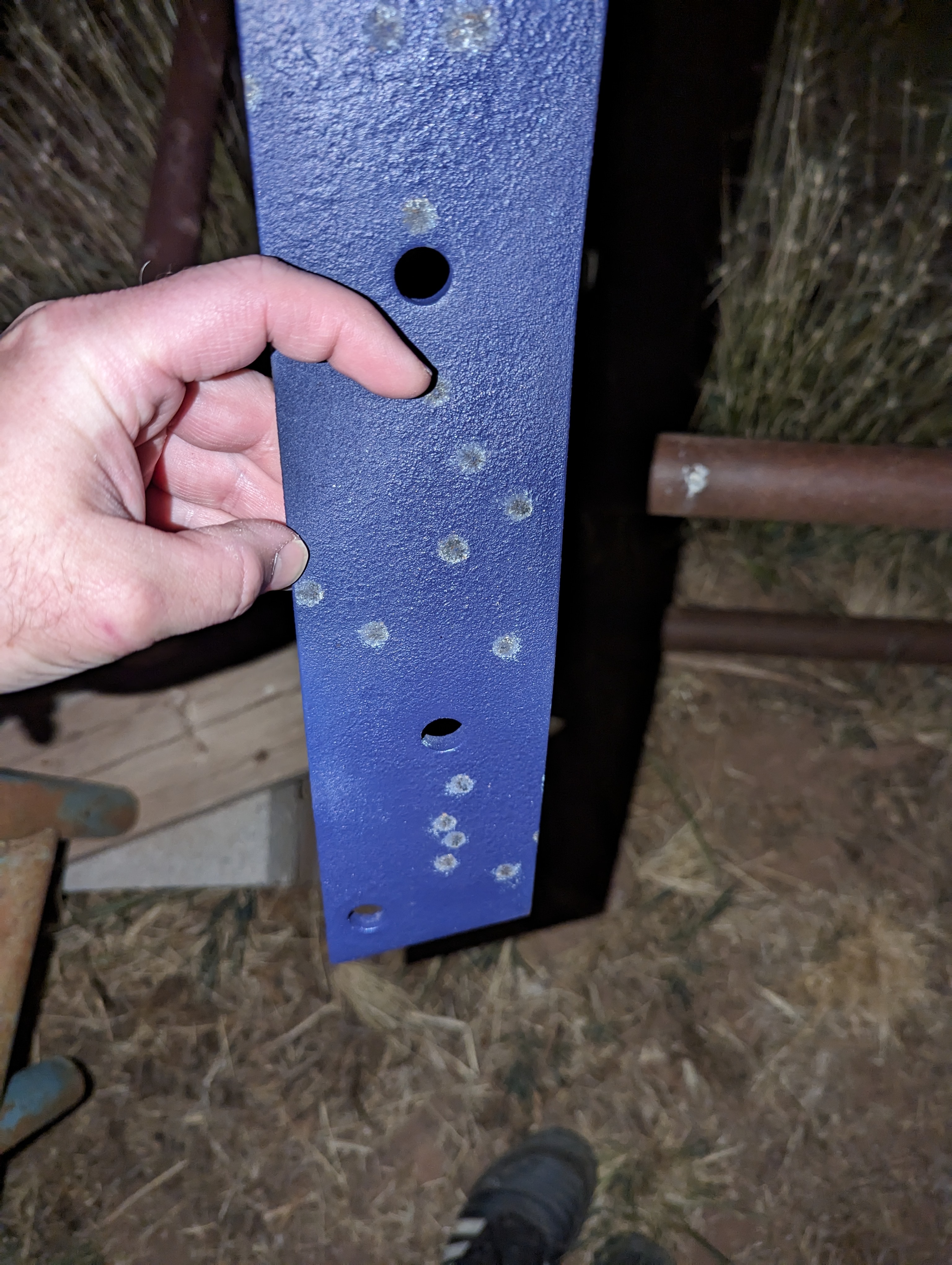

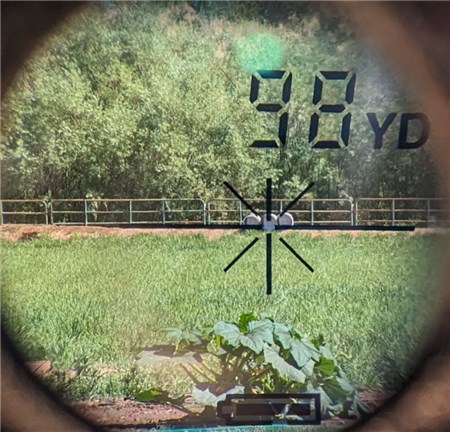

Shot the Ghost last night after dinner/before dark. Didn't even put out paper, just shot my semi-permanent steel, although it was freshly painted.
Chose to use the JSB .20/15.89.
There was enough wind that the shrubbery past the targets were waving back and forth pretty good. For further context, the squash and pumpkin plants in the garden I was shooting over the top of were also waving around. They're at about 25 yards. I'd guess that sustained winds were around 15mph with gusts up around 18-20.

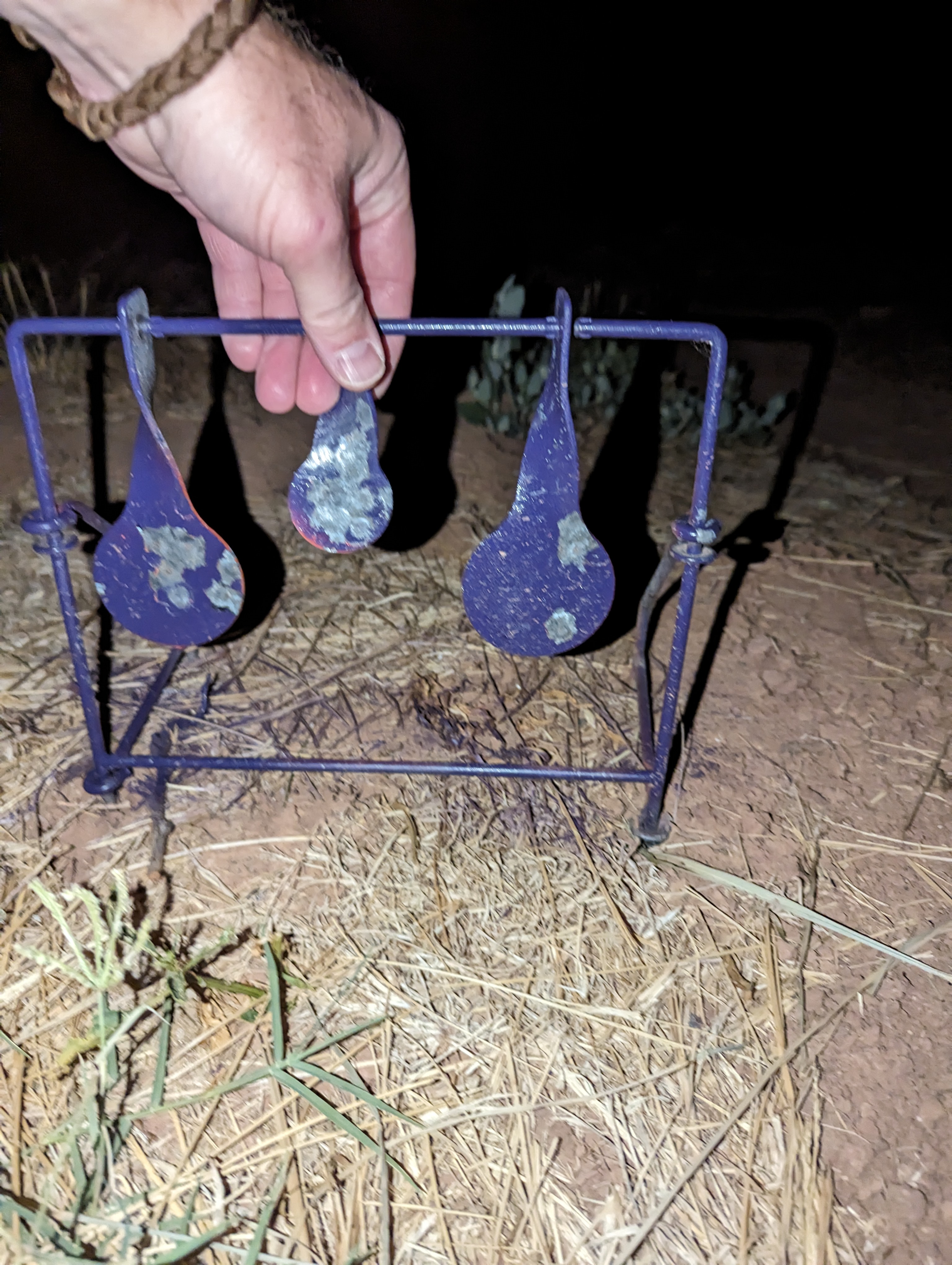

I was just shooting for fun and wasn't going to post anything here, but then was texting a buddy and decided to share. So the photos were taken after dark when I'd changed my mind and hiked back there to get some photos to share.
Here are the paddles at about 94-95 yards. The bigger ones weren't much of a challenge so I mostly shot at the little guy, thumbnail in photo for reference. Best streak on that middle paddle was 7 in a row.

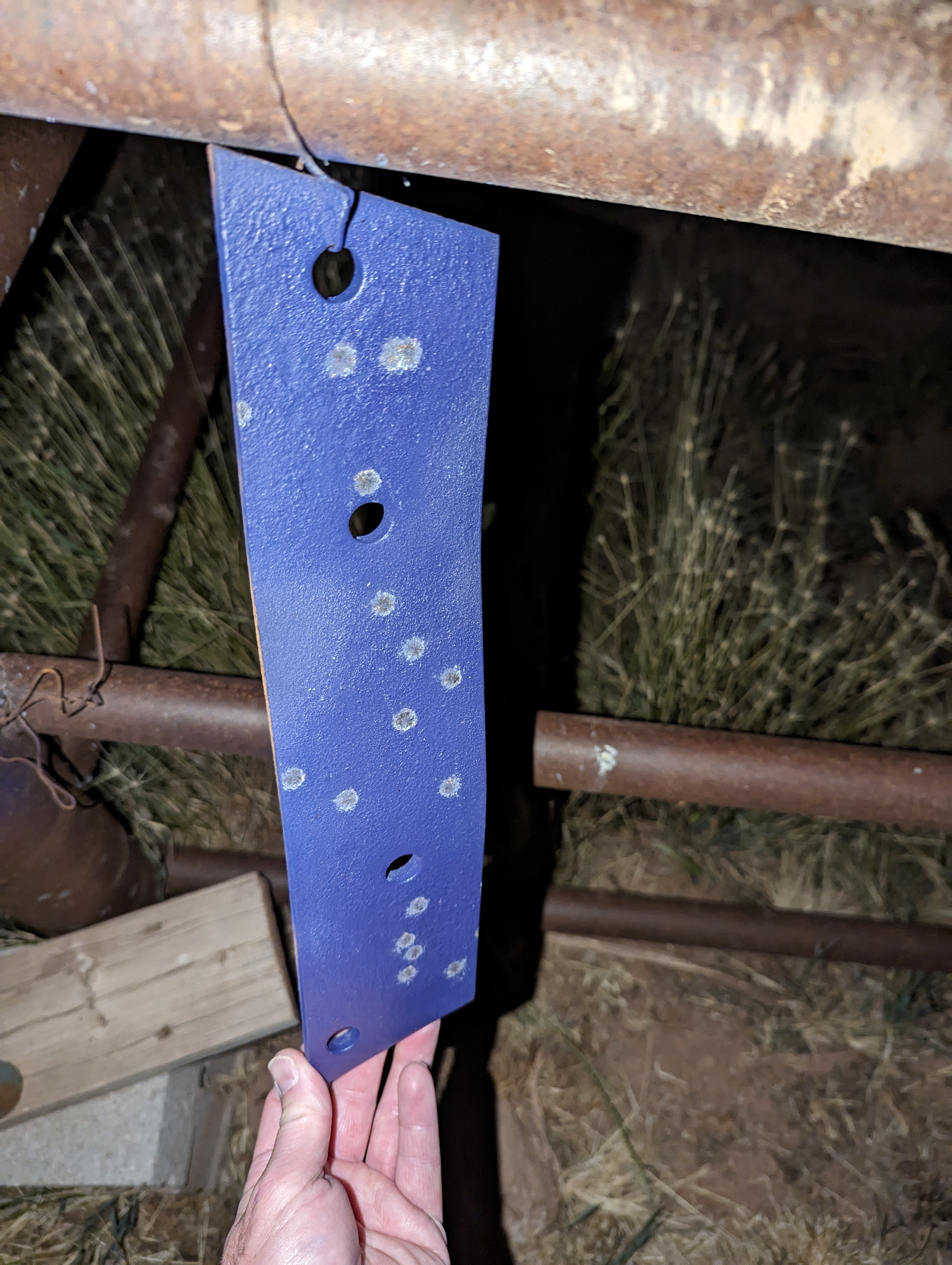

And here's a five shot group at old bushhog blade hanging at 125yards.
And finally, three groups of various shot counts at 135 yards. Groups were just hunting for clean spots on the steel so there's a group above the top hole, another group in the middle of the holes, and then one below the bottom hole.
Hold offs for the wind on the 135 yard shots were between 0.6 and 1.2 mils.
Fun stuff, meant to be just a chill session so nothing very scientific. But man o man I love these JSB. 20 Heavies!!! So predictable and no what-the-hecks?!?!

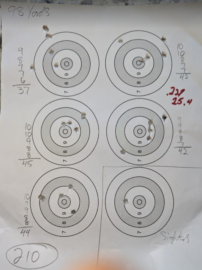

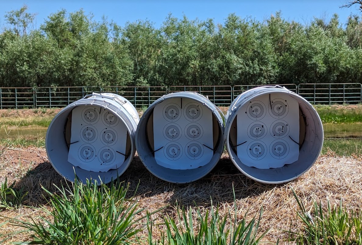

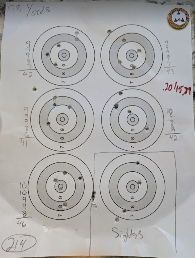

It's always fun to quantify whatever guns/barrels are currently part of the stable as the best long range option. And that's what this fun shooting session was all about: answering that question.

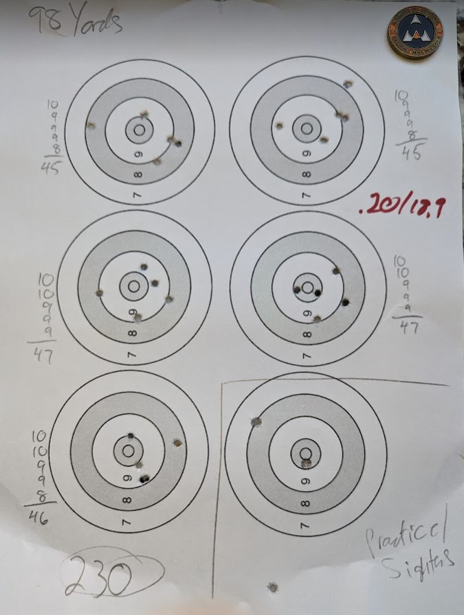

Paper at 98 yards.
Left ended up being the .20/15.89, middle was the .20/18.9, and the right was the .22/25.4grain.
And here is how they scored.
And of course the best BC was the best long range performer. Both pellets were quite close in score, and that first upper left group with the .22/25.4 really hurt the score for that projectile. I should have shot more sighters before rattling the 25 shots off with that gun.
