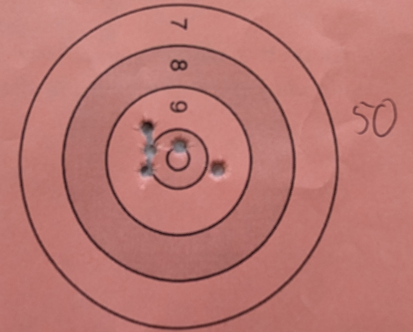

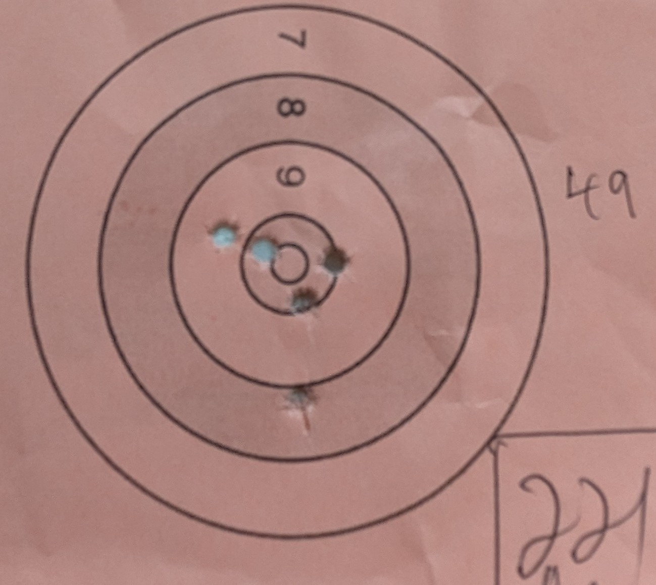

Going from the pellets to the slugs felt like cheating.
Of the 18, 5 shot groups (90 shots) only one of them scored outside the 7 ring when using the slugs.
These two were the high point from the slugs, there were lots of 45, and 46s as well. Only the one group that had the 6 scored less than 40 ,(a 39 in this case) the rest of the 5 shot groups were 40+.
Looks like I'll be shooting .20/18.9grain NSA slugs from the Ghost at some Xtreme Field Target matches this winter.
