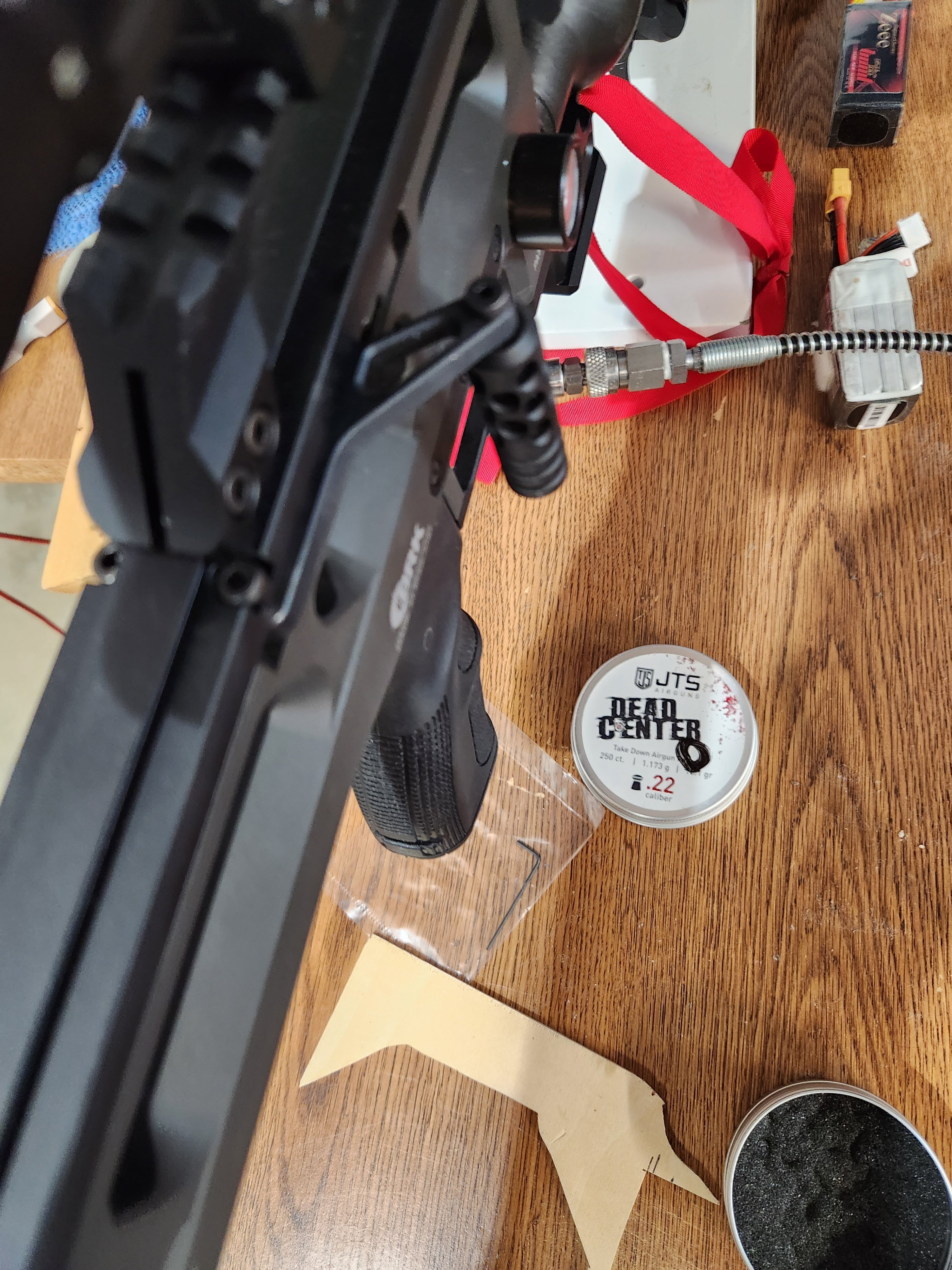

I think my issue with the cocking handle jolt upon firing might be an anomaly. I’ll see what I can do to remedy the issue when I get home today.
The Ghost has pretty tight tolerances.....I recently was fiddling with the rear end and found that I accidentally induced a bind in the cocking by tightening the bottom bolt for the drop-down before the top three bolts. As soon as I got it back together I knew something wasnt right, the easy smooth cocking had been replaced with roughness and a binding feel. Took me awhile to isolate it but eventually narrowed it down to the order in which I tightend those four bolts that hold the rear (part that contacts shoulder pocket when shooting) section to the rest of the gun.
Just an example to illustrate that something may not be exactly aligned properly and is causing the jolt you describe.
The grub screw to which I’m referring in the video plugs a hole within the internal compressed air region/cavity of the firing chamber. I’m thinking that since all the air will not escape out the barrel when a pellet is fired, some of it will escape around that grub screw, which is directly below the cocking rail linkage. I am questioning what the reason is of drilling a hole and screwing in a grub screw in that particular area.
This is the grub screw:
Upon closer inspection, that threaded hole on which the grub screw goes is directly above the air transfer port that channels the air to the barrel. I think that was the drill bit’s entry hole to enter from to drill the transfer port hole and when drilling was complete the grub screw was inserted to plug the entry hole. If indeed air is escaping from or around the screw, BRK didn’t use any sealing agent (o-ring, teflon tape around the grub screw, Loctite, etc.) to prevent any air leaks due to air escaping around the barrel, which might be causing the vibration, and why I’m getting some inaccuracy. Perhaps my gun was made on a Friday and the assembler forgot to apply sealant?🤷🏻‍♂️
Could you cock the gun, put it on safety of course, then remove the top rail and hold your finger over that hole when you fire a pellet? That would definitively answer your question as to whether or not your side lever jolt is coming from air escaping out this grub screw.
I was actually thinking of trying that but am worrried that there might be parts—especially the small, hard-to-find ones—flying off.
Also, AOA just responded to my email and said that on a recent Ghost disassembly there was some threadlocker on the grub screw that was on it. I’ll check if the same can be said for mine when I get home later.

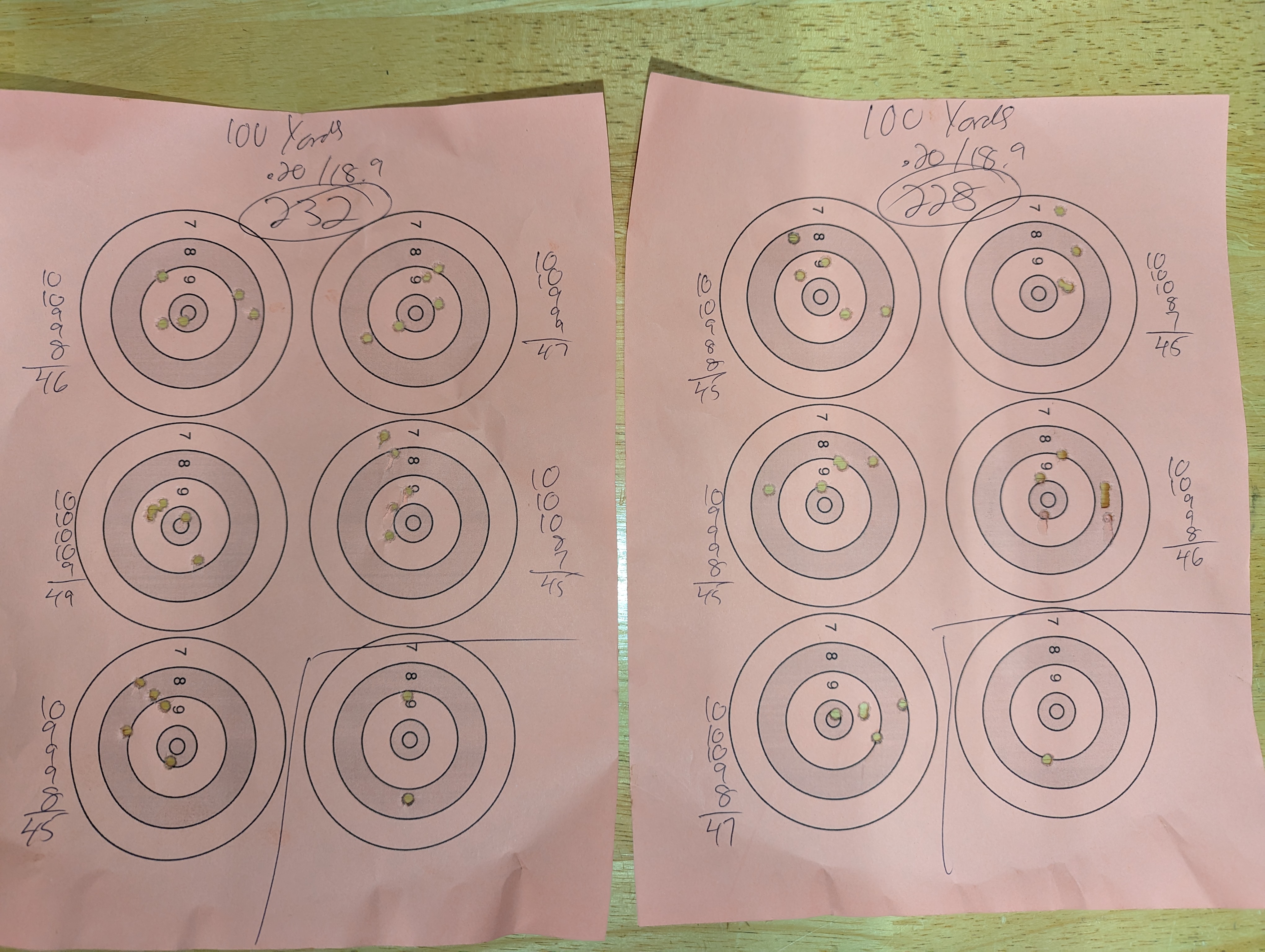

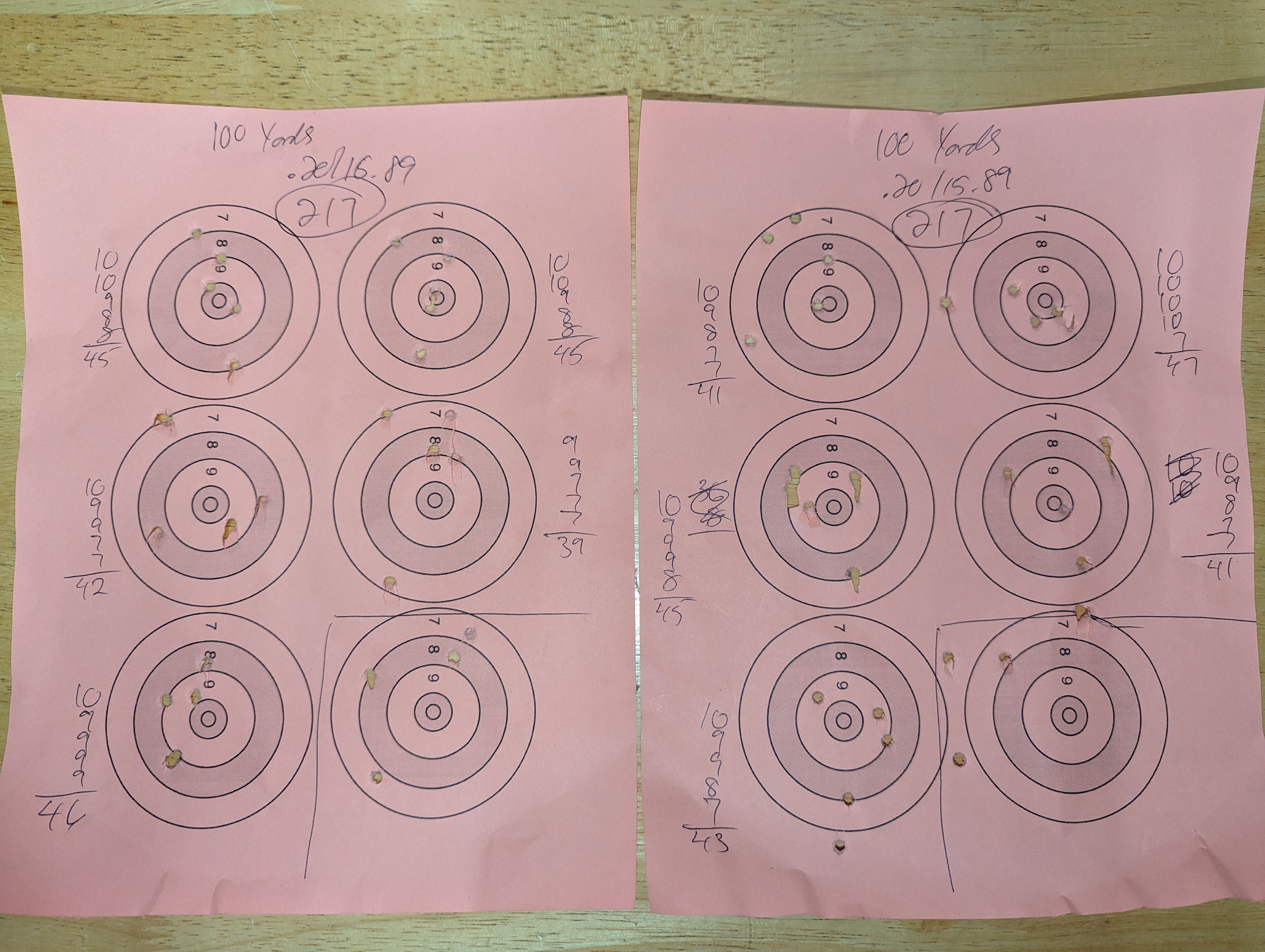

Did some shooting with the Ghost this evening.
Shot 2 EBR cards with .20/18.9grain NSA slugs, and two cards with the .20/15.89grain JSB pellets.
100 yards.
Slug results first. Two sighters for the one card, one sighter for the second card, so all 63 shots shown here. I just don't shoot a ton of sighters, not a true benchrest guy I guess. Man I'm always impressed when I shoot these .20 slugs. Just seems too easy.
And here are the two cards with the pellets. Couple more sighters here, but still not many.

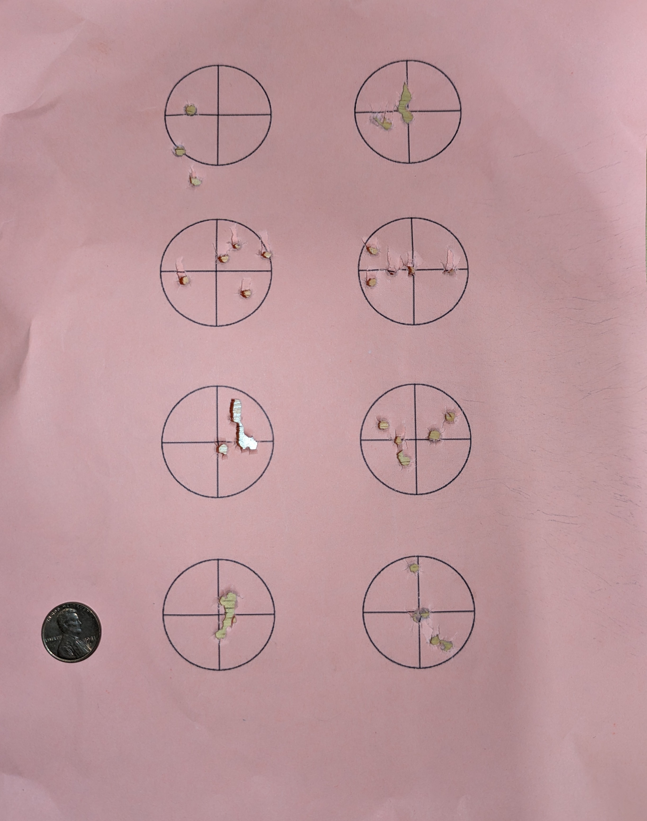

After the above I brought the traps in closer, setting one of them at 55 yards. Spun the wheel down to "MIN" for 19.8fpe and shot these using the .20/13.73grain JSBs. This is from bucket and sticks. 5 shots per group. Some got away from me, but the bottom left and top right were pretty good.
