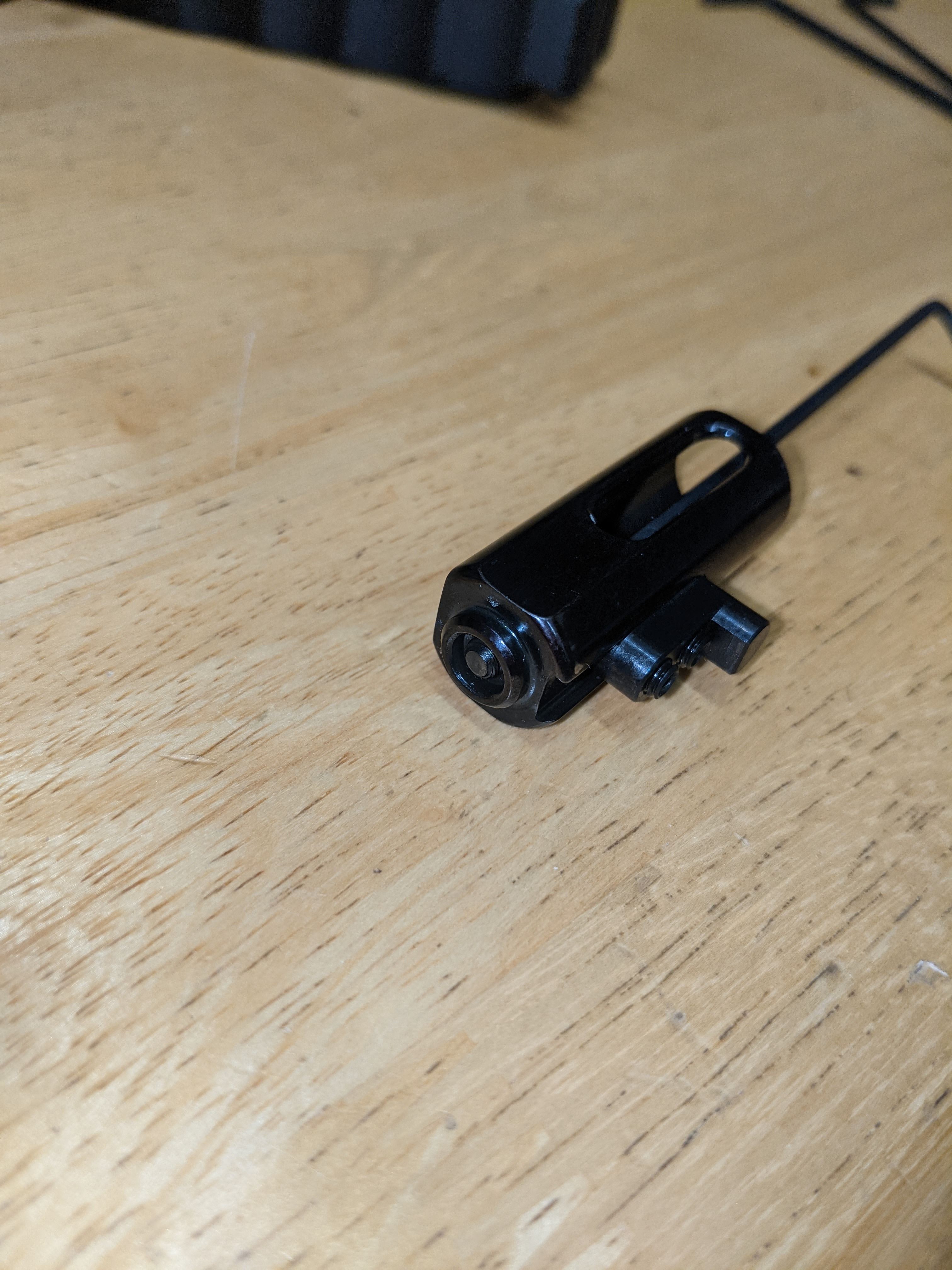

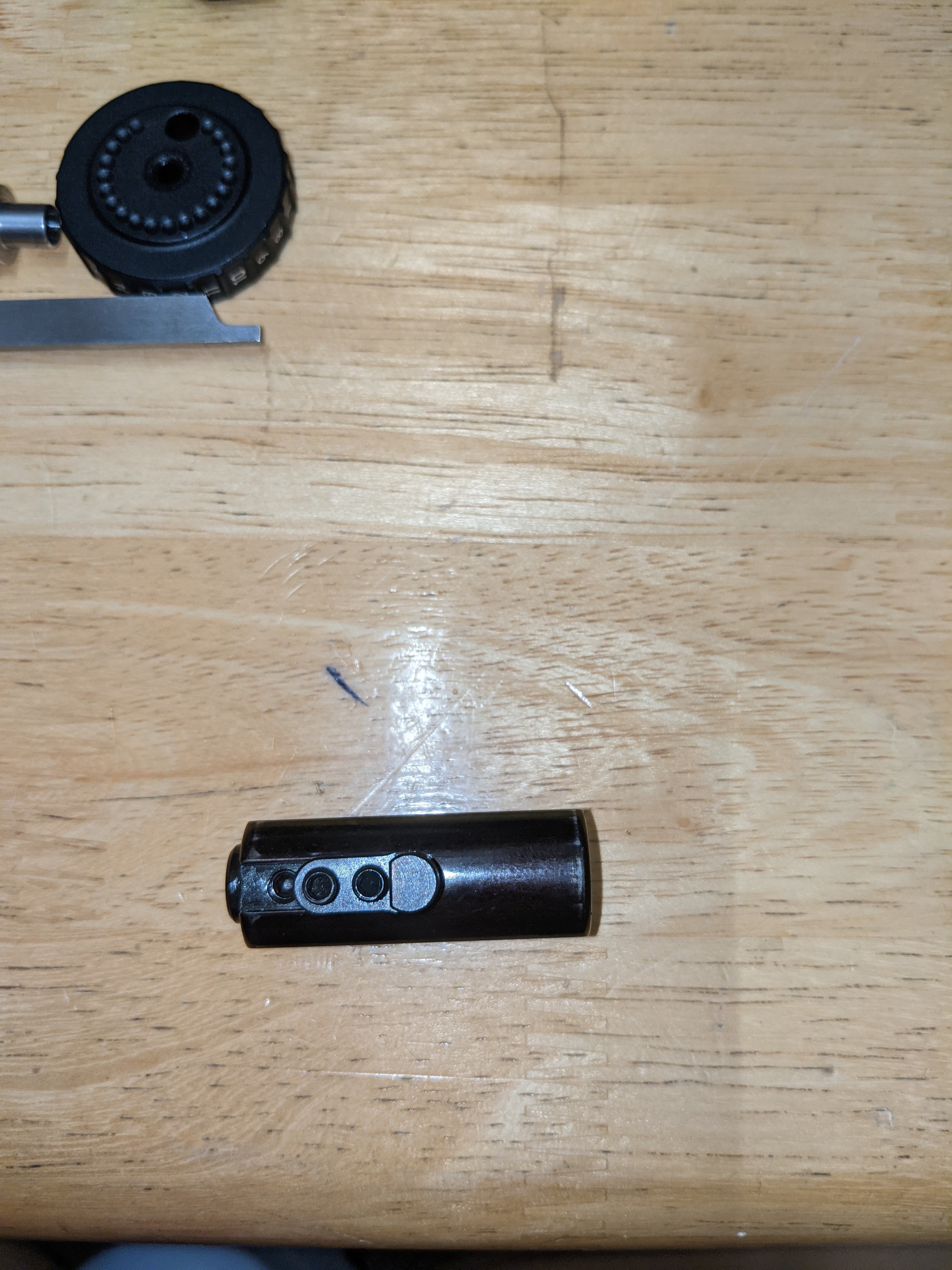

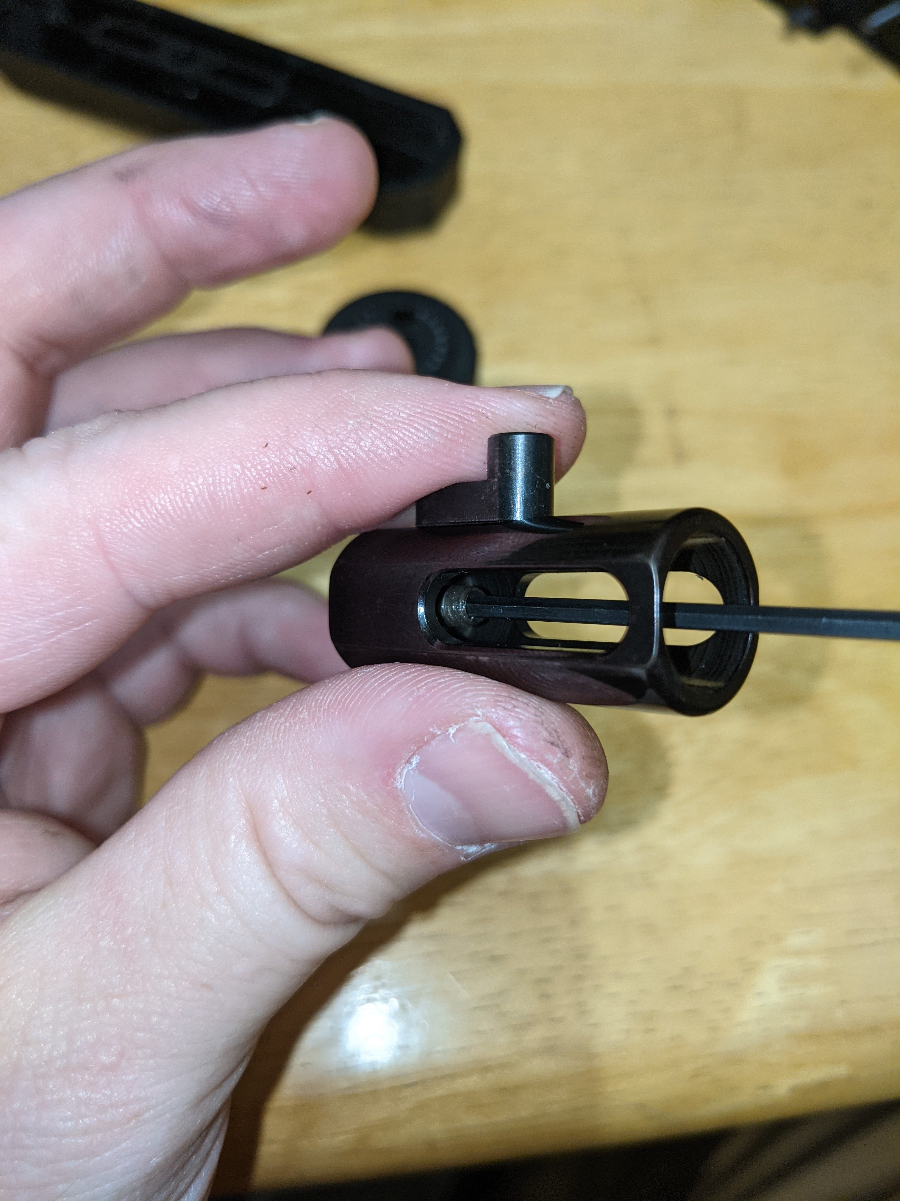

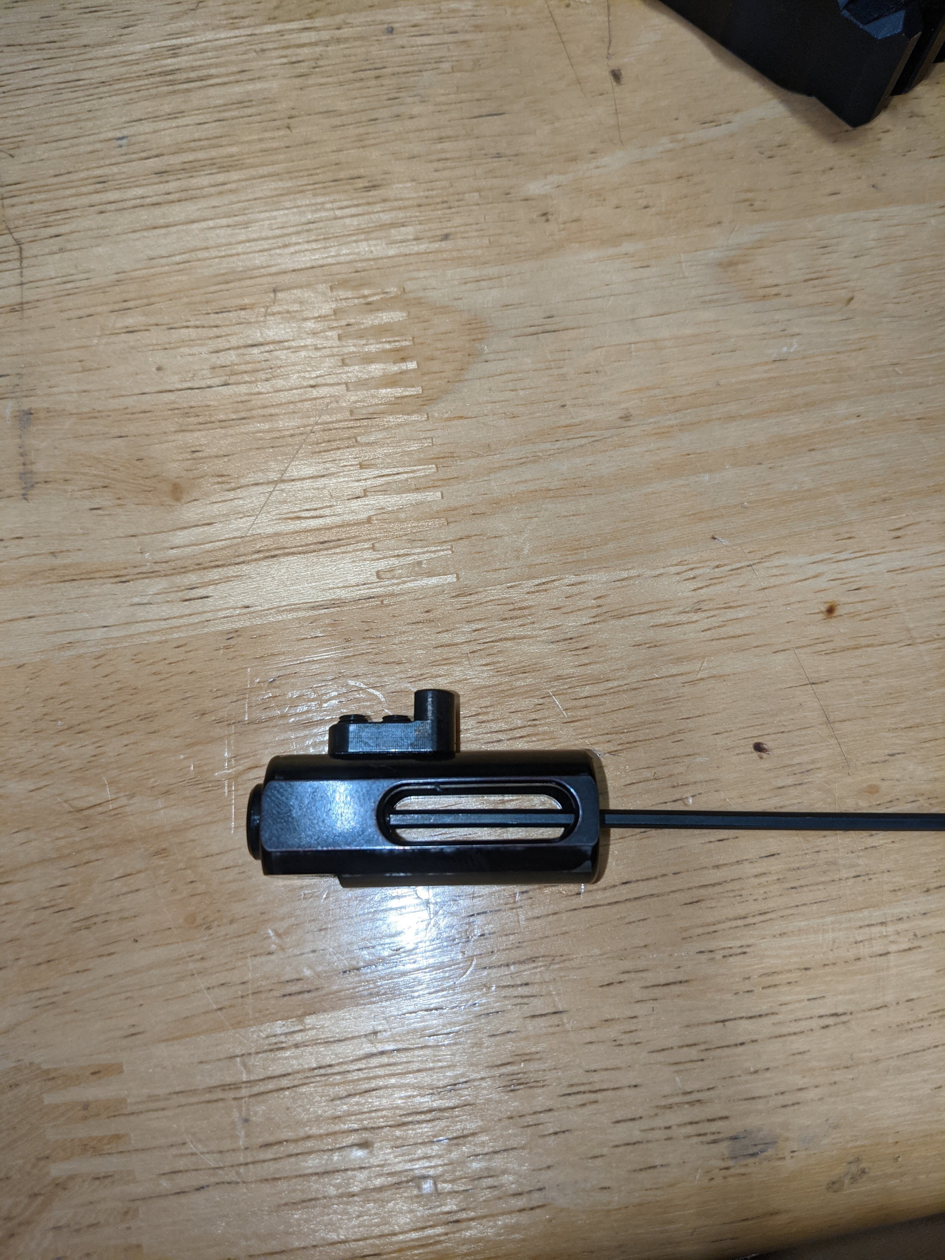

Those two grub screws hold the cocking shoe to the hammer. Are they snug? They don't need to be gorilla tight, but if they're loose and the cocking shoe is sliding in the dovetail of the hammer.....then yes I suppose that could be your problem. Ie If the cocking shoe moves the whole hammer beneath it should also move.
What is the correct location of that shoe? Should the probe protrude unless you pull back on the cocking lever?
Cocking shoe looks to be in the correct position, which is simply fully seated to the rear in that dovetail of the hammer.
These should give you an idea. Your hammer doesn't probably have the cutouts on the side like mine, but the cocking shoe configuration is the same.

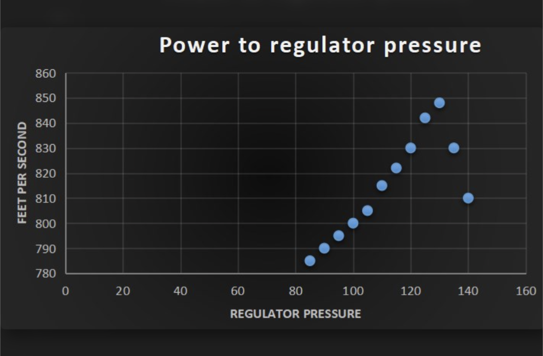

FPS from max and Min with 110-120bar reg pressure...
From post #523 on page 27
There's some potentially relevant discussion there....but the short version is that your energy output will peak at a certain reg pressure, and be less than that at lower AND higher reg pressure. For mine, the greatest variance of fps produced by the power wheel coincides with that peak energy output reg pressure.
