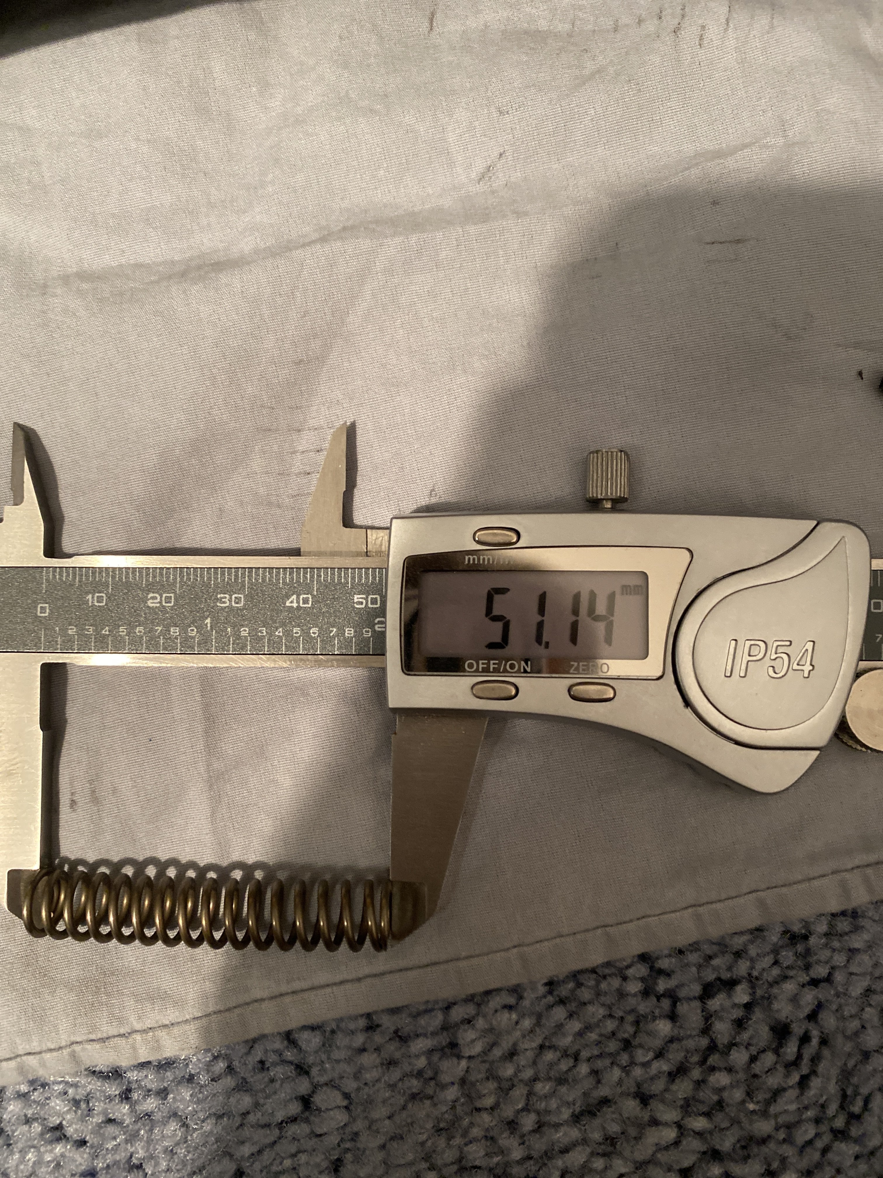

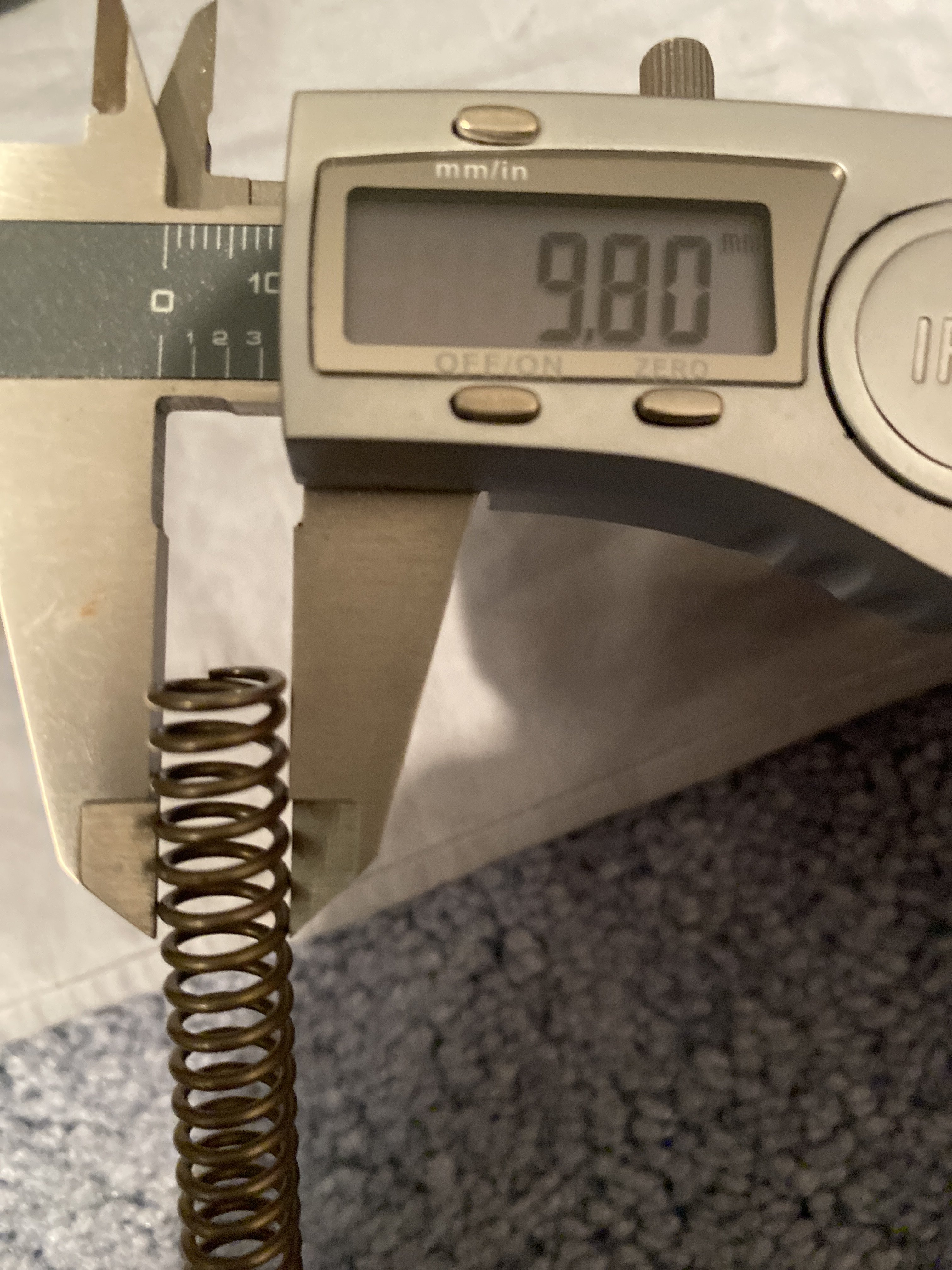

It's almost acting over sprung (for a .177), which has got me wondering if you ended up with the heavier, 0.052" wire hammer spring in there. You game to take it out and measure?
1.36 millimeters =
0.0535 inch
So, yep, you got the Heavy hammer spring.
Call AOA and ask for the 0.047" wire spring. The "medium" spring should give you just as much or close to as much fps on the upper end, but also also lower fps with reduced hammer tension (with an optimal reg setting).
I've got a 0.052 wire spring. The difference in 0.052 and 0.053 is likely in the calipers we're using, probably the same spring. But anyway, even for 50fpe in .22 I didnt need the 0.052" wire spring.
Or source yourself a lighter spring at a hardware store. I've played around with various lengths and decided that keeping it close to the 2 inches OEM spring length gives the best combination of how it feels to cock and the efficiency. So keep it about 2 inches in overall length, and roughly the same outer diameter and it'll work. Take your spring and the wheel if you decide to do the hardware store. Use the spring guide on the wheel to make sure inner diameter is good, and compare length and OD to the spring your gun came with.
