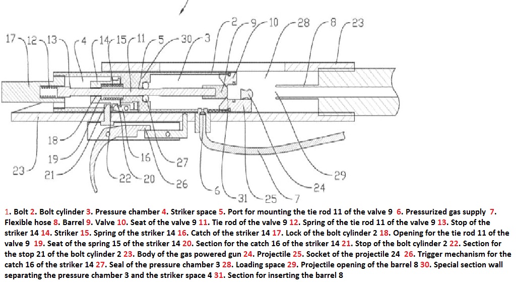

I thought it would come with a balanced valve like this, with which parts can be changed depending on the caliber, apparently they are still far from good internal ballistics...

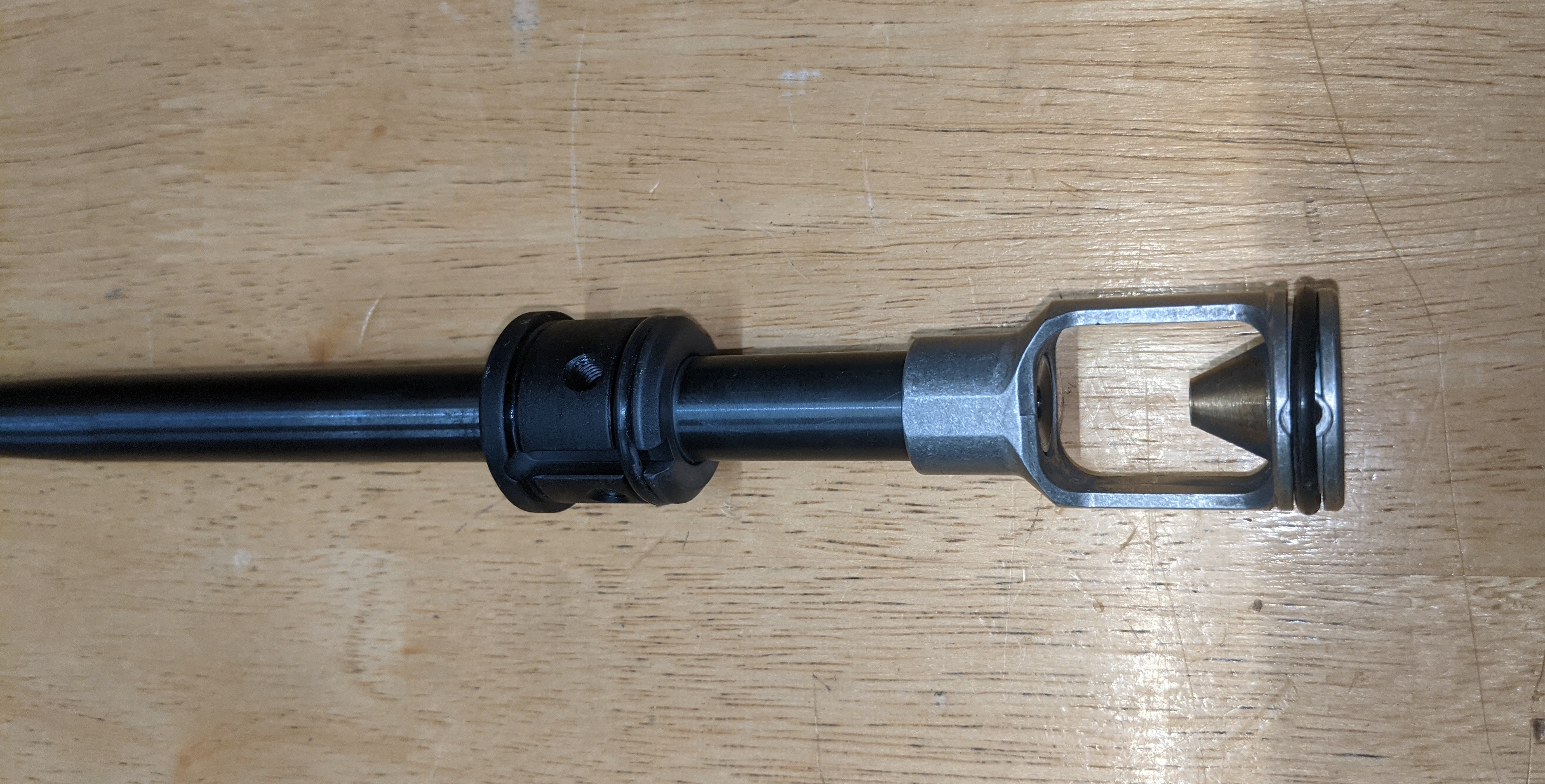

I have a couple questions about some of the pictures posted. It looks like there is lube on the actual hammer. Is this the case? It seems like this would affect consistency.
Also, have you looked at the bafles? I'm curious what style they are.
Thanks again for the super thorough review!
Seems like there was some lube on the hammer but it also hasn't created any problems with consistency. While I was in there a few weeks ago I qtipped off the excess. I know common knowledge on the forums says to not have lube on hammer, and maybe that's the case with some guns, but it's been 10-12fps spreads at worst (some single digits) every time and tune so far with this gun. Shooting my 10-55 dope literally right now and when I come back to a distance the holdover is identical so seems to still be at the same fps. Started this session by putting about 10 shots over the Chrono and they were all @ 880-885, just like they were the last time I shot it. First shot was 882. I think it had sat, unshot, since Weds or so.

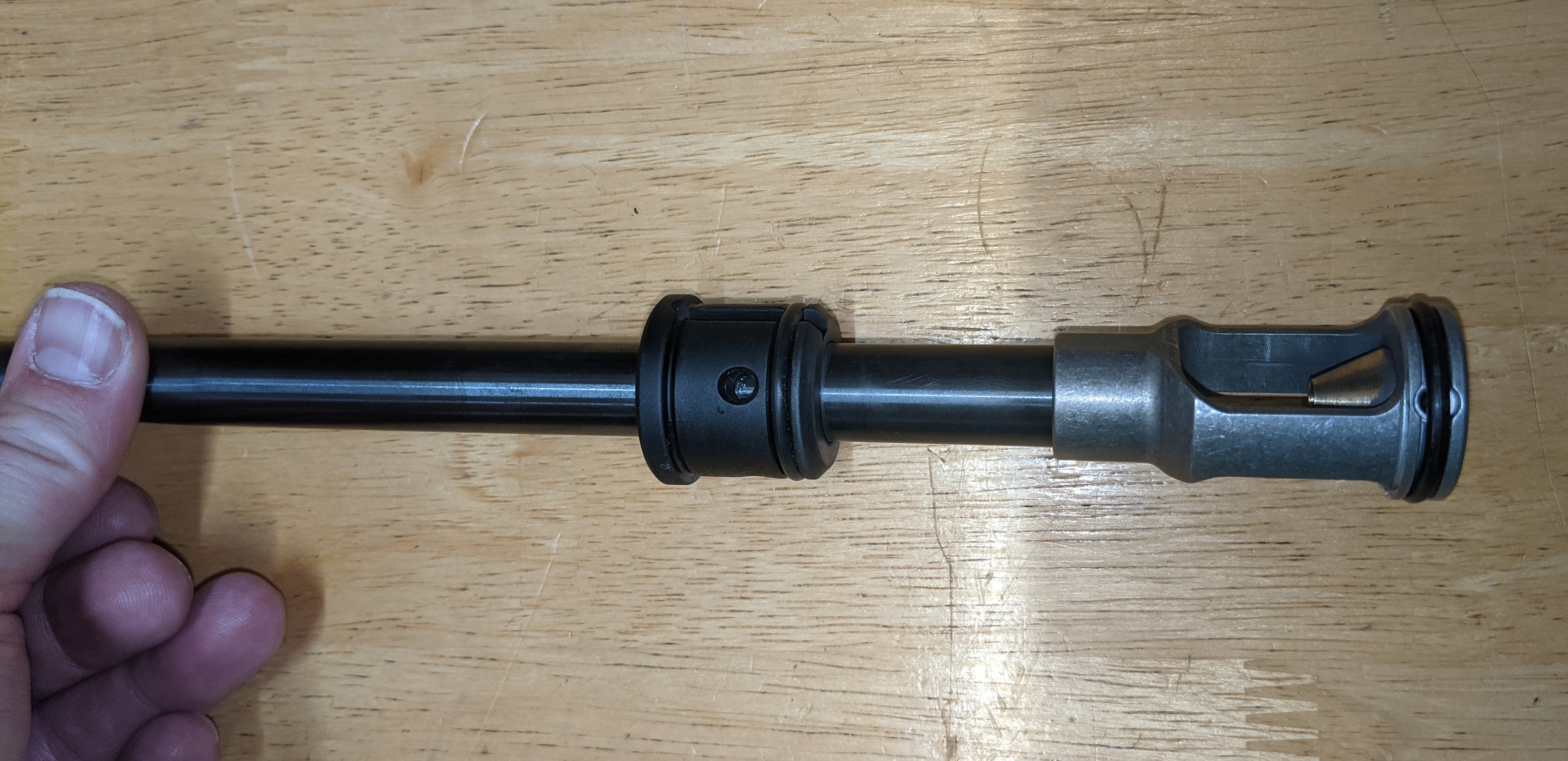

Not much in the way of baffles in this short shroud, just on cone at the end, maybe longer shrouded versions have more?
Carbon fiber shroud walls are 0.065 inches thick. Pretty thick.
The Carbine version that I have needs a moderator threaded onto shroud. Too loud (for me) without it.

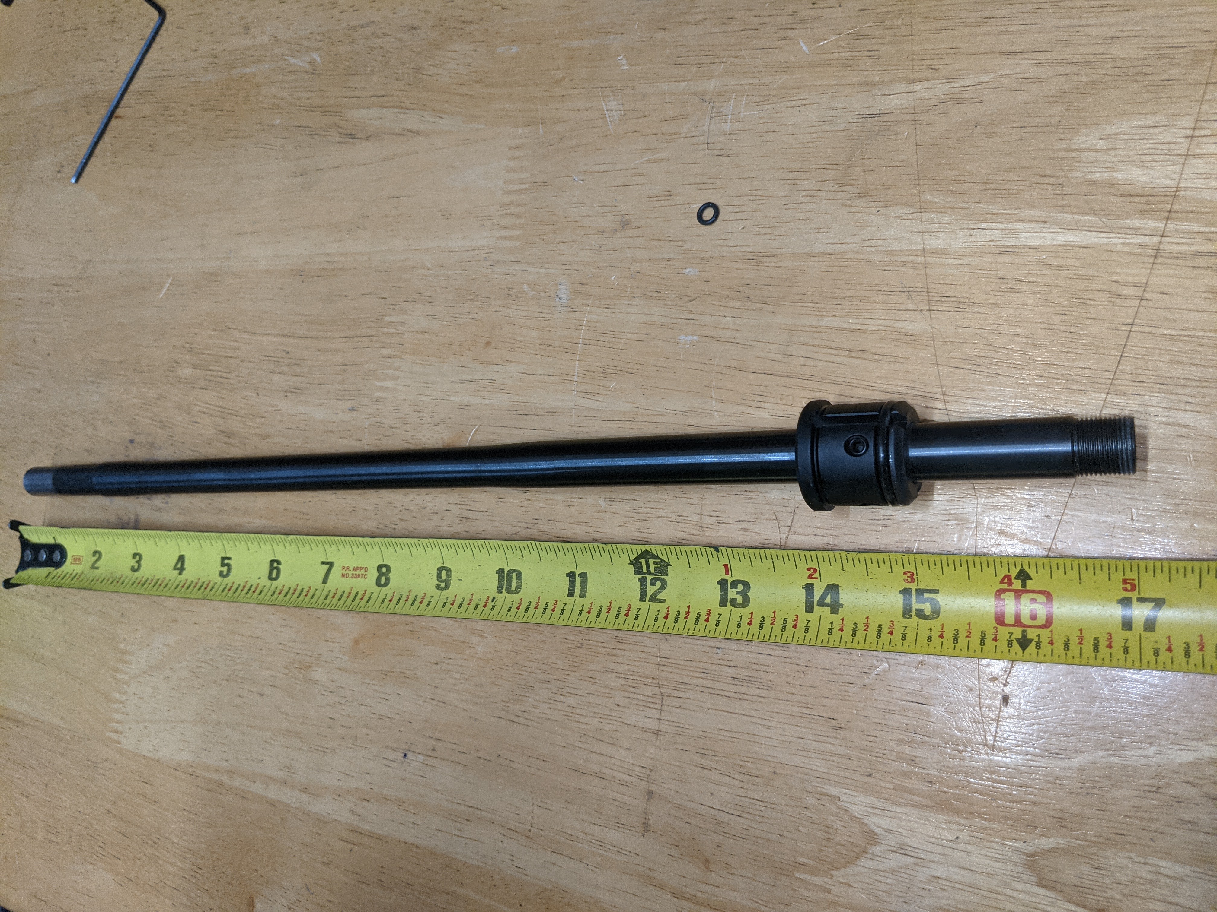

Is the threading on the end of the barrel 1/2x20?
After everything you've posted so far, this really looks like it's going to be my next rig with .177 and .22 barrels. (I'm just going to have to save quite a bit ; ) ) It just looks so well thought out. I'm hoping that it's fairly easy to maintain/disassemble in typical Daystate/Brocock fashion, without a ton of O-rings and tiny parts like some of FX's rigs.
The threading on the barrel is not 1/2x20. I was hoping it would be too, for the option of no shroud. But no, it's a finer thread. I may get out thread gauges the next time I'm in it to see what they actually are, but it's likely a moot point since it's for sure not 1/2x20.
