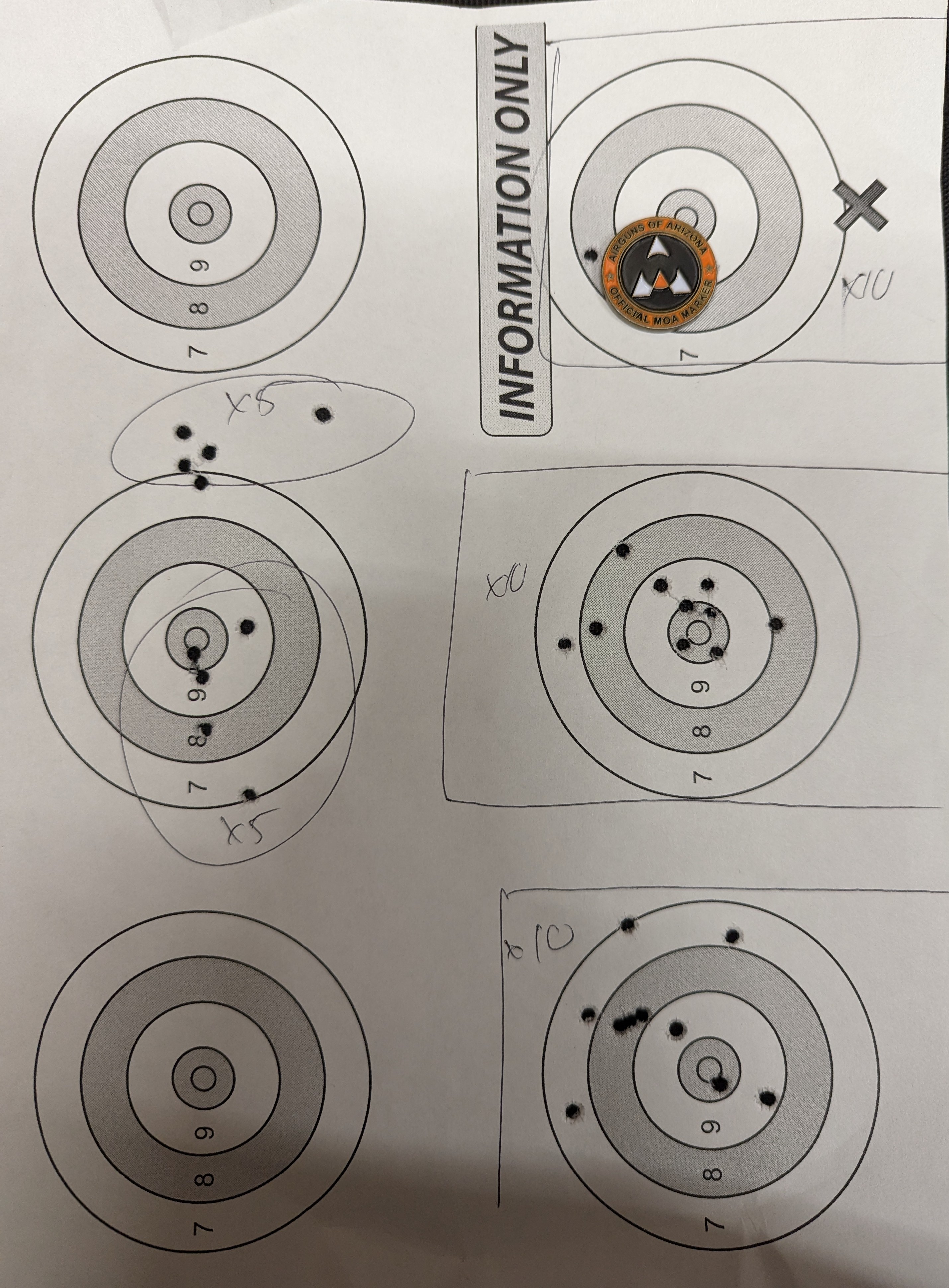

At the end of the shooting session decided to try some 100yard groups from my plastic table (bench). Still had that 6-9mph headwind quartering in from 11 and 1 o clock, switching back and forth.
I was clicking around chasing the most recent wind affected impact points too.
On the left column I had a pretty good looking 4 shot group, less than 1/2", and the fifth one took a ride in the wind.
The other 5 shot group on the left had a lot of vertical, which is what was happening when that head wind would come up and then die, off and on, on me.

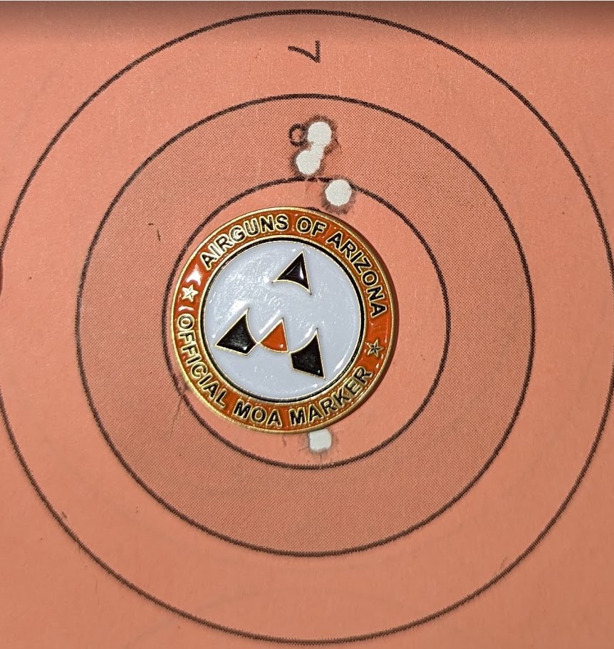

3, ten shot groups on the right column. Bottom two are meh, but that top one! Nice stuff right there. 9/10 under an MOA coin with one straggler shot. And even the straggler shot isn't far from the rest of them.
Very nearly had a ten shot, moa group.

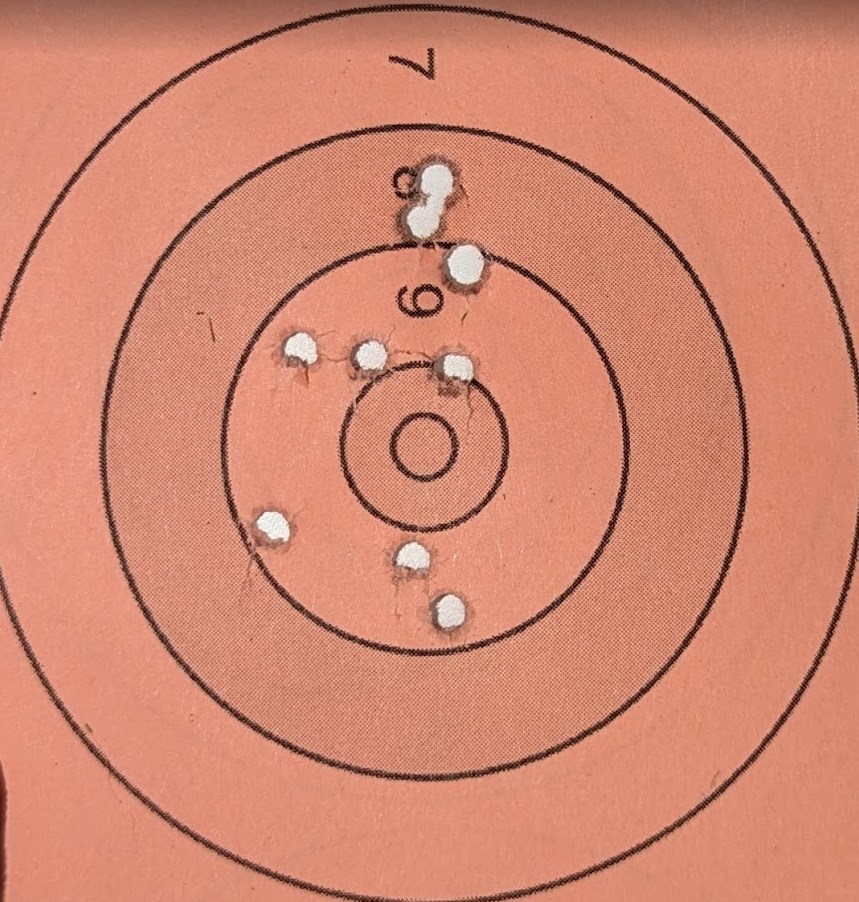

With how incredibly well this gun/barrel shoots those .20/18.9grain NSA slugs, they really deserve to be this Ghost's primary projectile. This was 10 consecutive shots taken yesterday at 100 yards with a tricky 10-16mph headwind. Two of the ten share a hole, I think the one just to the right and above the printed "9." Anyway, it measures 1 and 5/16" which makes it a 1.2533MOA group. And the large vertical is the headwind. Again, a barrel and non-benchrest gun that shoots a projectile like that needs to be dedicated to THAT projectile.
Calling that highest shot an 8 (might plug up to a 9) and assuming that two shots in one hole situation is the one I think it is...makes this a 92/100, which would be a 230/250. I've shot quite a few 230+s with the .20/18.9 from the Ghost, so that seems reasonable.

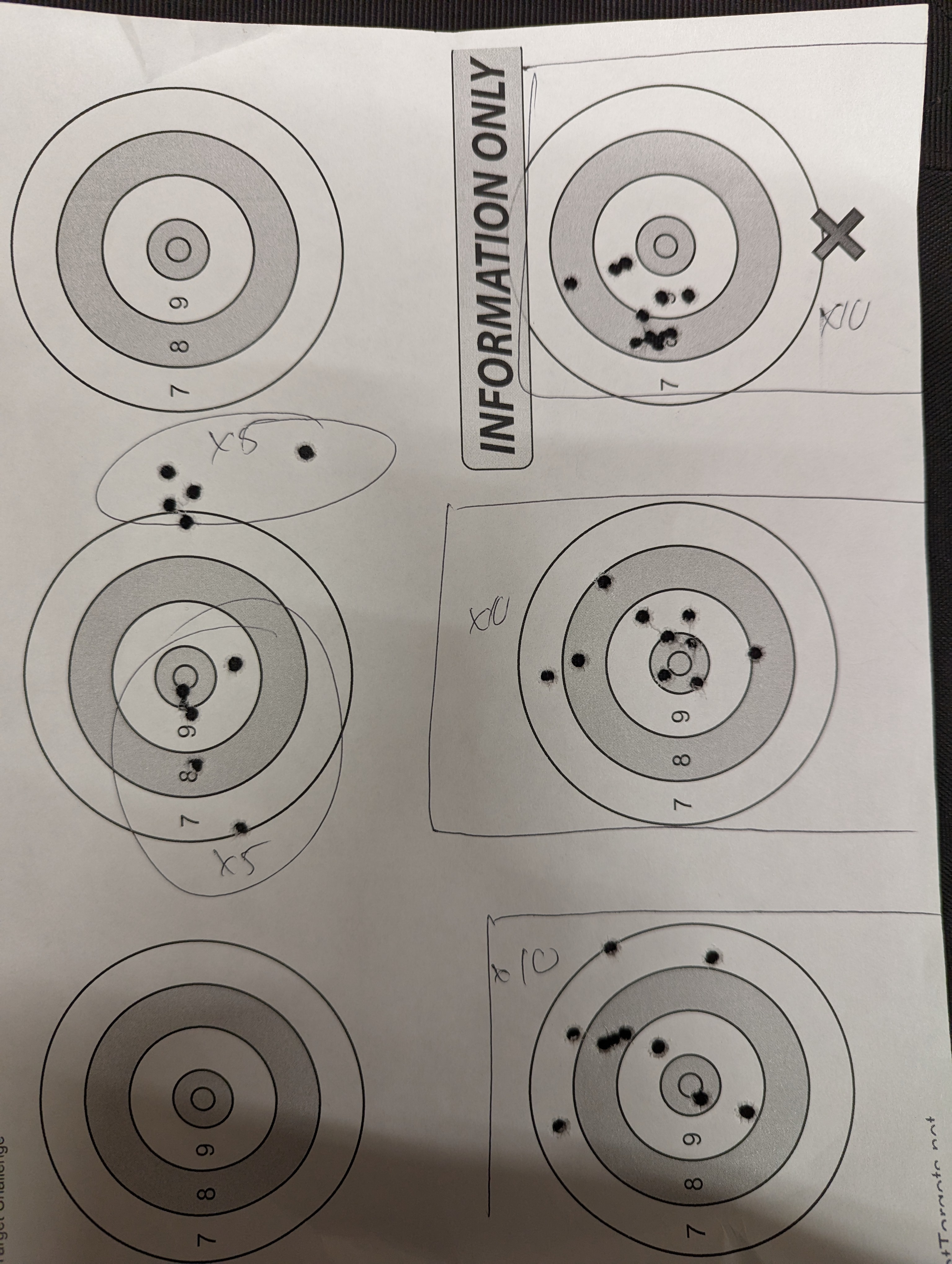

Here’s a pic of 5, 5 shot groups with my ft ghost with 13 gr jsb. Top row is 950 fps with mod middle is 810 fps with mod and bottom is 810 fps no mod. Was shot at i think 35 yds mod was a short 0 db
Groups were shot single load same aim point and no wait on wind
