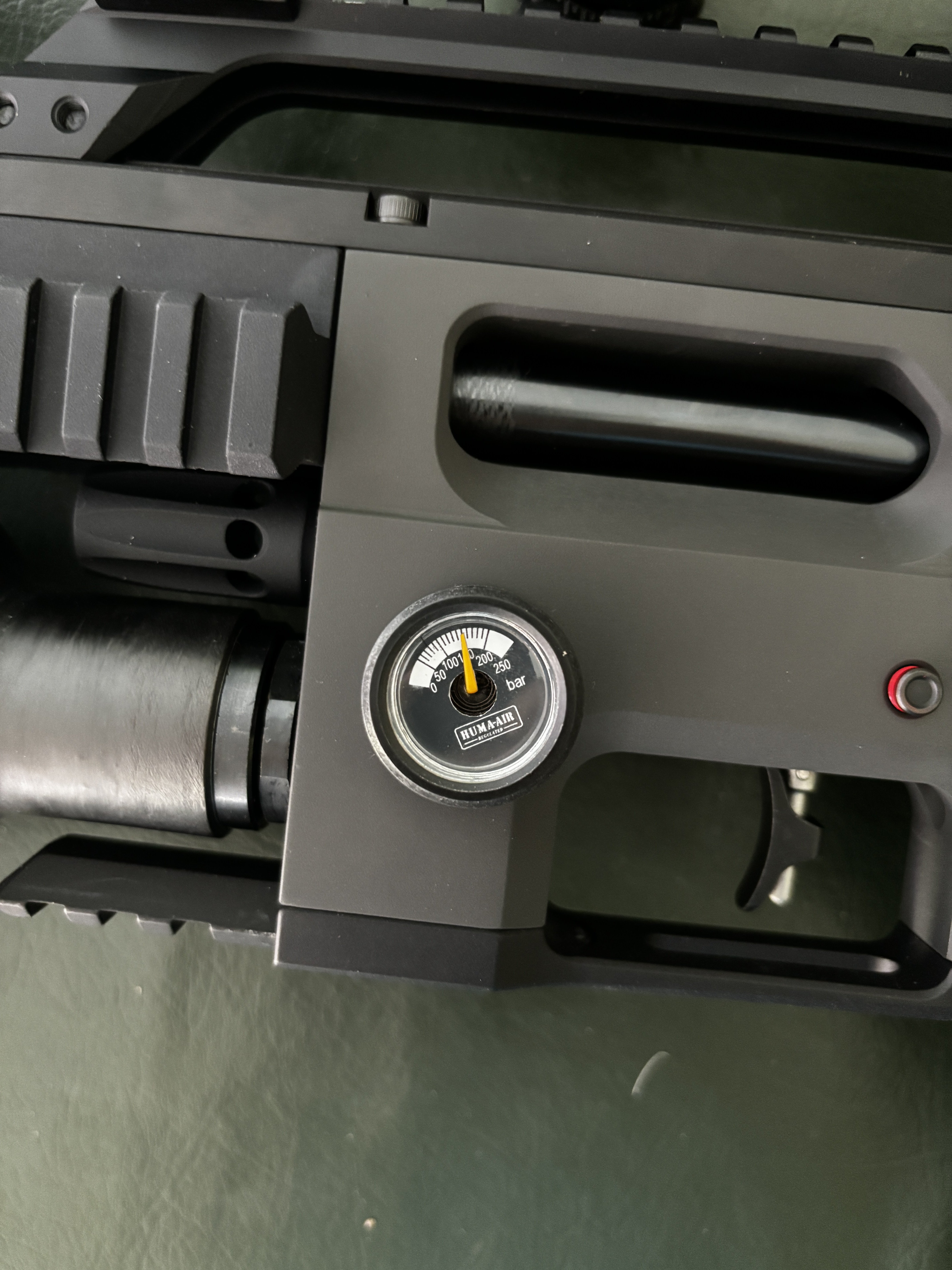

@Franklink

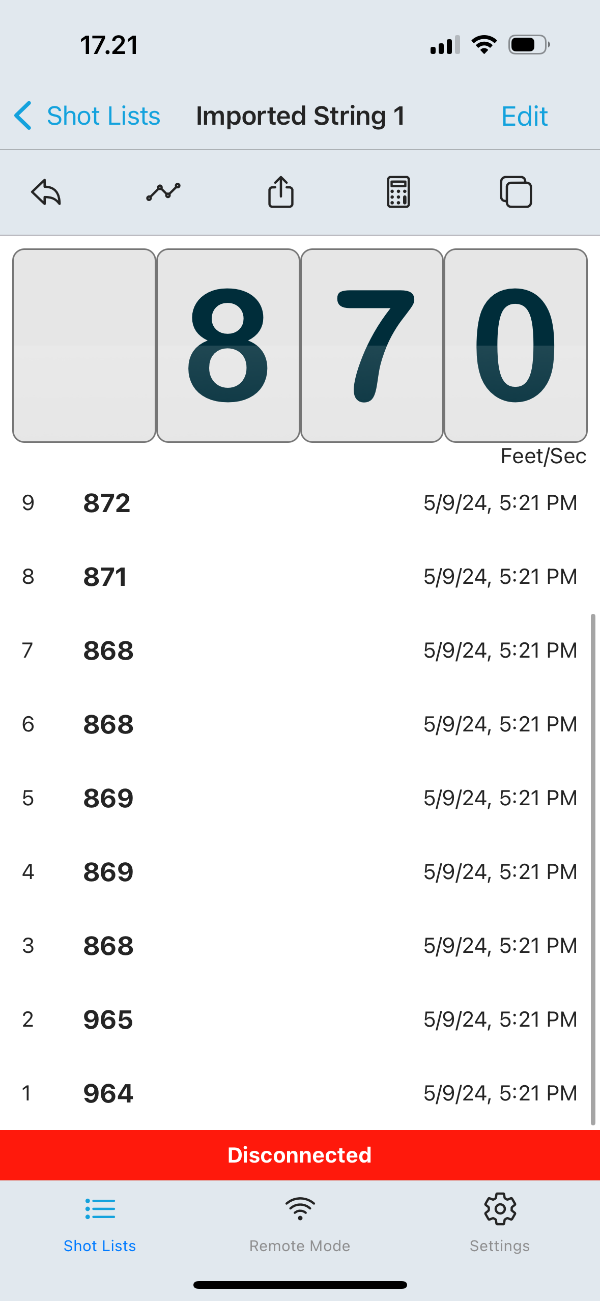

Today i shoot a brand new GHOST HP .177...
When i fill the bottle, i see that the regulator pressure is 150 Bar (Factory Setting), i took a picture because my eyes is + and Cylinder, so i can see clear when i zoom in the photo :ROFLMAO:
so i decrease the regulator pressure to 100 Bar, and set the PW to MIN
1-2 ==> FPS 964-965 - JSB 10.34 gr ==> 100 Bar PW-MIN
3,4,5,6,7 ==> FPS 868-869 - JSB 13gr ==> 100 Bar PW-MIN
8-9 ==> FPS 871-872 - JSB 13 gr ==> 100 Bar PW-11
I shoot sillouette with Zeroing at 33 meter, it is flat shoot between 18mtr, 25mtr, 33mtr, 41mtr ==> This is awesome, i am wondering why this can be happend ?

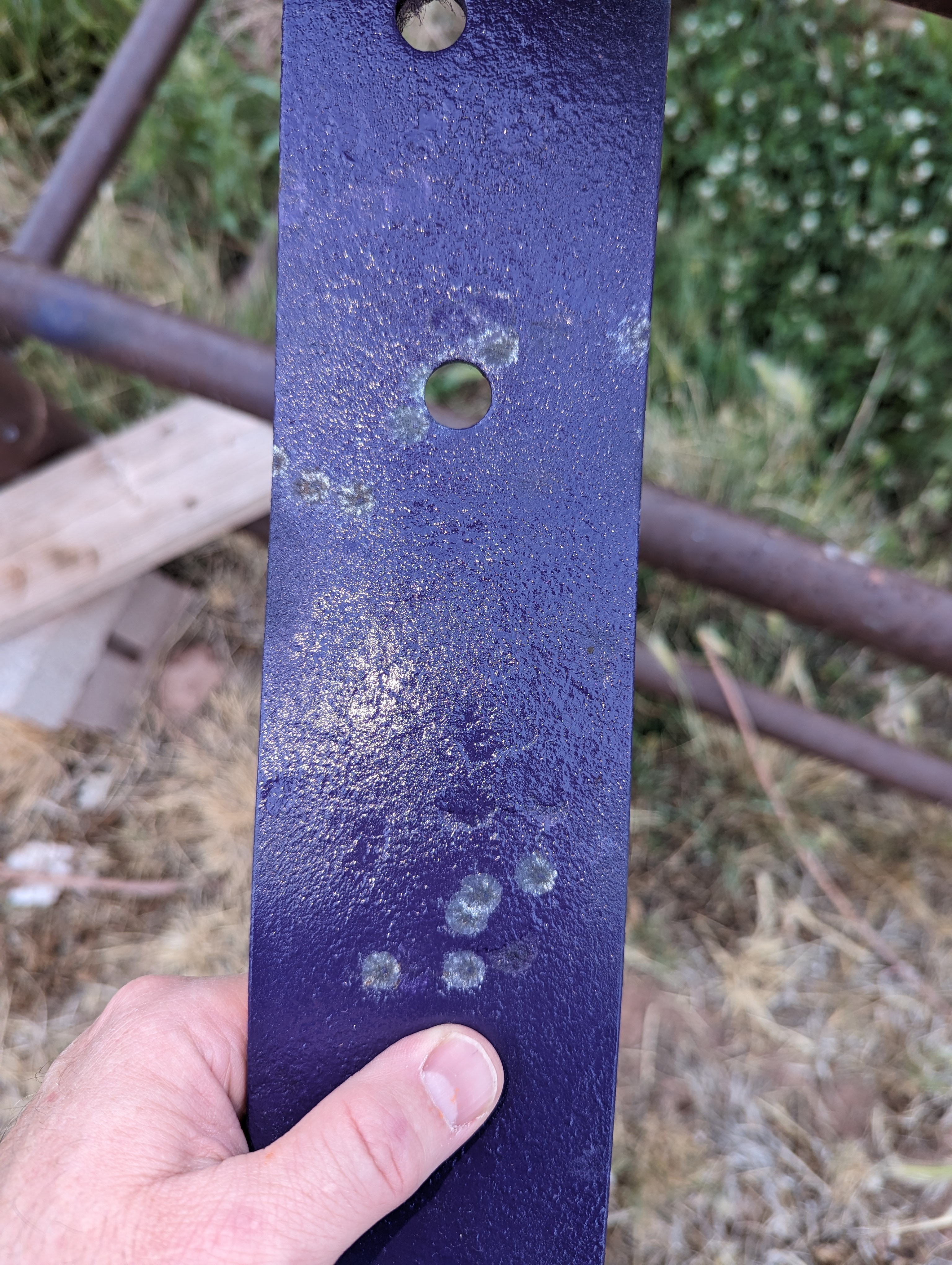

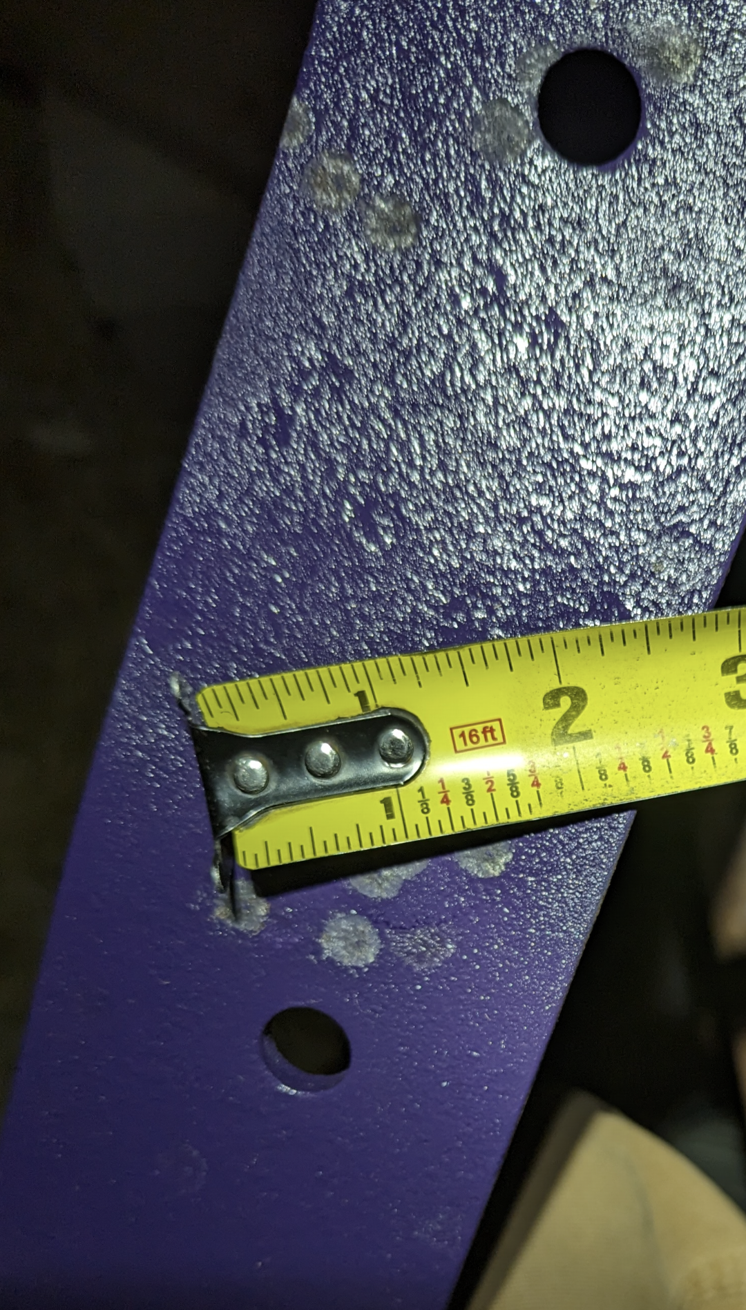

Been awhile since I shared anything Ghosty, but I've still been immensely enjoying the platform.
Just casual plinking this evening....
Repainted the steel yesterday but didn't have a chance to shoot at it til just now, after work.

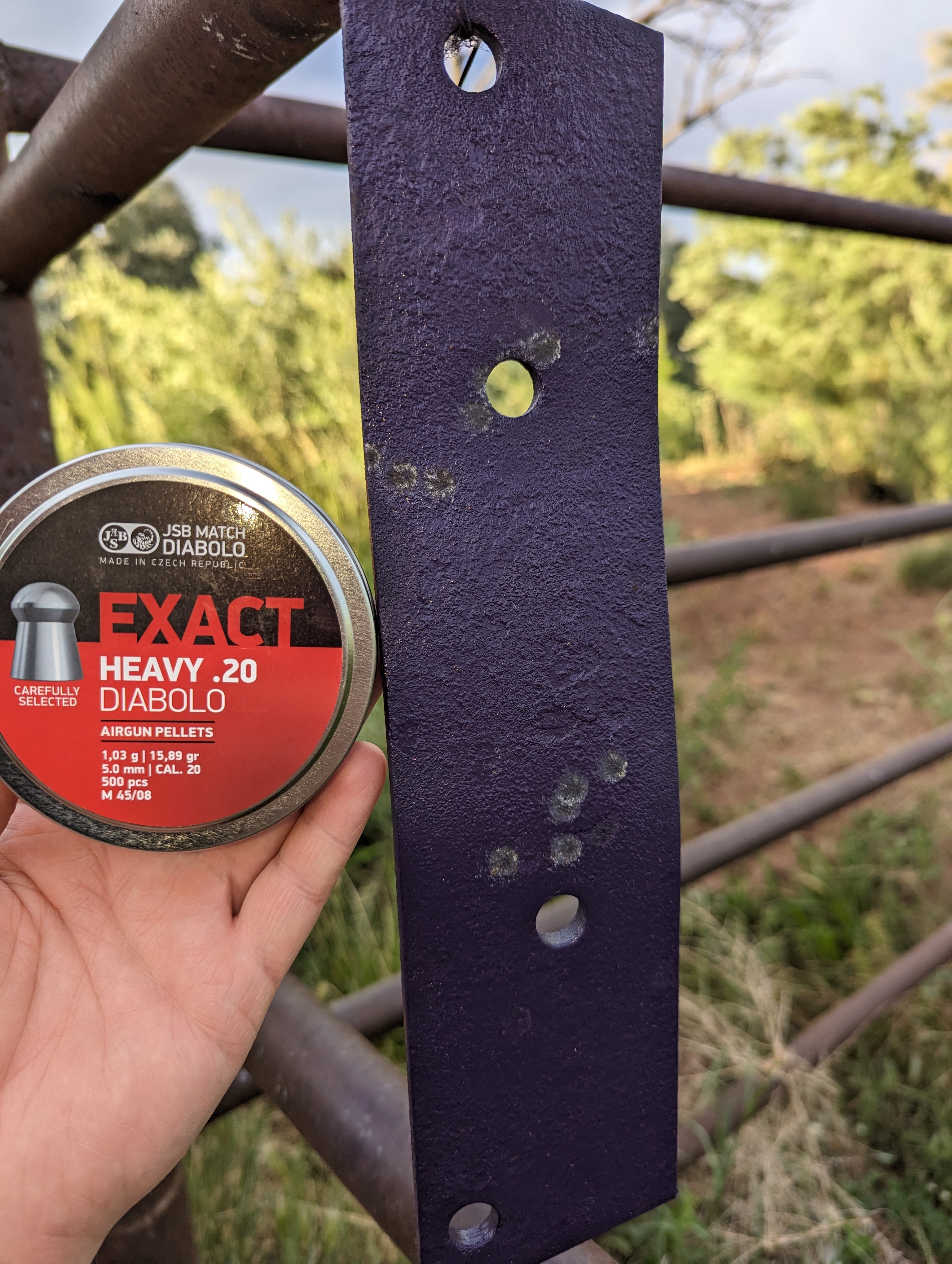

I took 5 shots at the paddles, 3/5 connected, one on each paddle. These are @ 130 yards. Big ones are maybe 2.5", small one is probably 1.25-1.5".
Then took 15 shots at the old brush hog blade behind it, 135 yards. Ten shot group using the top hole as the aim point. Three shots are right at the hole, the 9 o clock hit actually mostly went in the hole, but there's a 1 o clock and a 7 o clock that are edge-touching the hole. 7/10 connected for a kinda big group.
Then took five shots using the lower hole as the aim point. MUCH better group here, had the wind figured out by then. Didnt measure but something like 1.75-2" or prairie dog head sized for all five shots. I'll take that!
Wind is whipping pretty good, needed 0.6-0.8mil hold off. This is with the .20/15.89 @ 915-920.
Fun stuff.
Went on a long evening walk with my wife right after dark but got back from that and couldn't resist walking to the back of the property with a tape measure.
Confirmed that the large paddles @ 130 are exactly 2.5".
And this is a tape measure on that 5 shot group @ 135. Kinda tough to measure with metal and lead splatter. It's just a shade better than 1.5" but not quite as good as 1 and 3/8", call it 1 and 7/16 probably.
1.4375" @ 135 yards = 1.0168 MOA
Pretty dang sweet.
And THAT'S one of the reasons why I love the Ghost.

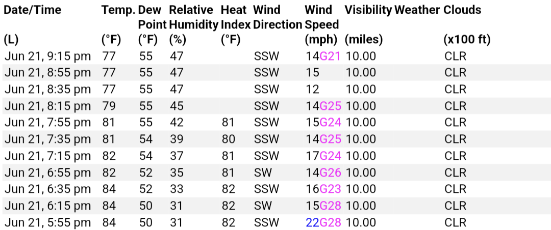

Oh yeah, this was the wind, groups shot around 7 o clock. I hesitate to share this, b/c it starts to get unbelievable here....29-30 fpe and MOA @ 135 yards in gusts to 25ish mph?!?!?!....😳😁
