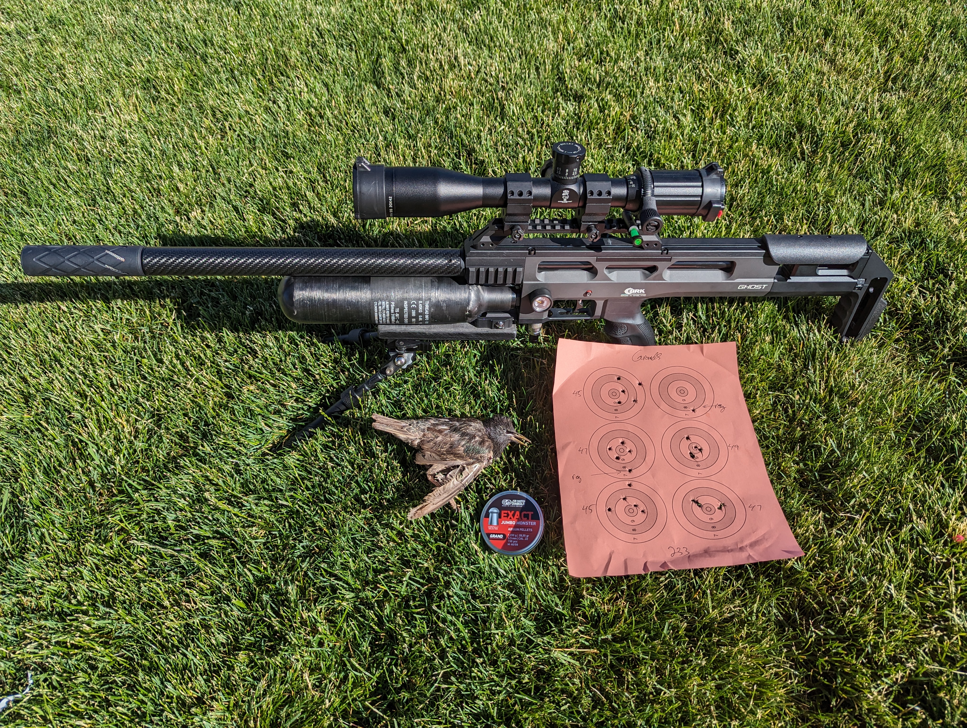

Been running the new JSB Grands @ 960-965, reg pressure of 150 bar. Shot this a few mornings ago, 100 yards. 233 but might be more like a 231-232 upon closer inspection (always guessing at how they'd "plug" for scoring). Dumb starling landed in the field at around 75yards about halfway through the card. That 60fpe mangled him up pretty good-broke wings coming and going. I do believe it was PLENTY of fpe.
Have shot as high as a 238 with this combination, but over the last few months, averaging more like 230-234.

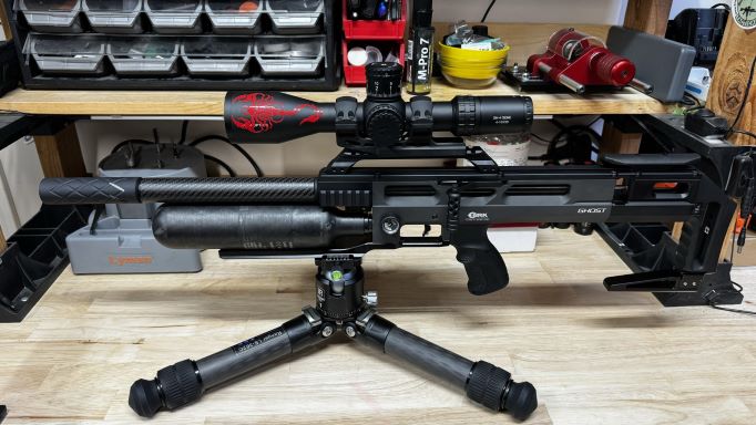

Received my Ghost .22 Plus yesterday and am excited to take it out for a test run this weekend. This is my first PCP gun and hope to like airguns. I have many different rifles / guns and have been shooting for over 30 years, but would be nice to have a plinker gun I can shoot at the house.
Not thinking about the gun being a bullpup rifle, it is very backend heavy and surprised me at first but it makes since with what is all located in the rear of the rifle.
I added the 0db moderator, PRS bag rider, extended rail and placed a Arken 4-16x scope on top. Only other option I might choose is to either cut the cocking lever by one notch or to get the PRS cocking lever since it is a little low, but will give the original a run for a few months to see if it gets in the way at all when actually shooting.
Oh and yes I am a lefty and am glad to see BRK truly having an ambidextrous bullpup rifle :)
Chad
Can you share info on the tripod and what do you think of shooting off a tripod vs a Benchrest?
Thank you in advance.
