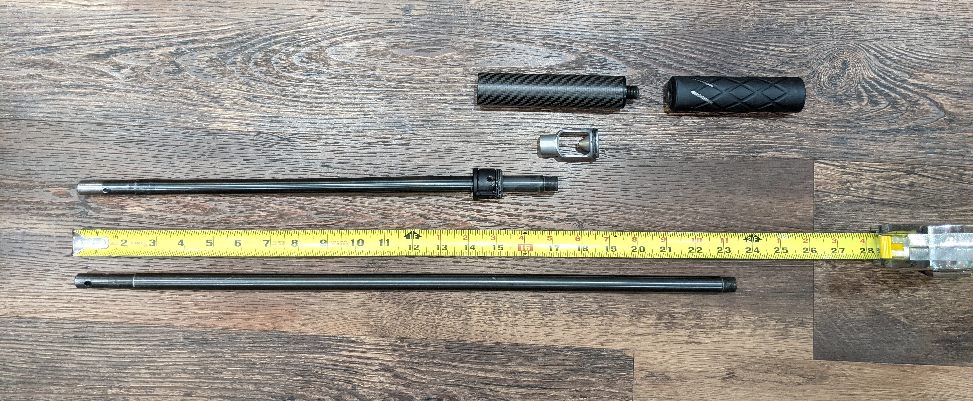

I don't think people realize just how compact the Carbine config of the Ghost is, partly b/c there's so few out in the wild and mostly b/c Soren and I haven't really focused on that aspect much.
So I just took some photos.
The first one here is the .177/17 inch barrel next to the .22/23inch.
The last one is with a 14mmx1mm adaptor to 1/2x20 and a short little Hugget Atom moderator. OAL
Is just about 27.5inchs. Aesthetics could be cleaned up by removing the rear shroud cap if this wasn't just for visualization purposes.
In summary, the Ghost Carbine is COMPACT.
