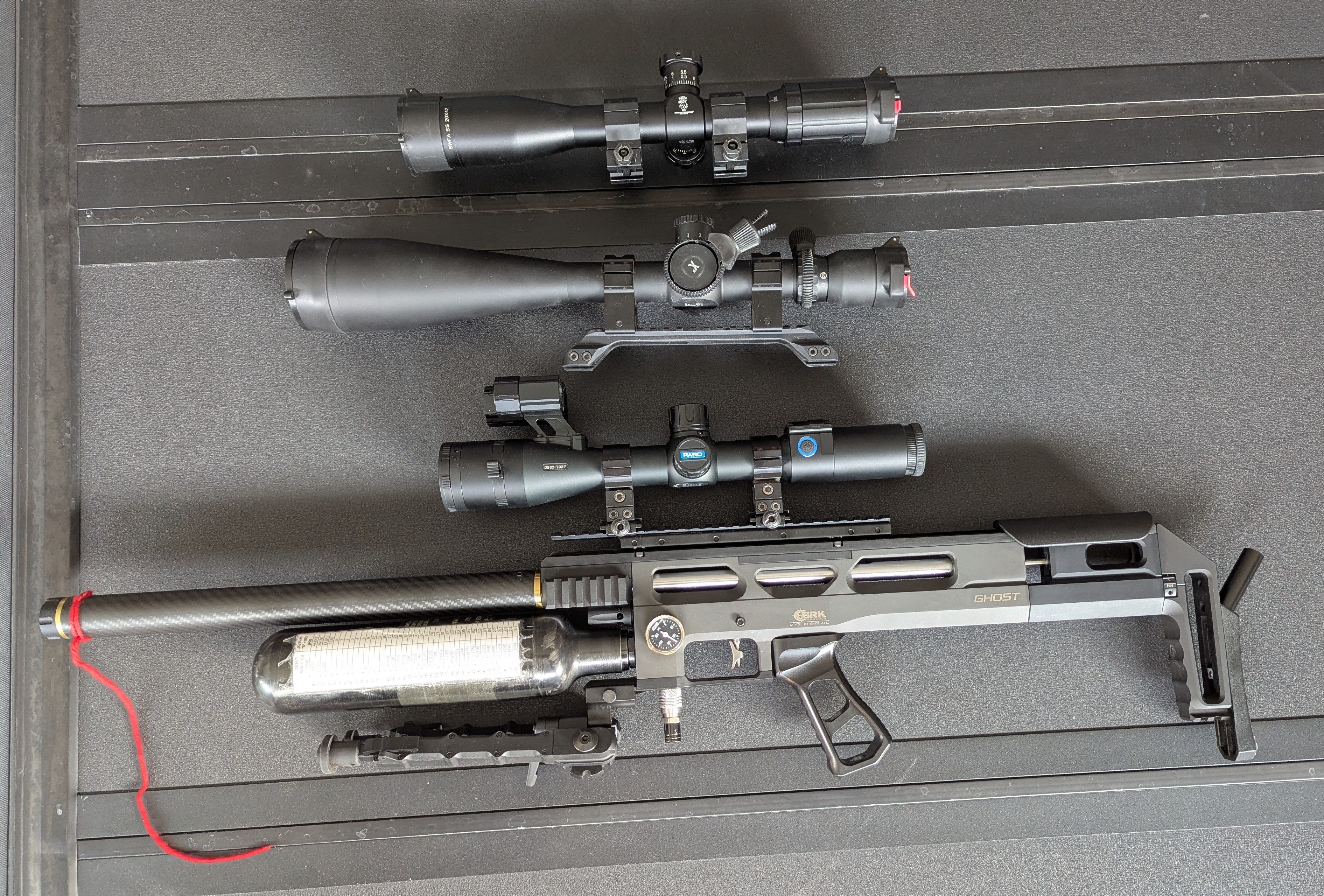

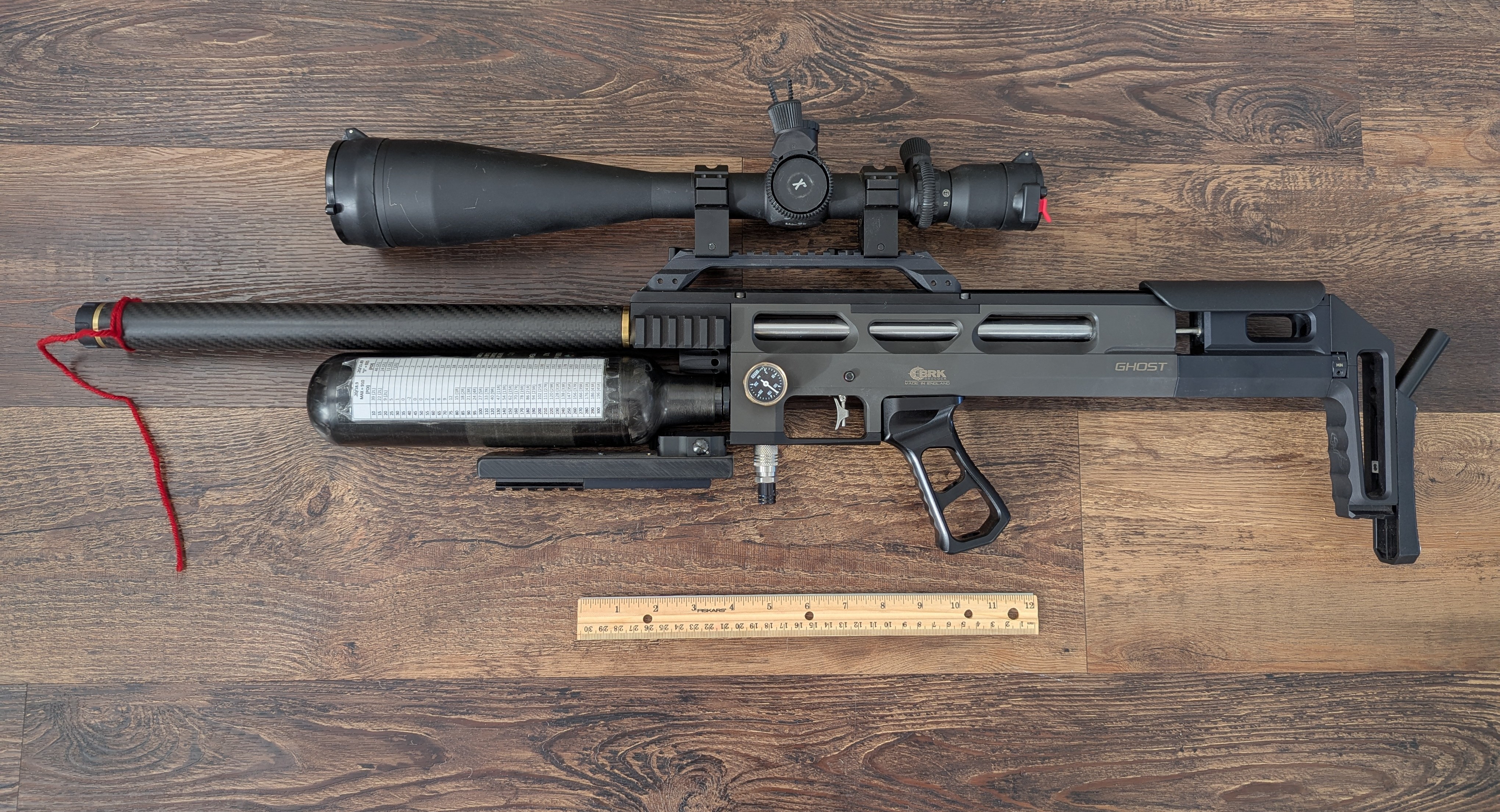

This was taken as a size comparison before I mounted the Falcon.
Bottom is the PARD (on the Ghost in the photo)
Middle is the X50
Top is the SWFA
Next time I get the gun out I'll try to remember to take a photo to share.
