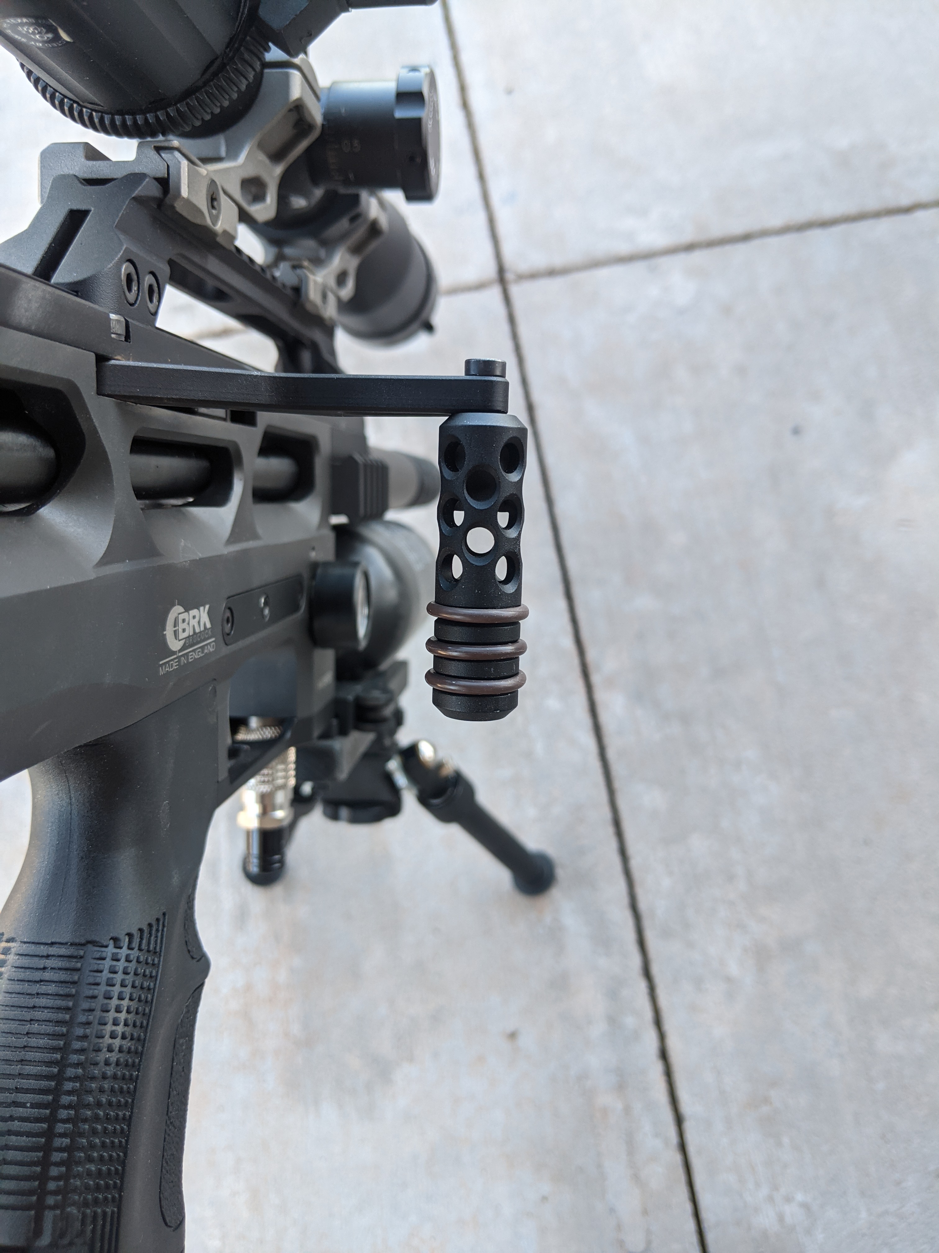

Somebody was wondering about orings in the grooves of the cocking handle....
A110 are a good place to start.
These have a slight brown tint, black would look better.

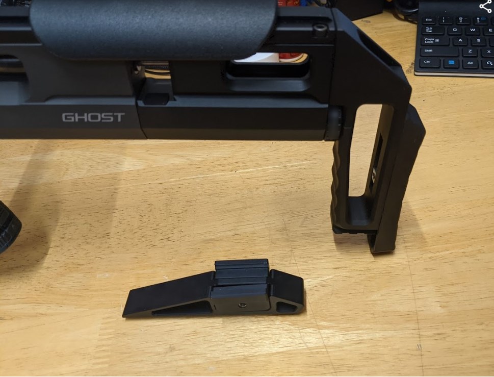

Had a few different chrono and bench sessions throughout the day today. All of it with the borrowed bad rider. I've seen these bag riders before and thought they were cool, but personally not really into benchrest much, I'd never envisioned buying one. Well, I gotta admit that they really improve the experience, when shooting from a bench and using a bipod and a rear bag. I mean REALLY improve the experience.
Couple niggles with it though....

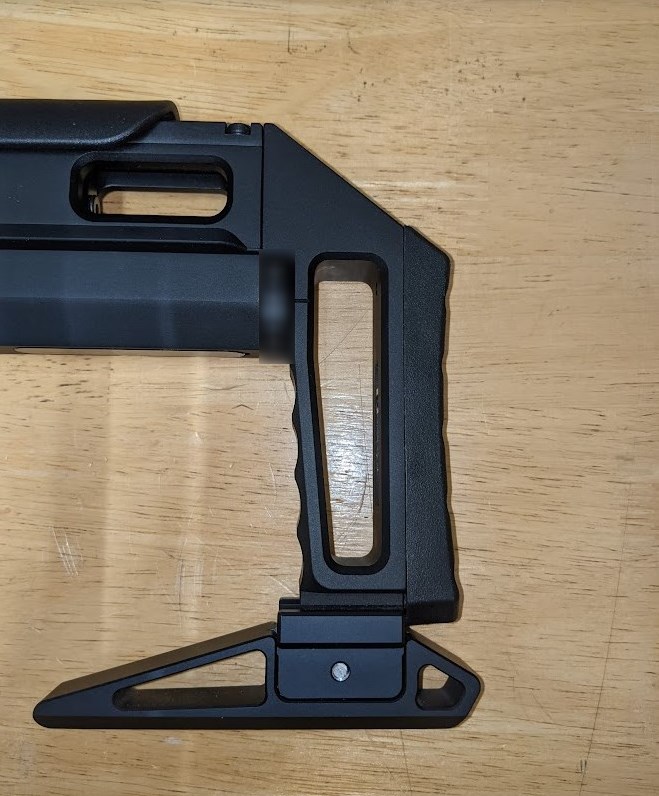

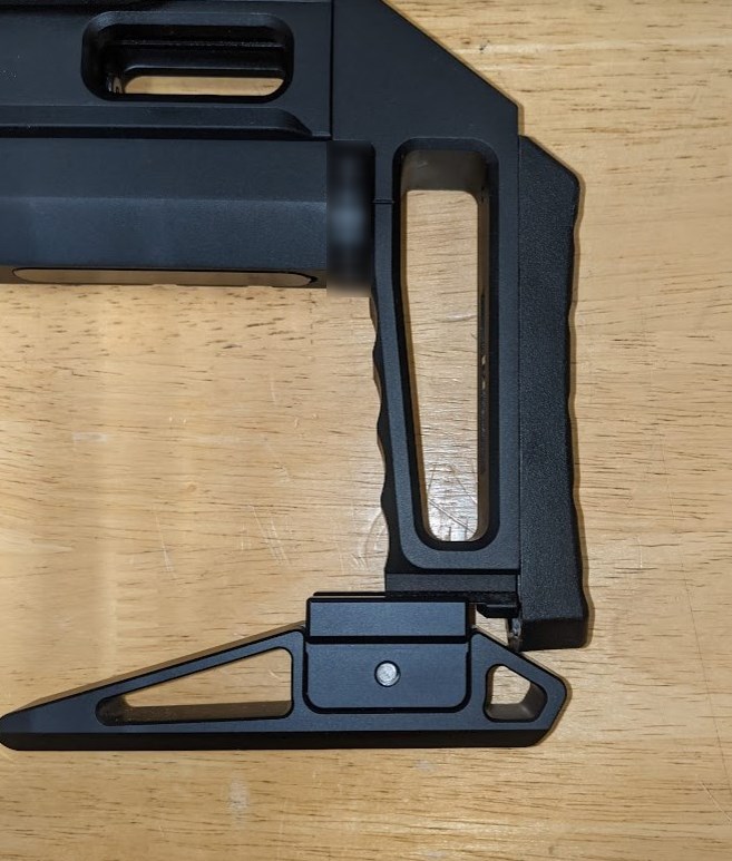

I adjusted the buttpad down, to fit me better, and it does. I usually like them lowered, when possible. I shot the ft match on Sat with it lowered as far as it will go. Like this...
Well, that bag rider won't attach with full engagement on the pic rail unless the buttpad is raised all the way up....
With the butpad slightly lowered it'll attach with probably enough engagement to be solid. But I'd sure like the buttpad lowered all the way.
Notice in the first photo how the clamp doesn't have the usual picatinny crossbar to fit in the slots. Seems to be plenty solid without the crossbar though.
I think Daystate/BRK probably chose to only put a two slot pic rail on here so that it doesn't extend out past the max width of the butt portion of the gun. And that makes sense, cuz a sharp-edged pic rail (and yes, I find all pic rails sharp edged) extending wider would just create a place for everything to snag, for any non-bench use. Compromises.
Overall, I found the bag rider concept a big enough improvement to warrant adjusting the buttpad up when I'm going to have a bench session. The buttpad adjusts with just one bolt, so it's not too big of a deal.

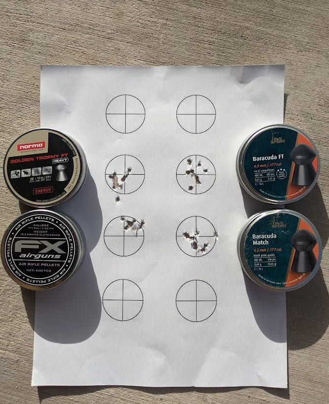

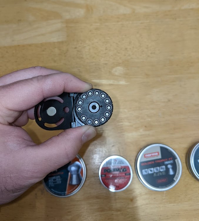

Here is the pellet testing. As previously mentioned, I was curious to see what the current settings could do, with only messing with the hammer tension adjust, leaving the regulator and hammer stroke length the same. Weights from 7.87grains up to 16.2.
Test design was as follows....(remember 13 shots in .177 magazine and why I did it this way makes more sense)13 shots over the chrono in the garage first (less lighting issues than outside and no chrono errors). Then outside to where I had two target traps at 50 yards, the first 3 shots were used in one trap to get the impact points roughly near a crosshair I could use as an aimpoint. The following 10 shots were then shot into the other trap, holding on the nearest crosshair to the impact point. So, 10 shot groups at 50 yards. There were no "fouling" shots or letting the barrel get accustomed to the new pellet. Quick and dirty (well not really, it still took forever).
I did not clean the barrel at any point in this testing, in fact, I haven't cleaned it since before the field target match on Saturday. I also only shot 1, ten shot group at 50 yards with each pellet (except for the 13.43s since I shot it at two different speeds, shot 1, 10 shot group with each speed for that pellet). So these are NOT the "best of the best" or cherrypicked "good" groups. These are the only groups I shot today. The only thing not shown here are the first 3 shots from each magazine shot at the other trap, to get an idea of impact points.
Chrono first.....refer back to this table when analyzing the photos of groups shared next. Those groups were taken with the hammer tension setting shown here.
  • Some of those speeds are simply too fast for the pellet, and some are too slow. With only one exception, the accuracy results support that conclusion.
  • Overall, the consistency was pretty good.
    • The Beasts were tight loading, but they have been in every gun I've tried them in.
      • the magazine wells were plenty deep for the 16.2gr Beasts, anyone familiar with them knows how long they are, like a tiny little dart.
    • An interesting thing to note is the ES on the 13.43 with two different hammer tension settings. At first glance one would assume the hammer tension had something to do with it, but I don't think that's the case. With the spread of 16.29 I didn't seat the pellets all the way into the magazine wells. And with the spread of 7.4 I did seat them the entire way (ball point pen). I noticed the loading into the barrel wasn't as smooth with the pellets not seated into the magazine entirely. And the magazine lid will shut just fine without fully seating the pellets. These photos were taken as an attempt to show fully seated, and not. I think I'll seat them the entire way now, seems to be better consistency, and for sure loads smoother. And some pellets just drop all the way to the bottom, some have a large enough skirt to not fall to the bottom.
    • Seated and not seated.

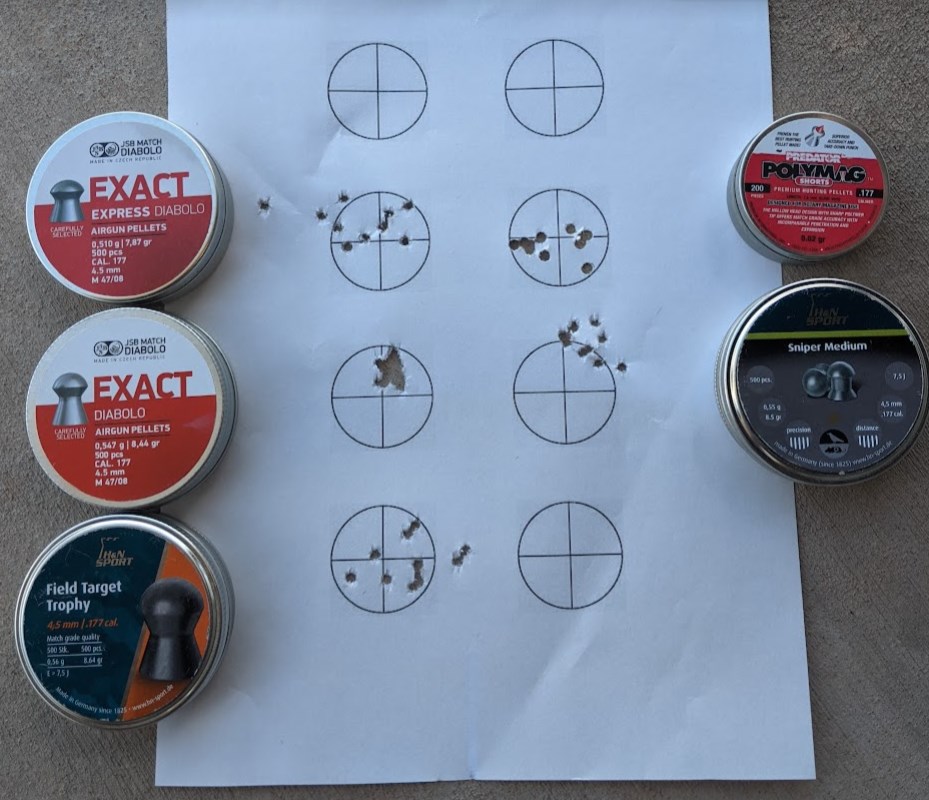

Here are the groups from the 7.87 to 8.64 grain pellets. Shot around noon and wind speeds were 3-7mph and shifting from right to left and left to right during this session, per NWS.
Those 8.44s were amazing at this speed. This was the surprising one to me, as I would have assumed that was too fast for that weight. The Sniper Mediums weren't too bad.
Here are the groups from the 9.1gr to 10.65gr pellets.... also shot around noon and wind speed were 3-7mph and shifting from right to left and left to right for this session.
About what would be expected, the gun was tuned to shoot a midweight pellet, so not surprising that these did so well. The FX/10.34 in the lower left was actually the tune used at the field target match on Saturday. I don't think I'd hesitate to shoot any of these four pellets at a field target match. Plenty sufficient accuracy for that game from all four of these pellets. In that regard, not very pellet picky, assuming gun is tuned for that window of pellet weights.

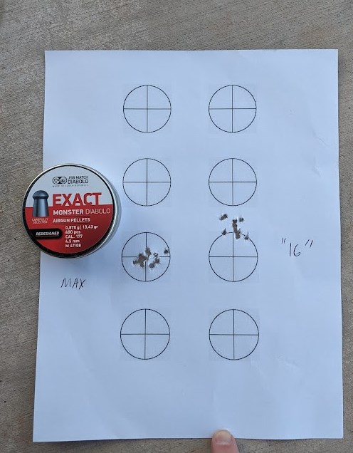

This is the Monster RD. Shot around 4pm and winds were 7-10mph during this session, again shifting from various directions.
Really quite decent accuracy, given the greater wind during this session, perhaps the best shooting pellet of the day.

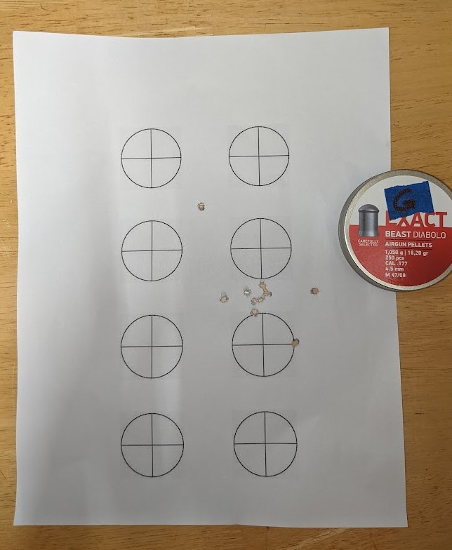

Finally, the groups from the 16.2gr Beasts....taken at 9pm and winds were 6-7mph, per NWS.
7 of the 10 went into a pretty decent group, the other 3 were definite flyers. Take a close look at the holes from those three flyers and you can see more lead smear on one side of the hole, as well as slightly oblong (non round) holes. My thoughts are that the 16.2s just weren't going fast enough to be stabilized with these settings.

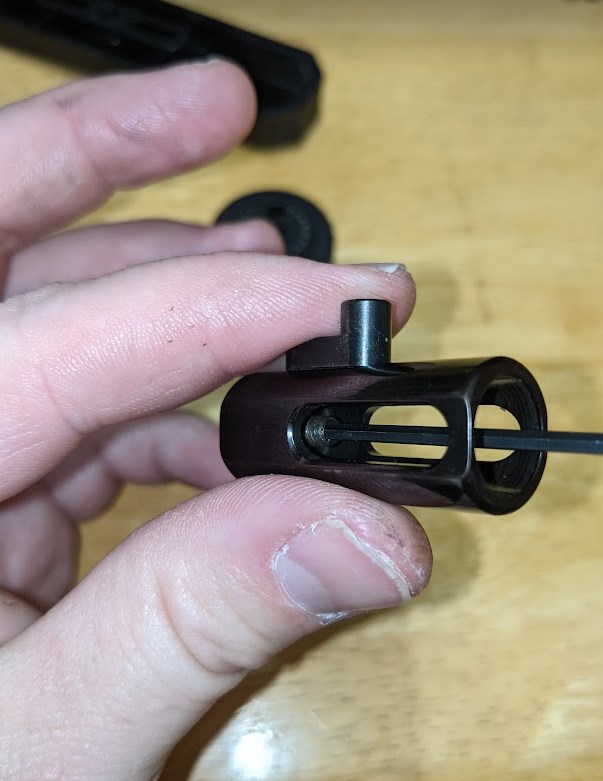

Hammer Stroke Length

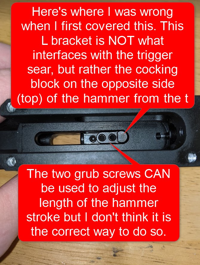

Post #23 had some inaccuracies (ie I was wrong). This post will hopefully clear them up. I'm learning this gun as I go but I do apologize for spreading false information back in #23.
The correct way to adjust the stroke length will be presented here.
There was an earlier request for photos and measurements of the hammer, those will also be presented here.

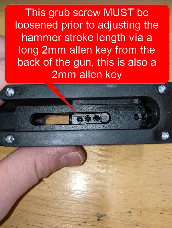

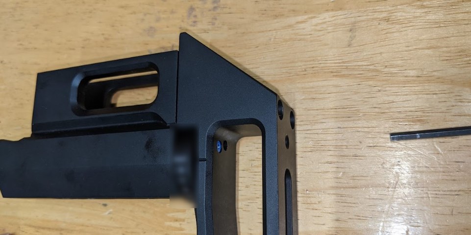

This level of disassembly is not required for hammer stroke length adjustments, but I needed to "see" what I was doing so I took it apart again. Hopefully these photos will help any future Ghost owners also understand how their gun works.

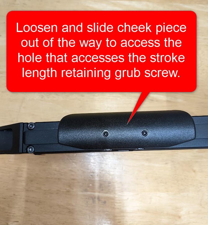

For adjustment of stroke length (again, disassembly not required).

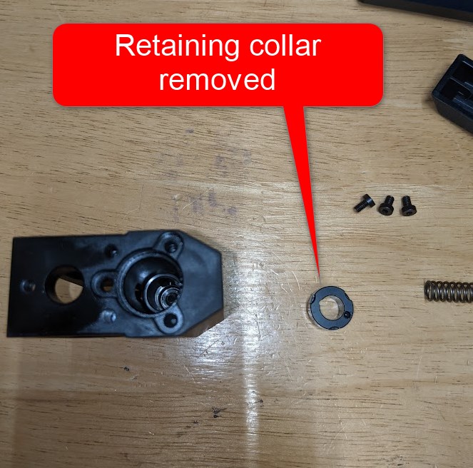

This is the rear sub assembly, removed from the gun as describe in the 3rd photo on post #57

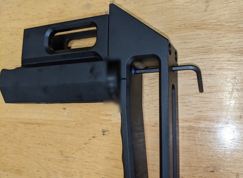

With hammer spring tension at max, the 2mm allen key can be inserted in these holes to access the hammer stroke adjustments. You'll need a LOOOONNGGGG 2mm allen key.
And the rest of the photos will hopefully help visualize what is in there.....

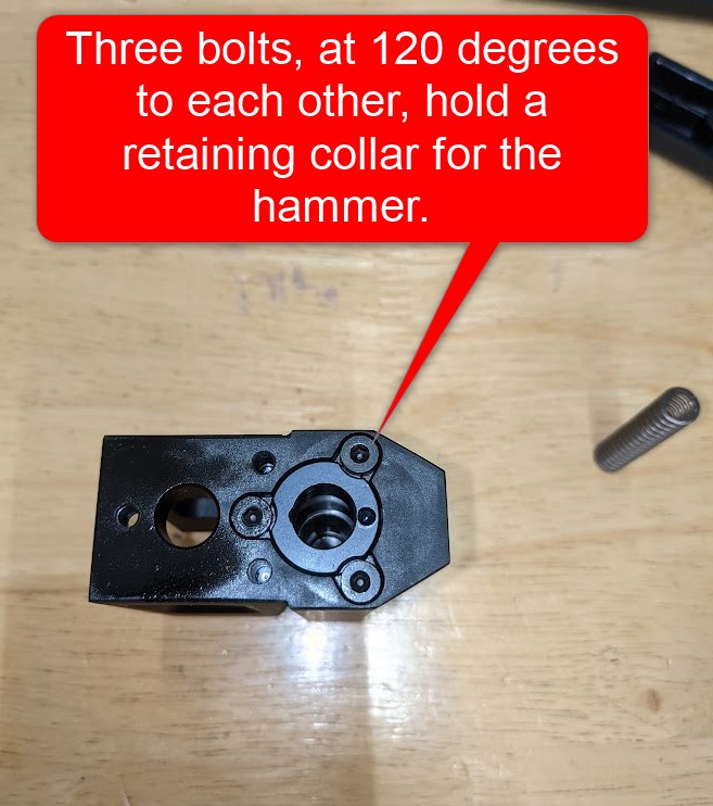

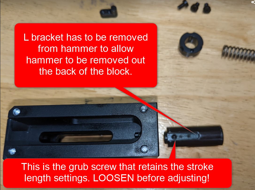

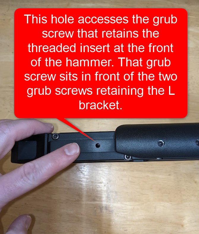

The grub screw being pointed at in the following photo is what needs loosened by accessing through the hole under the cheek piece (second photo in this post)

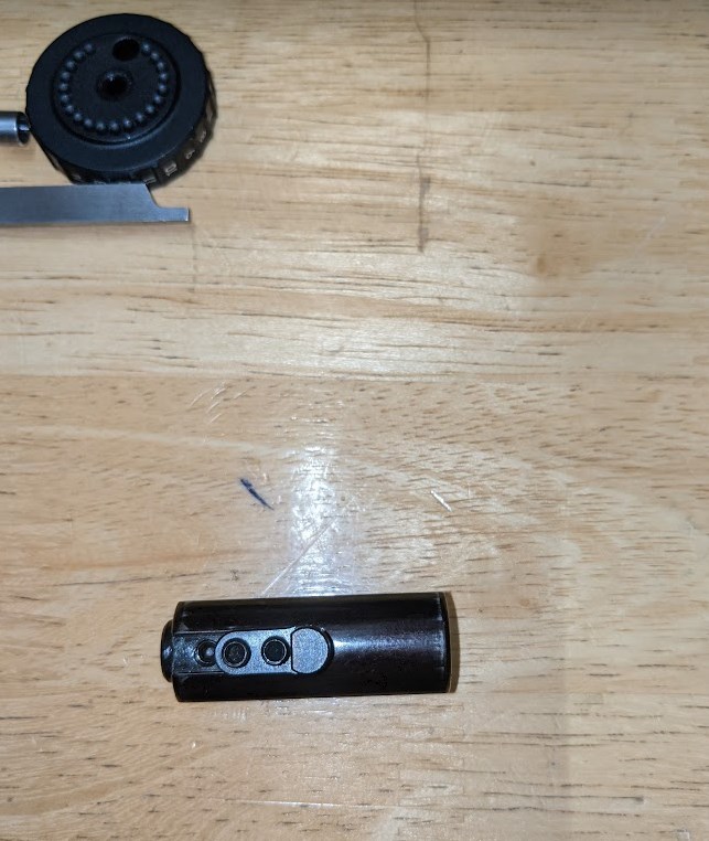

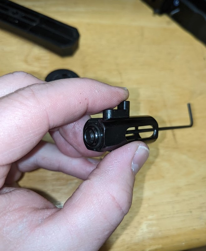

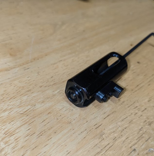

I replaced the L bracket with the hammer out of the gun in the next couple photos, again for visualization.

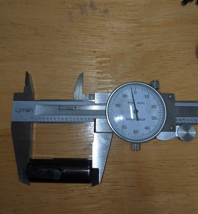

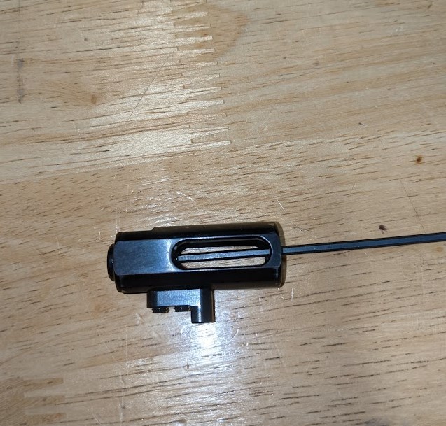

Max and min hammer length (max considered to be where the grub screw still has full engagement)
Clear as mud.
Clear as mud.
