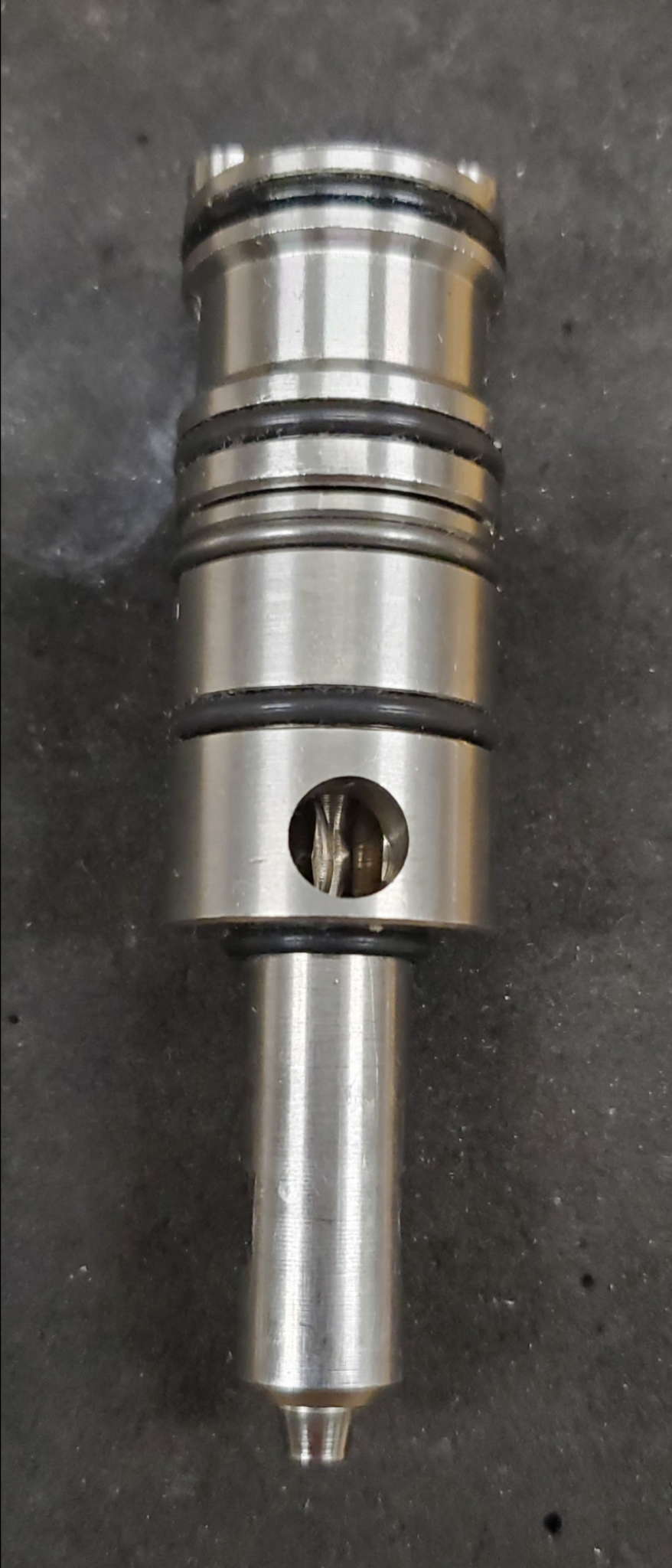

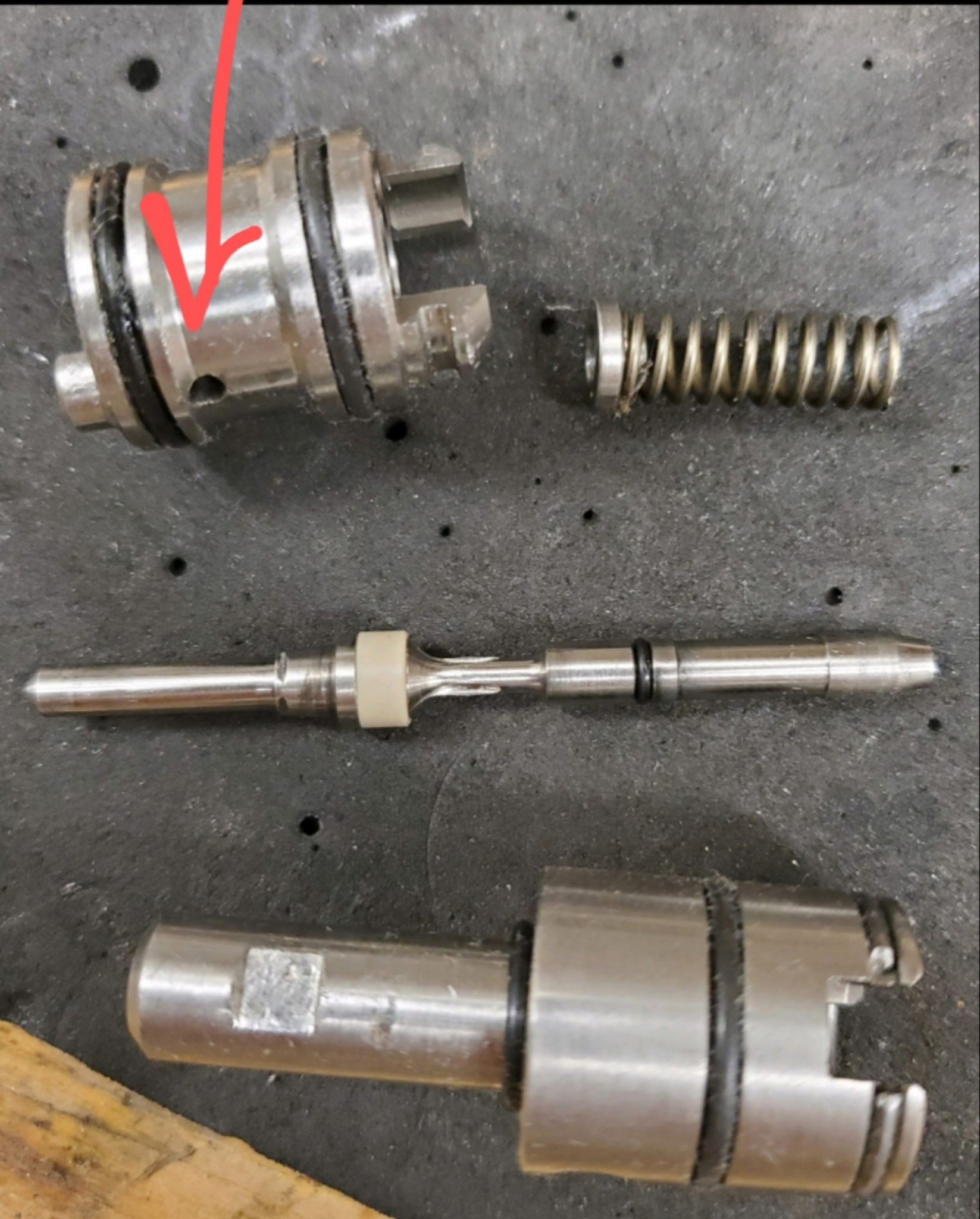

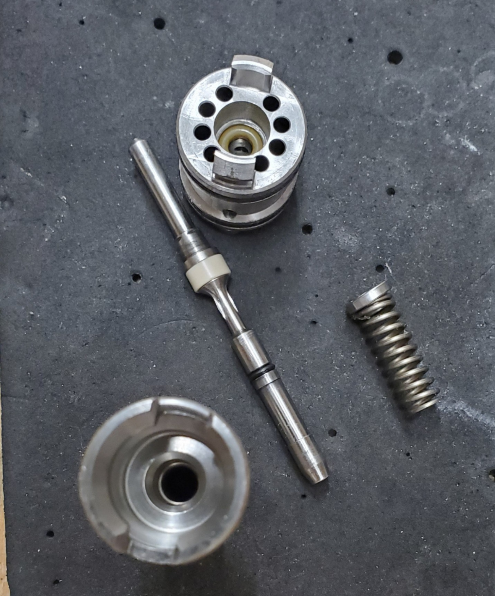

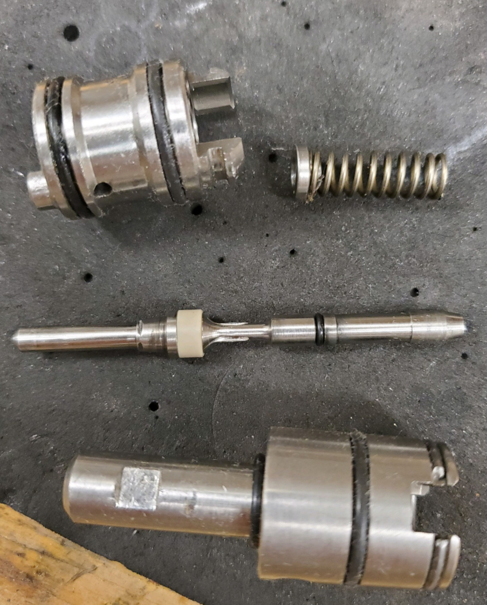

Valve Photos
These were sent to me by an industry contact, so I've not pulled the valve from the review Carbine... I usually understand function better if I can hold it and look at it from various angles.....
My first question to the contact was....what's this hole? (Atypical place for a hole on a valve, in my limited experience)
The response "The vent to atmosphere. In the straight down view, you can see the oring that seals the valve stem to the back end. That is why there's no closing force added from the plenum pressure. "
I already shared the next two photos earlier in the review, but it'll give some context for the valve photos above.... especially my text bubble starting with "5th fastener." Also, the flat on the rear of the valve body that can be seen above, and in the last picture here. That flat is what "5th fastener" (grub screw) secures to.
Hopefully that answers some questions and perhaps satisfies the curiosity about the valve.
I'm working nights right now so can't confirm but I think I remember being told that the Ghost and the Delta Wolf and Alpha wolf all have the same valve. I'll update tomorrow when I know for sure.
Reactions: TerryE1
The BRK Ghost has got the updated balanced valve from the Daystate Alpha Wolf 👍🙂

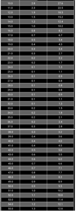

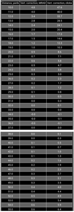

Dope data and scope height
The following is pretty specific to folks with an interest in field target, so if that's not you, maybe skip this installment.
Back in post #92, in reference to the dope data I used for the FT match, I stated the following: "The design of the gun puts the scope above the barrel quite a bit. I used higher than necessary mounts because they were already on the spare scope, so the scope was EVEN higher than it would have been otherwise. Once a guy has set up a handful of field target guns, you get a feel for how trajectory plays out. Well, with that scope so far from the barrel, it threw me for a loop because the dope data was quite different than what I see with most guns. The whole thing meant that I had a nice straight neck for seeing through the scope, but the close shots needed much more elevation than I'm used to seeing on ft guns."
There's a discussion going on in the field target area right now about the challenge of ranging with 16x. Some of the participants have commented how hard it is to determine distance at 45+ yards when only using 16x. All of that got me thinking it might be interesting, and maybe even beneficial to folks for me to share the following. So this post will not be specifically about the Ghost, but rather using it as an example to illustrate how strategically setting up a gun for field target matches can result in higher scores.
This first table is the dope data I used for the Ghost at the field target match on Sat. This is with JSB 0.177/10.34gr going 890-900fps, using a zero of 35 yards, a BC of 0.032, and a scope height of 3.3inches. (I haven't collected a BC but eventually will, this data was arrived at by using impact points shot at 10-55 yards and then reverse input into Strelok to get a matching table.)
The following is the dope data Colben used for the gun he shot. It is with JSB 0.20/13.73gr going 800-810fps, using a zero of 30 yards and, a BC of 0.045, and a scope height of 2.3inches.
I want to point out the 45 and 55 yard clicks required.
  • For the Ghost, with the scope height of 3.3 inches, 45 yards needs 2 clicks and 55 needs 6 clicks. (a vertical difference of 4 clicks on a 1/10 click scope is all going to be within a legal kill zone at 45+, so calling it 45 or 55 won't matter, the pellet will hit the kill zone either way, assuming a steady hand).
  • For the .20, with the scope height of 2.3 inches, 45 yards needs 7 clicks and 55 yards needs 13 clicks (the vertical difference is 6 clicks, over half a mil now, assuming steady hand, some of the shots will still fall into the kill zone if it is mis-ranged, but less wiggle room.)
Also note how much more elevation is needed for the 10-15 yard shots with the high scope height Ghost, when compared to the elevation required for the same distance with the lower scope height .20.
There's quite a bit to glean from all that. A couple big ones though.....
  • First, trajectory. Many in ft have moved to the loopier .177/13.43grain pellets at about 800fps (to stay legal). The argument being that it bucks the wind better. In my comparison here the .20/13.73 is comparable to the .177/13.43 as it also needs to be kept to just about 800fps to be legal. With that loopier trajectory, there's less wiggle room on the ranging of the far targets, because the heavier pellet is dropping more quickly than the lighter 10.34s.
  • Second, scope height. An exaggerated scope height will result in less holdover/elevation for the far shots, but will require more elevation for the 10-20 yards. In the case of a 16x Hunter shooter that knows his scope ranges well from 10-20 yards, but not so hot at 45+ yards, it would make sense to set the scope higher.
  • Third, take a look at the zero range, for the 10.34grain pellet, 26-46 (20) yards is within 0.2mils of zero. For the 13.73grain pellet, 22-36 (14) yards is within 0.2mils of zero.
"But the BC is better with the 13.43s." Yeah, maybe, but just learn how much to hold for varying wind values and that becomes a non-issue. We're shooting at large targets in field target. It's more a game of knowing your gun and having it be dependable by maintaining its impact point and consistent velocity than ultimate precision.
I'll conclude with commenting that my 0.177 pellet stash has a WHOLE LOTTA 10.34s, and very few 13.43s.
(and find a barrel that'll push the 10.34s up to 930fps and the difference becomes even more profound than the example used above).

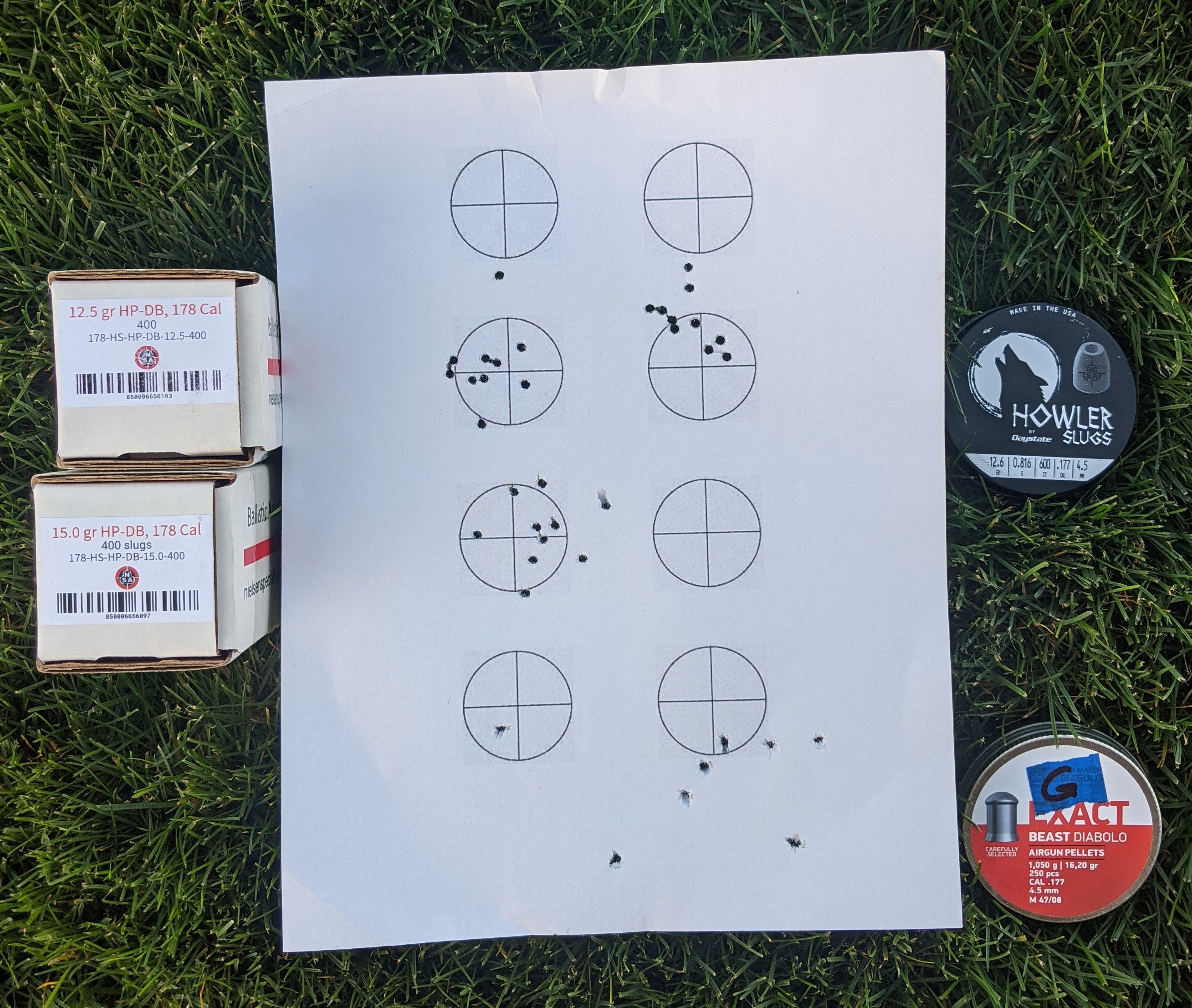

I then went outside for 50 yard accuracy testing....and it wasn't pretty.
The 12.5 NSA/Howlers did the best, that Howler group was 10 shots at about 1.25inches. The 15grains are just too slow. And the Beasts were curve balling pretty bad-also probably pretty slow. There wasn't enough wind for it to be causing what I was seeing.
To be completely fair to the .177 slugs, and before I move on to the .22 barrel (which I'm just itching to do), I really should scrub the barrel and retest the 12.5NSA and 12.6gr Howlers at 50 yards. If results are better I'll stretch it out further, but I'm not overly optimistic.
It's hard to choose a projectile that is producing 1.25inch groups at 50 when I've got at least four different ones that'll AVERAGE 0.75inch groups and occasionally shoot 10 into 1/3rd of an inch.
But next step will be retesting accuracy (after a good barrel scrub) with the 12.5 and 12.6 grain slugs at 50yds (and maybe further if the second go-around @ 50 is better than the first.)
After that, I'll put that .22 barrel and probe on this thing and see what it can do!

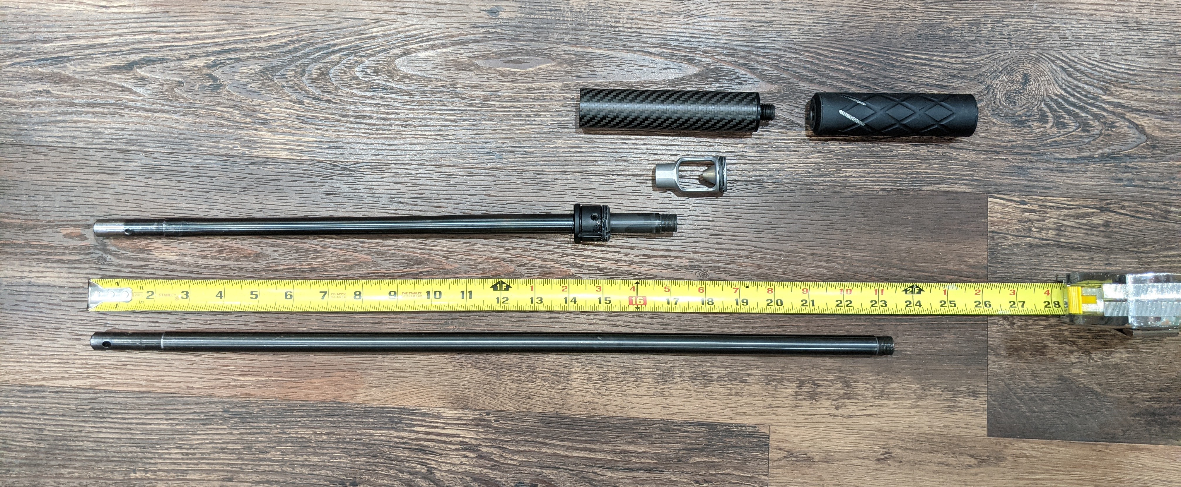

So I just took some photos.
The first one here is the .177/17 inch barrel next to the .22/23inch.
The last one is with a 14mmx1mm adaptor to 1/2x20 and a short little Hugget Atom moderator. OAL
Is just about 27.5inchs. Aesthetics could be cleaned up by removing the rear shroud cap if this wasn't just for visualization purposes.
In summary, the Ghost Carbine is COMPACT.
