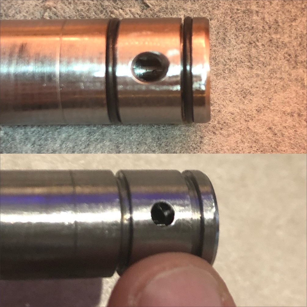

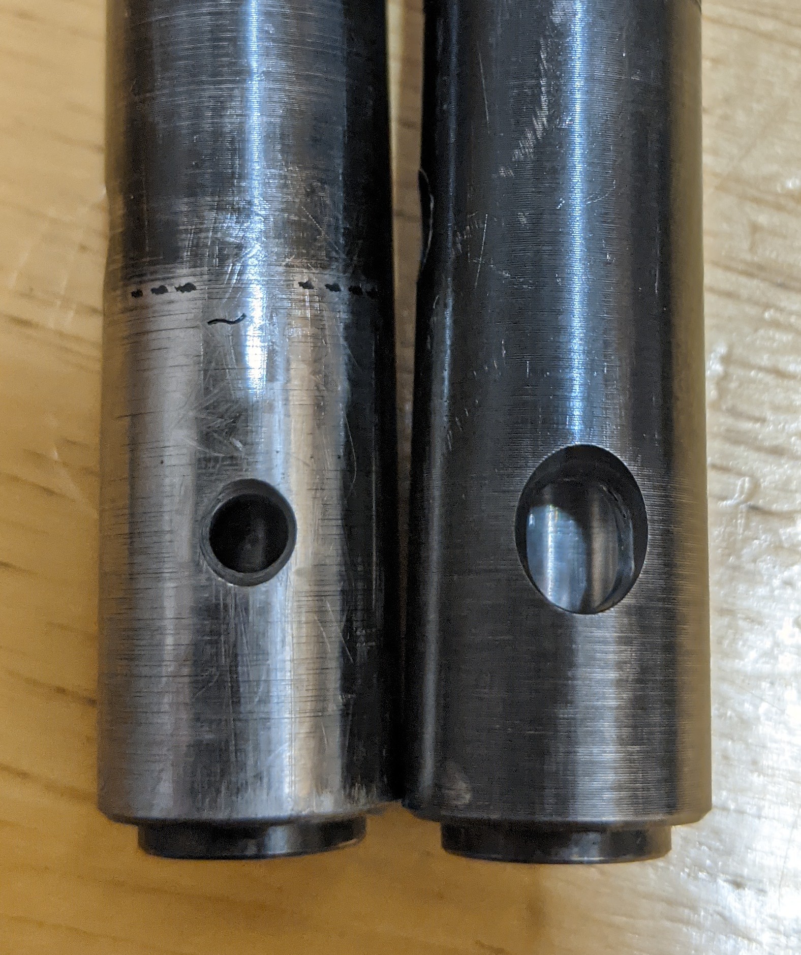

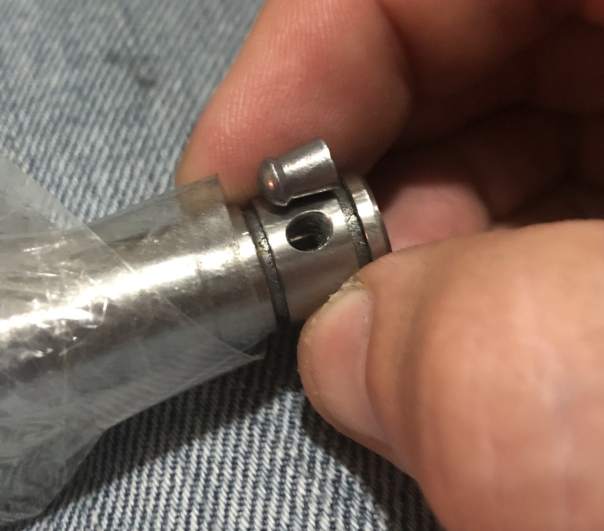

Talk about EASY caliber change!

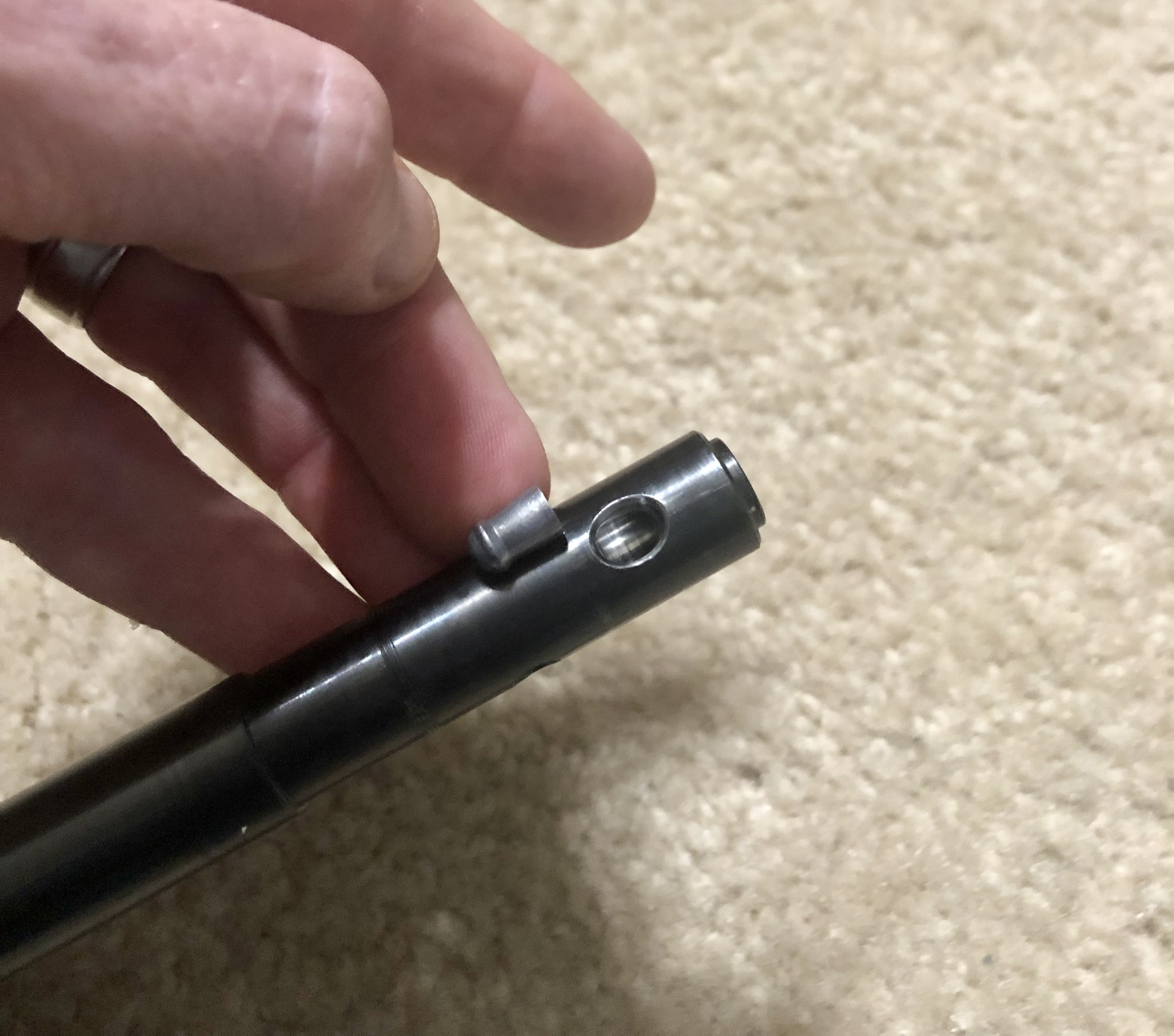

Here are the transfer ports (.177 on the left and .22 on the right)... The .177 Carbine (and therefore barrel) is a demo gun. I'm not sure of its provenance prior to coming to me. The .22 barrel has been floating around in the ART program for who knows how long (could be up to 2 years), since it also fits a Delta Wolf. In short, they obviously picked up some scuffs somewhere in the R&D/testing phase.

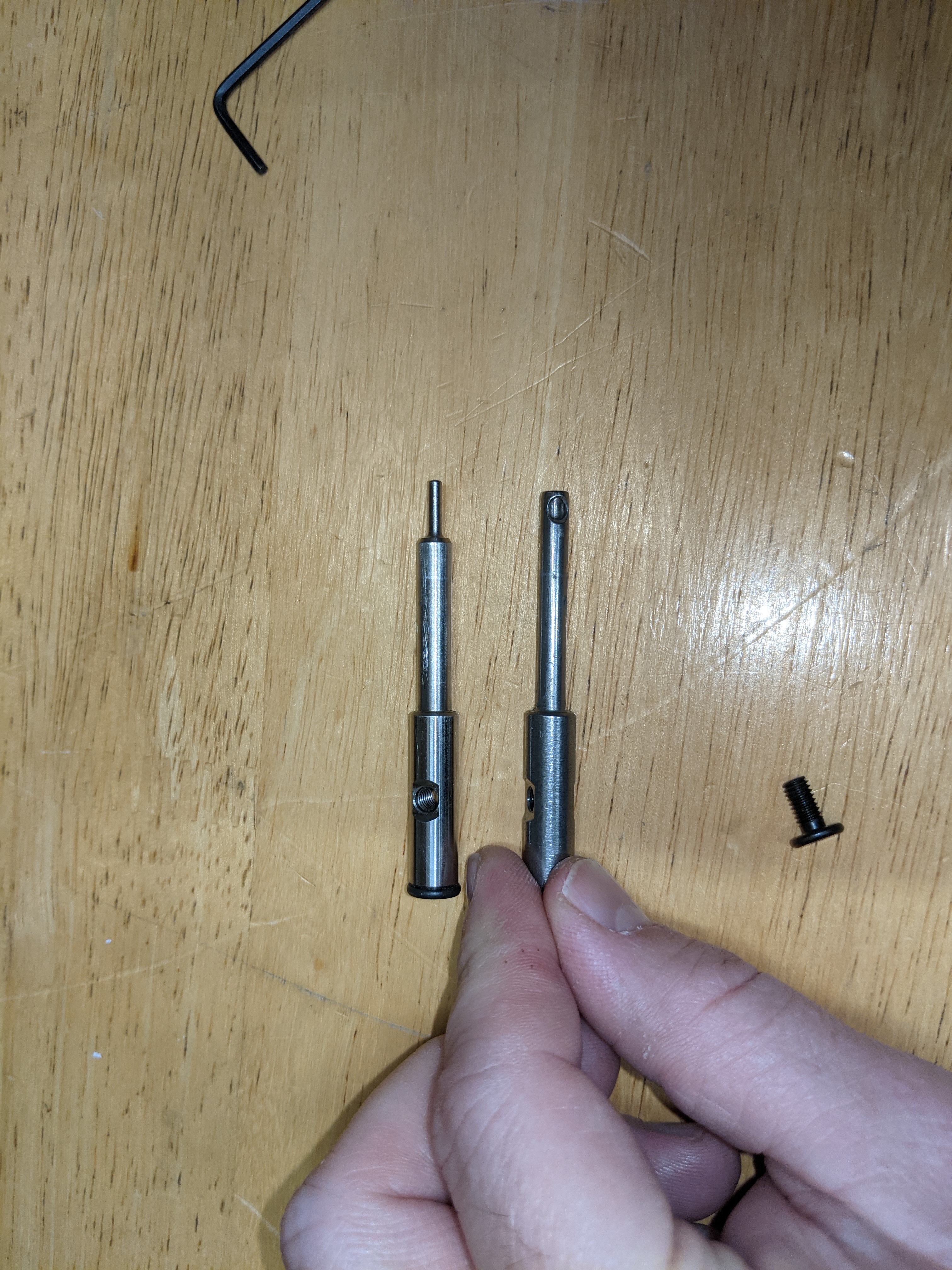

And the probes (.177 on the right and .22 on the left), yes, flow-through for the .177, and extended pin type for the .22)

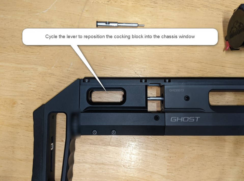

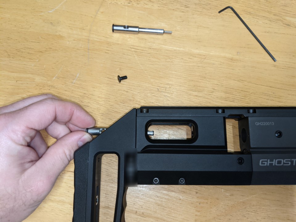

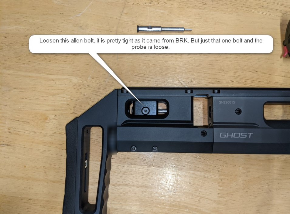

Here's the sequence for changing out the probe.....
Push the cocking lever forward to also move the cocking block forward.....
Probe will slide out the back of the cocking block...
And continue right out the back of the rear sub assembly.
Replace with the correct probe for chosen barrel, in reverse order.
I was told that the bolt in the back of the pellet probe is for the magnetic hold on the Alpha/Delta (electronic) variation of this gun.

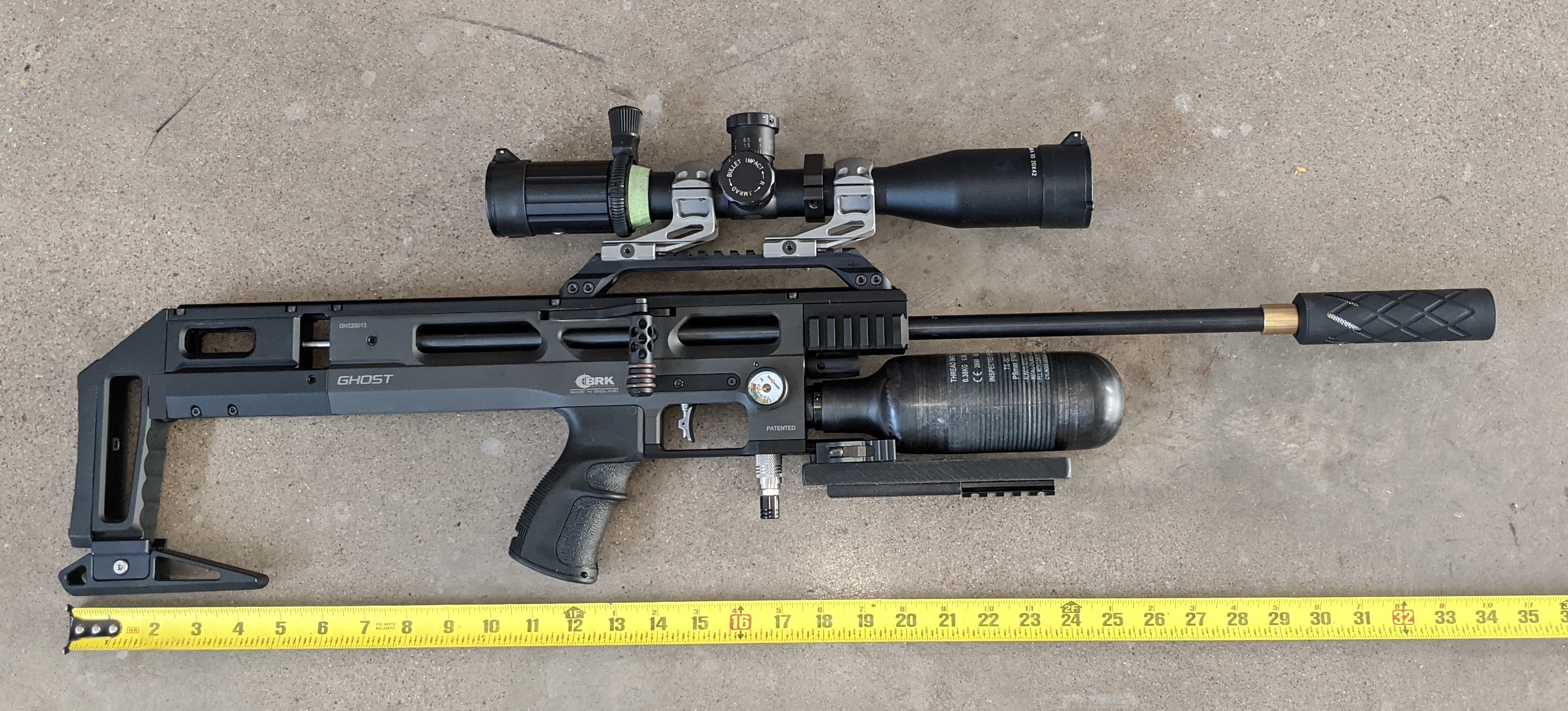

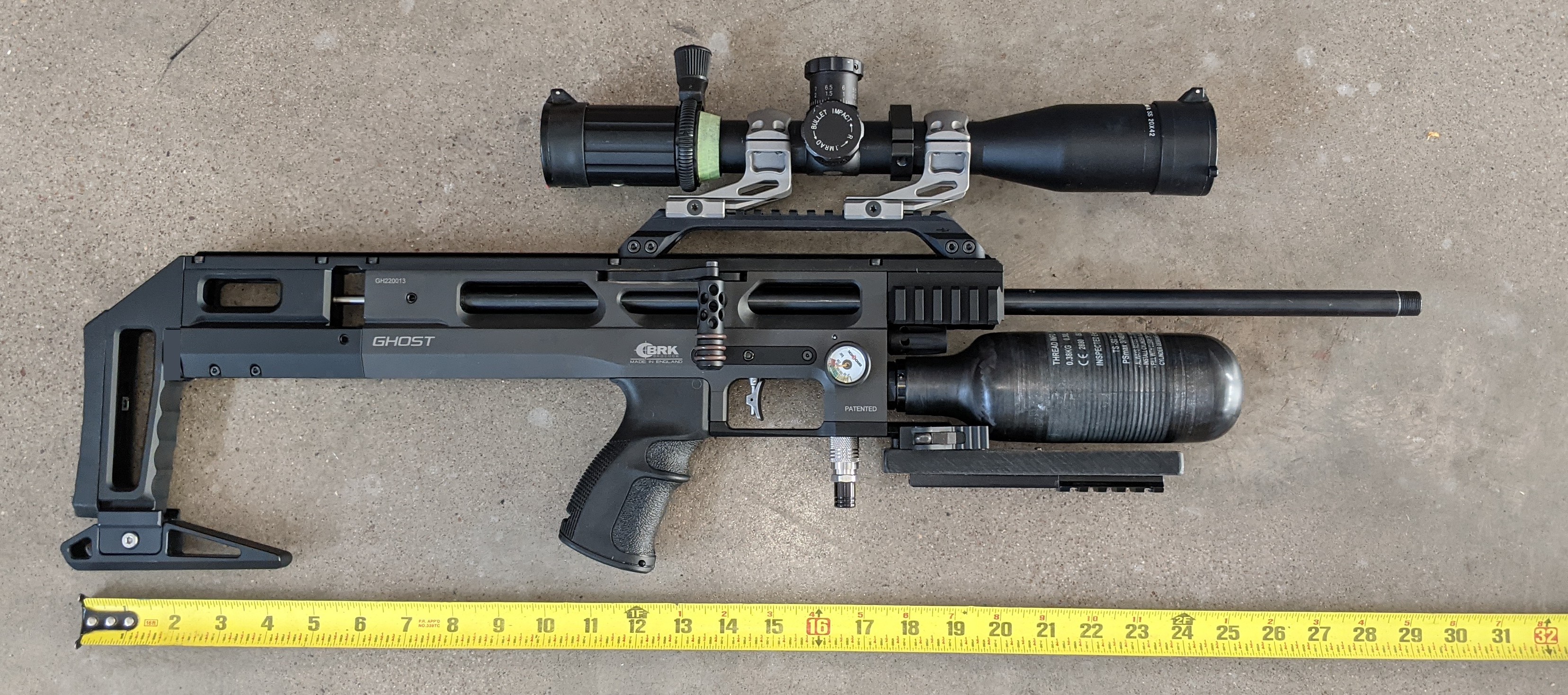

And a couple photos of the 23" .22 barrel installed. Just under 30 inches oal, without any hushers.
OAL about 34 inches is using the 1x14mm to 1/2x20 adaptor (brass in photo-aftermarket, ie Ghost doesn't come with it). A larger/longer bottle would balance those proportions right out, and make sense for a .22 and higher energy output/air usage anyway.
.177 barrel with Carbine shroud and 4 inch 0DB laid in back to help visualization of what it would look like if I were to swap over the shroud and moderator from the .177 to the .22 barrel. OAL also about 34 inches here. But I think it would actually extend out further, another inch and a half or so if it were to be installed on this .22 barrel.

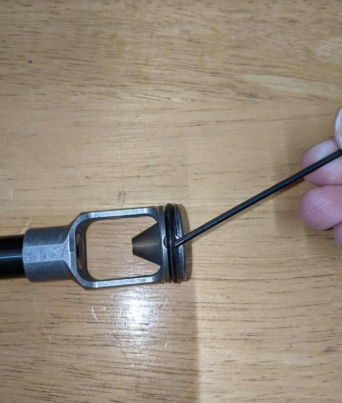

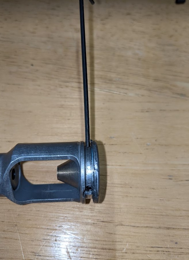

And now, for how the Ghost plays into this discussion.....the design of the air stripping, "cone" in the end of the shroud allows for tinkering. AND it allows for a moderator to still be used.
Under the oring are some grub screws that retain the splitting cone.

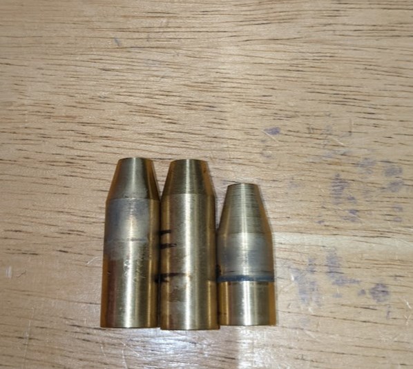

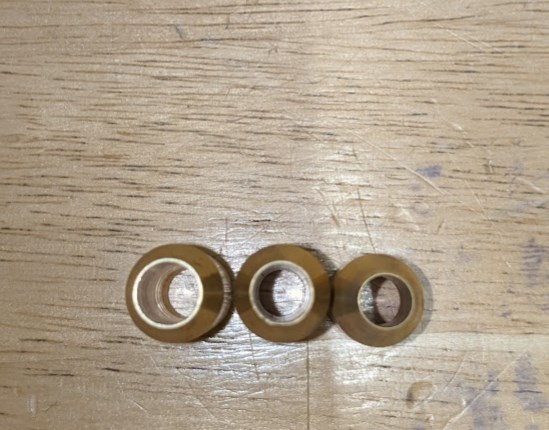

The Ghost does not come with any additional cones, but for somebody with machining skills, or for somebody willing to pay someone else with machining skills......additional cones can be made.
These three have slightly different apertures, angles, and even lengths to allow varying gaps from the barrel....
Just some food for thought for the types that are hunting 10's over 9's at 100 yards.
