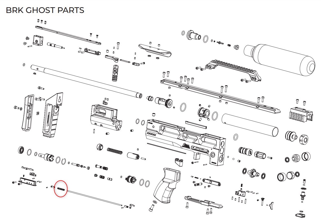

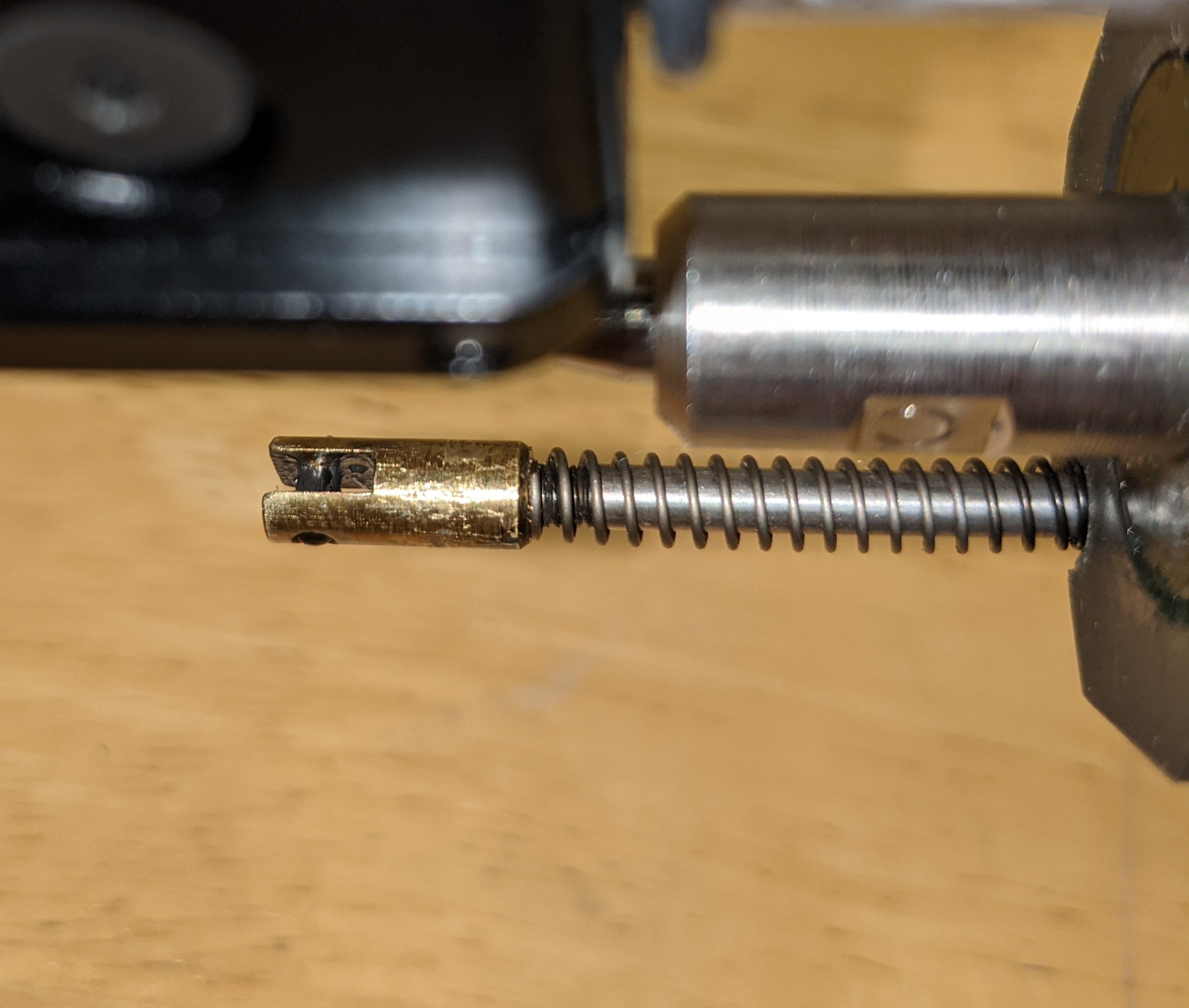

The biggest gains to be had in helping the trigger are on what we've been calling the trigger bar return spring, circled here...
And a photo of that spring.
This is how the trigger cassette "catches" that bar.
I hate to clip a spring, much preferring to replace with lighter springs so that both ends are finished, but after a failed attempt at sourcing a lighter trigger bar return spring, I did the dastardly deed. I only clipped half a coil at a time, and then reassembled to test the trigger weight.

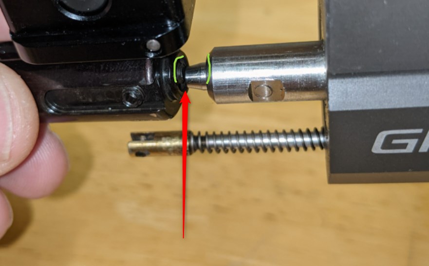

Here are some photos to illustrate that line of thought. (as previously stated, this level of disassembly is not necessary to make the adjustments, but by doing so I can take photos to help readers visualize the adjustments being made).
All of the above chrono testing was done with this depth....
Without the nose extended, the thought being that where I marked green is perhaps "hitting" (hammer on valve body, not hammer solely on valve stem).
The testing from here on will be done with this depth....

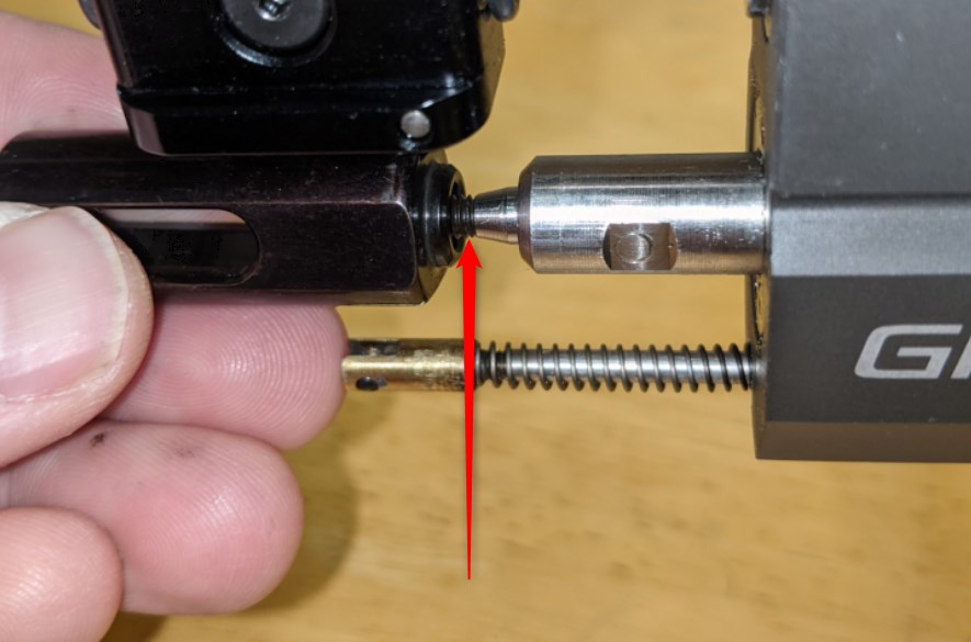

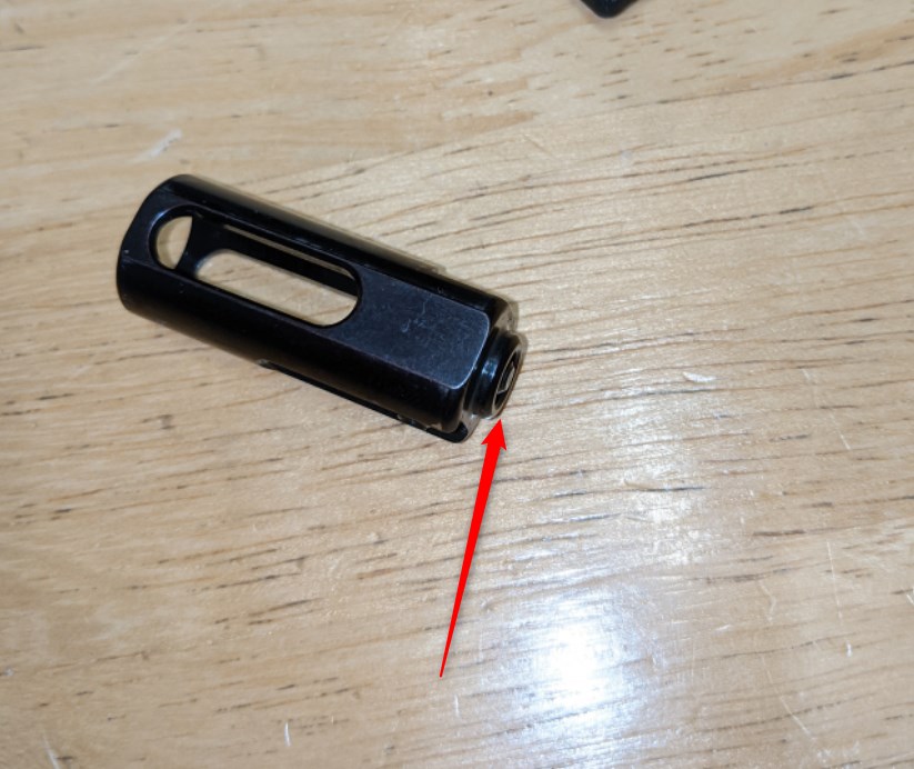

Note the potentially "cleaner" tap of the hammer on the valve stem with the slightly protruding "nose"....
So I extended the threaded "nose" of the hammer about 1/8th of an inch (effectively decreasing the stroke length but also allowing all of the energy from the hammer to be imparted solely upon the valve stem, and not the valve body).

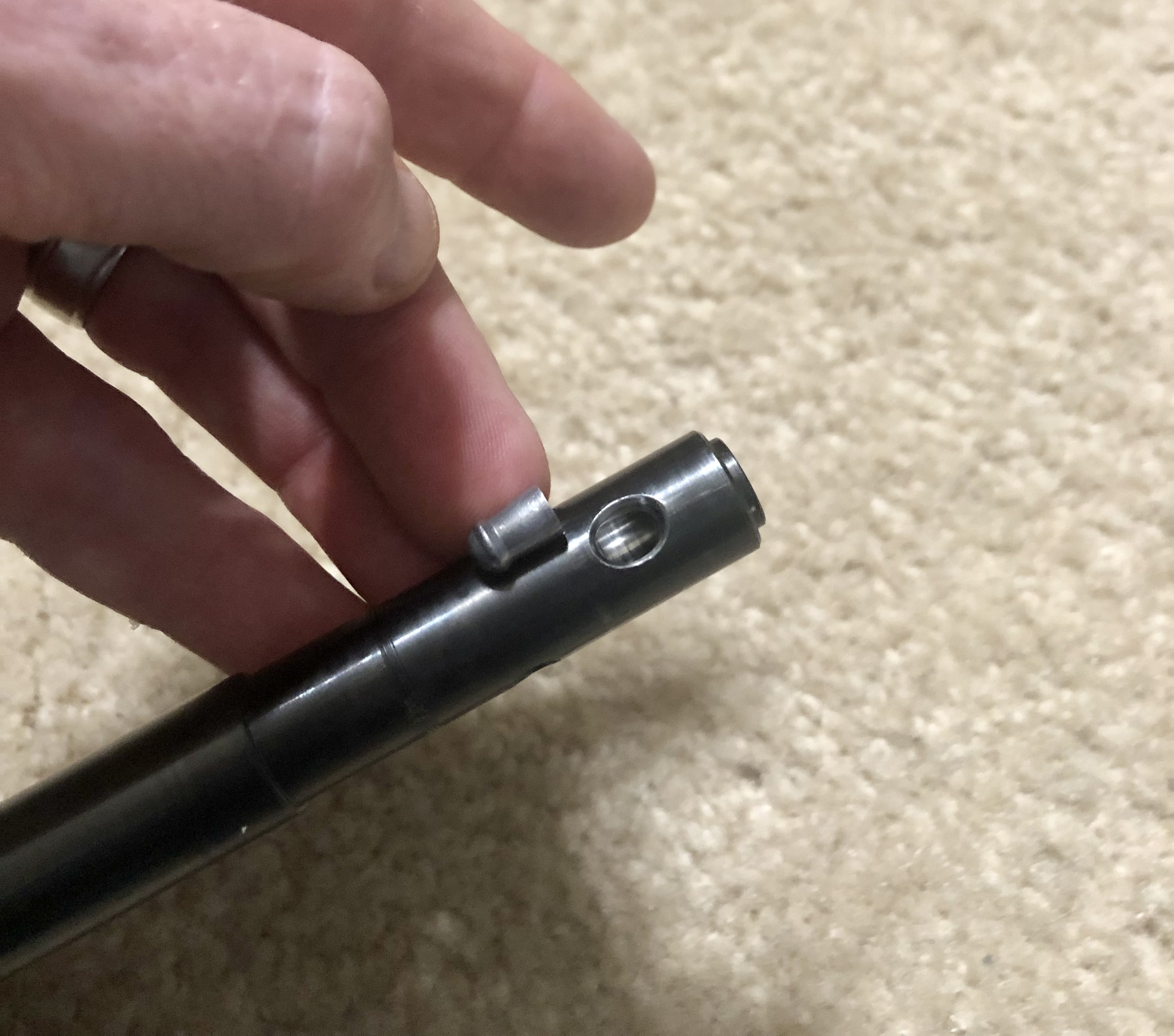

As a side-note, I realized throwing this on the rear pic rail would make the barrel horizontal, and easier to line up into the pellet trap. It's meant to be a forward, undermounted pic rail handle but it has made the chrono sessions a bit easier. I might try shooting it this way at paper too, sorta the same concept as the little rear monopods, just not as refined as one meant for the purpose.

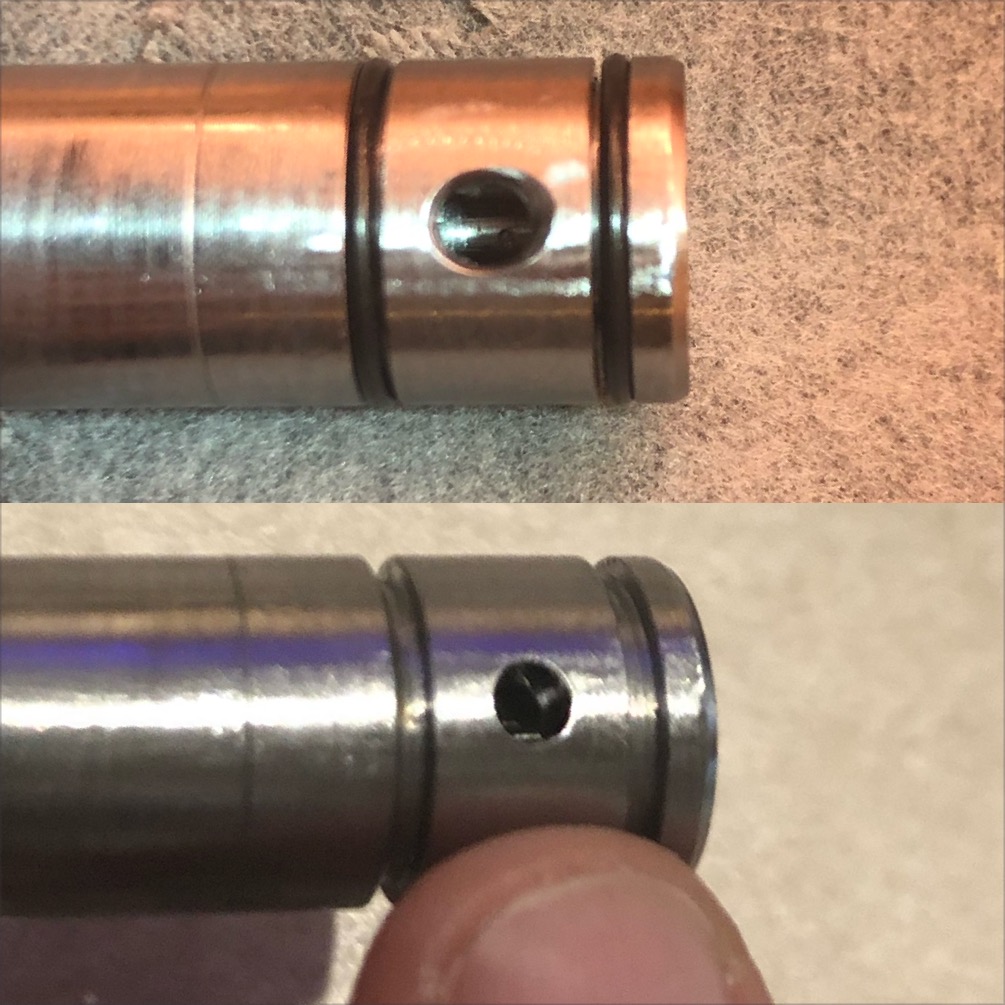

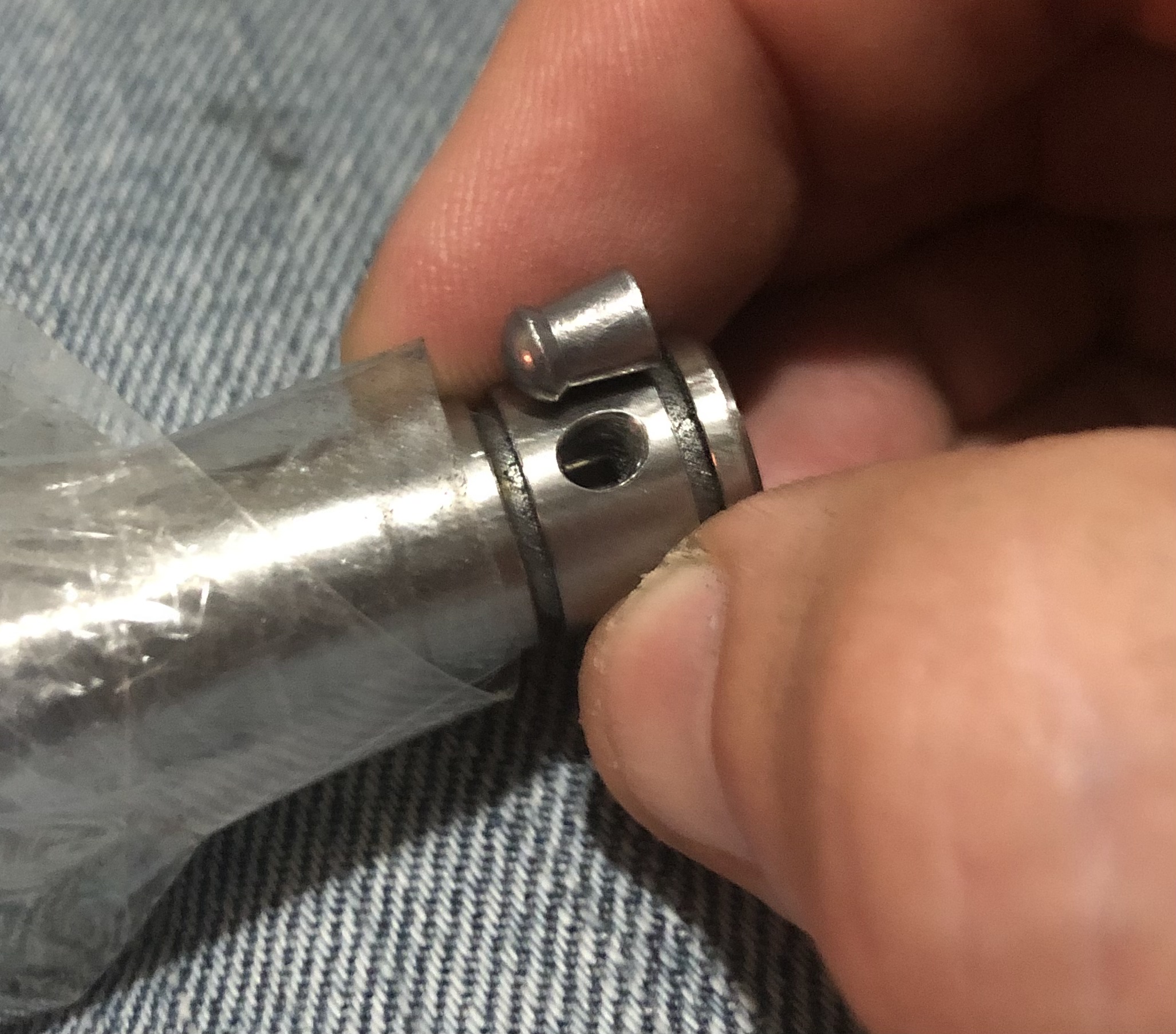

My .177 Renegade barrel and .22 Delta Wolf barrel after messaging. Before and after of the .177 barrel. @Franklink I believe that .22 you have has been messaged a bit as well. Bob perhaps.
Definitely on the .22. That port on Franklink’s barrel is significantly larger than the port on my .22 DW barrel. Probably why I have to crank it up to 3600u-sec and 82 vdc just to get 965 fps with the RDMs.
Nice Dremel work on that .177 port Derrick. ! You also had to port the .22 DW barrel to get decent power didn’t you?
