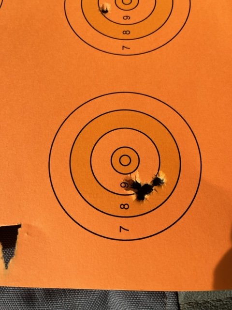

The 18.13 JSBs were pretty accurate despite averaging 995fps. The first image is a group at 50 yards with the 18gr JSBs.
2nd image, 25.39gr MRDs at 50 yards.

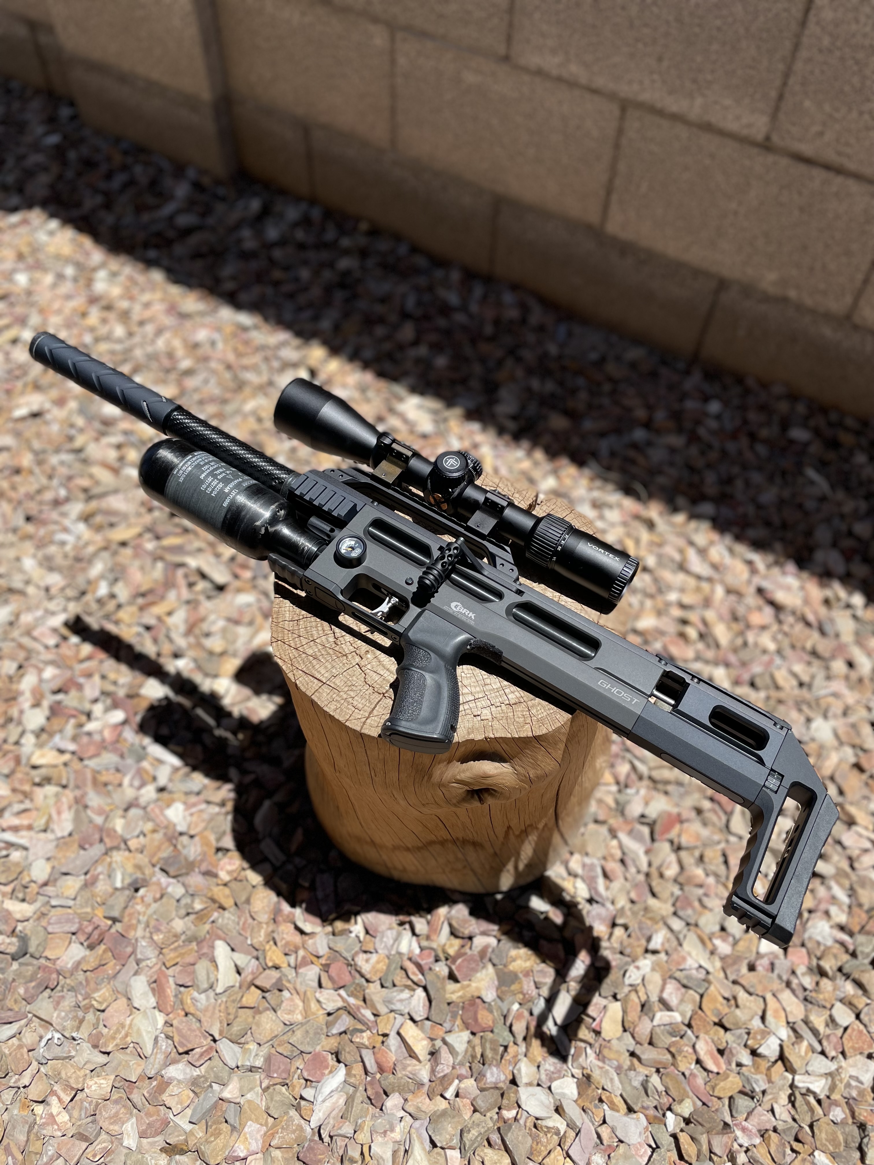

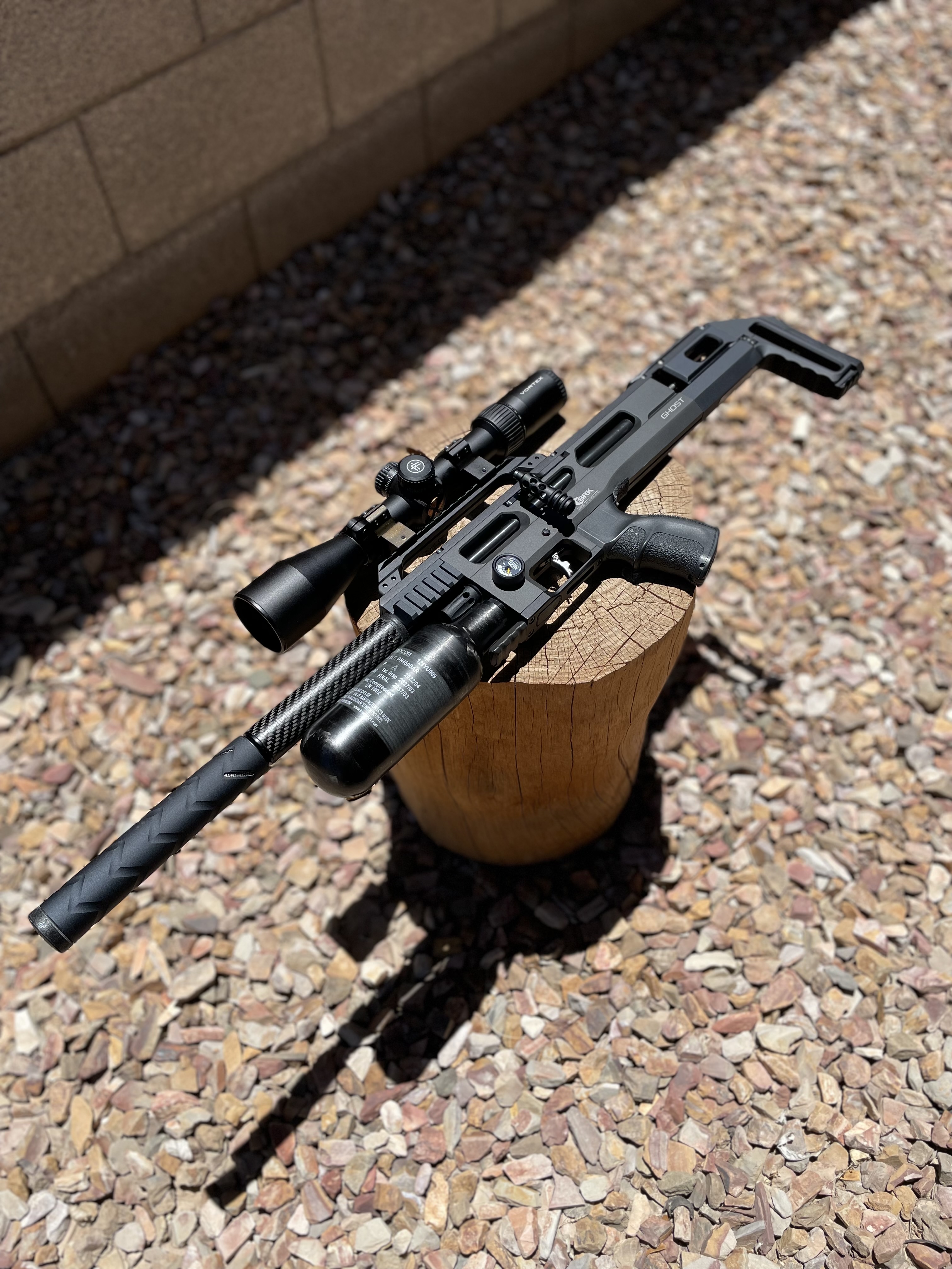

Brand new Ghost Plus (17") in .22. Nice rifle! Just home from a visit to AoA this morning. The Ghost followed me home.
18.13 gr. JSBs are flying at avg. 982 fps, for around 39 FPE. Huma reg is set to around 152 bar. HS is at 10.
I am pesting at up to around 30 yards, more typically 25 yards, and finding there is more noise and power than I would prefer for my particular "back yard" application. I'd like to get down to 30 FPE or slightly below.
Can you folks suggest a reg pressure and hammer spring dial setting to tame the noise level somewhat, save some air, and maintain good accuracy at these fairly close distances in .22? Most of my shooting is with JSB 18.13 and I will shoot some JSB 25.39 RD Monsters.

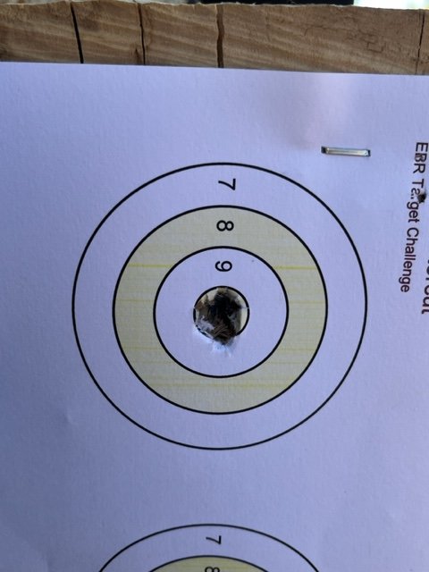

I own a ghost carbine in 22 and was not impressed with the groups I was getting until I pulled the barrel and did a full cleaning with a brass brush, Gunzilla, and some JB bore bright....Now it is a tack driver.....Super filthy barrel !!!!! Here is 5 shots before and after cleaning the barrel at 40 yards.
Tony P.
