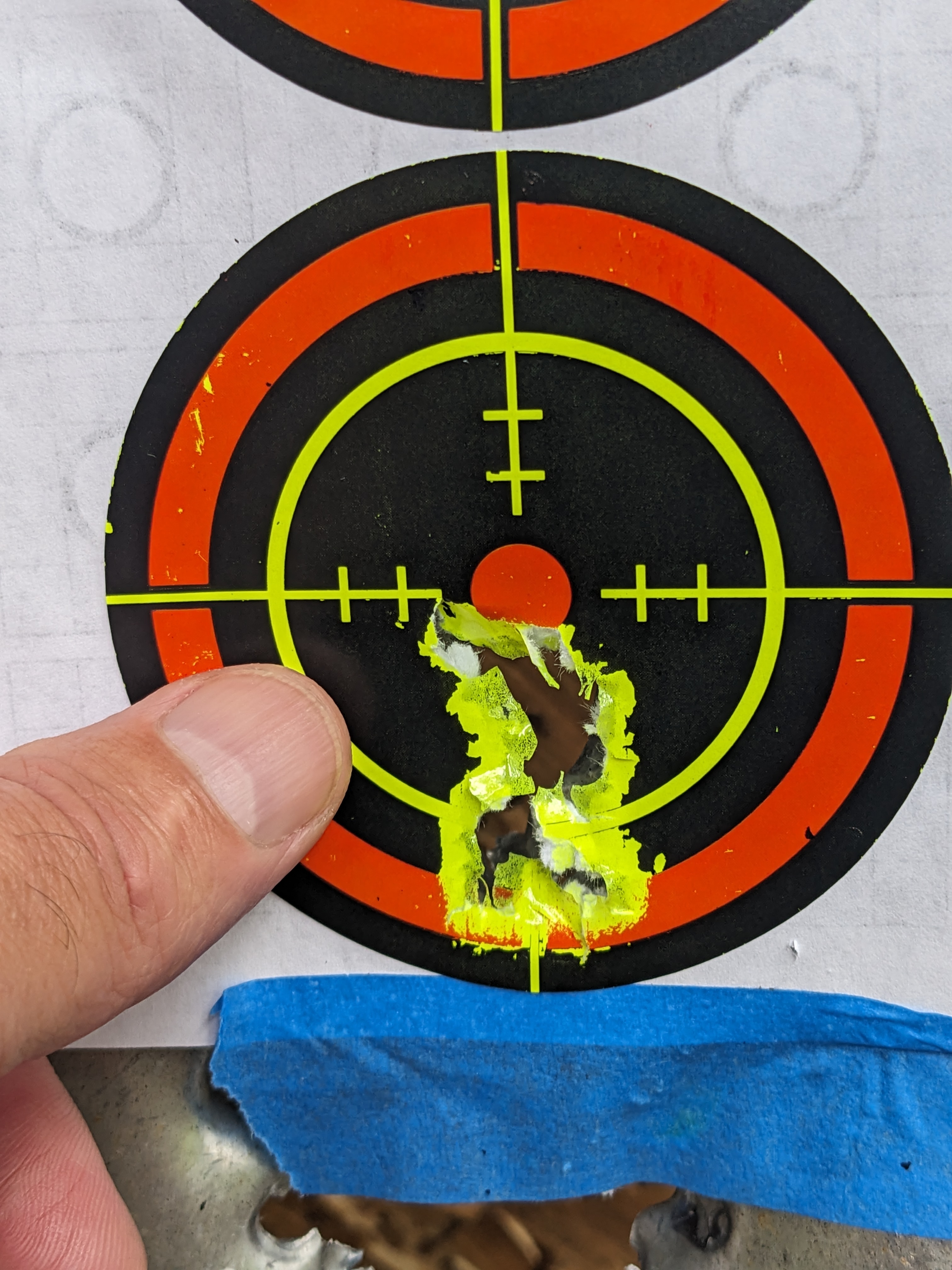

The 18.13 JSBs were pretty accurate despite averaging 995fps. The first image is a group at 50 yards with the 18gr JSBs.

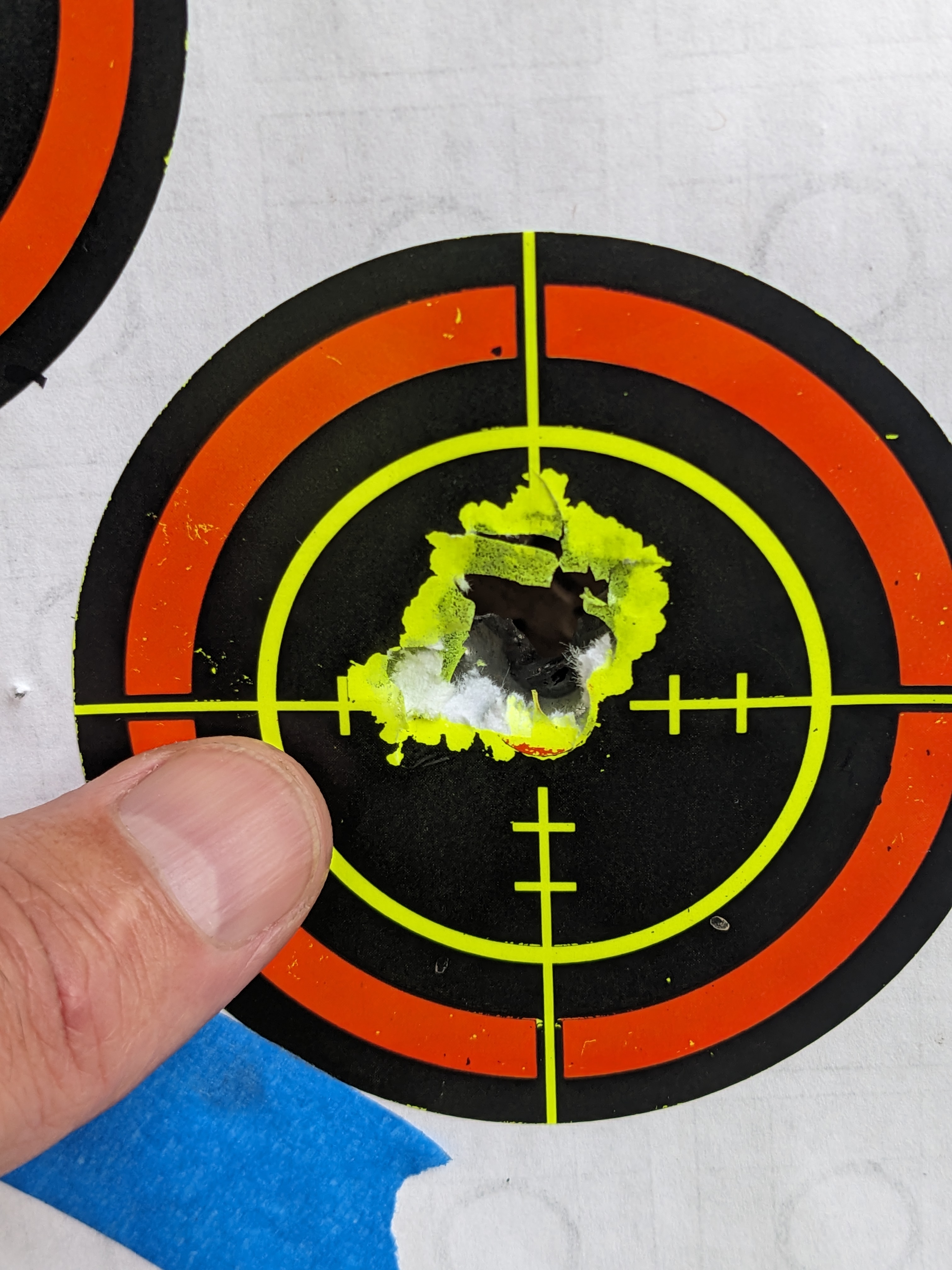

2nd image, 25.39gr MRDs at 50 yards.
