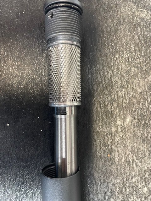

Here is what the new Daystate Wolverine Sapphire .25 Caliber looks like inside - this is the end closest to the breech action...
this screen also was cause for a LOT of grief from displacing the shroud causing canting and thus some clipping.

Never knew about this screen. Well I learned something today. Now I am curious what is function is.
Thanks for sharing.
