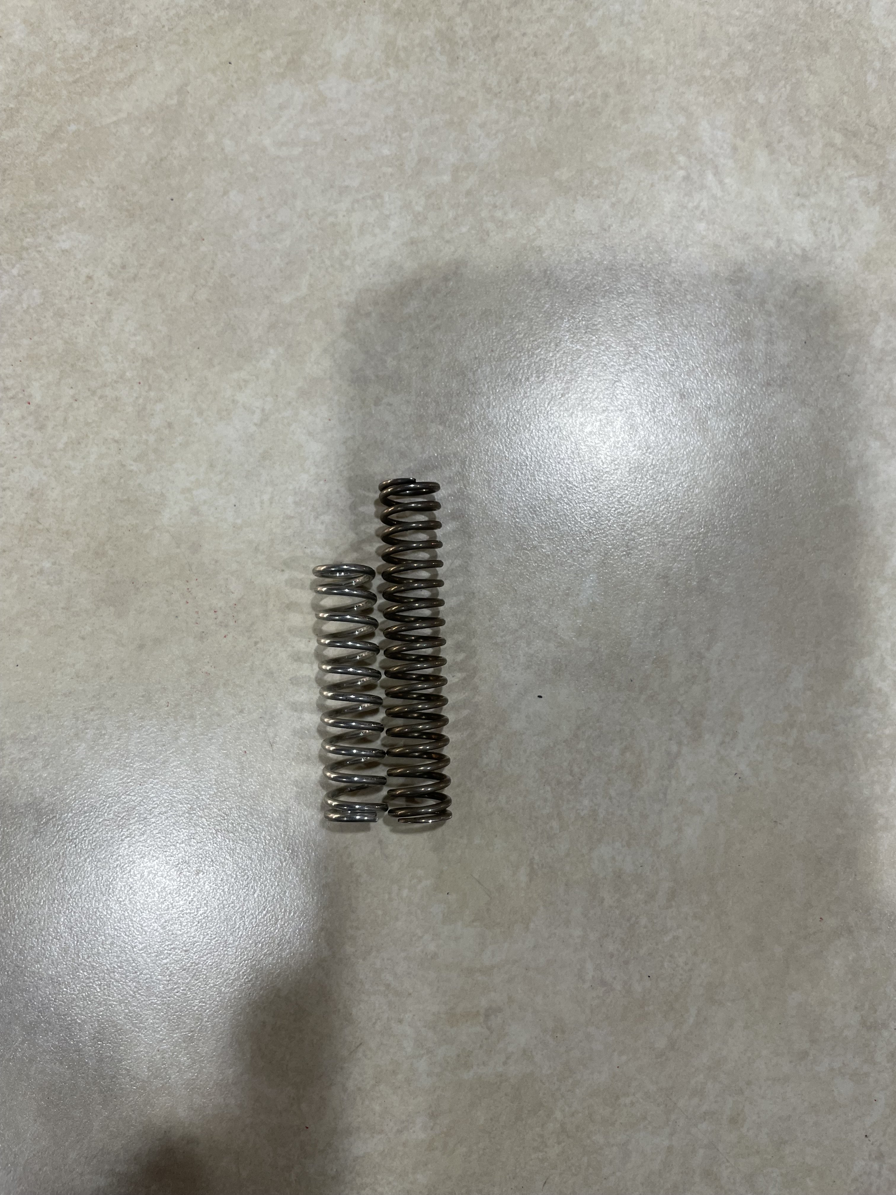

This is the spring (on left) that I've swapped with the OEM spring (right) that was on my .22 Ghost Carbine (US version). I've powered down my Ghost to shoot at 650 FPS with 14.3 grain pellets. Although it's shorter, it's a little stiffer. My Ghost's regulator set point is 60 BAR and power wheel is on setting 17 to produce 650 FPS. I got the spring at Ace Hardware. I have a spare--if you can't find one at your hardware store, let me know and I can send you mine.
I also experimented with a shorter/stiffer spring like that, also from ACE. Ghost valve is very receptive to changes in the rate of the hammer spring and opens alot of opportunities to get exactly what you want. I noticed a very different "feel" to the cocking with the short/stuff spring. Hardly any effort to cock until the cocking lever is through most of its travel, and then you feel the spring start to compress. There seemed to be some potentially positive effects in the shot cycle/air conservation by making the already free flight hammer even more free flight via use of a much shorter spring.
Yes, the lighter cocking effort as a result of the short-stroke spring pays dividends in terms of air efficiency, less stress on the valve, and a lighter trigger-pull break.

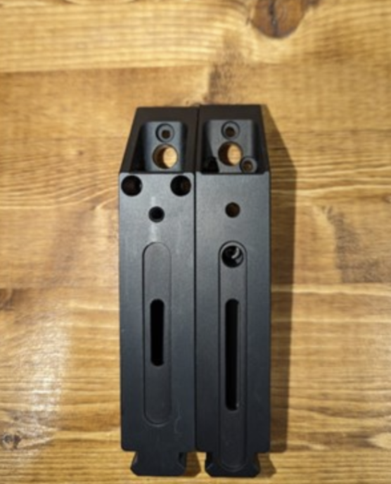

You just have to remove the drop down portion of the rear assembly.
One bolt to remove the plastic buttpad first, don't lose the square nut.
You won't need to disassemble as far as this photo but it's the best I have to illustrate. Yours will look like the one on the right. Remove the three bolts that are at the top in the triangular pattern. And also the lower bolt that is in the top portion of the groove for the plastic butt plate.
That aluminum drop piece that the plastic buttplate bolts to will now fall off.

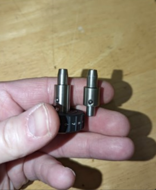

The hammer tension wheel looks like one of these...cone shaped end fits into the back of the hammer spring.
Hammer tension wheel has nothing holding it at this point. It'll fall right off the gun, hammer spring is in that hole, tip the gun up and it'll fall out. Don't lose the ball bearing in the hammer wheel.
When you're putting it back together, be careful of the pattern in which you tighten those four bolts back down. You can inadvertently create a bit of a bind in the cocking. It'll still cock with the bind, but not smoothly. If you end up with a binding side lever, revisit how you tightened the four bolts that hold this rear part to the rest of the gun.

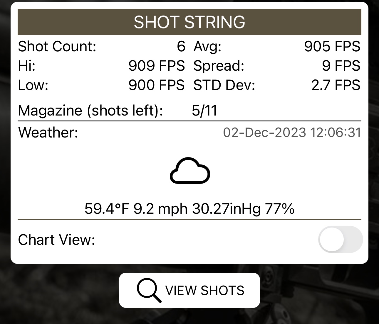

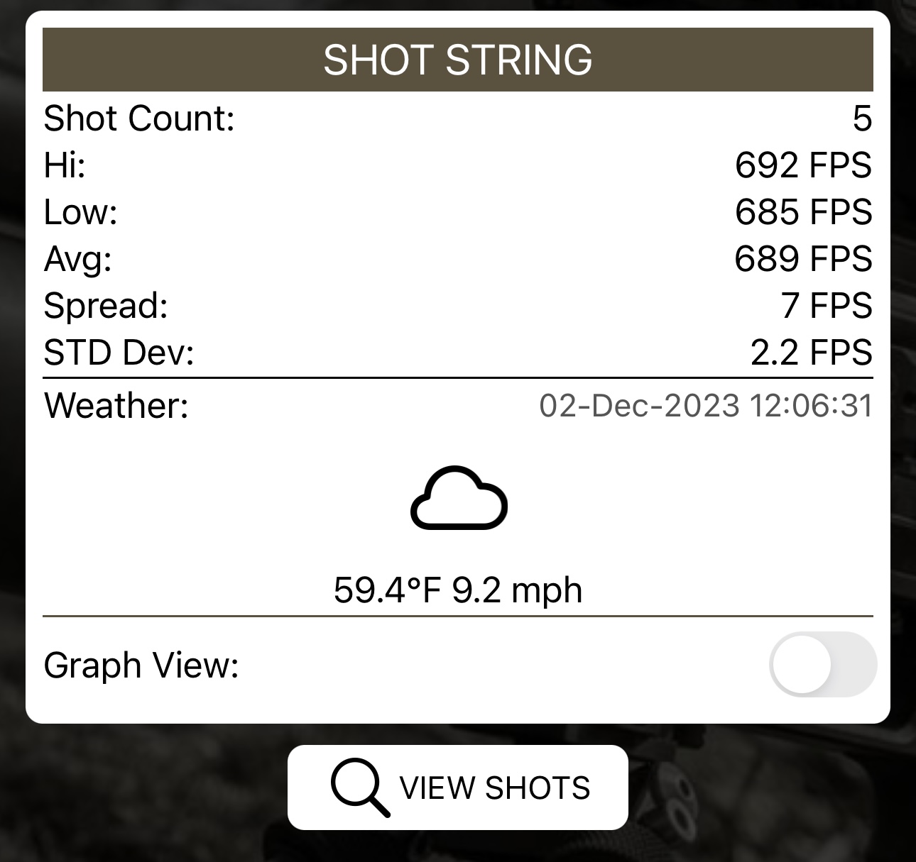

The spring did the trick. Set reg to 125 bar and with the wheel set to min was get in the high 680s and set to max was about 905 fps.
That is just amazing being able to change your fps by 220 fps on the fly by just spinning the wheel.
Below is half a mag on min and half on max on the wheel
