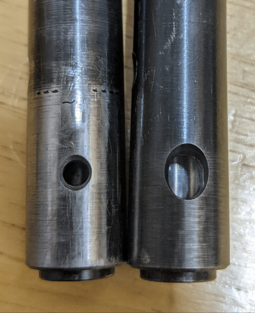

The transfer porting situation is interesting.
This is a .177 Carbine barrel and a .22 HP barrel...
The 28" .177 mentioned above must be ovaled like the .22 HP in the photo I just shared.
Often see 75-80% of bore size mentioned as the max size of transfer port before loading issues (pellet/slug tipping into the transfer port).
A 0.125" to on a .177 would make it about 70-71%. So there's a smidge more to be had there for a round TP. Or the ovalized would increase the effective even further.
It's all about desired use though. If wanting to push s slug fast.....versus a nice air conservative 19fpe pellet tune...too big of a port can be worse than too small of a port, again, depending on desired use.

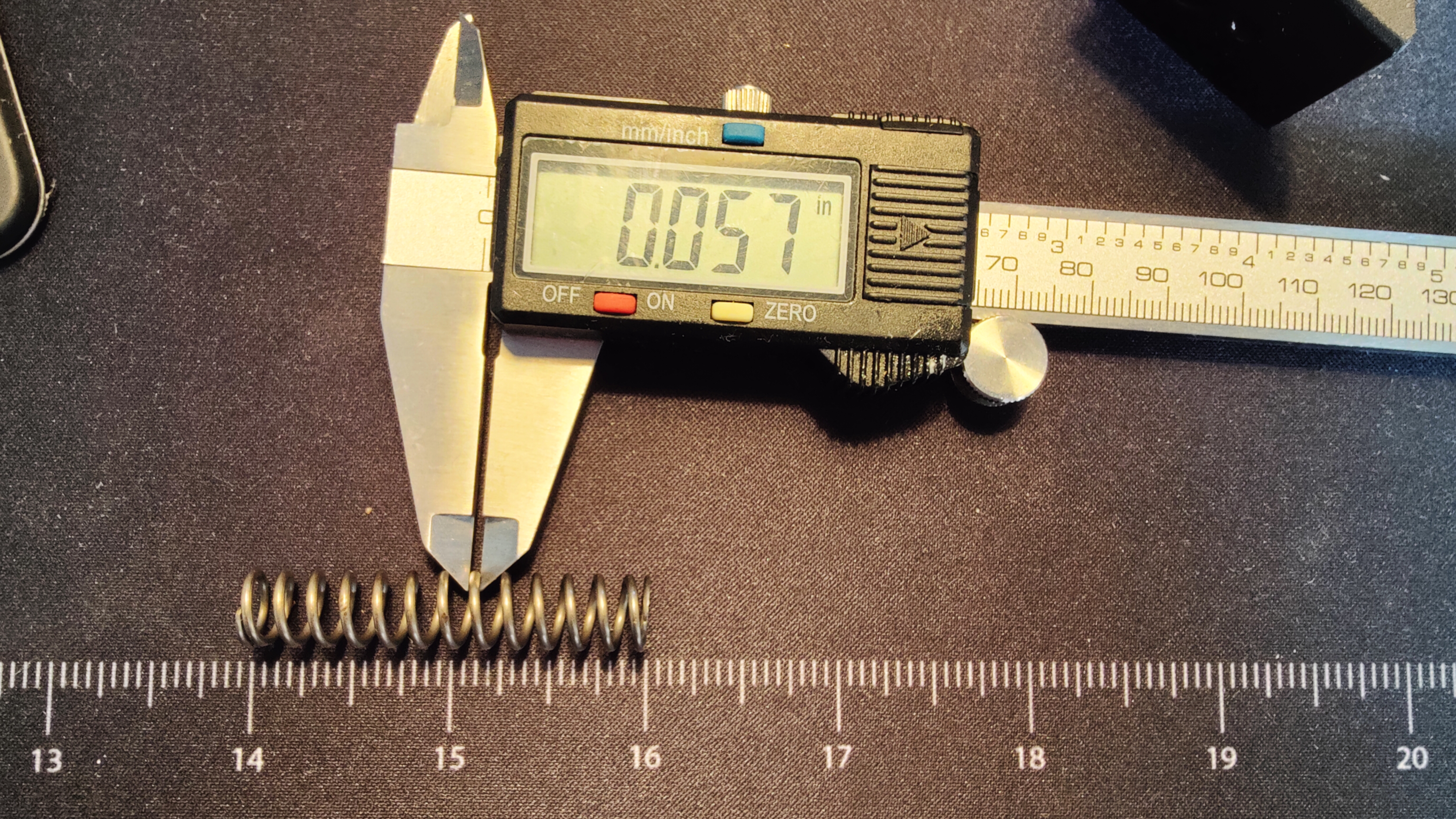

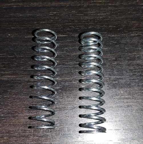

Problem found!
Why did they put the ekstra heavy spring in - that makes no sense.
"BRK labeled "light" had a wire size of 0.046inches. "Heavy" was 0.051. "Extra Heavy" was 0.057."
I've just made a claim to Krale that my powerwheel isnt working as intended. They must send me the right spring so my powerwheel starts working. There are no dealers in EU which have accesories to the Ghost. They only have the Ghost. So buying a spring set my self from UK will be +£90 with tax and fee :(
Success!
The 0.051" wire spring will push a .22 to 58fpe. I think you'd be up into the 20grain slugs before such a heavy spring would be necessary in a .177.
I use the 0.051 for 35fpe slugs in .20 and 58fpe pellets in .22. The 0.046-0.047" hammer spring works better for everything under about 35fpe. ("Better" being less cocking force, more air conservation, less harsh shot cycle).

Yes. Thank you to you guys that where spot on. I often see 100x options when asking for solutions inhere. Your councelling was right on spot. Thx!
Which spring would you recommend me if I want the powerwheel to finetune and not make big steps to the FPS.
If there is no TP adjuster (something that chokes the transfer port), you would heavily rely on regulator pressure to tame the gun shooting light pellets vs tuned for shooting heavier slugs in the most optimal conditions (tuned 97% away from plateau for both light pellet and heavy slug).
Hopefully with the right spring, you can still create enough lift/dwell at a higher pressure for slugs, and then be able to lower the power wheel settings enough for lighter pellets to shoot 900~ fps.
There is a HUGE difference between .046" wire and .057" wire. Glad you're getting to the bottom of this.
