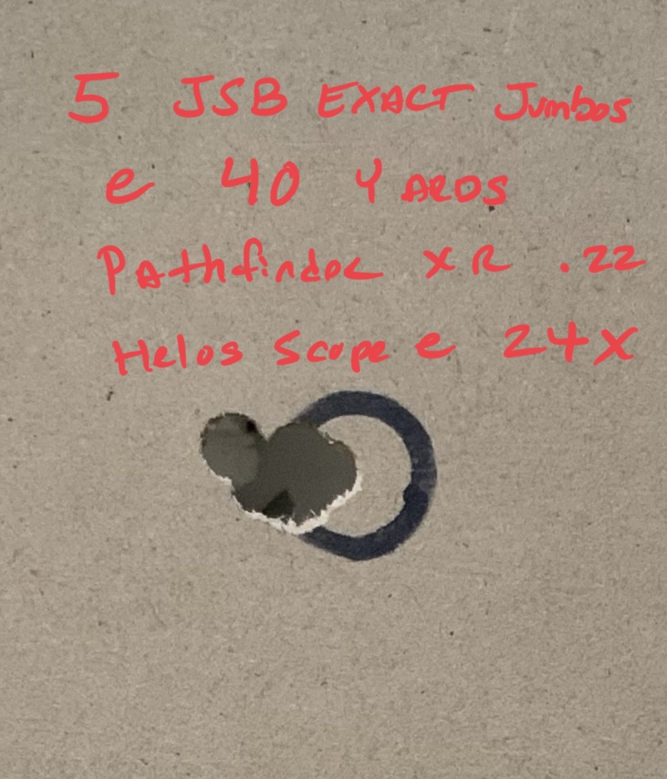

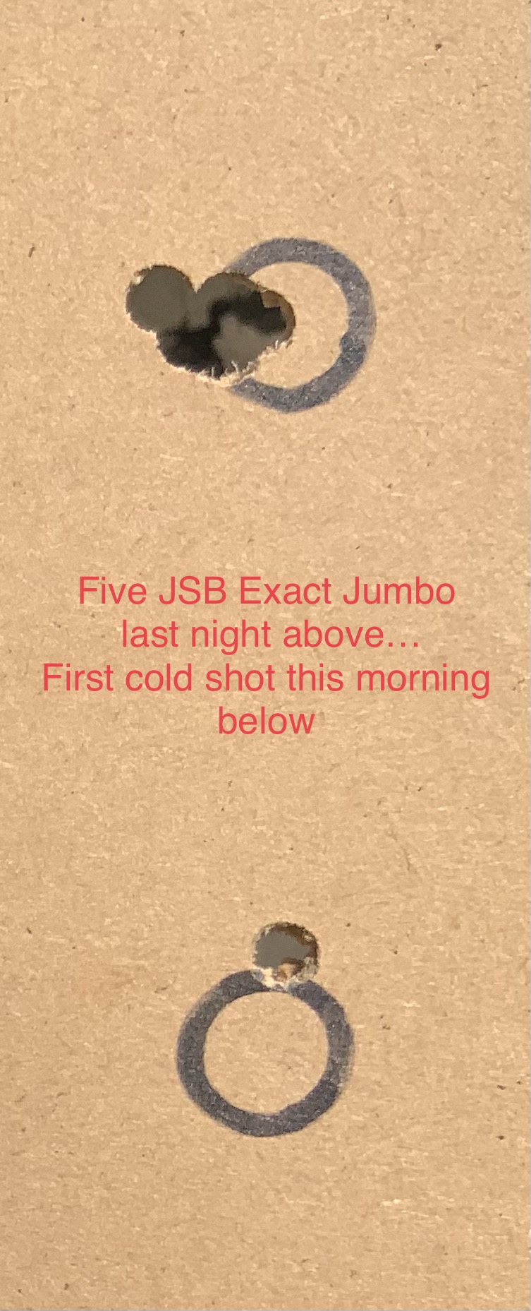

When I do my part, in good conditions, dime size or smaller 5 shot groups sending JSB Exact Jumbo 18s at 40 yards. At 50 yards from 1/2-3/4”. I am not a bench shooter and the Pathfinder though very capable is a plinker/pester for me; where only the first shot counts… Some examples of when “I’m“ on point, the gun is more capable than I am.

Is it accurate till 50 yards? Less or more?
Also what's your regular and hammer settings? Thanks!
My reg setting is 150bar. I can measure my HS setting from flush. My hammer throw is stock.(I have played with the HT a bit but it didn’t make much difference)
I spoke to Chris at AOA about the hammer throw changes but he too agreed that it doesn’t change velocities much at all.
I only have 43yrds to play with in my backyard range. I can easily stay within an inch with the 16.08 JTSs on a calm day.
30yrds it will do 1/2 to 3/4” all day long.
