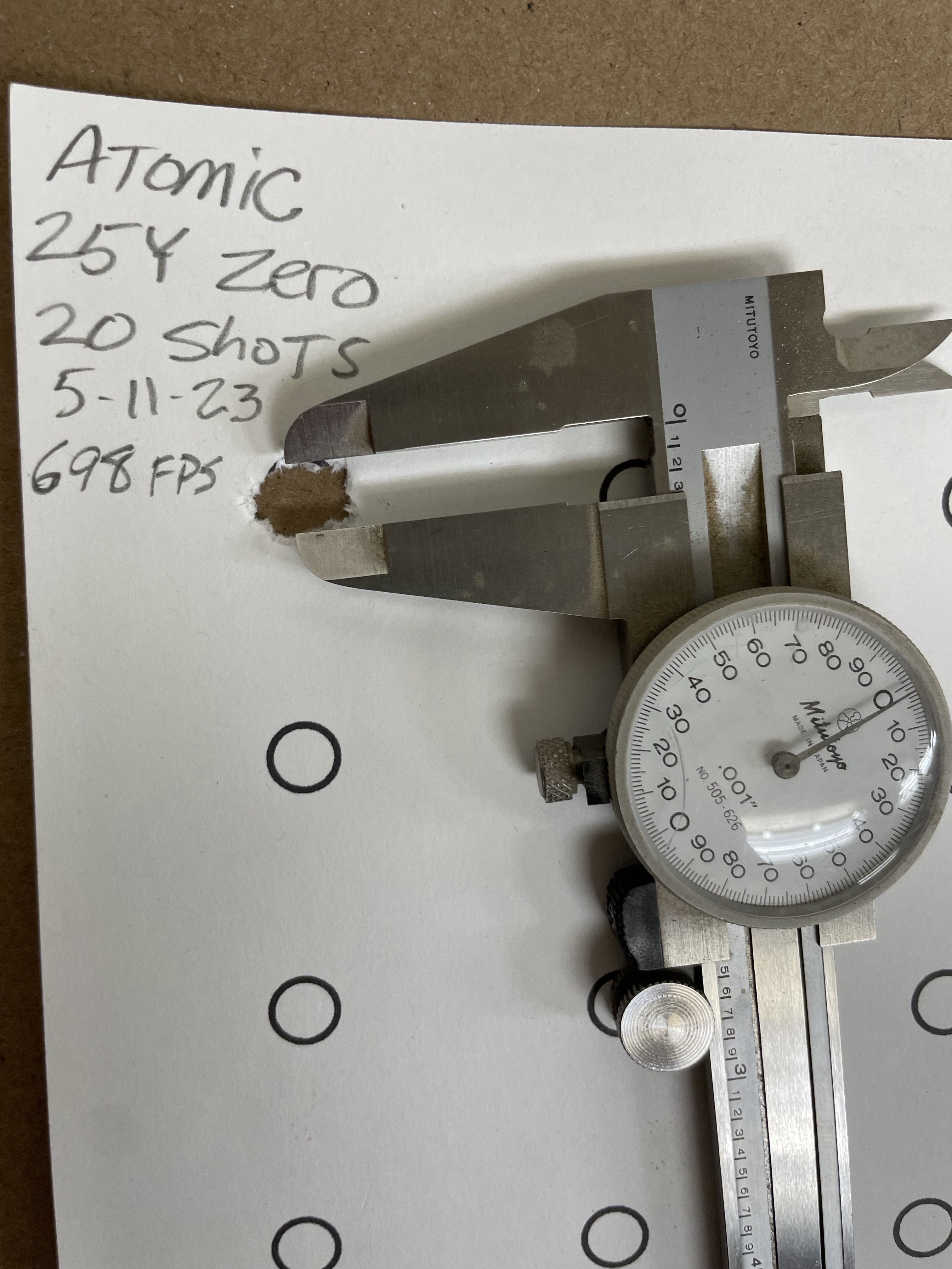

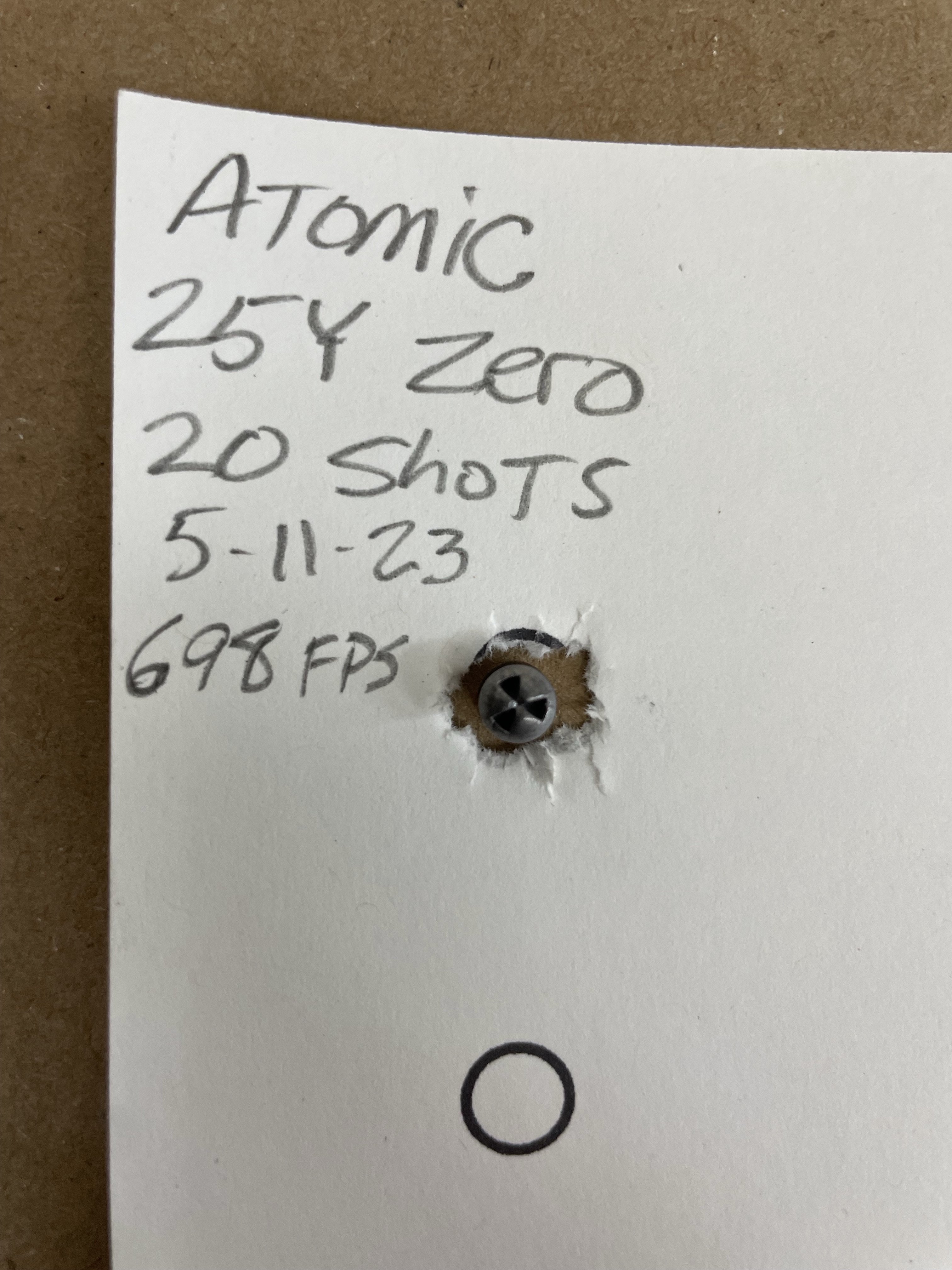

I ordered the Atomic from AOA and about a week later it was delivered. I mounted a USO 3-12 scope, cleaned the pipe and proceeded to start feeding it lead. The Atomic is lighter than the other two and it’s a 250 bar fill which are two pluses for me. I experimented with several tunes but Steve Scally at AEAC said to tune any pellet at 700 FPS and he was spot on. I found the best accuracy with CPHPs at 709 with SD under 2. My groups shrank o a single ragged hole a5 25Y at that tune and that is where it’s now.

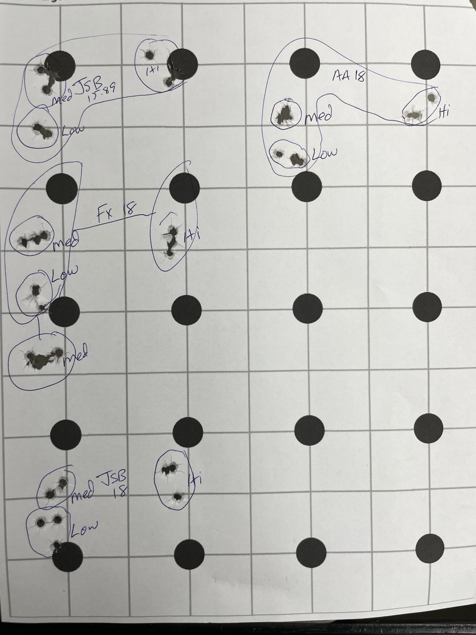

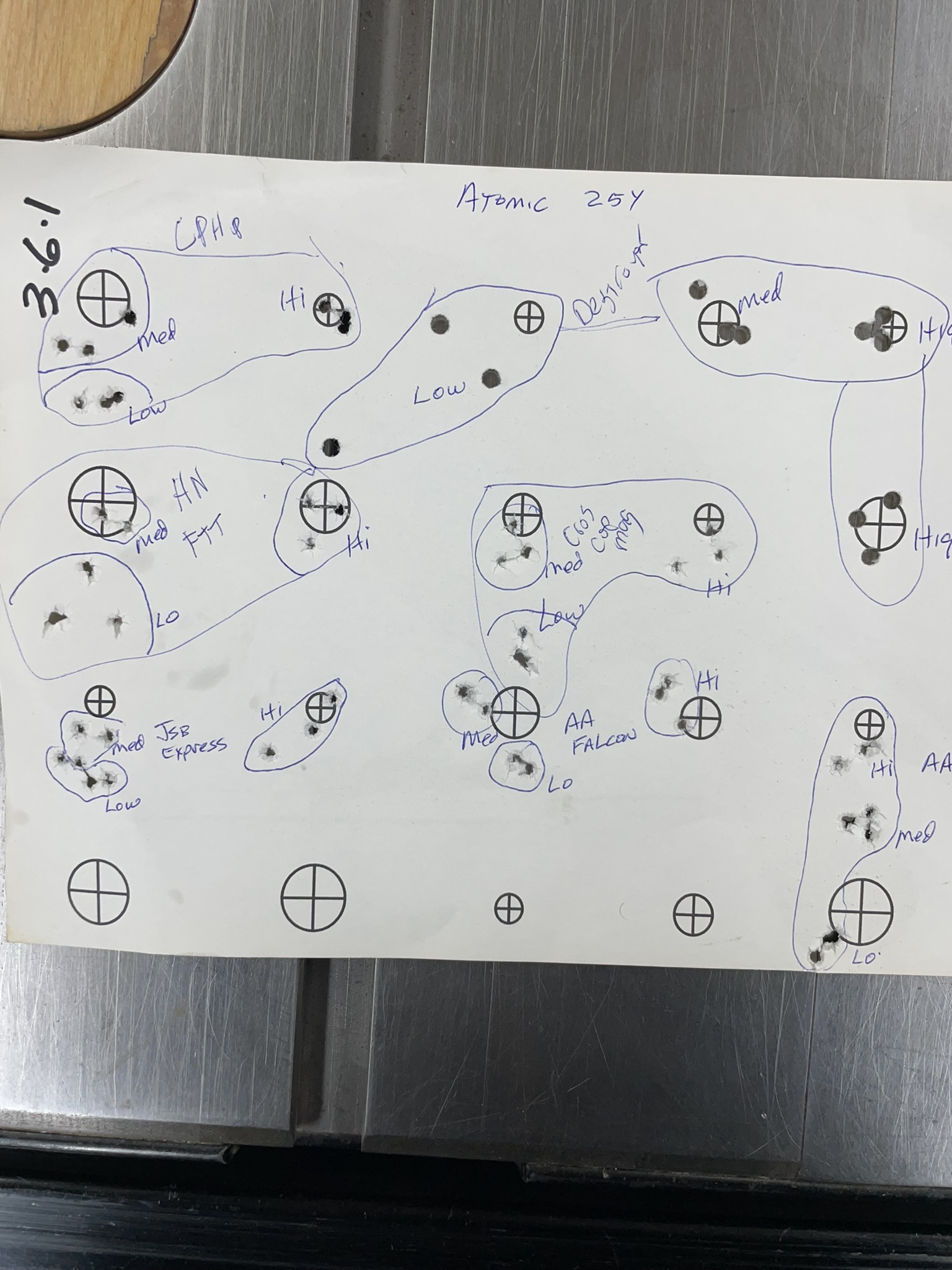

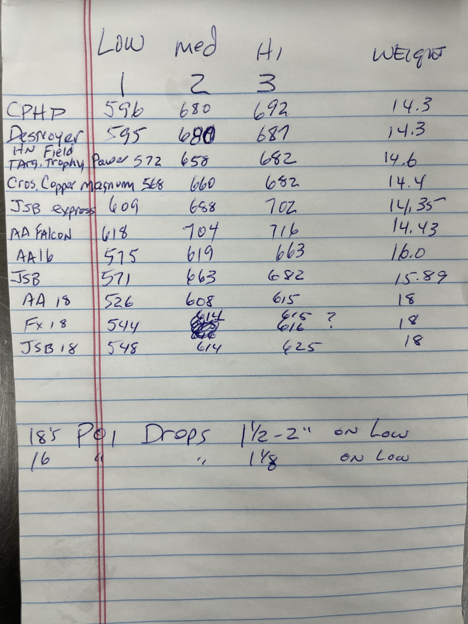

2) I was hoping the power adjuster (transfer port) would give me more shots than it did. #2 (medium) yielded about 3 more shots and #3 (low) yielded about the same before it fell off the regulator. Both #2 and #3 TP settings made the SD numbers go way up. #1 (high) had the lowest SD numbers.

4) Air usage is quite good considering the air chamber is only 45cc’s. This translates to about 33 shots before it falls off the reg. We are hunting in a target rich environment but in a perfect world I’d like to see a slightly larger air tube and at least 50 shots.

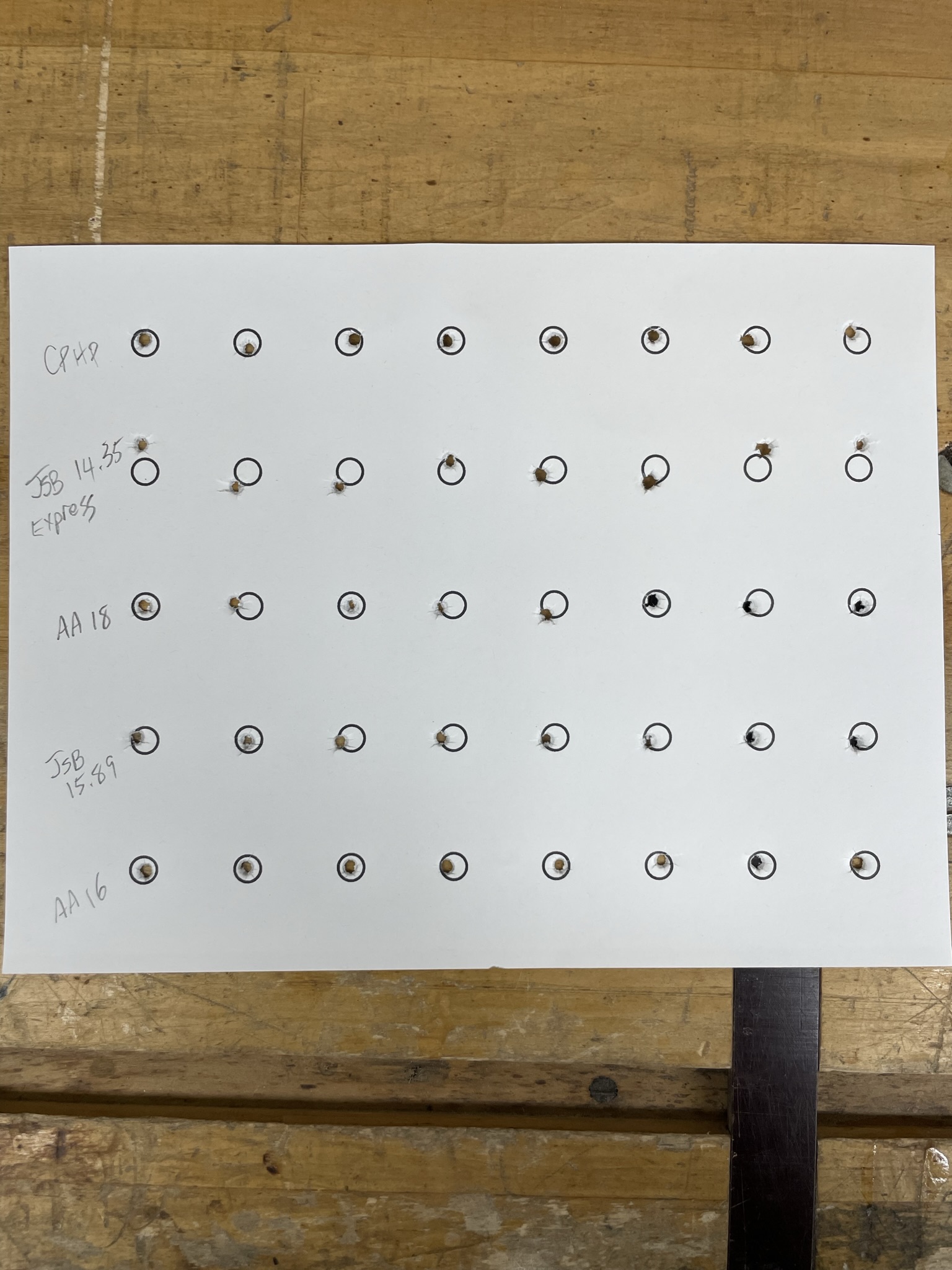

I’ve got well over 1000 pills down the pipe now and have tried many different pellets to see if it has any preferences. It certainly doesn’t like JSB 13 and 14 grain, Gamo RedFires or Poly Mags. It shoots JSB 18s OK but has a preference for JSB 15.89 and AA16s being the most accurate. CPHPs with a 5.52 head size we’re almost as accurate as the 16s but still suffer from the WTH occasional random fliers.
