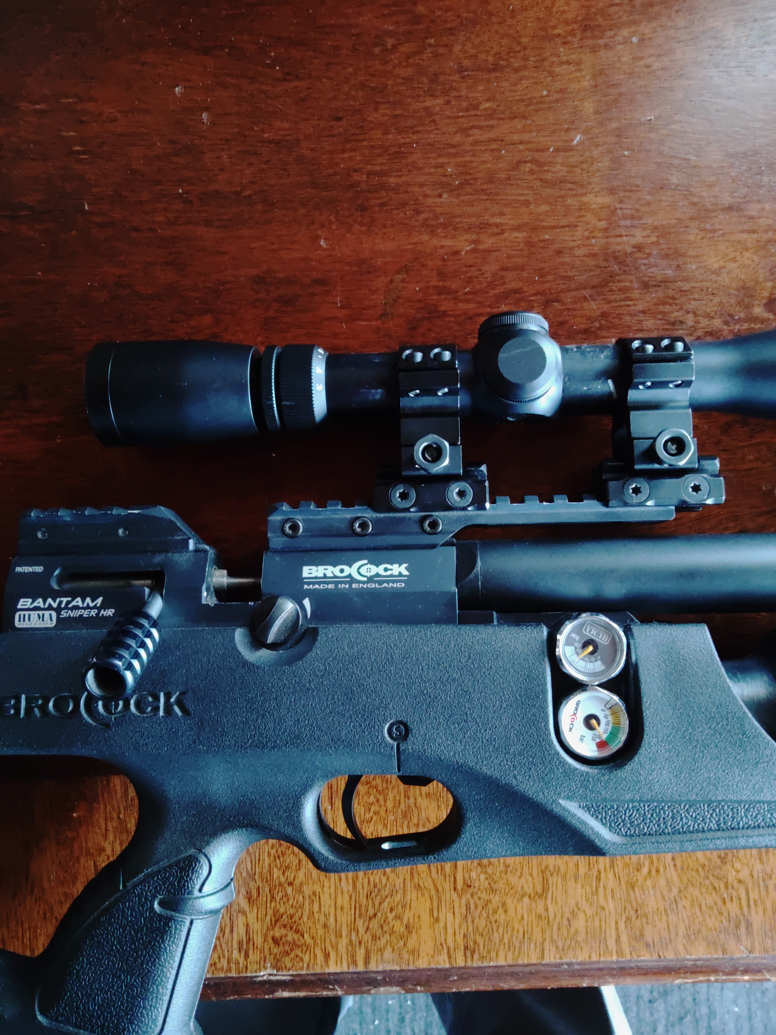

I ordered a set of these to tune my Brocock Snipers. I have not tried them yet but if your current hammer spring is not enough these may help.
I know my sniper XR can reach 46 FPE with the stock spring and 25.39 ammo.

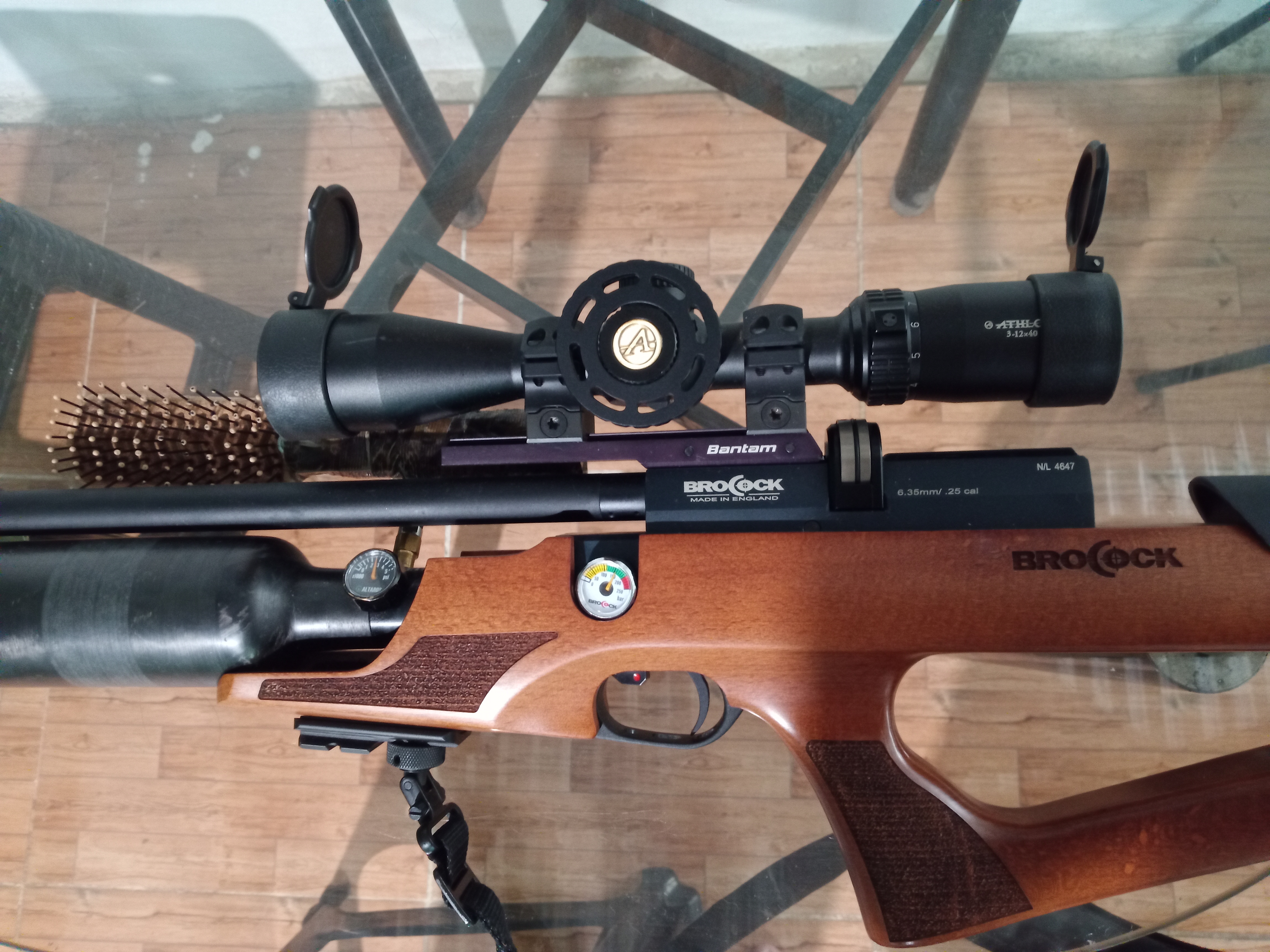

It does look like your gun is shooting pretty close to what it was rated at from the factory. Looks like it is rated for a max of 785fps. with 25.39.
You have a Bantam Hi-Lite model that isn't as powerful as the (later generation) Bantam Sniper. You won't be able to get to the power level you want, due to the (5" shorter) barrel length. And whatever extra power you might coax from it will come at exponential decreases in shot counts.
To some extent, it is what it is.

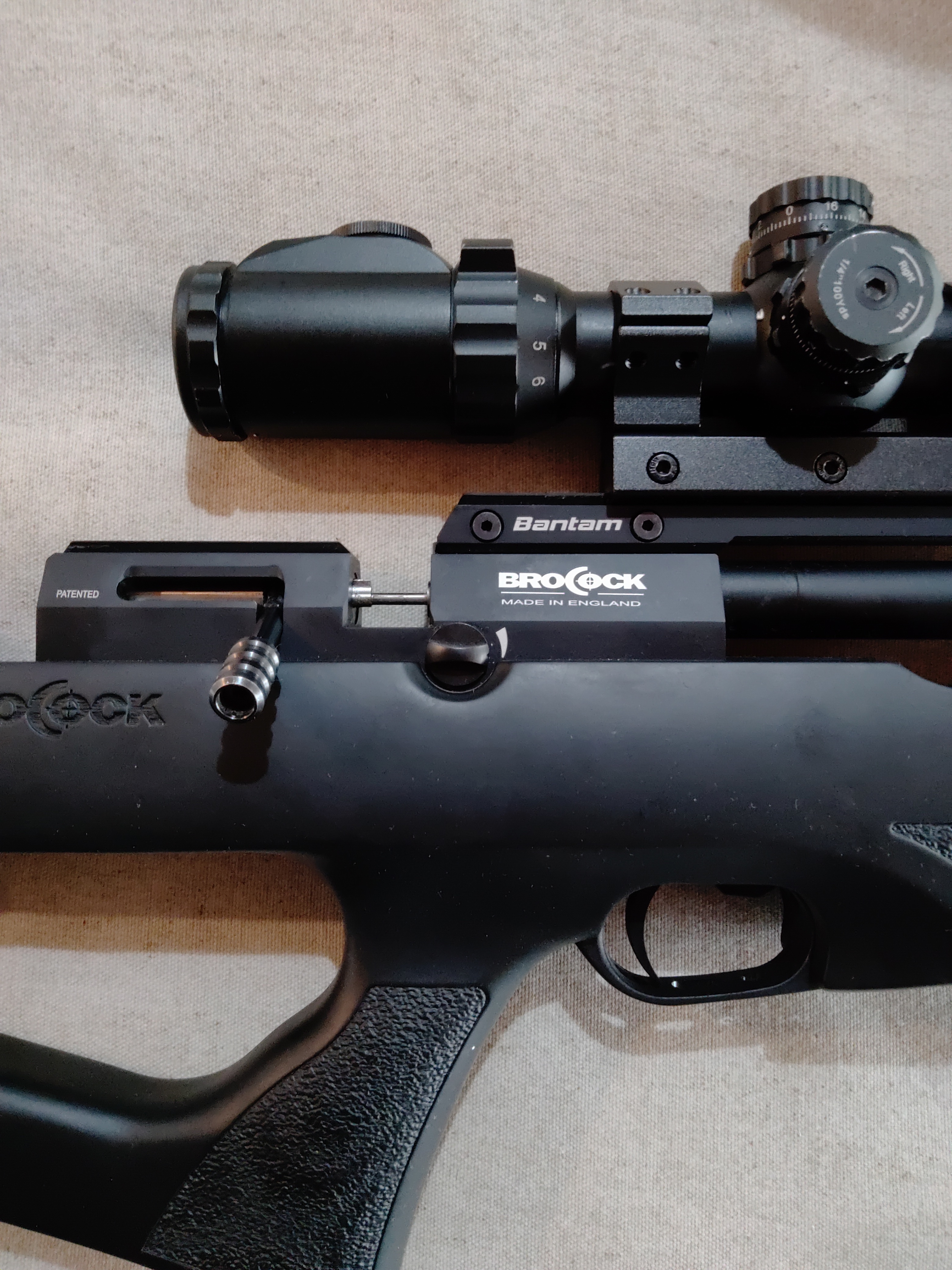

If I recall correctly, the .25 HiLites did not use the awesome Slingshot hammer/firing system, in order to coax more power. That would explain the clank, wap.
My .22 Bantam HiLite is fantastic, as it and .177 are much better in the HiLite platform. Top rifle is my .22; bottom is a .177 I converted to pistol.
As taken from my testing notes-
.22 Brocock Bantam Hi-Lite bolt-action pre-charged pneumatic repeater
18.1gr JSB, 230 BAR* charge, 60 shot powerband= 835 862 27 4 852/29.0
18.1gr JSB, 250 BAR, hammer spring shimmed, 40 shot powerband= 859 871 12 3 865/30.1
18.1gr, 250 BAR, hammer spring shimmed, 54 shot powerband= 871 892 21 3 884/31.5
10/4/2018- Six consecutive 5 shot groups at 50 yards with 16gr. AA averaged .50” c-t-c.
6/2/2020- Four consecutive 5-shot groups at 100 yards with 18.1 JSBs averaged 1.18”.
The smallest group measured .55”; 2nd best 100 yard airgun group I’ve ever gotten.
7/2/2020- Eight consecutive 5 shot groups at 50 yards with 18.1 JSBs averaged .49”.
