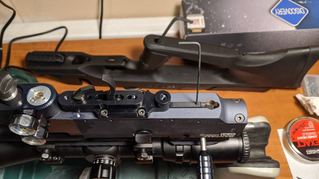

I have a Sniper I bought used on AGN. I have not adjusted anything. It’s set at 130 bar. Original owner was shooting JSB 15.8. I scoped it and set it up for JSB 18.1. Shooting 1” at 50 yrds. My question is where are the trigger adjustment screw and hammer tension adjustment located? Do I have to disassemble to lube bolt shaft. As the gun shoots better then I can, I may not do anything to it. But I would like to know how. Overall my ignorance as I entered the PCP world 2 months ago with an inexpensive XM1.
Howdy!
Here's a pic of my sniper hr magnum. Make VERY small adjustments to the read screw here where the allen is inserted. I would start out with at most 1/8 of a turn and then cock the gun, test the trigger (you should be able to catch the bolt after the sear releases so the gun does not fire). But of course you want to ensure the gun is unloaded before doing any of this! If you adjust too far, you will find the gun will not stay cocked. Off the top of my head I *think* these are small clockwise turns to lighten it, but I'm not 100% sure.

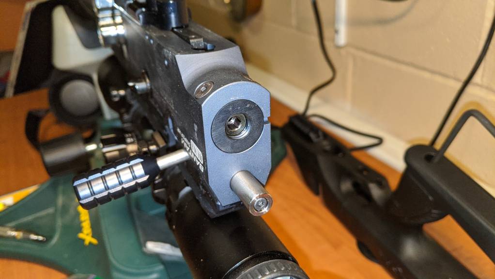

Here is the hammer spring. I strongly suggest you measure how deep the screw is seated so you can easily return the gun to it's "norm" hammer spring setting. Backing the screw out LOWERS velocity. After playing with this I found that I had to use a drop of vibratite thread compound to keep the screw from walking. There's not any physical lock on this screw preventing this adjustment from changing.

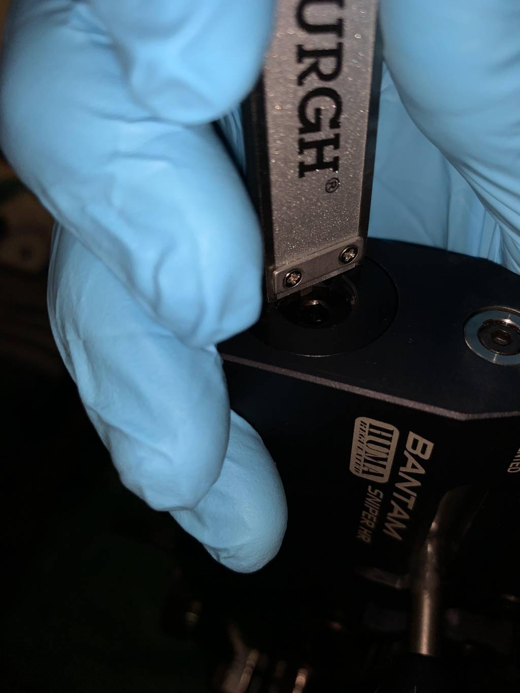

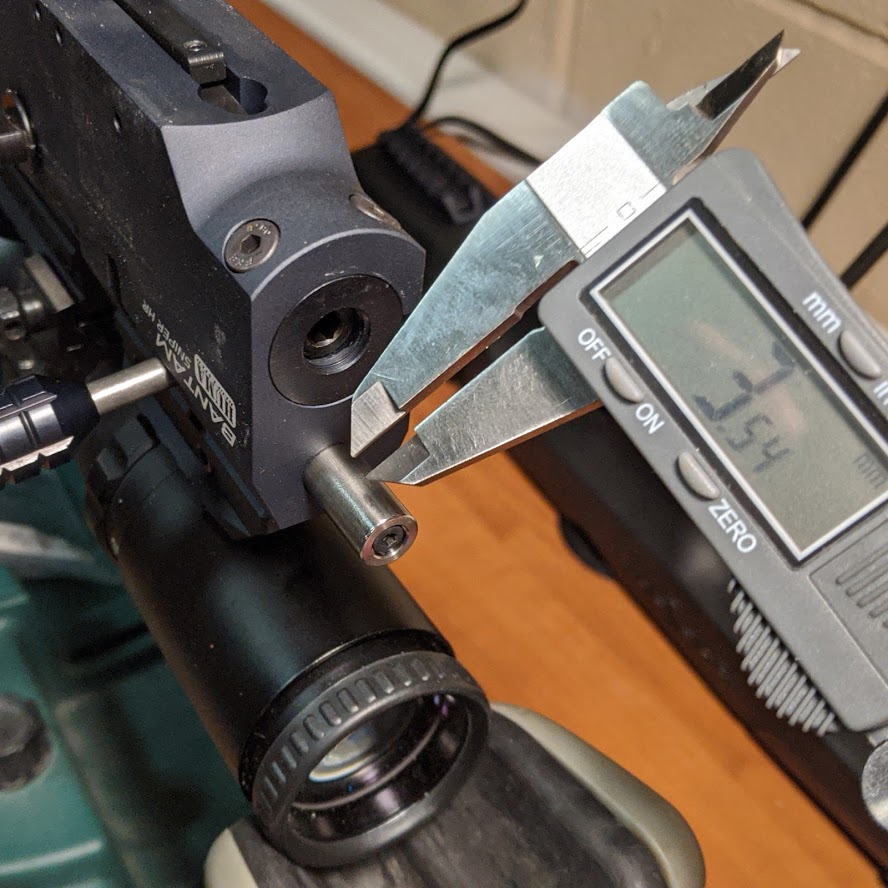

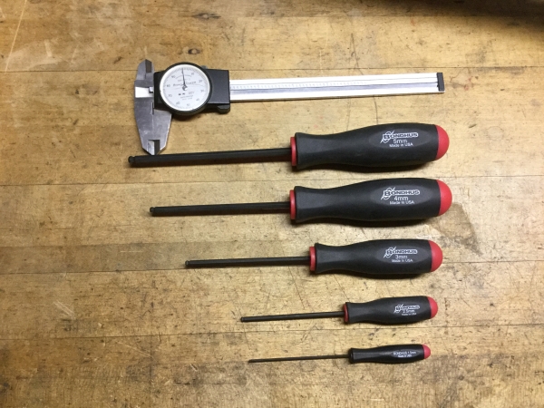

Here’s where I’m confused. What exactly is being measured in order to measure changes in the depth of the hammer spring tensioner screw? Are you measuring the length of the back of the bolt protruding out? Or are you actually measuring how far down the recessed allen head has traveled into the threads after adjusting? If you’re measuring the distance the allen head traveled from being flush, how is this accomplished using calipers?
@ezana4ce, you use the other end of those calipers to measure the depth of a recess in a thing, in this case the hammer spring screw.
Thanks. I had to look up how to use the depth rod earlier. I extended the rod from the end the placed the tip of the rod on the flush surface of the tensioning screw ( NOT down into the hole that allen wrench goes into) and moved the rod in until the short flat edge of the calipers rested flush on top of the back of the receiver. Next I locked the small bolt on the side of the digital screen and recorded my starting measurement. I did the same after making the adjustment. I’m posting these pictures in case another less mechanically inclined soul comes behind me and is equally confused about this metric. Here’s a “how to” link as well https://www.wonkeedonkeetools.co.uk/calipers/how-do-you-use-a-vernier-caliper-to-measure-depth
