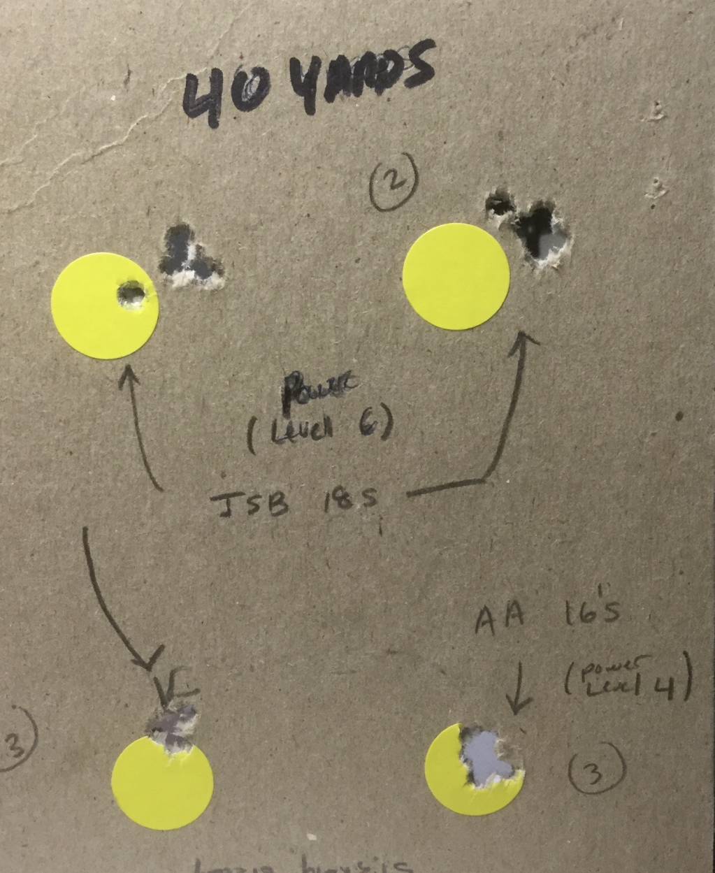

Hi Guys,
I recently got a Bantam Sniper HR in .22 in New Zealand. I thought I would add to this thread since it has lots of great info and I can add the basic setting my rifle came with.
The reg was set at 135 bar, shooting JSB 15.9gr exacts at 873 fps.
It does not have the hammer spring tension adjuster that some here have talked about. I assume that that is an AoA special? Of interest (to me anyway) is the fact that I can't really get any more power from it. First I tried adjusting the hammer throw screw. If I increased or decreased the throw from the factory setting it lost fps. So I moved on to the only other adjustment possible without modifying the rifle. I increased the reg pressure to 140 bar, same fps, tried the hammer throw again, no more than 870ish fps. I then increased the reg pressure to 145 bar. Now with the hammer throw set to maximum, I get 885 fps.
It's got too dark to do any more tests, but I'm assuming I will need to increase the hammer spring tension to get any more power out of it? I'll try that soon.
The reason I wanted to try a bit more power was due to the way the 18gr jsb heavies were grouping. At 30M they were the best performing pellet, but at 50M the 15.9gr were just beating them and at 70M the 18gr had opened up to 53mm but the 16gr were doing a 20mm group (5 shot groups). I was hoping with a bit more power the 18gr would be accurate out to a longer distance.
I shot these 5 shot groups at 40 yards tonight in the dark with a light attached to my Helos scope. Shooting off bipod with rear bag. 35 degrees, slight breeze. JSB 18s on level 6 for groups 1-3 and AA 16s on level 4 for the last group. All of these groups are covered by a dime.
